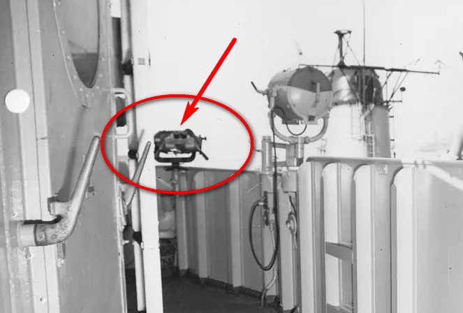

And then, following your advice, and abusing your patience and your expertise, in this order, would somebody know what this element is and would have some clearer picture of it, or directions as where to find one ?
It seems to me some aiming device, or the pair of binoculars I would love to have in my living room, and as it was present in USS Halsey Powell and The Sullivans it seems to be pretty much standard equipment, so in both cases it would be acceptable in my bridge, but I am not sure of what I am adding.
Thanks in advance for your interest, and best regards from this side,
Willie.
PostPosted: Mon Oct 31, 2022 8:40 am
Posts: 3106
Location: Mocksville, NC
Willie,
That object appears to be a bulwark mounted binocular stand - I've not found another photo or drawing of it at all. The photo is from 1956 so it very well could have been a modified Sky Lookout mount cut down from the WWII version of the Sky Lookout Chair & Binocular Stand. It appears to have one of the large bridge binoculars mounted with a pair of handles for maneuvering. We had either 2 or 4 of these on NEW JERSEY (011 Level) and if I can find the photo in my cruise book, I'll post it. The binocular mount looks to be simply a plate welded to a pipe stanchion and that welded to the bulwark. The binocular mount was probably removeable from the stand.
As both of my TFD Plan Books show items from WWII, this equipment is not included.
Hope this helps (somewhat... :doh_1: )

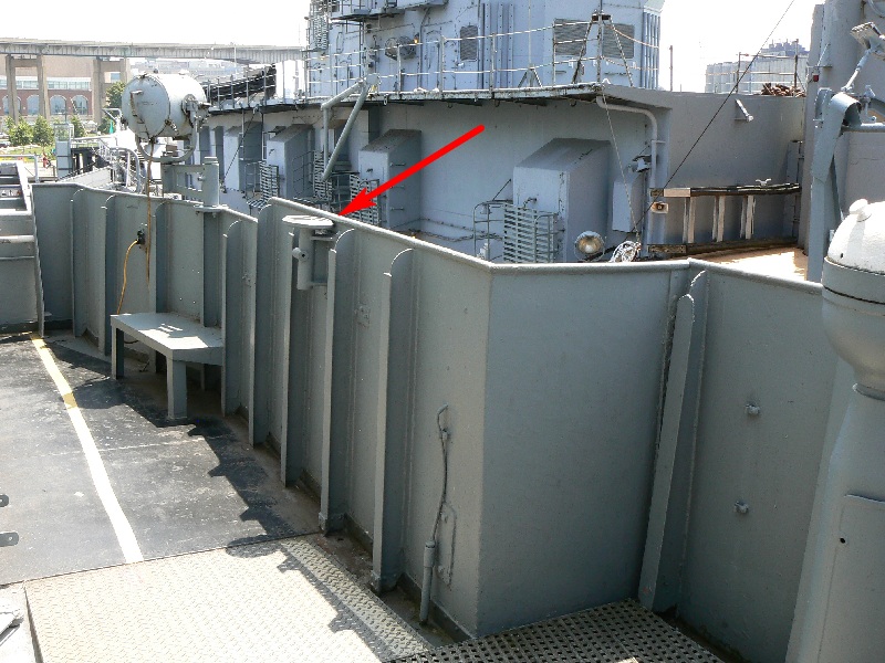

PostPosted: Mon Oct 31, 2022 11:51 am
Posts: 5060
Yes, those are 20 power (20x120) bridge binoculars. I printed some on a pedestal for use on several models though as shown here can be mounted on a pipe welded to a bulwark. I remember Turner Joy had sets of these mounted on the bridge wings. In the photo one of the handles used to assist in pointing can be seen.

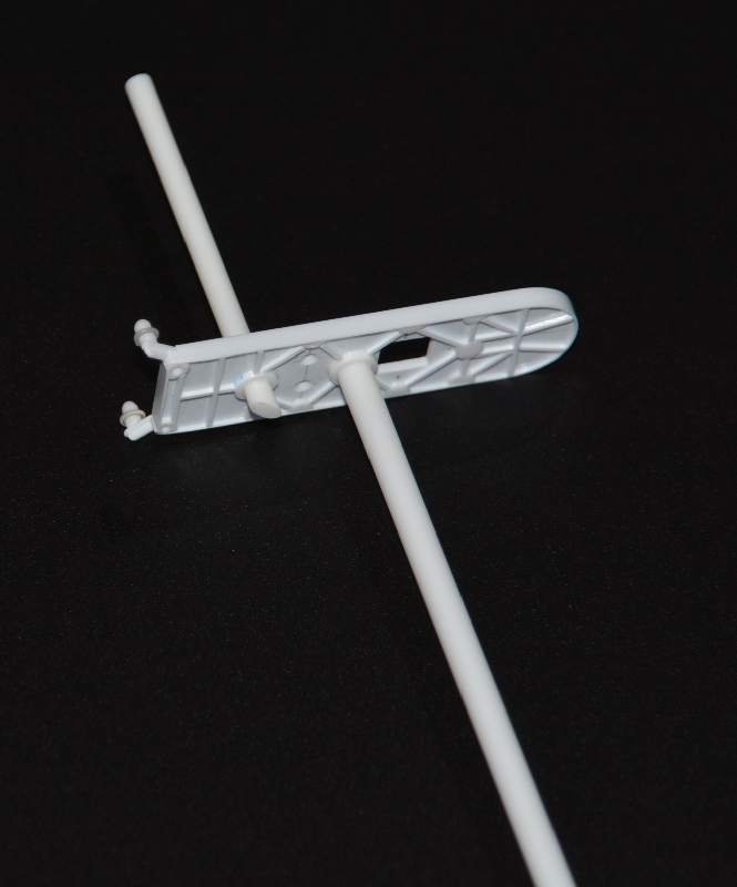

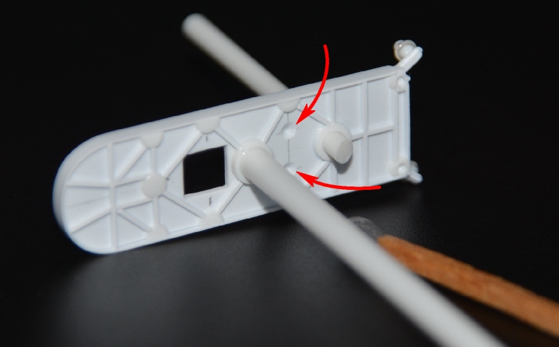

I have started the binoculars sets. The items themselves were a bit tricky to build, but not that complicated. Here you are the basic elements :

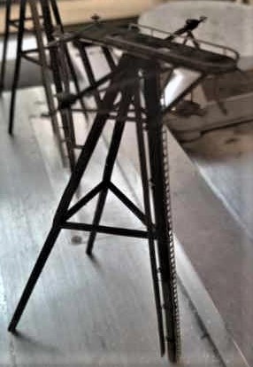

The main elements in this mast are the mast itself and the first platform, as everything else will be based in one of the two. The platform underside is not bare at all, just the opposite, and had to be done before fixing the mast itself. This is what had to be done:

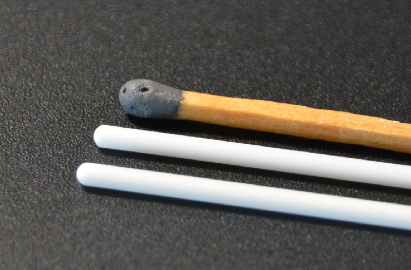

I made the platform with a piece of 1 mm. thick Evergreen plate, surrounded by a 0.25x2 mm. stripe for the contour, and completed with scraps of 2 mm. rod slices and 0.5x0.5 mm. stripe for the bars.

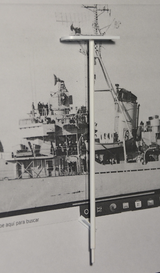

I found the mast height (130 mm. high at 1/144 scale) using one full profile picture of a Fletcher (one of yours again Hank :wave_1: ) compared with a similar one of much poored quality of Jorge Juan herslef, and calculated the inclination (5º backwards) taking the projection of the mast to the waterline. Then I made it using 3.2 mm. tube, filled with 2 mm. rod on both ends.
After this, the real problem: the inclination of the mast.
I had anticipated drawing a plan on paper, setting the inclination and fixing the two elements by sheer eyesight, the same process that I followed when I built the masts of F81 Santa María, but alas, the solution was waaaayyyyy easier: I took a screen shot of the picture I had used for the calculations, printed it and used it as the plan for the process.
The scales of the ship in the pic and my models are obviously not the same, but the profile is, and the picture is also big enough to make the attaching process reliable.
The piece at the bottom of the mast is a 4.5 mm. structure to have the mast and platform even while the glue is drying.

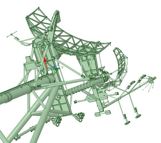

Your forward tripod mast looks good - I drew up this mast in 2D CAD quite a few years ago and then last year did some revising to small details prior to designing the whole mast in 3D for eventual 3D printing. I had the 1968 BoGP stbd profile of the ship to go by and I can't recall now the angle from straight up that the mast sits, but it is somewhere between 5 and 15 deg. Here is the side view of my 2D CAD drawing:
From this I developed the 3D design and here is the result -
This is actually two parts, the lower mast and upper mast. It does not include the yardarms. And here is the printed lower mast, it took approx 5 prints with modifications along the way to get to this point -
The final version does include the yardarms. The upper mast I have printed (3 copies) and will eventually get it cleaned up and off it's printing supports and mated to the lower unit.
More than likely all these tripod masts were basically the same in structure, but had different instruments/RADARs/antennas depending on the ship, etc.
Keep up the good work!!!

PostPosted: Wed Nov 30, 2022 8:59 am
Posts: 3106
Willie wrote:
Quote:
Hank, I cannot see the lower part of the upper mast in your "black" plan. You should check it is correctly printed; otherwise, it is very easy to add a piece of sprue, and you won't need to print a new mast.
Willie,
Here are a couple design file shots of the underside of my tripod mast assembly. Originally, I had drawn several 2D views of the mast when I was designing it years ago (side elevation), front elevation, bottom view, top view) but have since given up my 2D CAD license so no longer can access those design files. I may or may not have made screen shots of those plans but have since thrown them out after the 3D mast was designed & constructed. So, here is what my mast looks like from the underside:
144 scaled DD566 Underside of Tripod Mast Lower Platform_1.JPG [ 109.85 KiB | Viewed 1021 times ]
144 scaled DD566 Underside of Tripod Mast Lower Platform_2.JPG [ 56.45 KiB | Viewed 1021 times ]
This assembly includes just about everything that will go on the mast except for some small instruments that are glued to the ends of a few small rods here & there. This also includes the wave guide for the AN-SPS-6 RADAR mounted on the lower platform and down the stbd side of the front tripod leg. As I mentioned prior, I printed my mast in several parts so these screen shots are of a composite of those parts all in one file "assembled".
I know it's rather complicated to view, but that's the best I can provide at the moment. I hope this answers your question. Also, 5° on the mast rake sounds about right. One other note - I used a scaled print of my 2D design when I drew up the 3D parts and overlaid the 2D printout with the 1968 scaled copy of the BoGP on my light table to ensure that the mast had the proper rake, size, etc. etc.
Anyhow, your mast is coming along nicely - each of these will be somewhat different in their final form.

So, this is it for now. I hope you like it and very best regards from across the seas,
Willie.
PostPosted: Sat Dec 10, 2022 2:29 pm
Posts: 5060
Willie!
A clever solution to a 3 dimensional issue. Working with styrene has some advantages, in comparison to 3D printing. The thin styrene sheet is smoother and crisper than an equivalent printed piece and probably stronger. The main disadvantage is requiring assembly from a plethora of small pieces. The tripod mast on my Missouri is from Styrene and complicated by having many crossbars and diagonal braces. Your round head solution was quite good indeed!
Best wishes! Tom
