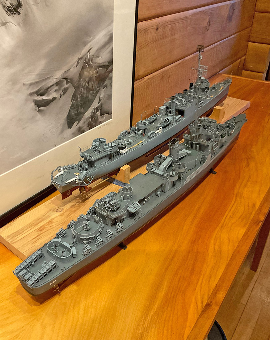

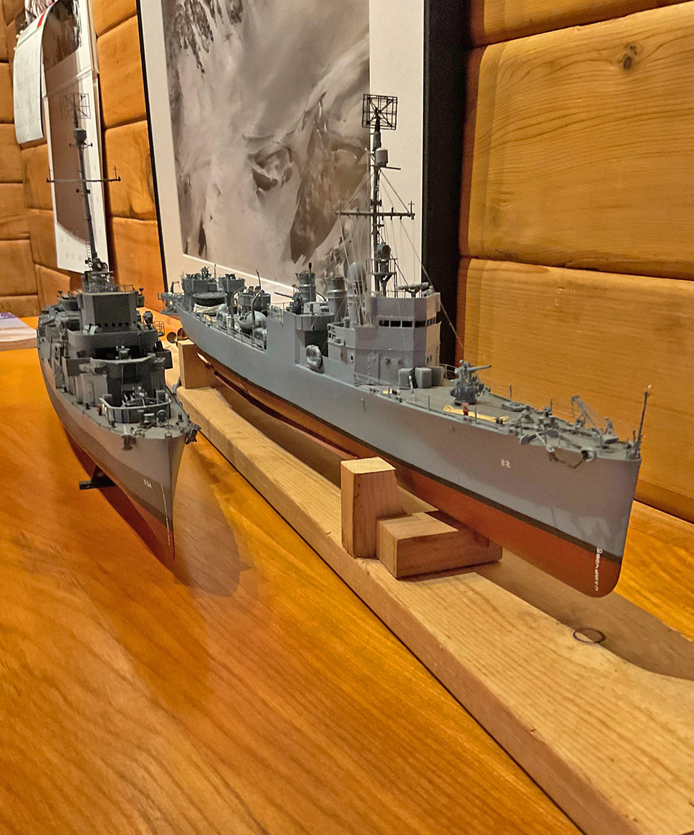

Whitehurst and Caine alongside. Both ships within a small dimension of equal length. Whitehurst still lacking cable spools, lifelines rigging and small errata. Probably not much accomplished over the next little bit due holy-daze and guests.

Tom,
That is a very cool display!! Its an excellent side-by-side comparison; very well done.
Bravo Zulu Shipmate.
Any ideas for the next ship to add to the comparison?

- Posts: 5068
Re: USS Whitehurst One to who knows DE.
Thank you Bruce! Caine still needs a more official base. Quite notable how much larger her props are to use all the additional horse power.
I just like to look at them even if not finished.
Cheers. Tom
Cheers. Tom
Tom,
Well, very fine looking pair of tin cans side by side!!!
Quite an interesting contrast between the two. You've done an outstanding job, as usual!!
- Posts: 5068
Thank you Hank:
Caine was my first printed hull and the 144 scale was somewhat determined by what was a reasonable size for printing and a convenient model size. I did dither about maybe doing Whitehurst in 1:120, a scale I like as I can approach the excellent 100 and 96 scales in what I can do. However practicality won out and it's nice to have a pair. Actually they could be displayed in a single case? Our design program is not optimal at all for hulls, but it can be done with a few warts here and there. A little Zen and magic involved at the best. It is very good for most other ship parts: Anchors, weapons, chain, even masts and spars.
The Holy-Daze are not a good time to get much modeling done, guest, travel and general personal itercourse with family and friends.
Lifelines, spools and rigging, all on the watch list at the round tuit as well as the Christmas Mail Buoy.
