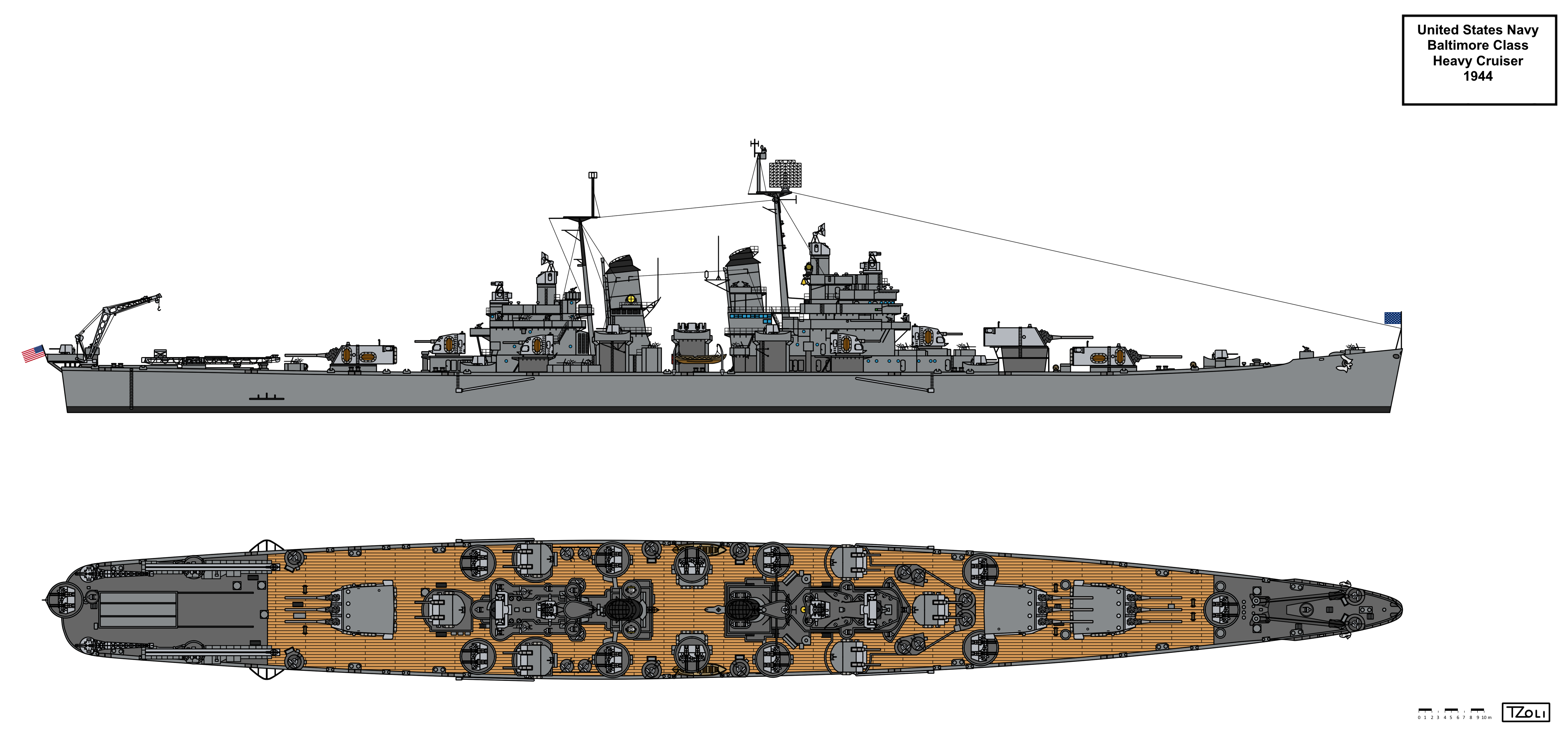

Here are my drawings of 4 units of the classes:
CA-68 USS Baltimore as looked like in 1944/45:

I hope they are accurate.

TZoli,
Excellent! Thanks! I think it helps with the colors.

The stern of the Macon should look more like that on the Rochester, with the off-center hangar hatch and more rounded deck. In the late 1950's, she even had the starboard side twin 3" mount on the stern. That was removed in order to install a Regulus missile launching system. The mod included sponsons for the launch and changing the hangar hatch to slide sideways, as seen in this shot of the Los Angeles: https://www.navsource.org/archives/04/135/0413506.jpg Only the first 4 Baltimore's, with the two cranes, had the more square stern. The switch to the single crane caused them to round off the corners of the stern at the deck level in order to help hoisted aircraft avoid bouncing into the corners of the deck. Ironically, when the twin 40MM were installed there, it negated the benefits of rounding the stern. The waterline remained more squared off, giving the complex contours characteristic of the later Baltimore's, the Oregon City's and the Cleveland variants. The off-center hatch also was part of the "round stern, single crane" mod starting with Pittsburgh.

The round (a circular arc) stern at main deck level and square (ish) stern at the waterline is something that some modelers miss.It is tricky to model.

This rounded deck configuration is unusual in that it (for a USN ship) incorporates a degree of tumblehome. I hadn't noticed this before but the aircraft handling considerations with the single crane make sense, this would have also reduced top weight a little. But then of course the light AA considerations in the final event overrode the aircraft handling niceties.

As I recall the Baltimores didn't have tumblehome along the sides, but there was some from the "corners" of the square stern at the waterline and the founded main deck level.
However the Clevelands were (re)designed with tumblehome. After the Navy increased anti-aircraft guns and armor protection the ship was unstable. The contractor (New York Shipyards) proposed widening the hull at the waterline, producing tumblehome, and improving stability. Tumblehome was unusual in US Navy ships.
