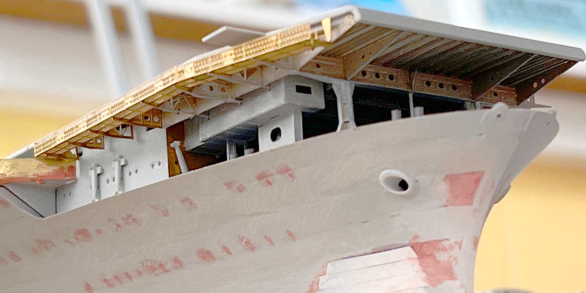

For some reason, I was quite eager to see the degaussing cables go onto the kit. After much ado, here it is. It went on fairly easily. I bent it at the ends to follow the curve of the hull, and used a bunch of little pieces of tape to tack it into place. Once I was happy, then I glued it down. There's a gap where the hangar deck catapult sponsons were, and I plan to fill that with the unused bits of the degaussing cable from the kit PE parts.
Another milestone is that the fore 5" gun galleries are glued in place. It took a fair amount of persuasion to get them in, but they're in, puttied, filed, sanded, etc. There's still a little of the putty-n-sand to do, but they're pretty much done. I've also added the catwalks around the front of the flight deck, and the flight deck still fits! This time, I did all of the work with the flight deck on the kit and everything inverted, thus adding those parts wouldn't affect the fit of the flight deck.
But all is not sunshine and lollipops. There are a few tricky problems to fix. More on that later.
Mike
