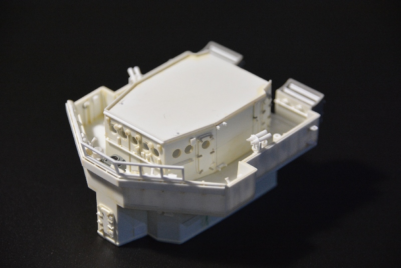

Nice Work Willie! It seems a WWII vintage constructed ship isn't complete till there is hardly room for the virtual crew to move about. Certainly this was true for the ships that I have constructed. Good work especially on the radar repeater, many of these items wouldn't have survived if left on an exposed bridge. The original Fletcher pilot house is quite small and the expansion into what in Alaska we would call a Wannigan (Somewhat impromptu add-on) for overflow equipment. Surprisingly the pilot house for an Essex class carrier is just as small! On a modern vessel the commander is privileged to have some pacing room, as with the lords of the quarterdeck of days of fighting sail.
My Whitehurst has a very complex multi level open bridge and there ate enough data points to do a reasonable job of simulating all of the instruments. More like an airplane than a ship! Work to do...
There is a pleasure in doing some hidden interior detail, my Poseidon has a decked out bridge and radio and navigator compartments have some detail as well. These would only be accessible if as a miniature sailor you could access through he open bridge doors. The O1 level below also has all the bulkheads and passageways though not accessible. Many decades ago the PSNS Shipyard museum had a 1:48 scale Essex class carrier from plexiglas, with all interior compartmentation.
Always good to push your capabilities!
Best regards: Tom
Best regards: Tom

Willie,
Excellent work on the bridge details!! Your repeater is much more intricate than the commercial item that I bought - as it's already installed, I'll live with it. However, yours takes the prize!! As always, 1st class effort.

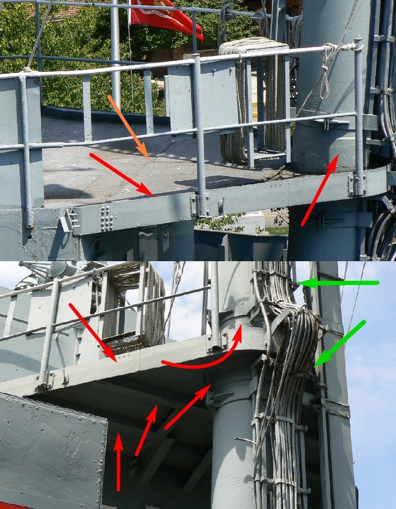

I do notice that Rick's above photo of the bridge has the early frames sloping backwards. I can see where the forward sweeping frames allows a better view of what is going on close aboard.
Thanks Willie and all for an educational project and jut another Fletcher, of which there were so many. Just how many destroyers have ever made a night torpedo run agains an enemy Battleship!

Hi there Hank, Tom and all,
Thanks very much for your remarks. My pleasure to share in this forum with you guys.

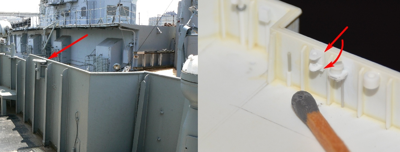

And as I was not sure what to do next, I decided to finish the binoculars in the bridge wings. This is what I already had in store: The following was just to add the yokes, and a strut base with a tube ring. And then to (more or less) replicate the fixing of the set to the bulkhead, that I made with small sections of 2.00 mm. Evergreen angles: With this, the binoculars have a revolving movement at no price in effort. My fat fingers have limits, these pieces are very small, and I had to oversize some of them, but once with everything in position, the overall effect is more acceptable: And @Tracy: reg. what we were talking about yesterday, here is a further finding that allows to confirm that what I did in the bridge is at least 50% acceptable. This time I was lucky, and in the same picture I can see how to link the canopy elements together. Wonderful. Nice going to all of you from across the pond,
Willie.[/size]
Good eye. I had noticed the canvas canopy, but not the backwards inlination of the frames.Fliger747 wrote:I do notice that Rick's above photo of the bridge has the early frames sloping backwards. I can see where the forward sweeping frames allows a better view of what is going on close aboard.
Always my pleasure, Tom, but I am afraid it is you folks who instruct me with the large amount of info you have always provided me with.Fliger747 wrote:Thanks Willie and all for an educational project and jut another Fletcher, of which there were so many. Just how many destroyers have ever made a night torpedo run agains an enemy Battleship!
Not many, definitely.Fliger747 wrote:Just how many destroyers have ever made a night torpedo run agains an enemy Battleship!
Willie.[/size]

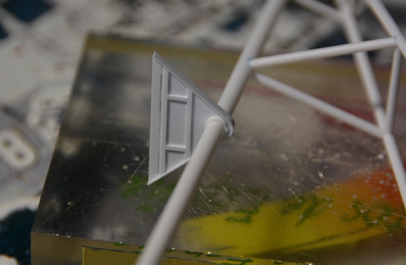

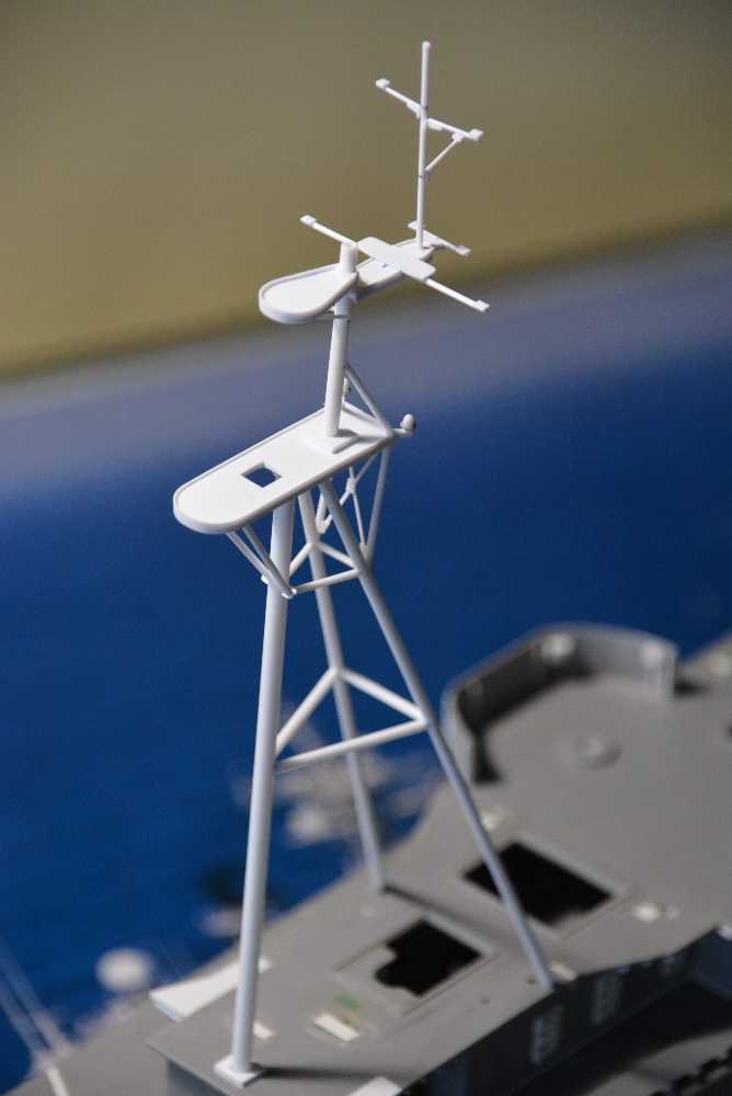

Hi all friend modelers again.
Next step was the main mast again, to build the cross bars, so that I can go on with the rest of structures and fine detailing.
This is the main thing to build. As it can be seen, the cross bars are not uniform at all, and as the main mast was made with 3.2 mm. tube and 2.00 mm. rod, I found a compromise with cross bars in 1.6 and 1.2 mm. rods.
With so long elements I had to make a kind of scaffolding first, setting the mast in the upward position and adding strips all around, so that the three legs did not move at all. In the heat of the operation I forgot to make a picture of the whole scaffolding. This one was made when the strips were removed in the most part, but it gives an idea of the otherwise very simple process. With all the strips gone, the glue markings were deleted with fine sandpaper, and there are no marks at all.
The mast looks now really good. The cuts in the bars had to be very precise, following the rake of the three legs. It took some time and some rod sections wasted, but it was done in due time with no further problems. Nice going and best wishes from across the North Atlantic,
Willie.[/size]

Willie,
Your tripod mast looks excellent! Good work, as usual! The cross members are a bit tricky to get correct, in spite of being rather simple tubes. Once again, these were not a std. design as there are a couple variations of the basic mast. CASSIN YOUNG and THE SULLIVANS do not have identical masts - each varies somewhat in the basic structure. I think this was due to the type of RADAR unit that was intended to be installed and also (again!) shipyard preference in final engineering/design.
Nice to see your recent progress!!

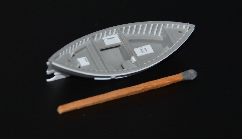

As I am bogged at the moment with the wiring on my mast, I have devoted some attention to the motor whaleboat. Hank sent me some months ago one of the redundant whaleboats of his 1/144 WWII Revell Fletcher. This model was actually one of the two described in AOTS The destroyer THE SULLIVANS, by Al Ross, pag. 117, the one without canopy, that is apparently the one that the sister ship Alcal� Galiano had onboard. This one : Revell's whaler is very basic, really crude, but the general lines are aceptable. Firstable I had to delete the motor canopy and open the deck to make room for the operator, and then to make the motor itself.
This whaleboat motor had a canopy that was not simmetrical, this one: Once I had the information the canopy was no problem at all, as I had to use only some Evergreen scraps. For the detailing I could find one single picture, this one: So I had to adapt the details, to make this: The next step was make the rear section with the shaft and the supports for the rudder to form a curved line. I made this with three elements welded together with Revell glue (very thick) and then filed and sanded to the right proportions, and then more sanding to put the adition level to the rest of the keel. After this I had to make a screw, simply a section of rod filed and sanded. Then I added frames, hatches and some other small stuff, to give the thing some more detailing. Very easy. [/size]
Hank, my pleasure that after all the help I have always had from you I have been able of being of some help for you too.
Tom, this solution sounds really interesting. I would naver had thought of a mst in sections. It means that there are not big problems, but great solutions.Fliger747 wrote:For Whitehurst I ended up making the mast in three sections where it penetrated the decks and the hollow sections aligned by the interior piano wire. Part of that solution was dictated by the vagaries of 3D printing as opposed to styrene construction. The pole masts of the WWII DE's were tapered at both ends as guy wires were an important part of the support. This was an advantage for 3D technique in that case.

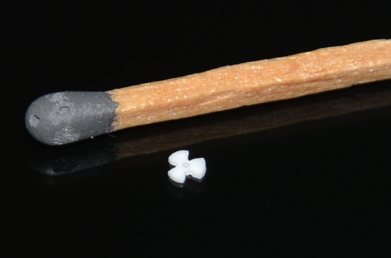

I don't want to glue the rudder and the screw yet to avoid potential damages with the masking tape when painting. As for now the thing is like this at the moment:
I hope you like it, and very best regards from this side of the Atlantic,
Willie.[/size]

Willie,
Nice work on the 26' MWB!! I noticed that you have added frames on either side of the inside of the hull - this would be consistent with the boat as shown in your photo #1015, but only partially exposed. I can't explain this as the same boats in our navy had the framing covered, at least as far as I can tell by a photo of our 26' MWB on NEW JERSEY, the photo taken during her rebuild in Philadelphia in 1967-68 - Here is basically the same type of boat shown in 1943, belonging to CV-10 - My guess is that the framing was covered by the 1950s, but that's only a guess. I know STODDARD's 26' MWB was identical to the one on NEW JERSEY and both those boats no longer had exposed hull framing. It could also be that there was no consistent std. for how these boats were refurbished when they were brought out of reserve fleet storage.
I'm only pointing this out in order for you to have some pictorial reference to other similar boats. Since McGOWEN was transferred from the USN in the mid-60s my guess is that her boat may also have had her interior hull framing at least partially covered by that time. I searched thru the few photo I have of STODDARD's one wooden 26' MWB but they don't show the interior of the hull.
Your details, as usual, are over the top - very well done!!
