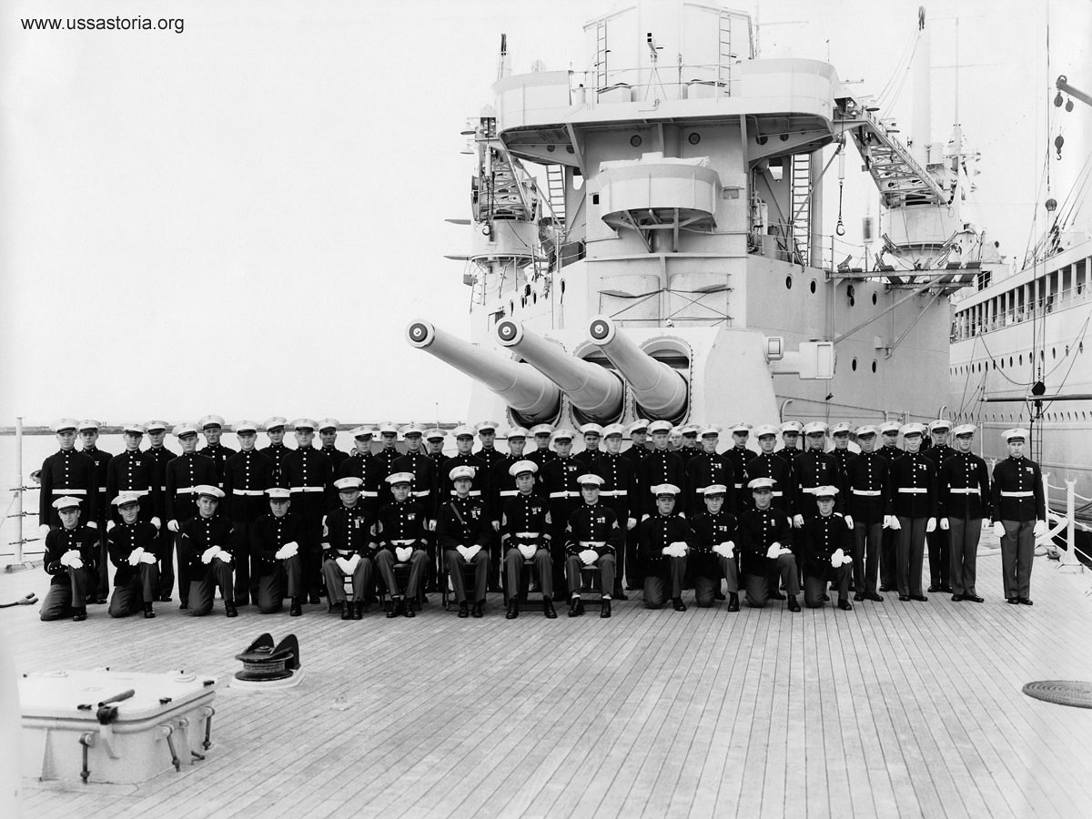

I agree about the ladders, that would be a logical place. Just cannot find any photo showing them there.
I mean the range finder covered with canvas on this photo. Thanks!
19350000 circa USS Astoria CA-34 aft deck rangefinder platform ussastoria.org.jpg
At works: USS Astoria CA-34
Vladi
Posts: 810
Location: Czech Republic
Re: Calling all USS New Orleans class (CA) fans
Post by Vladi »
Sorry for not expressing myself clearly. I am trying to find out what that range finder looked like .
