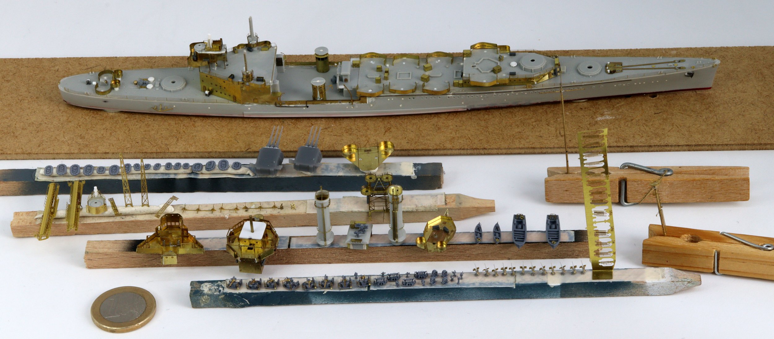

Some more work done although no updates posted in the meantime.

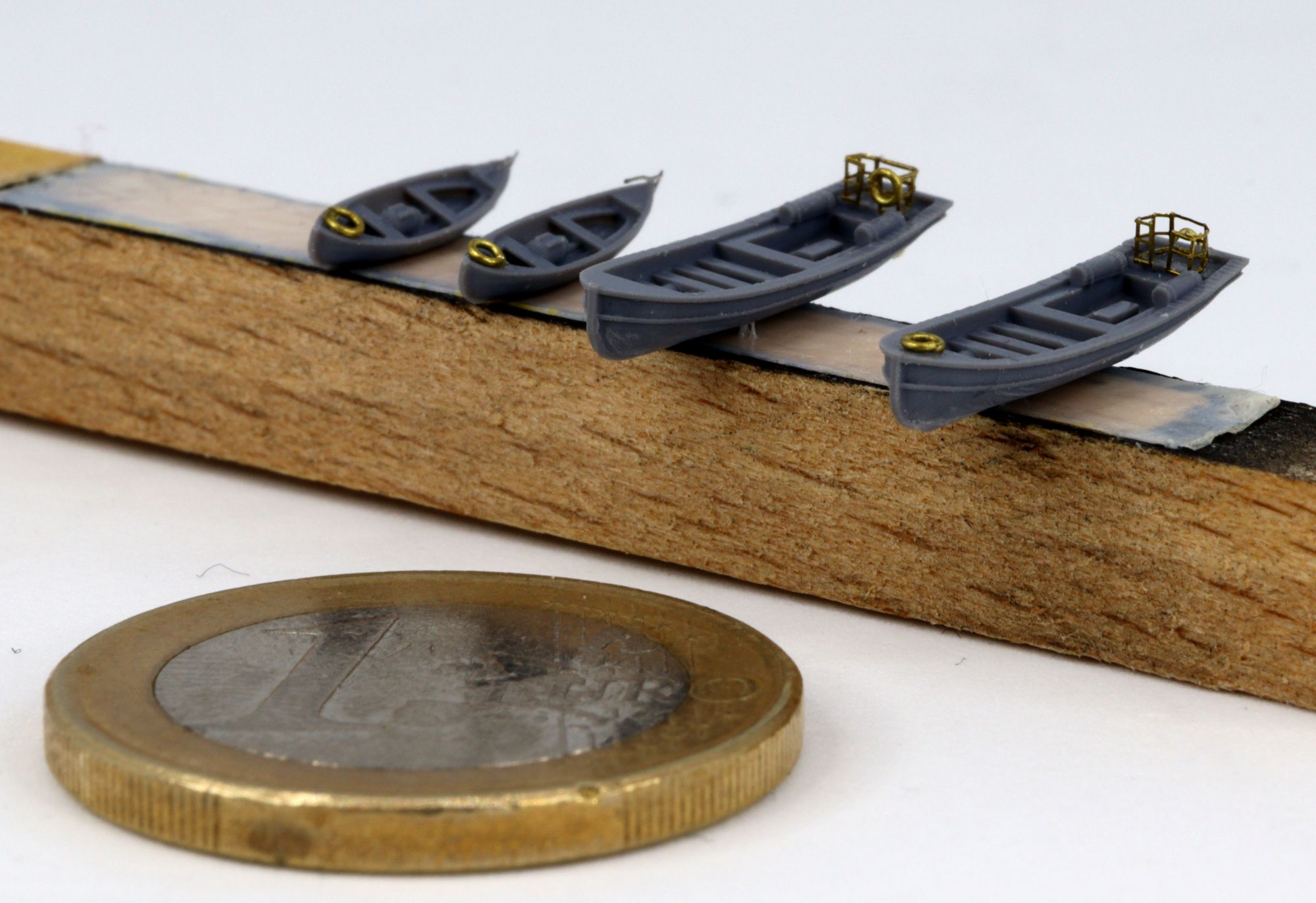

Motor boats
Two 40ft motor launches and one 26 ft whale boat were located on the hangar roof of Astoria in July-August 1942. Maybe this was the whale boat originally found davits on the port side of the well deck?
I used the awesome Shelf Oddity boats, in case of 40ft launches with my PE rudders and railings. It turned out I forgot to address rudders for the 26ft boats so I adapted those provided in the GMM USN cruisers sheet. Life rings were made from 0.3mm brass wire bent over 0.5mm rod.
Getting ready for airbrush!

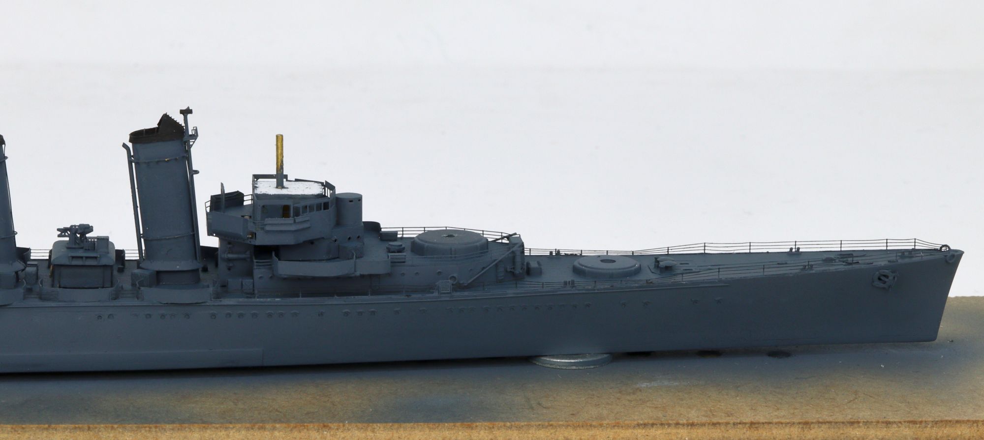

Hi all, my Astoria build has been on hold for quite some time as I put more priority into finishing USS Wilson last year and then into my Australia project. But now it´s time to move on with Astoria, too!
Just after spraying her with the gloss coat and adding decals of hull numbers and the ships´name I realized I totally forgot I wished to add hull plating! My original intention was to create the plating using a masking tape and airbrushing Mr. Base White but for whatever reason I forgot to do it before painting the hull. So I was in a situation when the paint was there so using my usual method would mean doing it all once again, with an added danger of overspraying the base coat to where I didn´t want it, adding too much layers to the delicate railings etc.
What to do? I considered masking the plates and spraying more gloss coat but I thought there was a danger of messing up the build. So what about using a clear decal? I draw the outlines of the hull plating in Inkscape and printed them on a printable transparent decal paper. Then I applied three thick layers of Tamiya gloss clear with a brush to gain some visible thickness (how often do you want it to be visible :heh: ). The next morning I cut inside the printed lines by Exacto blade and applied the decals over the hull. Some corrections were needed so I removed them before they set. I also found out that using a decal softener should only be the very last step to get out any remaining air bubbles, otherwise it can ruin the work. The second attempt already turned out quite satisfactorily. It actually seems this method provides a crisper appearance of the plating than spraying over the mask. The obvious disadvantage indeed is it only works if there are no portholes or other details on the raised plates, so I had to just miss the prop guards and the open portholes on the bow.
I´ll continue with weathering the ship in my usual way using artistic oil paints. Let´s see how will it look like when the next steps are finished.
Agreed. Nice adaptation, Vladi.

Thank you, Dan and Martin! Actually I started thinking about using this method on my future builds. I just hesitate at which stage it would be ideal to do this (in a planned way, not as a last resort like in the case above :) ). The catch is what if the ship was camouflaged, e.g. USS Vincennes in the Ms12 splotch camo, that one would like to use masking tape for. If the hull plating/decals are applied first, which is what my conservative part is suggesting, I´d be concerned about peeling of the first coat of paint - or even the decal! - while removing the masking tape. Using a matt coat for the decal instead of gloss may be an option how to improve the adherence of the paint. The other possibility is to do the painting first, exactly as on the Astoria. Vincennes even had less portholes so less area to avoid. What are your thoughts?
PostPosted: Thu Aug 29, 2024 9:47 pm
Posts: 8816
I'd also be concerned about the peeling of the paint with a mask, unless the adhesive was very light. Don;t know if that's a possibility.
Painting first - well Astoria certainly looks nice.
You may have to experiment a bit with a hulk hull.
PostPosted: Fri Aug 30, 2024 1:56 am
Posts: 765
Location: Czech Republic
Thanks for your comment, Dan. I found one reason against the paint first method so far: possible yellowing of the decal in the future. Let's see.
