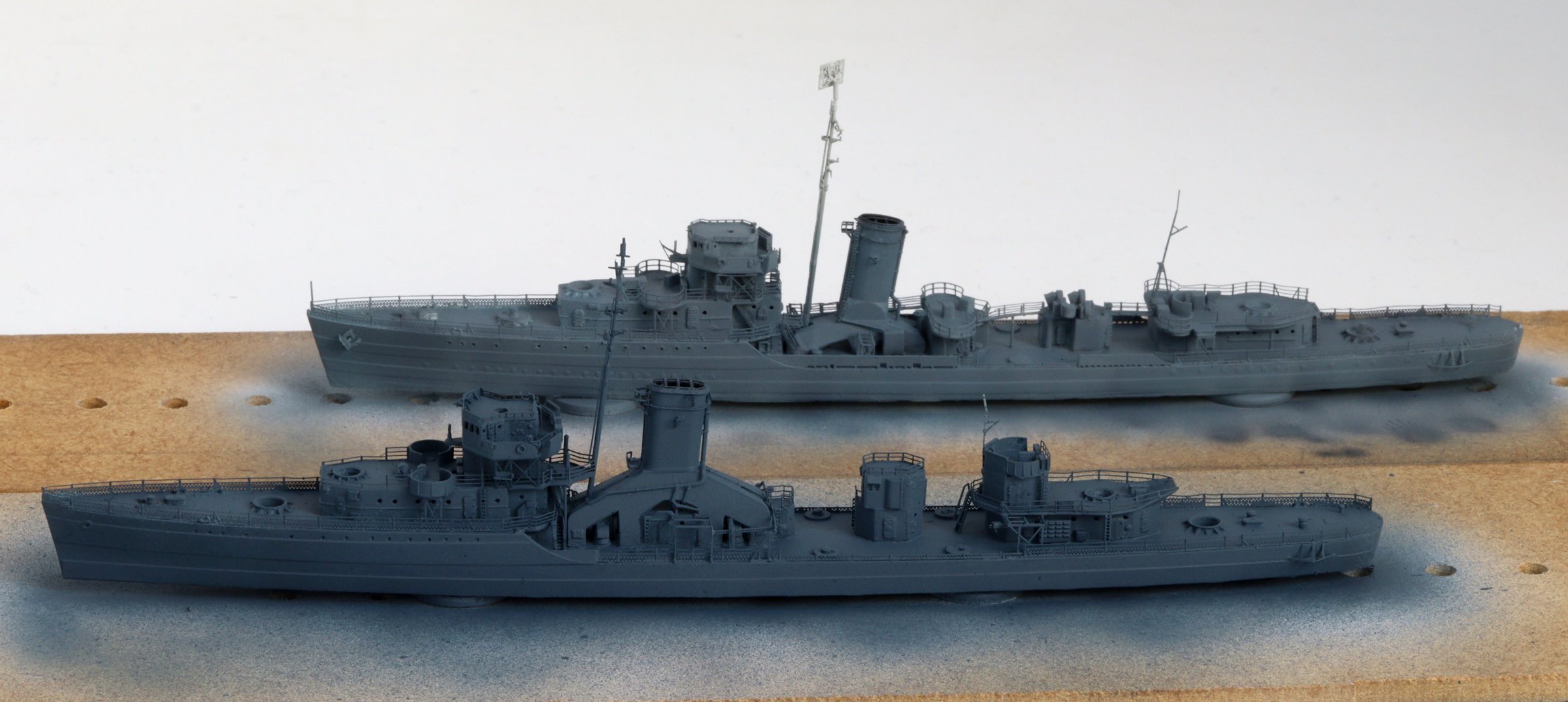

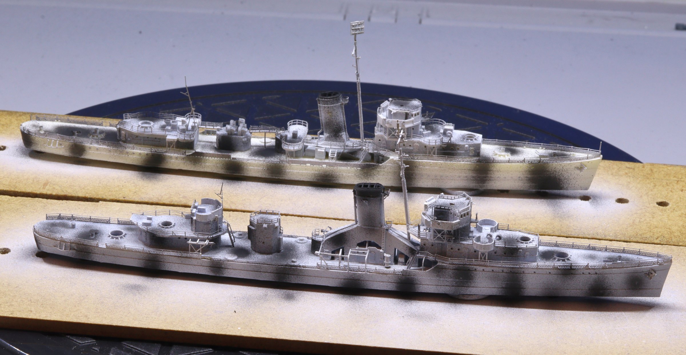

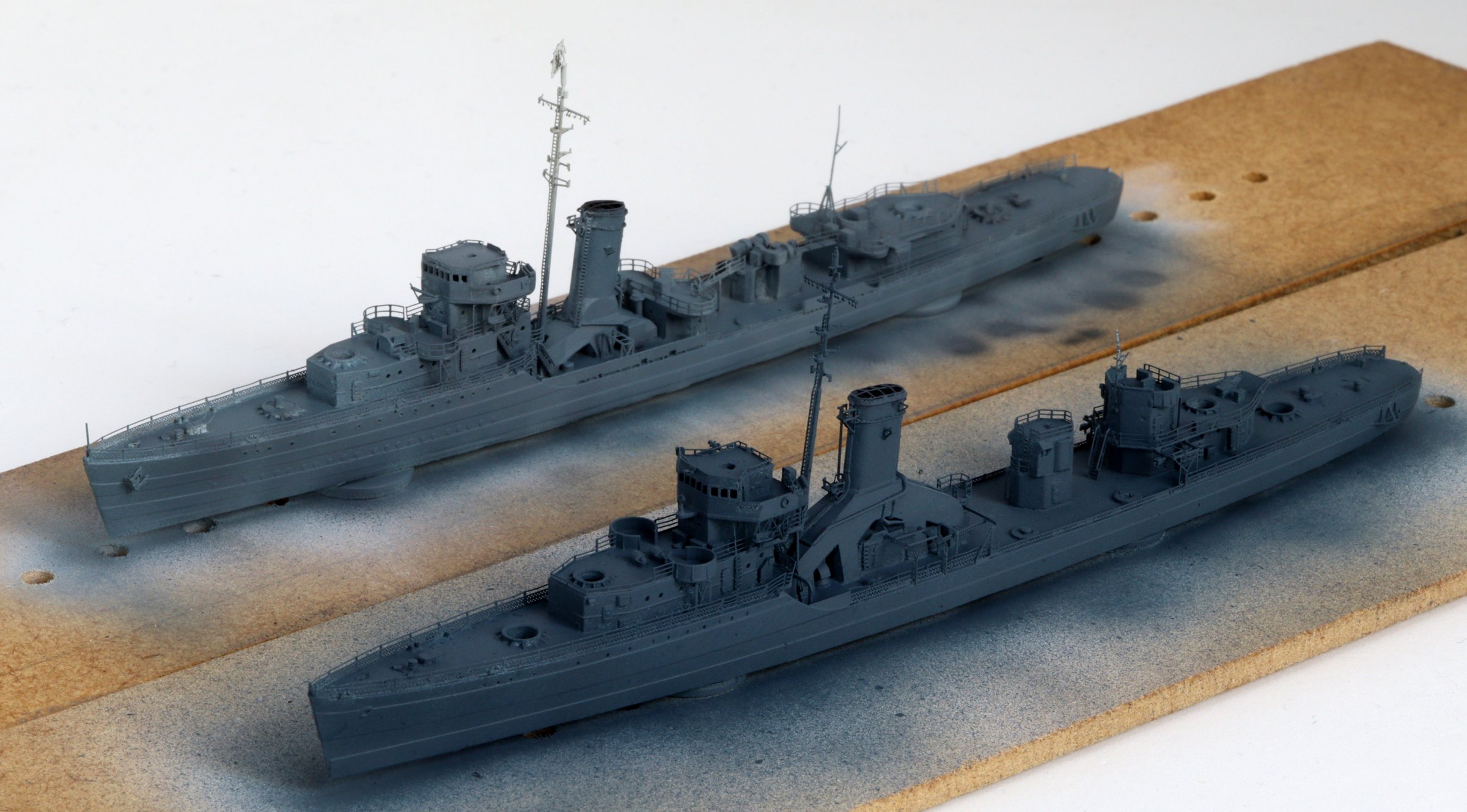

My first ever attempt at paint modulation. Worked out as expected on the Wilson (in the background) in combination with 5-O but unnoticeable on the Patterson in 5-N.

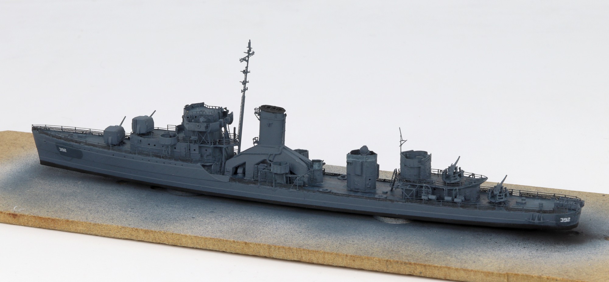

Re: 1/700 USS Bagley & USS Patterson at Savo (Kraken & Vladi

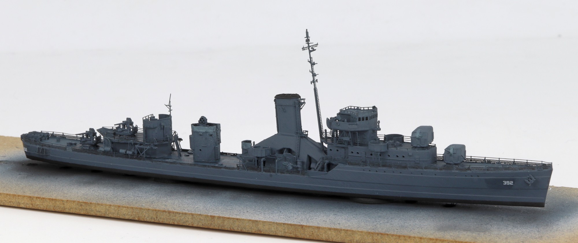

Done some work on the Patterson in the meantime but the progress was rather slow. Now comes a longer update to sum it all up.
Painting dilemmas
What dilemmas can there be at something so straightforward and simple as Ms21? Well�

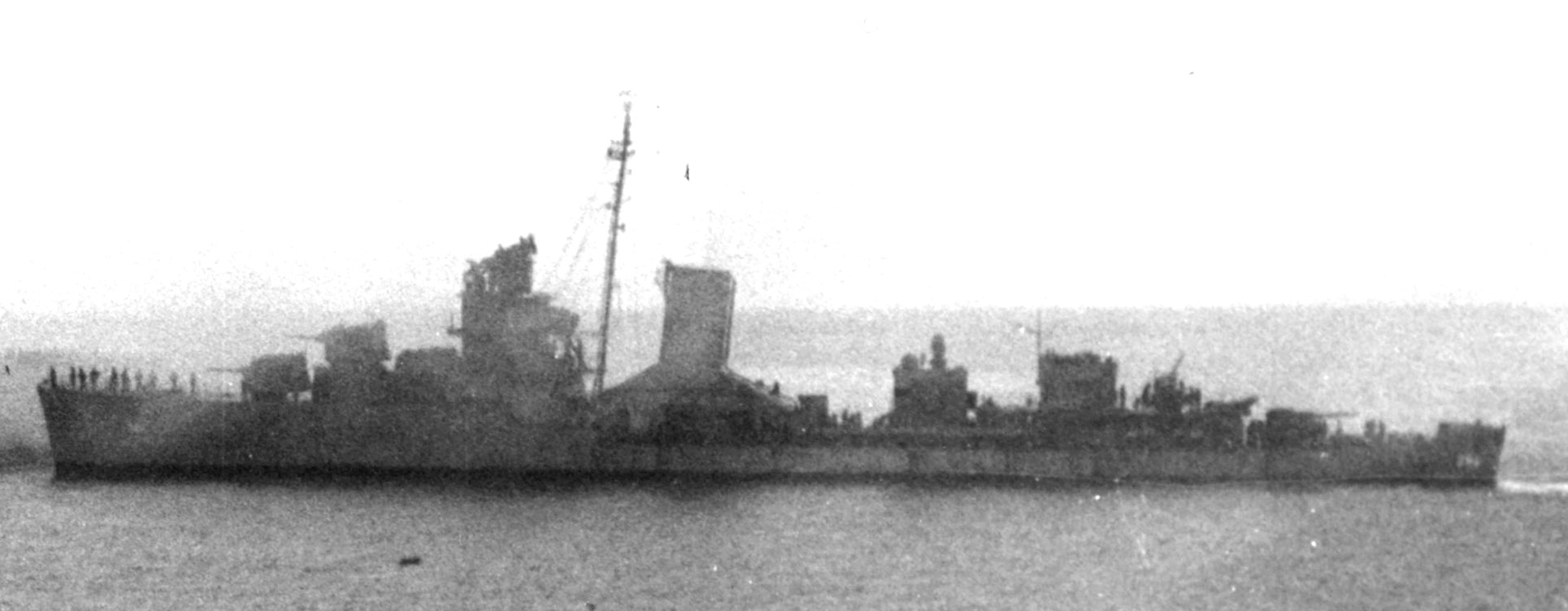

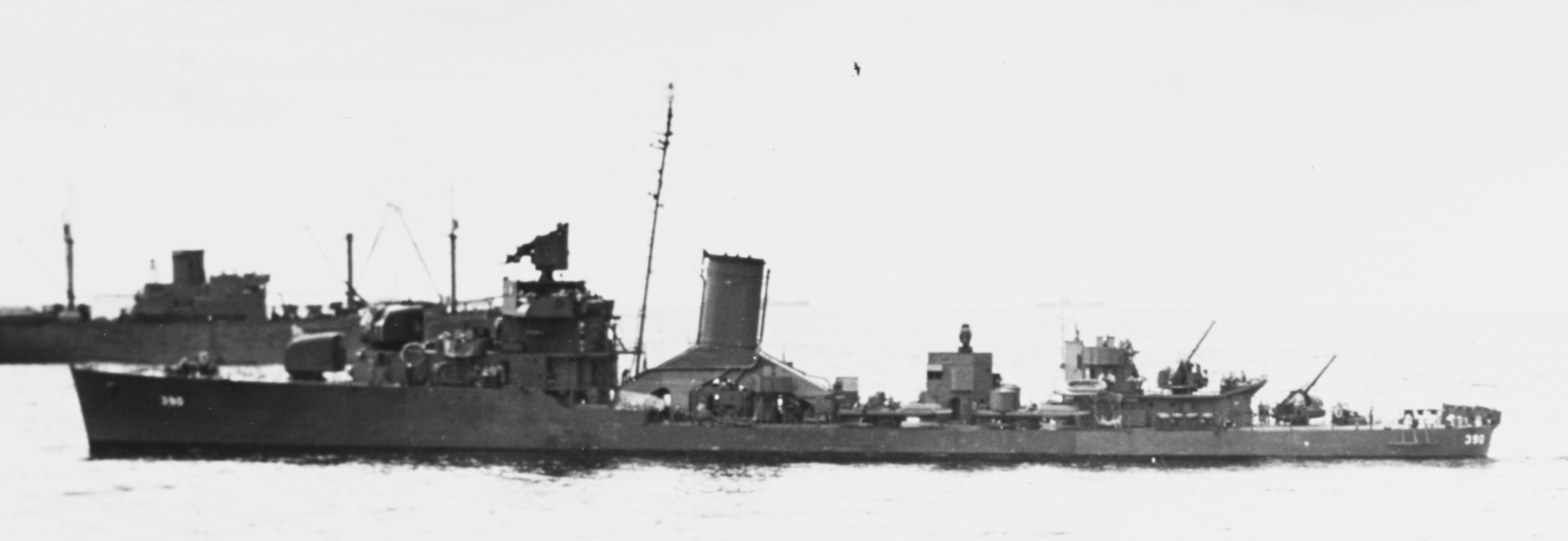

An interesting item popped up while I was painting the deck of the Patterson: looking at the numerous photos showing class members from above, it seemed to me they had not painted anything else than their decks with 20-B � turret tops, Mark 4 radars, sloping funnel uptakes and torpedo tubes show no hint of demarcation lines between 5-N and the horizontal (or sloping) surfaces. I discussed it with Rick and Matt and several interesting aspects came out. First of all, 5-N and 20-B were very close in color, the main difference was their purpose. This makes them really difficult to be told from b&w photos. 20-B was intended for the decks so it was designed to better withstand foot traffic. Most importantly, it was up to the crew/CPO/CO to decide how every part of the ship will be painted. Since e.g. the tops of the 5-in mounts saw little foot traffic, it might have been �common� practice to paint the whole mount with 5-N if in Ms 21. So this was my choice in case of Patterson. Another question surfaced when trying to establish the color of the canvas wrapping on railings atop searchlight tower, aft of funnel and also blast bags on mounts 51 and 52. Mare Island photos from May 1942 show them all unpainted on Patterson, in natural color. The photo showing Patterson closing HMAS Canberra to help removing her crew on the morning after the battle is not really conclusive but the searchlight tower canvas appears more like (faded) dark then light. Her sisters during or shortly after the Guadalcanal landing operation show both options were used, sometimes even combining light blast bags with dark railings coverings as seen e.g. on Ralph Talbot on August 7th, 42. The Bagley class comparison table was updated to include these features. I decided to stay with faded dark canvas for Patterson in the end, although I realize this is quite questionable. I wished to try a different method to mimic the canvas wrapped around the top of the searchlight tower. Usually one would use diluted PVA glue that fills the voids between railings for this purpose, that�s easy and quick. However I noticed that Patterson�s canvas was stretched quote taut. So I used thin aluminium foil which I painted with the relevant 20-B paint and then attached to the railings using PVA glue. I had much more control about how much I wanted to depict the sag of the cloth by pushing (or not) the foil against the railings. BTW the production version of the PE sheet will include two versions of these railings, one �open� and the other one �covered� with canvas.
The following photos show the status quo of the Patterson, still without her main director, radars, torpedo tubes, boat and davits, life rafts, oerlikons etc. Decals have been applied already (therefore the "darker" areas of gloss coat around hull numbers) incl. rubber pads and non-skid walkways on the deck (last pic). The deck was slightly weathered as it is becoming less accessible after some parts are installed, but the ship is waiting for her overall gloss coat and weathering of most of the model.
Painting dilemmas

Looking good Vladi. I really like what you did with the foil for the canvas dodgers. Though, I wouldn't put too much stock in the fact the canvas was unpainted in the shipyard. That would probably be the last thing they'd paint, or perhaps the crew would paint them after they left the yard. But I would think they'd most certainly be painted and not left their natural color, as was spelled out in the camouflage orders. Leaving a white/tan canvas unpainted is a lot different than not painting the top of a turret 20B.

Thanks for your feedback, Martin. I�ve been thinking along the same lines (in case of USN), but there�s evidence it has not always been the case that the canvas was painted. There are not that many clear photos of Bagley-class members "in action", but there are definitely a few that show light-colored (unpainted) canvas while underway. Just three examples from around the time of the Battle of Savo Island:
These are actually very helpful in identifying Bagley-class members as they appeared quite similar to each other at that timeframe.

I would think that, sometimes, a worn dodger has to be replaced prior to any dockyard visit, from possible spares. Maybe from a tender. So there could be any number of reasons why it wasn't painted at a particular time.

I confess the reason I chose faded dark dodgers for Patterson (in the given uncertain situation) was to make her appear another bit more different from Bagley that I still plan to complete later

Each USN ship had a supply of canvas so they could replace worn/destroyed canvas (Bloomers and railing covers being the primary uses during WWII and as awnings in peacetime) and it was expected that they would be painted as required. There are plenty of images of ships with "natural" canvas or painted canvas at some point in time and maybe even a mix of the two on a ship.

Made some good progress on USS Patterson in the meantime
It can be also noticed that the national flag is missing. I�m using a white decal paper on which you can print on a laser printer. But the flag measures out to approx. 1.7 mm in height in 1/700 and that's almost impossible to print clearly. However, the most difficult turned out to form such a small decal into a "flying" shape. I�m using a piece of aluminium foil as a base to which the decals are applied from both sides, using Mr. Mark Setter to soften them up. I had some 2mm high flags for test, but the decals keep breaking
Any suggestions welcome!
- - gloss coat applied
- weathering using artistic oil paints
- added remaining details: 20mm oerlikons, life rafts, main director, radar antennae, TBS antenna, whaleboat and davits
- added rigging according to photos
- sprayed matt varnish overall
- added sailors across the ship (I still plan to add a few more)

Destroyer USS Patterson DD-392, Battle of Savo Island, Aug 9, 1942
�WARNING! WARNING! STRANGE SHIPS ENTERING HARBOR.�
This famous signal was issued by USS Patterson�s captain over TBS just after sighting a Japanese cruiser at 01:43. Commander Walker�s next order to fire torpedoes was unfortunately overheard in the noise of 5in gun as Patterson fired a starshell. She then got involved in a gun battle with Japanese light cruisers Tenryu and Yubari, receiving a hit aft. With two aft guns disabled and a large fire started, Patterson drew blood at the Japanese side, too.
My model shows Patterson after executing a sharp turn to port and aiming guns and torpedoes to open fire on the enemy.
This was my first fully 3D printed kit (except PE parts of course) and it worked very well for me. The 3D printing lines on the hull remain faintly visible on close inspection of the starboard side in macrophotography, next time I�ll try to sand them down slightly and/or use a heavier primer. These cannot be seen by the naked eye though.
The research phase was really interesting. The level of available photographic evidence varies by Bagley class members but the characteristics of each ship came out quite clear as seen in Bagley-class destroyers � Differences as of summer 1942.
