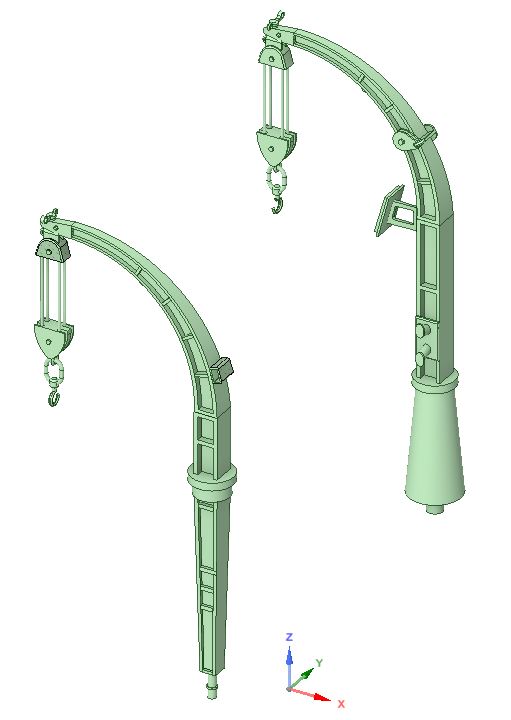

While Tom F. was working on his boat davits for WHITEHURST, I decided to do the same for STODDARD - I have 3 sets of davits (kit, Shapeways vendor (2)), but decided to try designing my own as these are all somewhat different than the davits on the 1960s era FLETCHER class DDs. So, here is a design shot of my fwd. & after davits -
I still have a few details to add and then to scale to 1/144 (these are designed at 1/96 scale) and do a test print. One issue I have with the older Shapeways products is the use of very brittle resin which makes their parts very fragile.

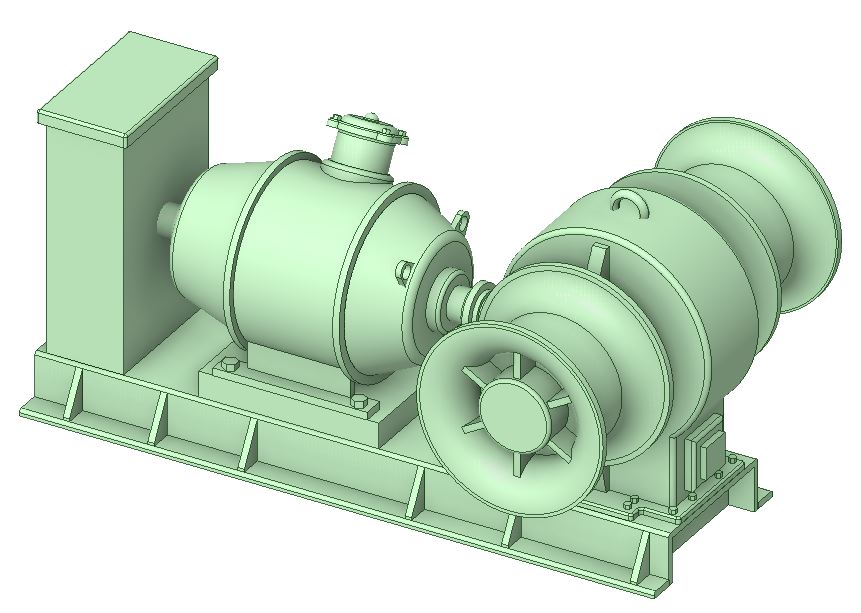

With the davits completed (essentially what I posted earlier), I decided to tackle the boat winch, even though I have the kit version and a Shapeways vendor version - neither of which really seemed detailed enough. So, using the FLETCHER Plan Book, the BIW Assy drwg for the winch, and a couple vague photos of the winch in the 1960's, I came up with what might be a slightly more detailed version -
I am going to print this in 1/96 scale and also 1/144 scale with the davits and see how they come out. I've just received my new supply of resin and am still trying to obtain the correct printer settings for these resins, so actual printing may be delayed a few days.

Hank:
For my DE the davits both have the large tapered base which provides a strong attachment for the davits to the deck. For the Fletcher's that aft davit looks as if it may need to be guyed unless the fixed base is supported by the bulwark? On the DE the bases were somewhat incorporated into the bulwark which adds a lot to their stability. Making them as two pieces such that the upper can rotate seems to be quite satisfactory. I am sure that in the end you will come up with a clever solution!
Regards: Tom

Fliger747 wrote:Hank:
For the Fletcher's that aft davit looks as if it may need to be guyed unless the fixed base is supported by the bulwark? Making them as two pieces such that the upper can rotate seems to be quite satisfactory. I am sure that in the end you will come up with a clever solution!
Regards: Tom
:doh_1:
NOW you tell me!!!! Actually, I hadn't thought of that (making the after davit rotatable), so that might be tonight's design project.... :thumbs_up_1:

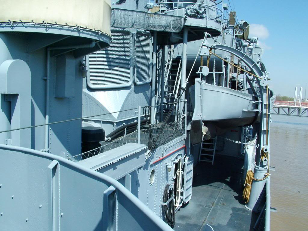

The base is actually not perfectly round - if you're standing behind the after davit, the base is flat against the bulwark, so "yes" your comment has validity in that the bulwark may have provided support to the davit. There were not fore/aft guy wires attached.
About the only photo I have to illustrate your point is this (USS KIDD) -
And perhaps I should have looked at this BEFORE I printed my davits. Oh well, at least I know that the curing box works well, so all is not lost!!

Well, that modification to the aft davit didn't take too long - I'll add it to the print file for tomorrow. Here is the version 2 -
(The bar connecting the davits is for printing support only, it will be removed)
I may follow thru with the same modification to the fwd davit later tonight.
As I'll be trying out the Any Cubic Resin, this should print with very good detail - at least that's what I'm hoping for.

Hank:
Good luck in the resin follies, seems to be the most valuable ingredient! Interesting that in your photo that the aft davit base looks like the DE version, somewhat integrated into the bulwark. As the davits have to work back and forth in rotation to get the boat out (they are about 23' apart) I wonder if the bracing pad is just a museum ship installation.
These things always seem to be a learning situation and by the time you have worked it out we will all know a little more!

Tom,
As I mentioned in my email to you with picture, the pad was there all along - I'm thinking that it is able to be swung out of the way during certain evolutions with the boat.

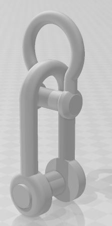

The original design of the chain stopper came from Tom and I did a bit of further tweaking and modifying to get to this point.
The chain stopper is not designed to "float free" as the links are extended to touch each other. As these items are EXTREMELY tiny, getting them into place and so forth will be a trial of patience on my part!!!! :doh_1:
All items are printed using the Phrozen ABS-Like Rapid Black resin.
