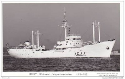

Wow pretty nice. Thanks for sharing. I am going to do a French navy spy ship from the 80�s.
I will cheat on the hull and work from a resin one I have and modify it. Can I glue styrene on resin?
Regular styrene glue?

Hi
Can you see the picture of the ship I want to do?
- Admhawk
- Posts: 957
Re: Question to all really experienced scratch builders here
Yes, nice classic lines.
What are you going to start with?

Well thanks for the additional posts. It's going to be a slow process for me. So much to compute. I will start with the basics at first. Cutting styrene, sanding , gluing and stuff like that. Where and what to buy, which thickness styrene to buy for each job is one of the first things I want to learn along with the basic tools needed. I build in 1/700. Not so much worried about accuracy at this point.
I got books to read too, that should take a while.
David thanks for the page about the B.E. Berry, I did not know that one. Just so you all know I was assigned for a time to this ship back when I was in the French navy.
It was what they called "Un bateau blanc" which means "A white boat". Basically not a fighting ship, we only had 2 mounted machine guns. It was nicer to be on these ships as middle of the night training for whatever reason were fewer than on destroyers and cruisers.
Tending to officers was my job (Yes like a butler LOL). Other than that during training I was assigned to receive or send whatever was needed to hovering helicopters, food, ammo or evacuating injured soldiers (Dummies here). I had to wear a fireproof suit when doing this and it was real hard to move around in it. When arriving at a pier I was one of the sailors assigned to secure the ship. We would compete to be the first one on land. Good memories though!
I hope I don't make too much of a mess modelling it.
