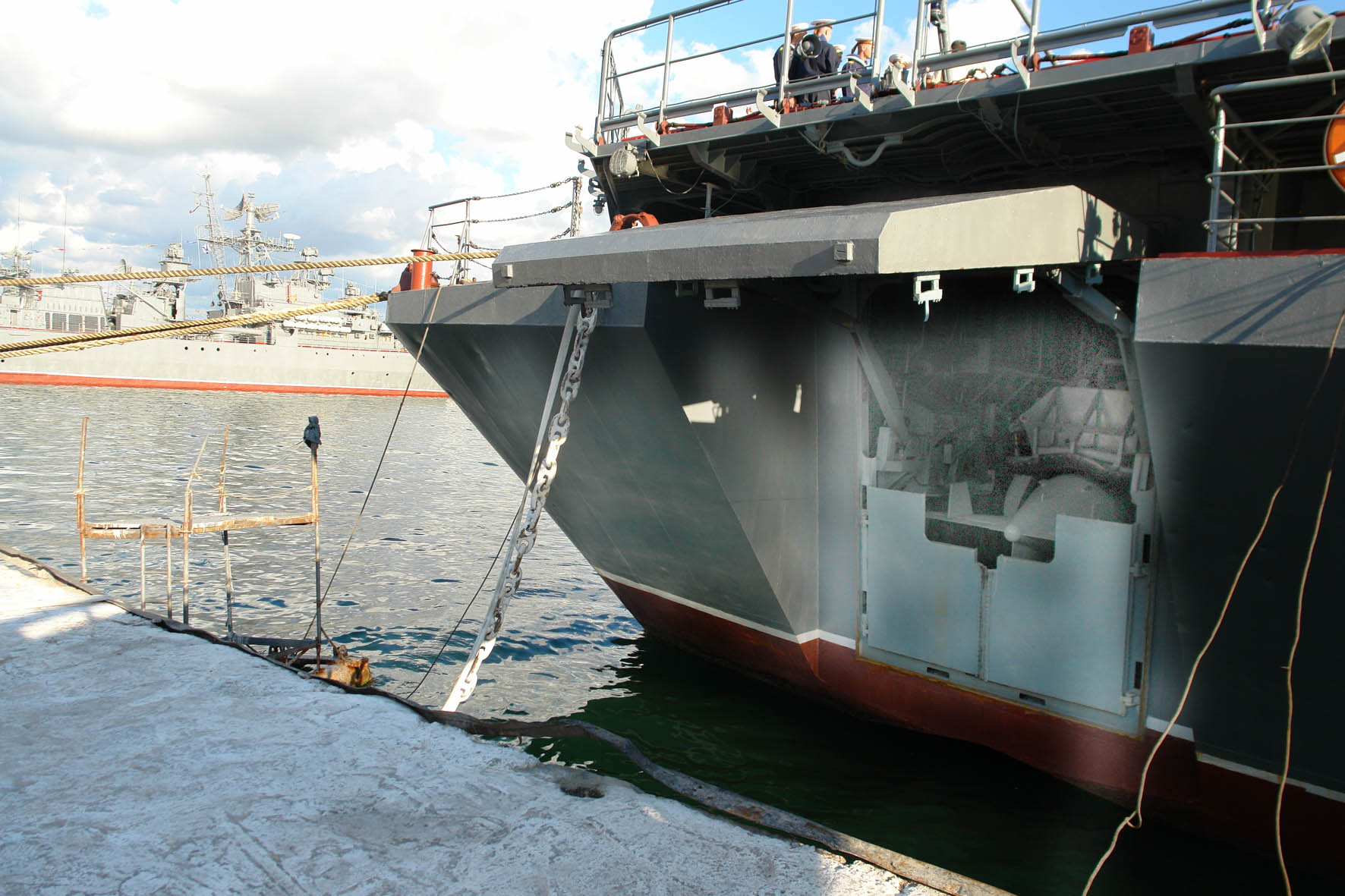

Dug out that harddrive. I believe this is what you're looking for. Not very good, I know, but the best there is to find I guess. Not sure of the authenticity of the picture though, I believe they played with the lighting balance to make things more clear, but might have just PS'ed a different interior on top of it alltogether...
What is visible is that it doesn't match with what I have for the Krivak, as the aft fins of the Slava VDS have a vertical stabilizer, which is lacking on the Krivak's. However the pictures I have of Krivak are for Krivak I, I believe Mare Tail was only introduced on Krivak II...
The davit/launch device on Slava does look a lot like the one for the Krivak, including the lower doors. I posted the Krivak stuff here, not to clutter this topic.
http://www.shipmodels.info/mws_forum/viewtopic.php?f=49&t=34726&p=1009688#p1009688
The merchant shipyard
PostPosted: Sat Sep 24, 2022 12:45 am
Posts: 3384
Thank you.
From what can be seen, the rear of the sonar towed body in the Slava looks very similar to the towed body shown in your photos of the Krivak, except for small vertical fins on the horizontal fin.
The ex-Minsk was turned into a tourist trap theme park for a while in China. On board an identical or at least very similar VDS towed body was turned upside down and put on display amidst parked aircraft. Photos of that VDS exhibit is easy to find on the web. The theme park is apparently closed and the ex-Minsk now appears to be a derelict hulk marooned in a land locked lake somewhere in China. The aircraft parked on deck are now gone, but the sonar towed body is apparently still there.
The ex-Kiev was also turned into a museum in China. It appears to have fared much better and is apparently still in good shape. An identical sonar towed body can apparently be seen in its deployment cradle inside the VDS compartment, See here https://www.flickr.com/photos/147661871 ... otostream/
I think those fins seen in your photo represent a minor hydrodynmaic change that does not necessarily indicate any more substantive difference. So they do not necessarily indicate Slava had a different sonar. The Slava class post date Krivak and early Kiev by a few years. It seem possible that minor hydrodynamic improvements were introduced to the same model of sonar towed body over the elapsed years.

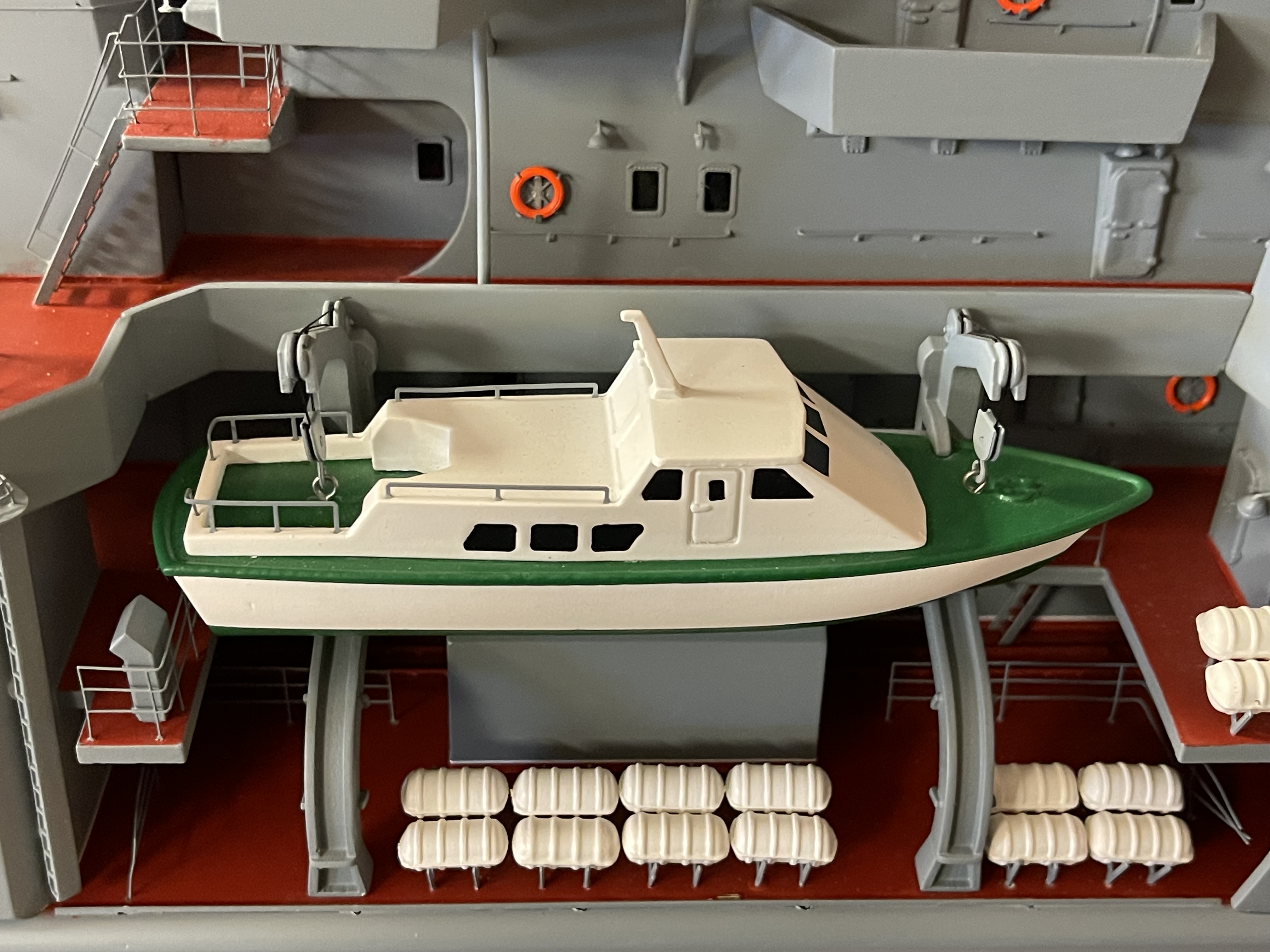

Does anyone on here have any additional photos on this lifeboat on the Kirov? Also, any idea on how it is raised and lowered? Thanks!
PostPosted: Thu Nov 02, 2023 6:53 pm
Online
Posts: 12346
The upright portion of the davit slides down the tracks of the "diagonal" portion with the boat hanging on until they reach the edge, at which point the boat is overhanging the side of ship and then lowered into the water.
There's a diagram halfway down this page that shows it: https://www.hiseamarine.com/gravity-rol ... davit-4832
PostPosted: Thu Nov 02, 2023 7:06 pm
Joined: Thu Sep 03, 2020 9:27 am
Posts: 12
Thanks for help. This could be a challenge to make functional at 1/100 scale.
PostPosted: Fri Nov 03, 2023 12:23 am
Posts: 1677
There are images about half way down this page showing how the double arm trackway gravity davits work:
https://www.okieboat.com/CAD%20miscellaneous.html
