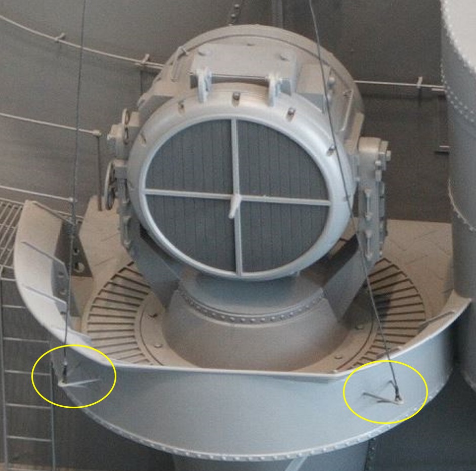

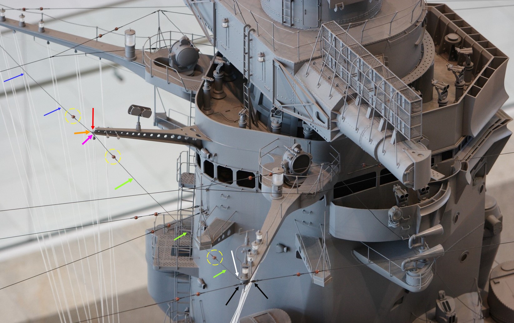

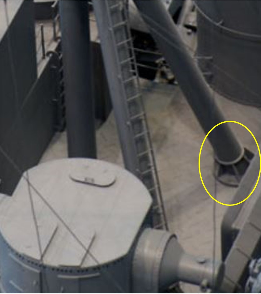

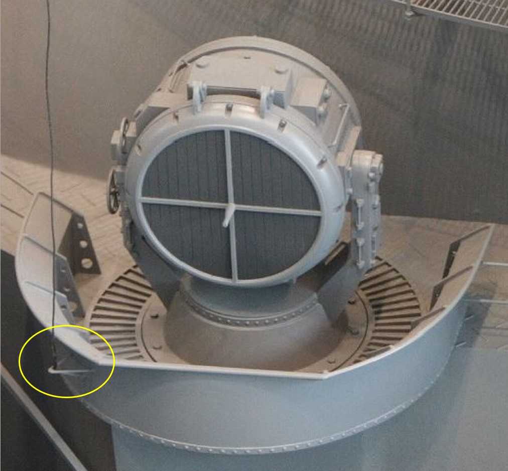

Kantana wrote:
In pic 06 you see that the 2 wirings are attached to the vertical bridge wall with a bottlescrew. The 2 bottlescrews are attached to a bracket. Please use your zoom.
From the bracket , you see the wirings going straight upwards , on the OUTside of the bridge wall, passing through a massive eyelet, aside the first window on the right and aside the second window on the left. Then both cables are going higher than the windows, through a similar solid steel eyelet where they bend over, inwards. From there , they go to the window edge were they disappear in the left and the right upper window corner.
Strange construction, you say ? I fully agree .
Maybe some expert can clarify , why the cables first make a loop UPwards before they disappear in the window corners ? I would have made the loop UNDER the windows , simply to prevent rain pouring from the cable �holes.
But I guess , for one or more obscure reasons, the cables should be placed like we all can see now .
OK. We know where the cables start . But where do they go ??
I am going to make a guess thinking that the 2 cables needed to be attached at that point to clear other structures around that area. They obviously were done as a retrofit to add additional equipment to the bridge, but it must have been too labor intensive to breach the wall to run cables through, so why not go through the corner of the window instead. Looping it over the windows prevents it from tearing away from the weight of the wire taking pressure off of the entry point. To me it looks jerry rigged (makeshifted), like running an extension cord up a wall and fasting it down in spots to keep it neat. I guess maybe they didn't have the right parts so someone was told to make it up as they go along, so that's just what they did! I notice maybe a little pipe was used to guide the wire in a specific direction to the window.
Jim
Jim

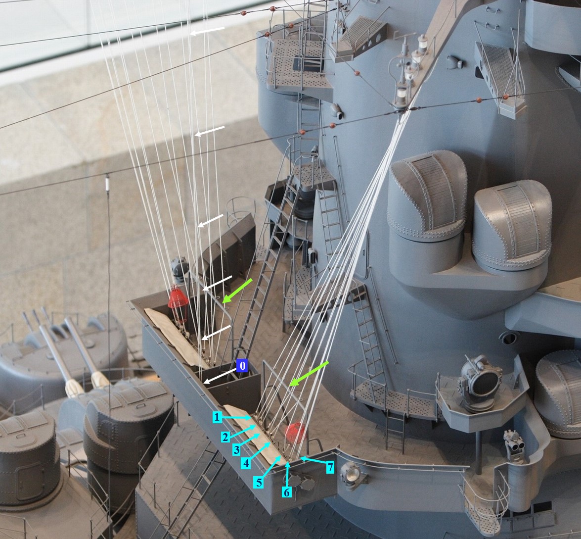

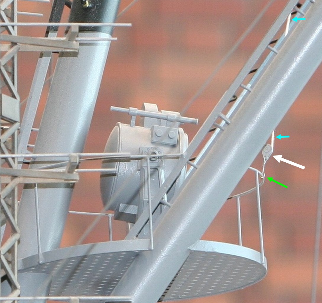

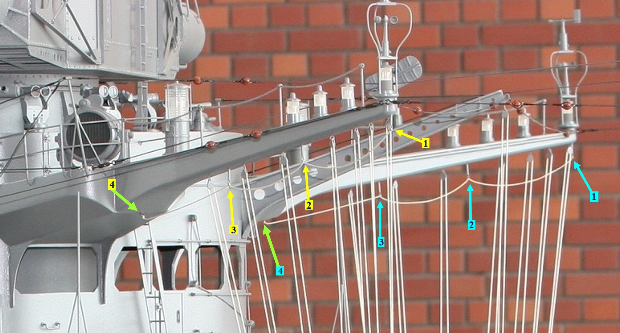

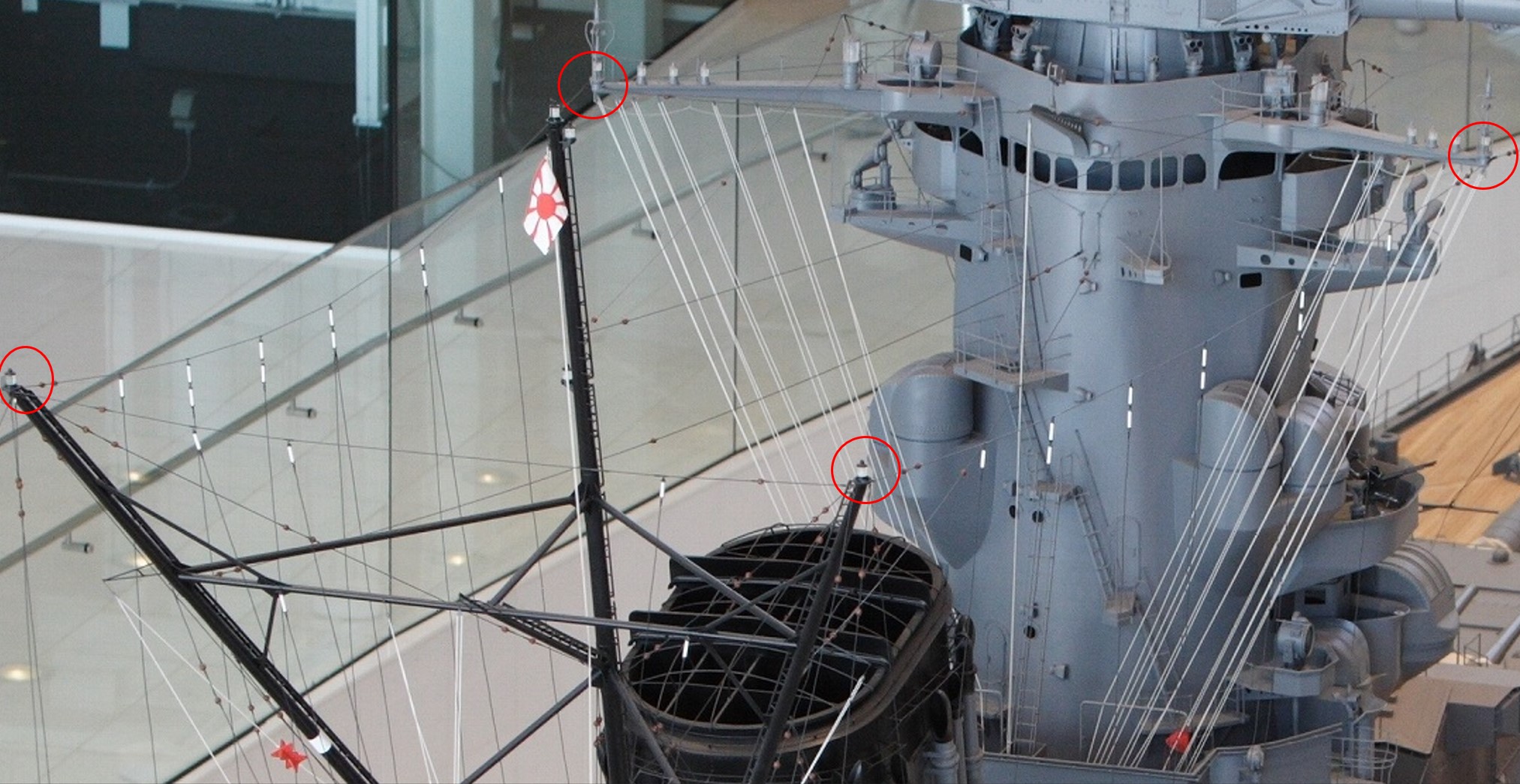

YAMATO RIGGING GUIDE
CHAPTER 02. BRIDGE

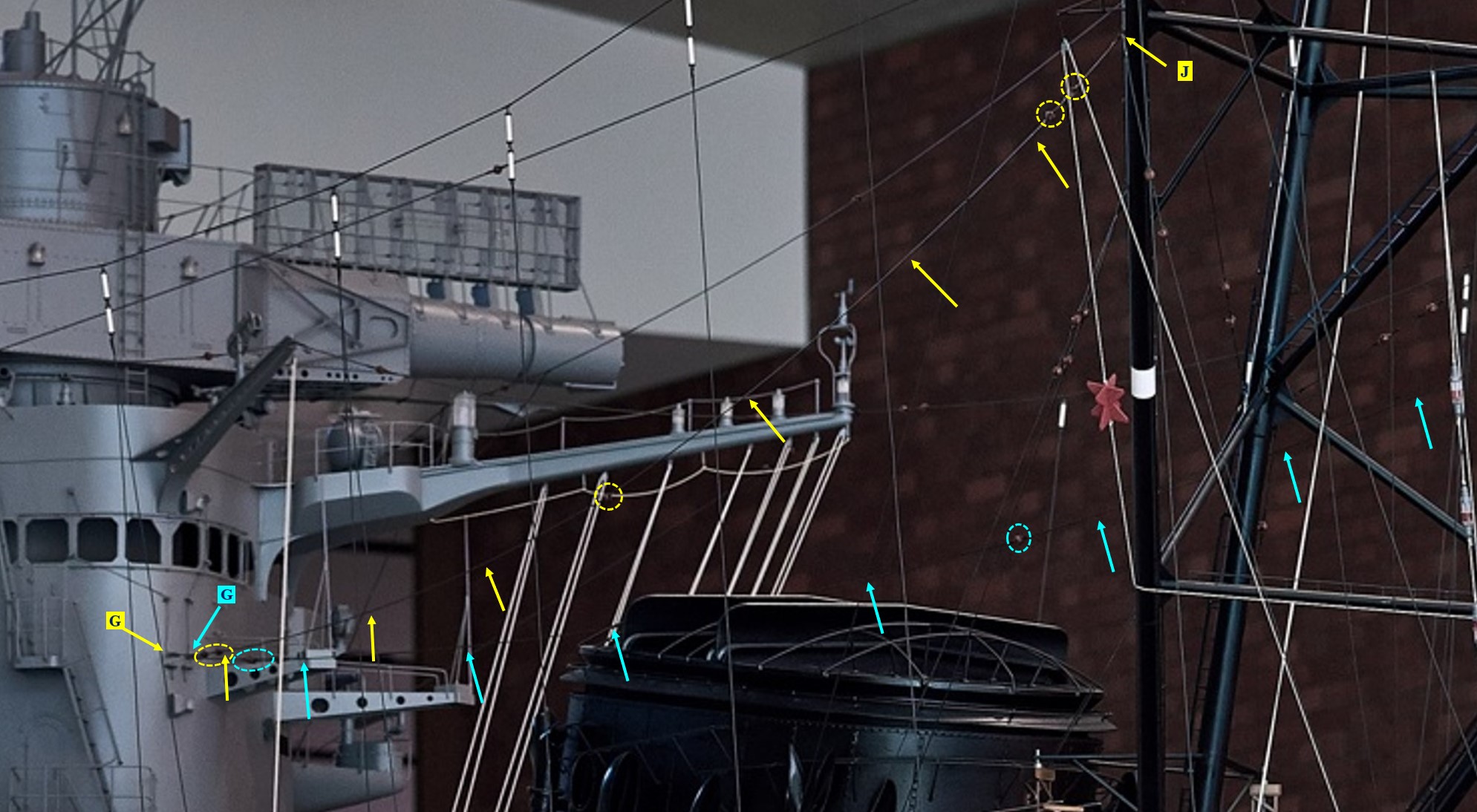

Step 02.05. Rigging from the Signal Deck to the Main Yards and back. � Revision 01 of 30 April 2024.
Gentlemen,
Today we will talk about the rigging from the Signal Deck to the underside pulleys on the Main Yards and beck.
In this rigging step we will not talk about Cables.
The Signal Deck is the sole playground of (white ) Signal Flag Cords.
The pictures

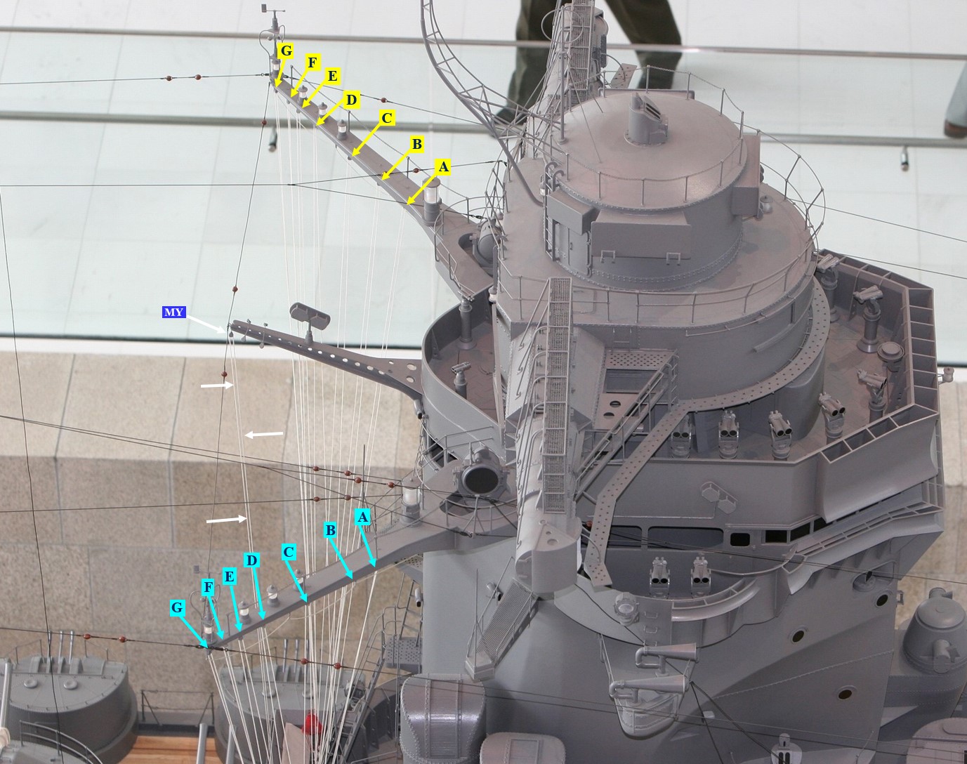

All the pictures have the same colour code for the rigging devices :
Yellow arrows A-B-C-D-E-F-G : pulleys under port side Main Yard.
Blue arrows A-B-C-D-E-F-G : pulleys under starboard side Main Yard.
Yellow Nrs 1-2-3-4-5-6-7: Port side Brackets at Signal Deck.
Blue Nrs 1-2-3-4-5-6-7: Starboard side Brackets at Signal Deck.
Green arrows: Upper Guiding Rails on both sides of the Signal Deck.

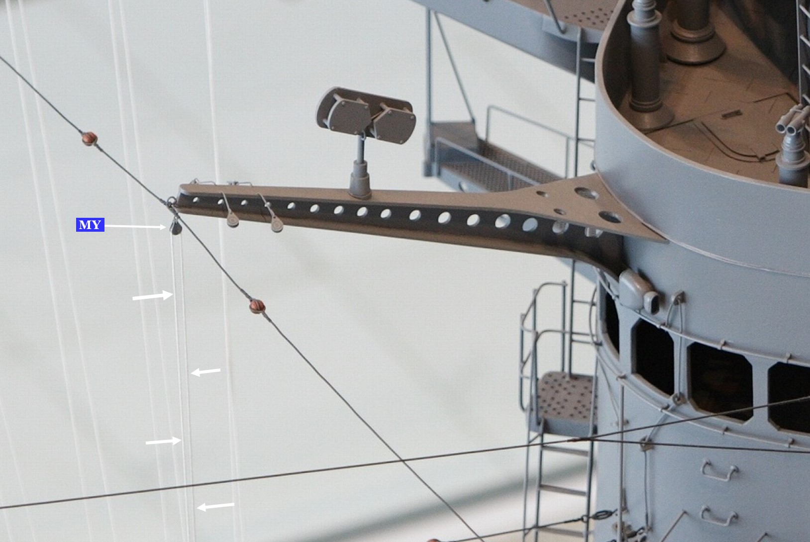

White Arrows: Single Mid Yard Flag Cord.
Blue Tag �MY�: Single Flag Cord Pulley on Mid Yard.
Blue Tag �0�: attachment bracket for Mid Yard Flag Cord at inner side of acces compartment on the Signal Deck.
In some pictures, only 1 side of the Signal Deck was tagged. This was done to avoid too much arrows and to keep clarity in the picture.
The Signal Deck.
The signal deck is located at the Aft side base of the bridge. See Pic 001-002-003-004-005 for more detail.
This deck is the work station where the signal flags are attached to the 15 Signal Cords that can be raised and lowered depending the visual message they need to transmit to all vessels in the (visual) proximity of the ship.
For a total view of the White Cords between the Main Yards and the Signal Deck, look at Pic 006-007-009-010 & 020.
I�m not going to explain how the signal deck is functioning, nor will I tell you about the significance of the different signal flags, but in Pic 016 you get a slight idea how they look like.
Of all the rigging devices on Yamato�s Signal Deck, the following ones will be discussed :
- The Access Compartment (box)
- The Flag Cupboards
- The Lower Fastening Bars
- The Upper Guiding Rails
- The Brackets
- The Signal Flag Cords
- The Single Mid Yard Flag Cord
- The � Red Baskets� on Flag Cord Nr 5
The Access Compartment (box):
See Pic 001-002-003-004.

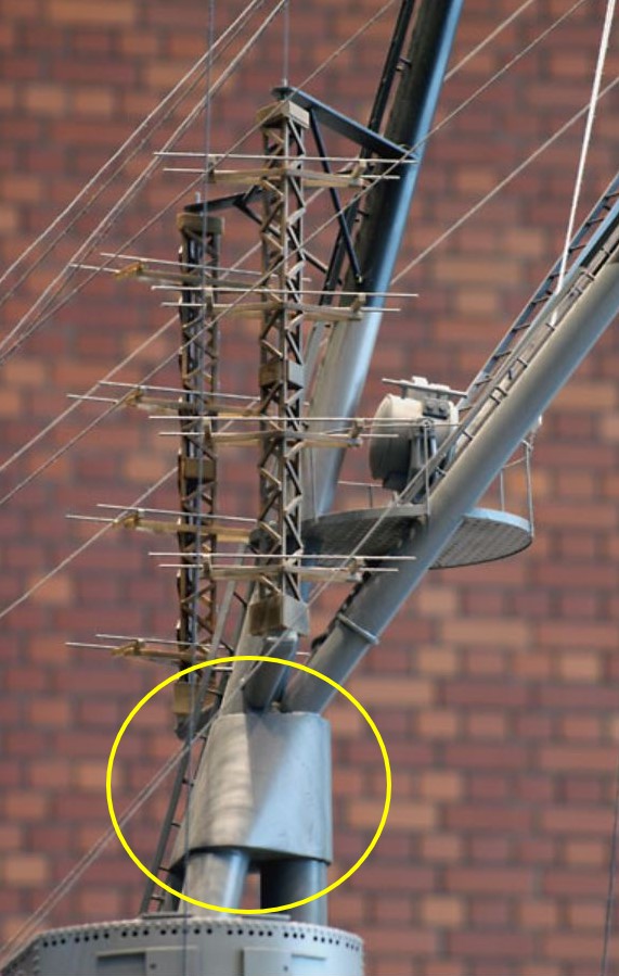

The Signal Deck can be accessed from the ships deck via the access compartment in the middle of the Signal Deck, near the railing wall.
The access compartment is a rectangular �box�,little lower than the railing wall. In the front side of the box, a (tiny) manhole is cut-out, enabling Yamato crew to access the Signal Deck. See Pic 001.
Inside the access-box, a ladder from the ships deck below arrives and also from there, another ladder departs to a higher platform on the Bridge structure. See Pic 003. Not much space to change ladders�

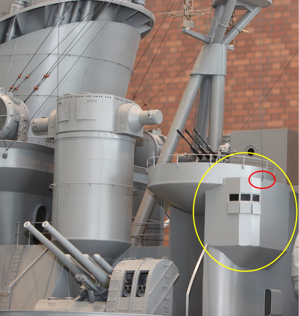

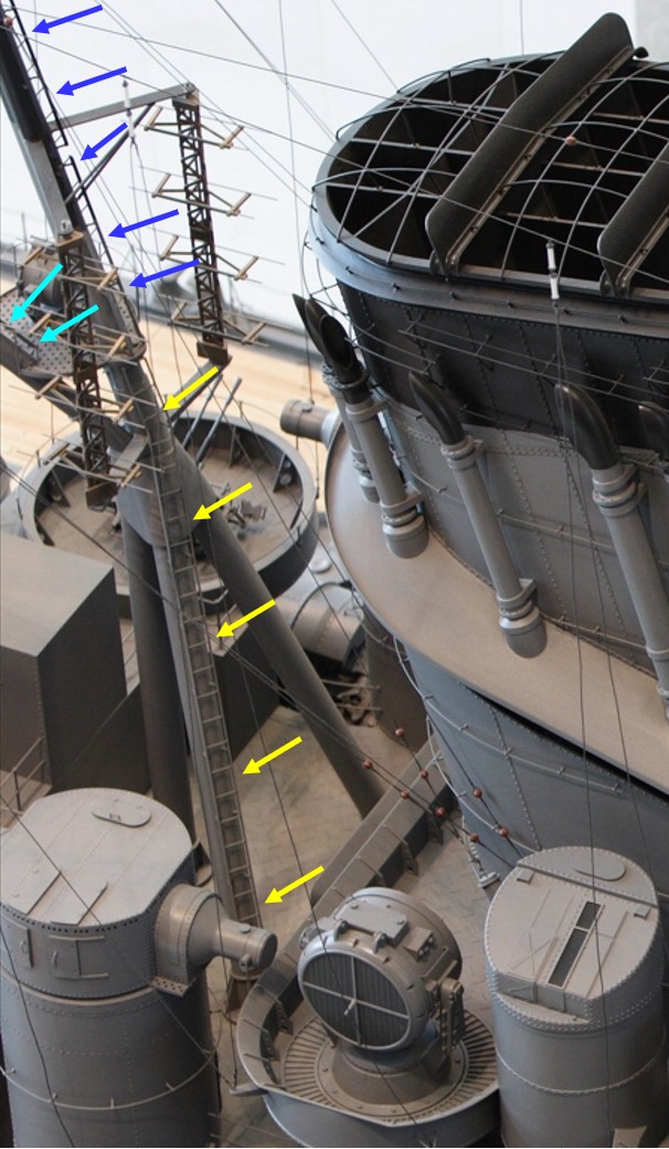

The Flag Cupboards
See Pic 001-002-003
These are 2 big containers on the Signal Deck. Both cupboards have a canvas cover on their top to protect all different Signal Flags that are stored inside. They are installed against the aft railing wall of the Signal Deck and they are separated from each other by the Access Compartment box in the middle.
In Pic 003 you see the naked cupboards from which the canvas covers are removed while Pic 001 & 002 shows you the cupboards with their canvas covers installed. Also visible in Pic 003: the different stowage racks for the Signal Flags.

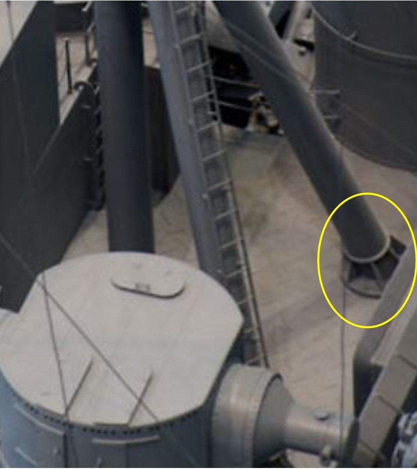

The Lower Fastening Bar.
See Pic 003.
The lower fastening bar is a rail, installed on the front side of the port and starboard side Flag Cupboard. It holds qty = 7 vertical Cord Brackets that are conceived to hold and secure the Signal Flag Cords when they are in fixed position.

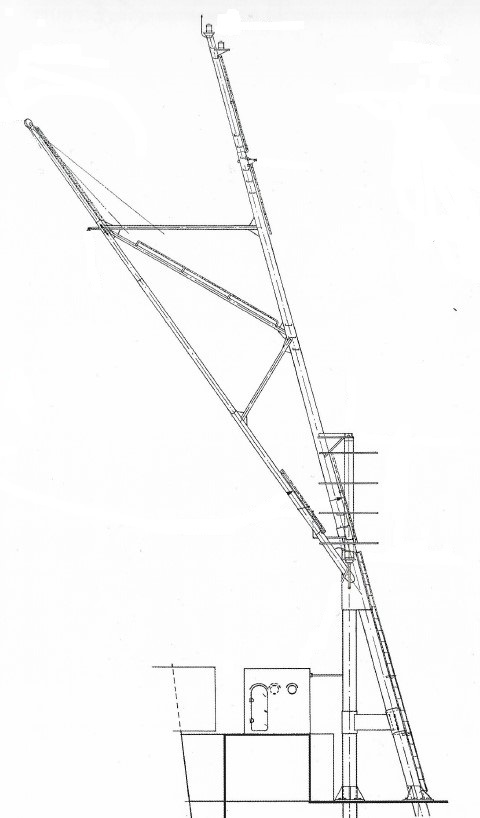

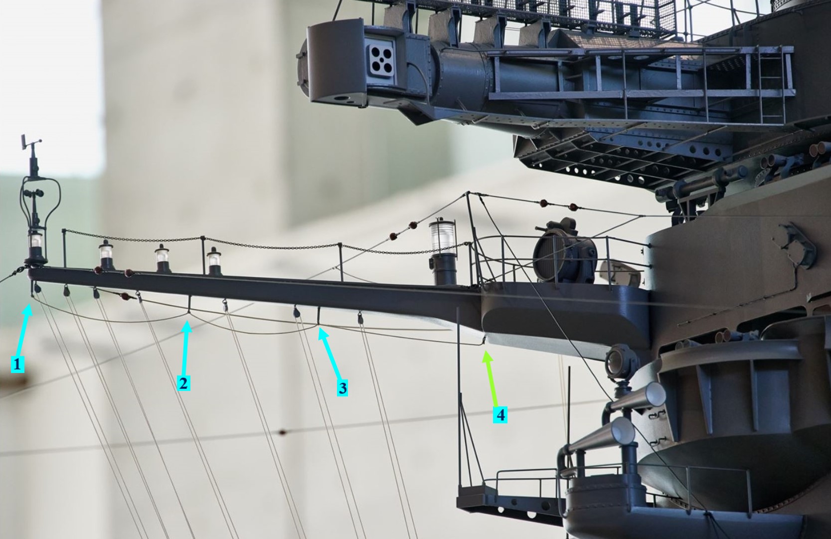

The Upper Guiding Rails.
Little before each lower fastening bar a big Guiding Rail is installed on the Signal Deck. See Pic 001 & 002. The Upper Guiding Rails are much higher than the cupboards and they extend above the Signal Decks railing wall also.
Both Guiding Rails are solid metal bars that are attached to the Signal Deck with 2 reinforcement-legs.
See green arrows in Pic 001-002-003 and in all other pictures.

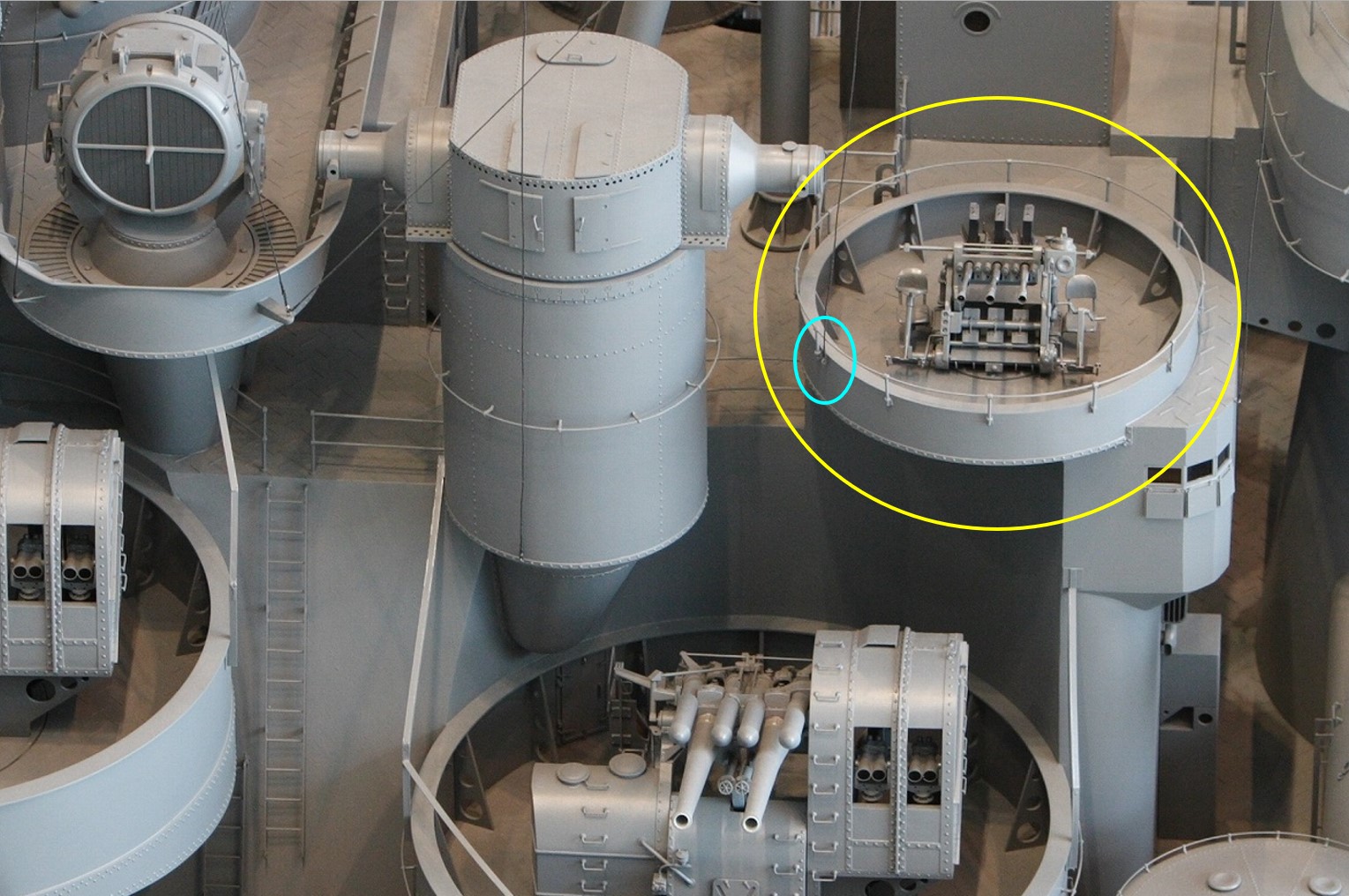

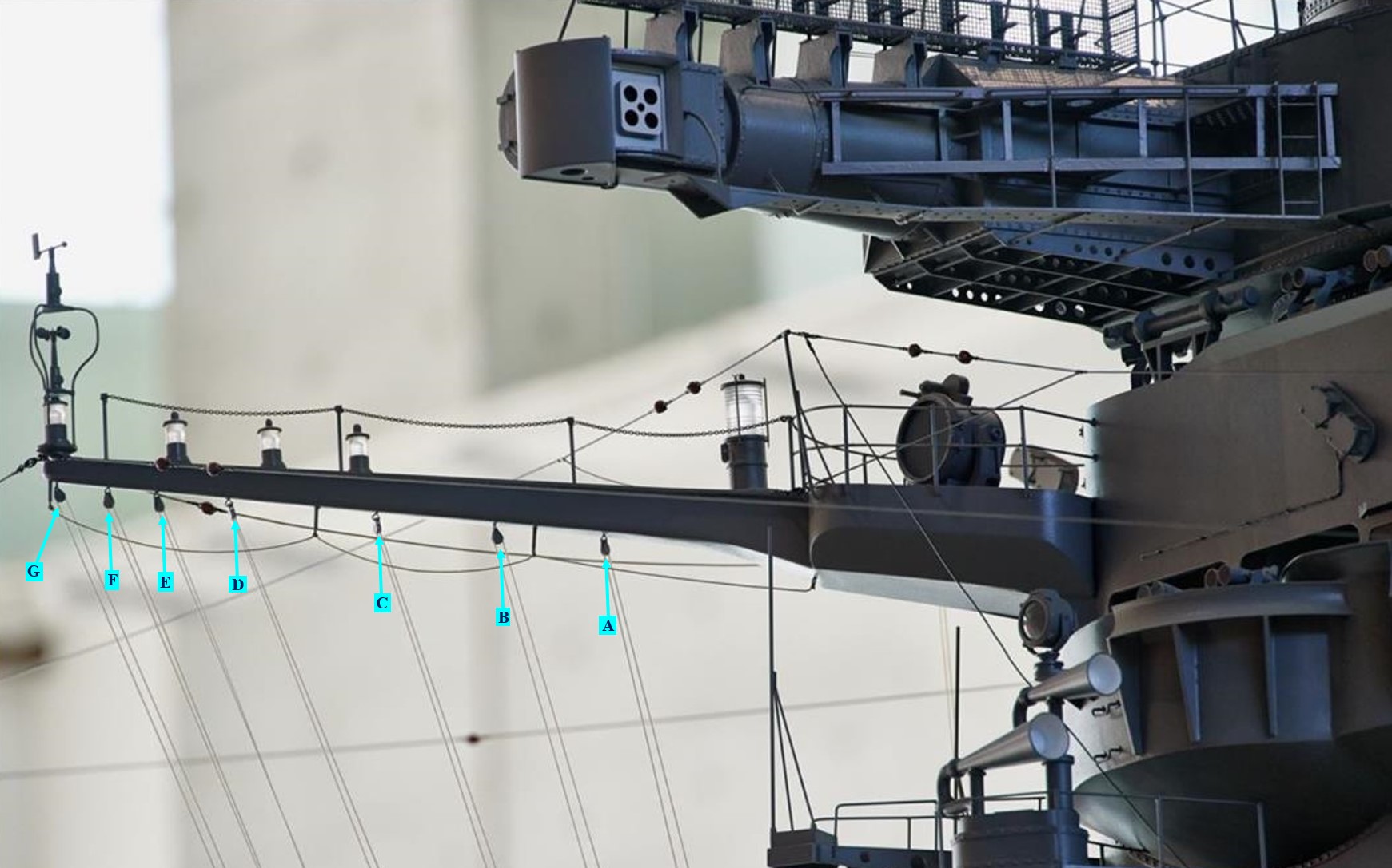

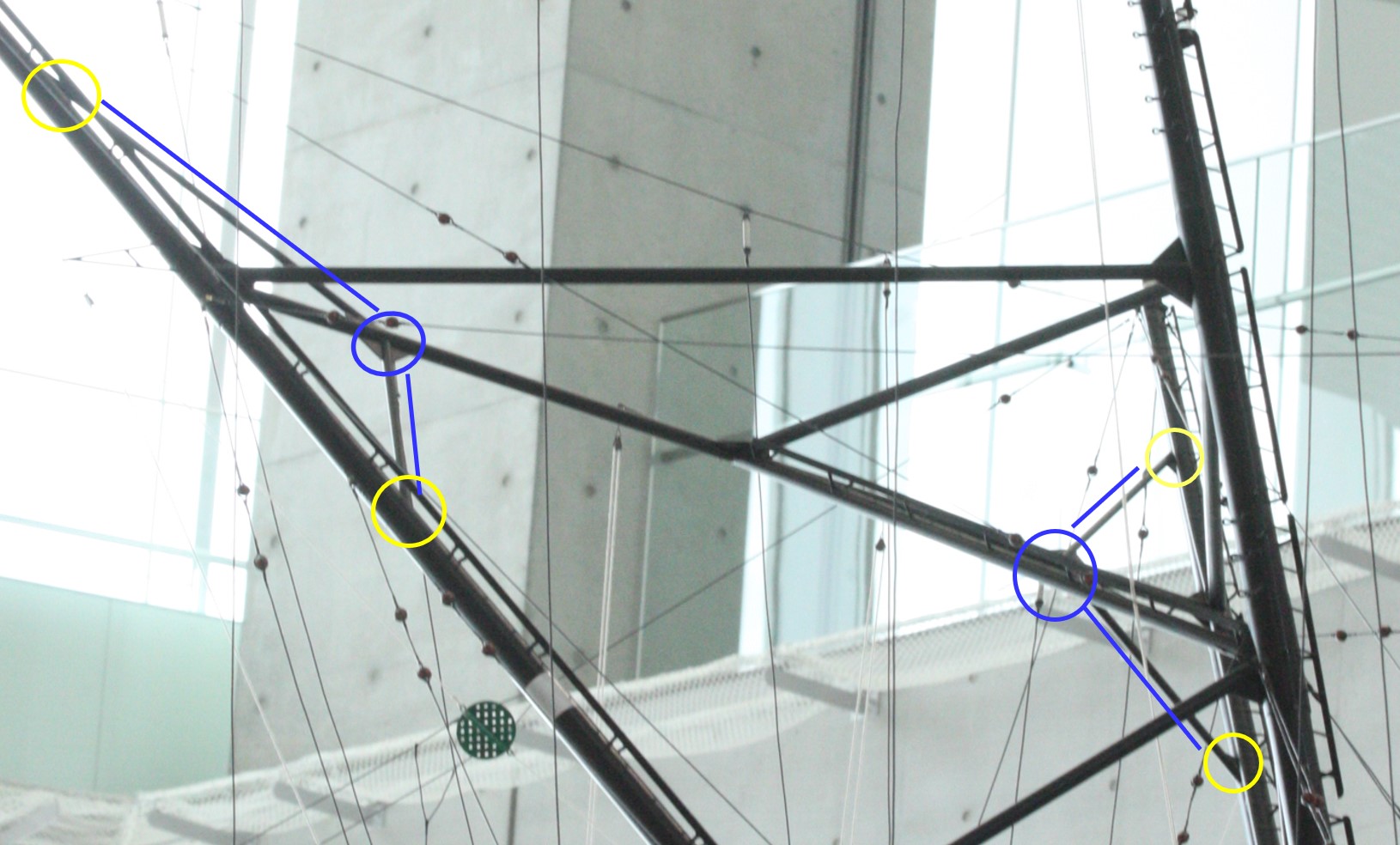

Each Guiding Rail has 4 big Lug Rings installed on its upper side.
See Pic 005 ( Nrs 1-2-3-4).
All Lug Rings are welded in the horizontal position, enabling easy passage of the White Signal Flag Cords. The lugs are located right above the 4 Inner brackets (Nr 1-2-3-4) on the Lower Fastening Bar. See Pic 005. These Lug Rings ONLY guide the INNER Signal Flag Cords (Nr 1-2-3-4). The outer Brackets (Nr 5-6-7) and Flag Cords are not guided by the Guiding Rails and here the Flag Cords that return from the Main Yards are directly attached to Brackets Nr 5-6-7. See Pic 003.
The Brackets.
See Pic 003.

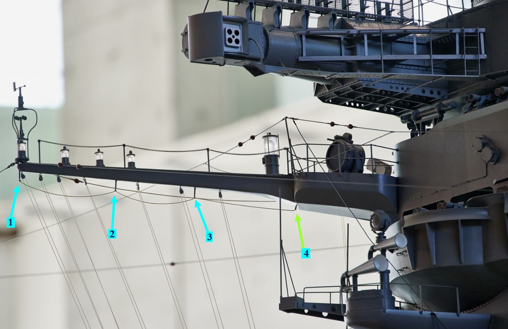

In this picture,you see the starboard Brackets installed on the Lower Fastening Bar. They look like short vertical rods where the Flag Cords are knotted around. See blue Nrs 1-2-3-4-5-6-7.
The Signal Flag Cords:
The Signal Flag Cords are fixed on their Brackets, in front of the 2 cupboards on the 2 lower fastening bars.
From the port & starboard side of the Signal Deck, the Signal Flag Cords depart upwards to the pulleys under each Main Yard.
See Pic 006-007-008-009-010-012-013014-015-017-018-019 for more detail on the main yards.
Once above, each Cord runs through a pulley and heads down again to the outer Brackets Nr 5-6-7 on the Lower Fastening Bar. Flag Cords Nr 1-2-3-4 first pass through the Lug Rings on the Upper Retaining Bar before they reach Brackets Nr 1-2-3-4 on the Lower Fastening Bar.

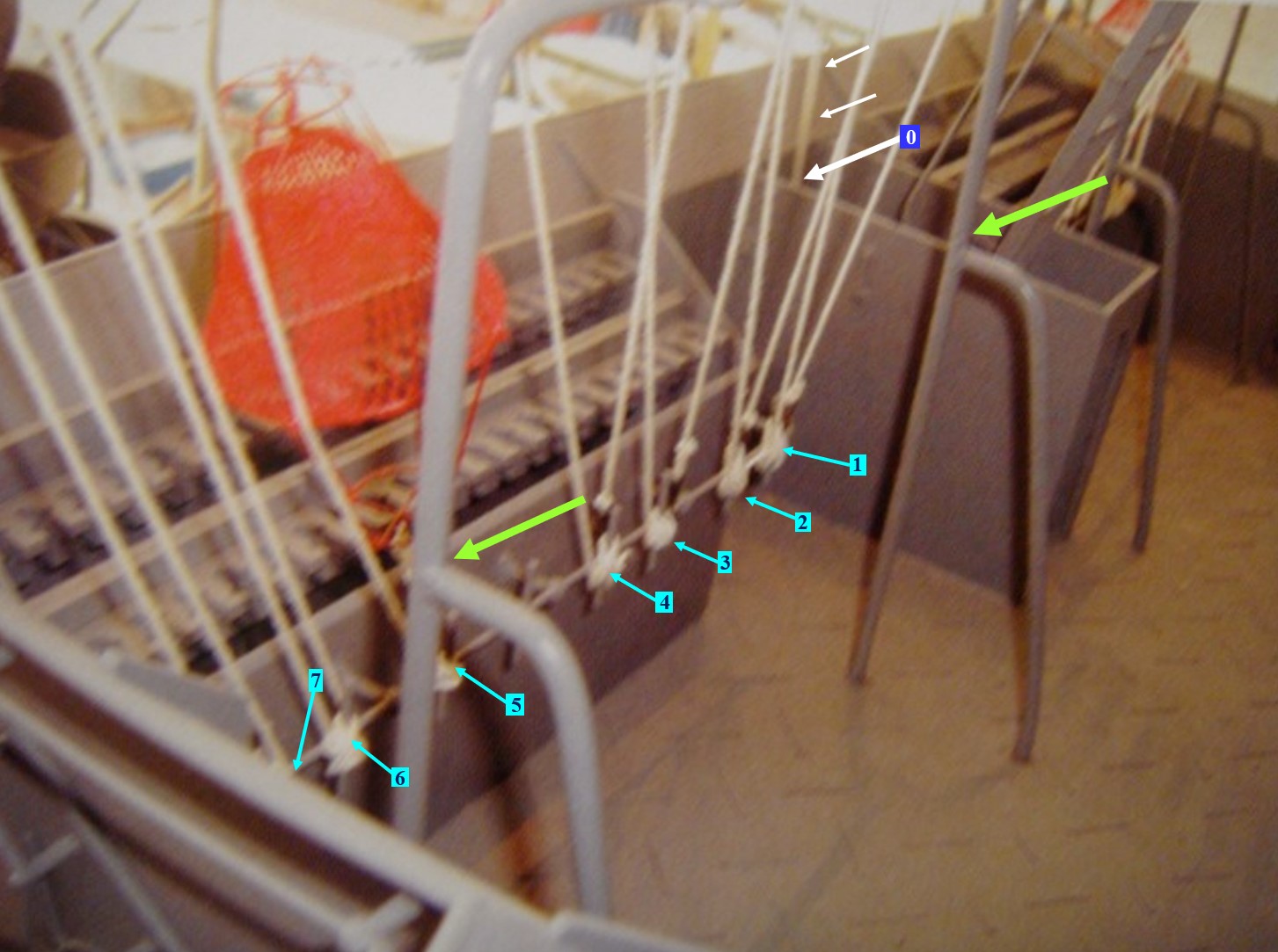

Beside all the other Flag Cords on the Signal Deck, there is only 1 Cord that departs from a Bracket at the inside of the access box. It goes towards the pulley on the Mid Yard-tip at the Bridge (see Pic 011, blue tag �MY�). As soon as the Signal Cord passes through the Mid Yard Pulley, it comes back down towards the bracket inside the access box. See Pic 001-002-003-006-007-008-009-010-013-017-018&020.
Notice :
There is no clear picture available of the bracket station �0� inside the access box of the Signal deck.
If somebody among you could provide me with such a picture, I will be glad to introduce it in this article to share it with everyone. Thanks in advance.
The only (blurry) image that comes the �closest� to the White Flag Cord attachment is Pic 003(white arrows) that shows you where the White Flag Cord disappears in the access opening. But that�s the best you �ll get.
See Pic 003.
When looking at Pic 003 you see on one end of Flag Cable Nr 5 a red � Basket shaped device � laying on the 2 Flag Cupboards. Not long ago I received the info on this �red device� : it is a speed indicator. Don�t know how it works but anyway : a BIG THANKS to Dan for telling me the real function of these � red baskets� on the Signal Deck.

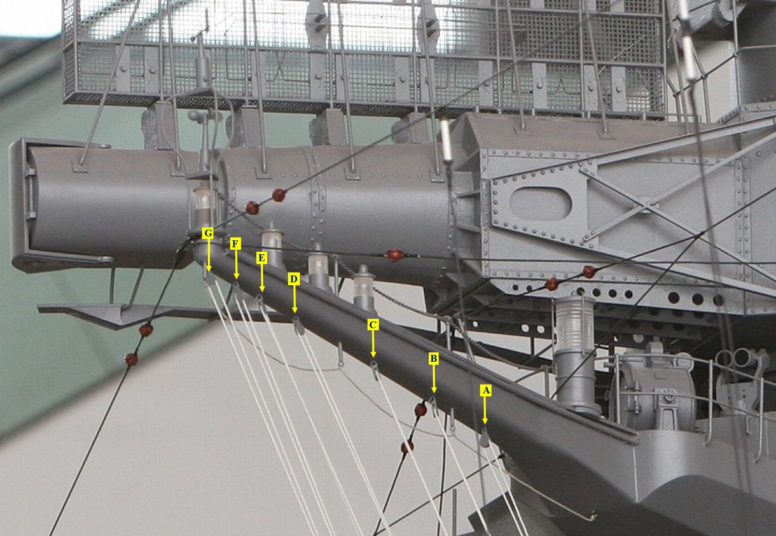

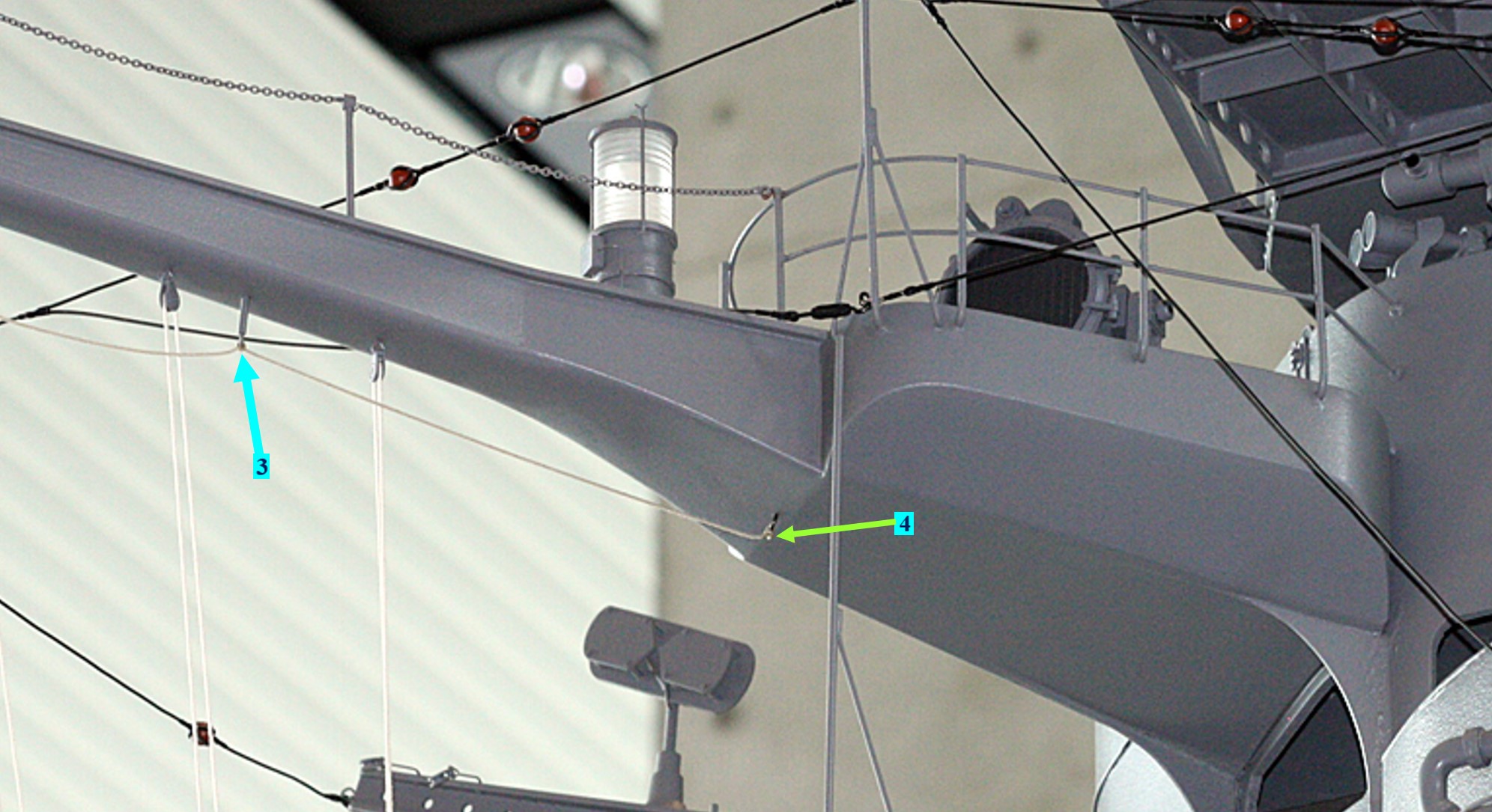

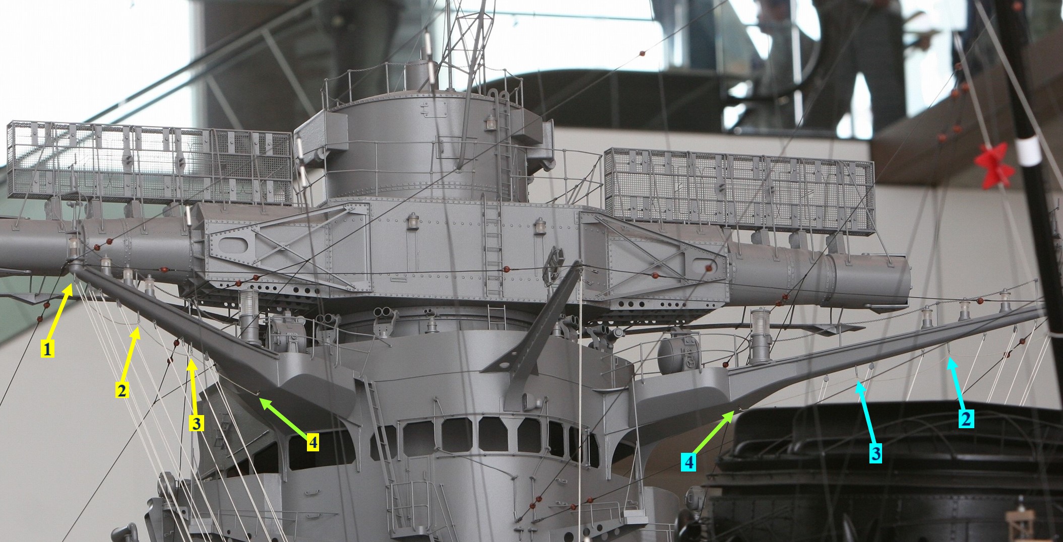

The Main Yard Pulleys
Under each Main Yard, 7 pulleys are installed to operate the Signal Flag Cords on port & starboard side of the Signal Deck.
See Pic 009-010-012-013-014-015-017-018.
They are tagged from the inside towards the outside with letters : A-B-C-D-E-F-G.
Notice :
Distances between all pulleys are not equal. They are closer or further from eachother, depending on their location at the Main Yard underside. See Pic 012-013-014-017.
The rule is : the further you go to the Main Yard tip , the closer the Pulleys are installed next to each other.
Rigging procedure :
This rigging step is quite straightforward : from the brackets 1-2-3-4-5-6-7 on the Signal Deck, a white Signal Flag Cord goes upwards to its corresponding pulley on the underside of the Main Yards A-B-C-D-E-F-G ; Once the Cords pass through the correct pulleys, they go back to the Brackets in their departing station. But Cords 1-2-3-4 make a little detour through the Lug Rings of the Upper Guiding Rails before they arrive in their end stations 1-2-3-4.
That�s all. Quite Simple�
Notice :
See Pic 003.
Notice :
Rigging procedure :

Step 02.06. Rigging White Cords at the Underside of the Main Yards. � Revision 01 of 30 April 2024.
Gentlemen,
today we will talk about the 2 White Cords that are hanging under the port and starboard Main Yards.
The pictures.
Notice :
In previous rigging step (02.05. Rigging of the Signal Deck to the Main Yards and back) you have already seen plenty of pictures on these 2 White Cords, without knowing it.
Are you surprised ? You should be ! They don�t stand out because they are hanging between all the pulleys at the underside of the Main Yards. They get a little �lost� between all those pulleys , no ?
So it will not be a surprise that, beside several new pictures, I used some of the previous rigging step 02.05. Just because they are very suitable for this subject.
The White Cords.

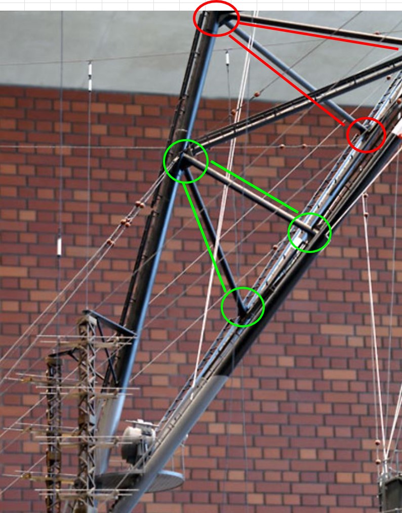

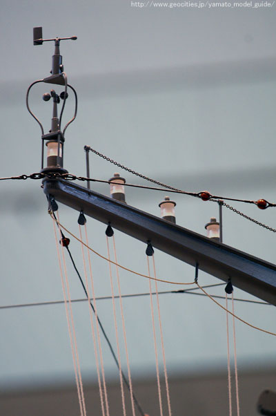

These White cords are hanging over the full length of the 2 Main Yards, at their underside. See all Pictures.
Let Us just note that we are talking about White Cords. They are not cables. Cables are black and often they wear Insulators.
White Cords on Yamato never wear Insulators.
The Cords in this rigging step are attached to 4 Lug Rings, installed at the underside of the Main Yards. See Pic 001-002-003-004-005-006-007-008-009-010.
The Lug Rings & Rods.
From the 4 Lug Rings under each Main Yard, only the 3 outer ones (Nr 1-2-3) are installed on a solid metallic rod. See Pic 001-002-003-004-005-006-007-008-009-010.
Presumably this was done the avoid interference with the White Cords in all the pulleys.
The most Inner Lug Ring (Nr 4) is not installed on a rod. See green arrows in all pictures.
It is directly attached to the base-bottom of the searchlight platform where the Main Yard shape starts. See Pic 001-002-003-004-005-006.
All rods are pointing downwards but they are not equally spaced between each other. See Pic 001-002-003-004-005 for more detail.The distance between rod Nr 3 and Lug Ring Nr 4 is longer than between rod Nr 2 and Nr 3. See Pic 007-009-010.
Gentlemen,
The pictures.
Notice :
The White Cords.
Rigging Procedure
This rigging step is so straightforward that looking at the pictures alone gives you all the information you need.

Dear "Katana",katana wrote:CHAPTER 02 - BRIDGE
Step 06- Rigging Cables on the underside of the Main Yards.
Description :
We are going to talk about the 2 cables that are hanging under the left and right Main Yards.
These 2 cables are placed on the underside of each Main Yard by means of 4 eyelets on top of 4 solid rods.
The rods are pointing downwards and they are not equally spaced between each other. See pic 01 for more detail.
The most INNER rods , right under the edge of the searchlight platform , have almost no length. It seems there is only an eyelet attached to the bottom of the searchlight platform without any rod.
I guess this is done to compensate the thickness of the searchlight platform versus the much thinner structure of the Main Yards at their end. See pic 01 , 02 & 03 for more detail.
The way the cables are hanging differs between the rods. Under each Main Yard , there are 4 attachment points and 3 fexions in this rigging step.
The first flex , between the most outer rod ( Nr1 ) and the next one( Nr 2) , is rather long and hangs at a certain distance from the Yard underside.
The second flex is between the 2nd rod and 3rd rod inwards , is shorter. The distance between the Yard underside and the cable is almost equal to the first flex.
But the third flex , between the 3rd and 4th rod , is different from the two previous ones : the cable shows almost NO flex : it looks like it is almost stretched between the 2 last eyelets. See pic 04 & 05 for more detail. Please note also that the distance between rod nr 3 and 4 seems to be longer than between rod nr 2 and 3.
Pic 06 gives you a clear view on the outer flex and in pic 07 and 08 you can see that the most outer rod is
installed OUTwards from the the first pulley that holds the flag line of the signal deck.

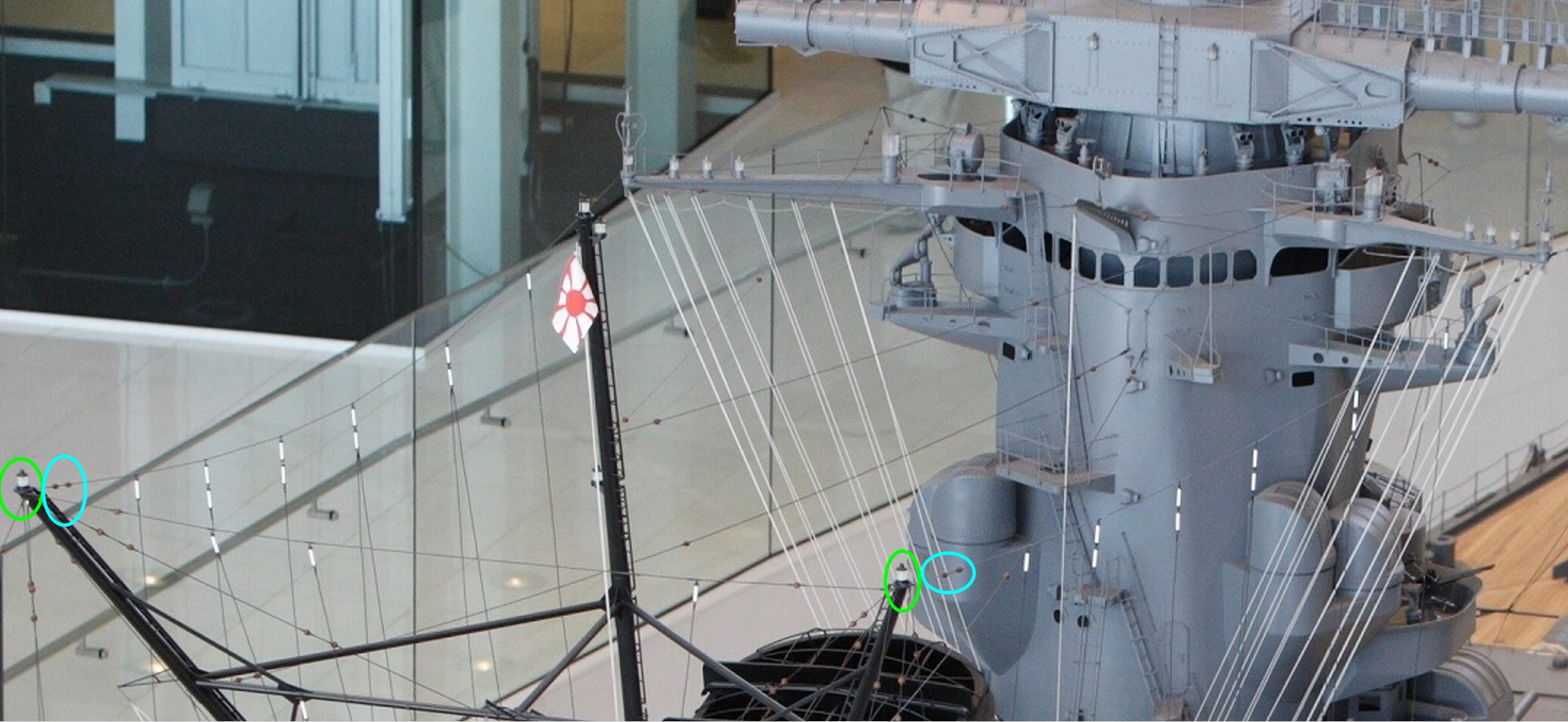

In pic 01, you�ll see that all MC�s are hanging above the fore ship at a respectable height ,heading towards the bridge.
Hint : in this pic, start looking from the Jackstaff and follow the main cables with your zoom.

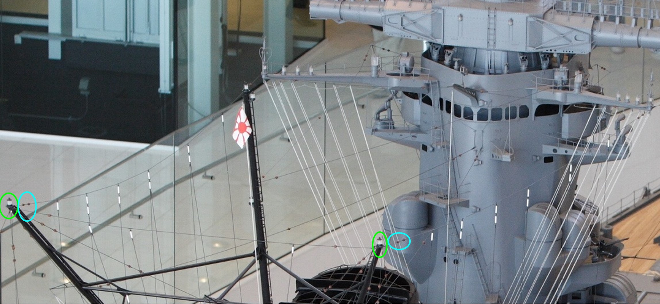

On the lowest cable (MC Nr 1) you will see 10 little dots. They form a series of 10 brown ball insulators , equally spaced to eachother and spread over a specific route. Keep in mind that MC Nr 1 is the mirror view of MC Nr 4.
Also in pic 01, we see that only 2 of the 4 main cables have those series of 10 brown ball insulators. MC Nr 2&3 do not show any insulators in this picture.
So , on what specific location is the most front insulator attached to MC Nr 1 & 4 ??

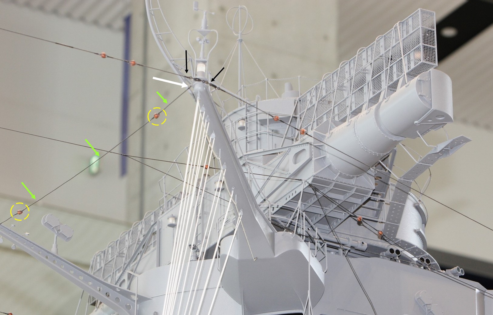

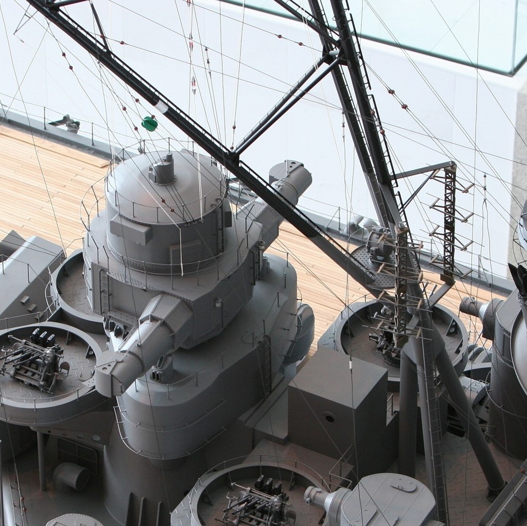

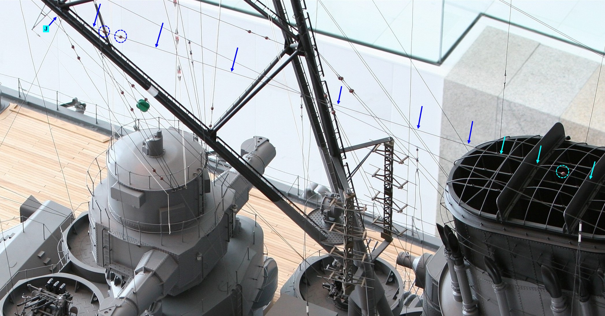

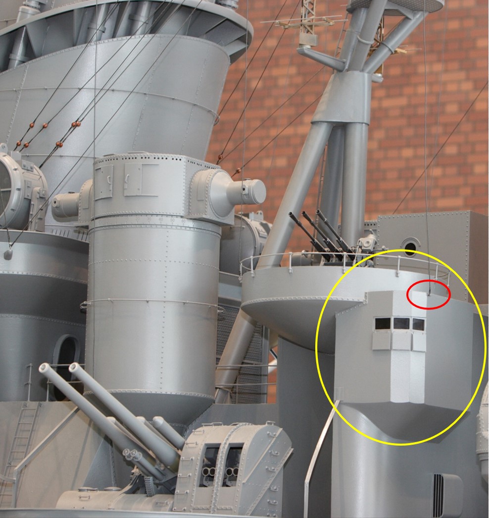

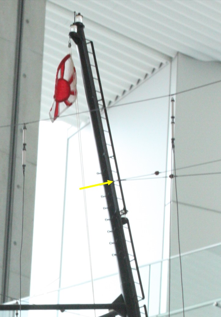

Pictures 03, 04 and 05 give a (not so clear) view of the Main Cables , but if you use your zoom , you might get an idea where the FRONT brown ball insulators are attached.
I must admit : this is a twilight zone in this rigging guide. Beside Rob Wood who made these , nobody published any photographs about this area. And certainly not any focused pictures on the main cables, hanging over the foreship.
So , if anyone has better/more clarifying pictures, please show Us. It only will help your fellow modelers.
However !! I discovered that in pic 04, when you zoom & look long enough , you �ll see in the window , right next to the Japanese Flag, the main cables are visible and somewhat contrasted because of the white background in the adjacent showroom next to Yamato room.
Not only the main cables are contrasted !! We also see 2 tiny dots on 2 of the 4 cables : Yep ! It�s them !!
We are looking at the 2 most front located brown ball insulators on MC Nr 1 & 4 !!
Now imagine a vertical line from the insulators towards the deck . You will notice that this line will hit the deck somewhere BEHIND the capstan. ( Huhh ???) Where is that ?
Ref : Jan Skulski�s AOTS page 153 : this location is at length station Nr 29 of the forecastle.
Pic 06 is better quality and here you �l see all 4 main cables with insulators on MC Nr 1 & 4. You don�t see the front insulators on MC Nr 1 & 4.
Now we know exactly where the 10 insulator series start . But where does it end ??

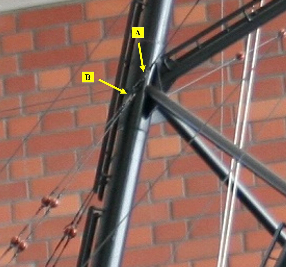

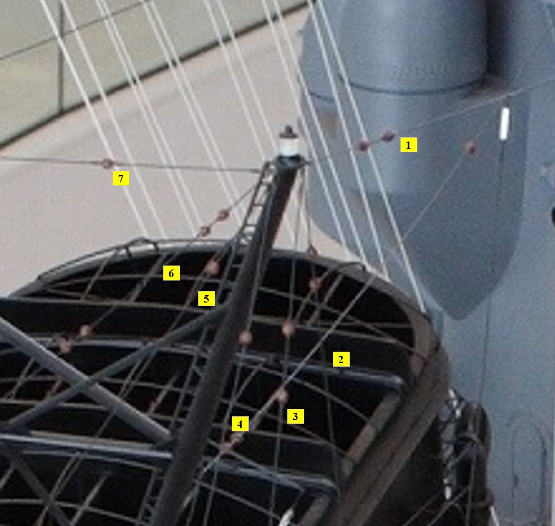

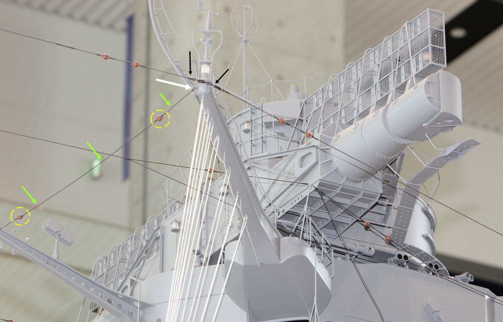

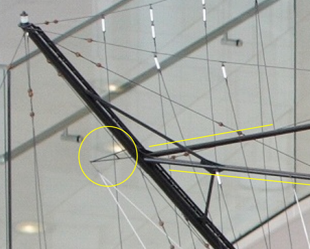

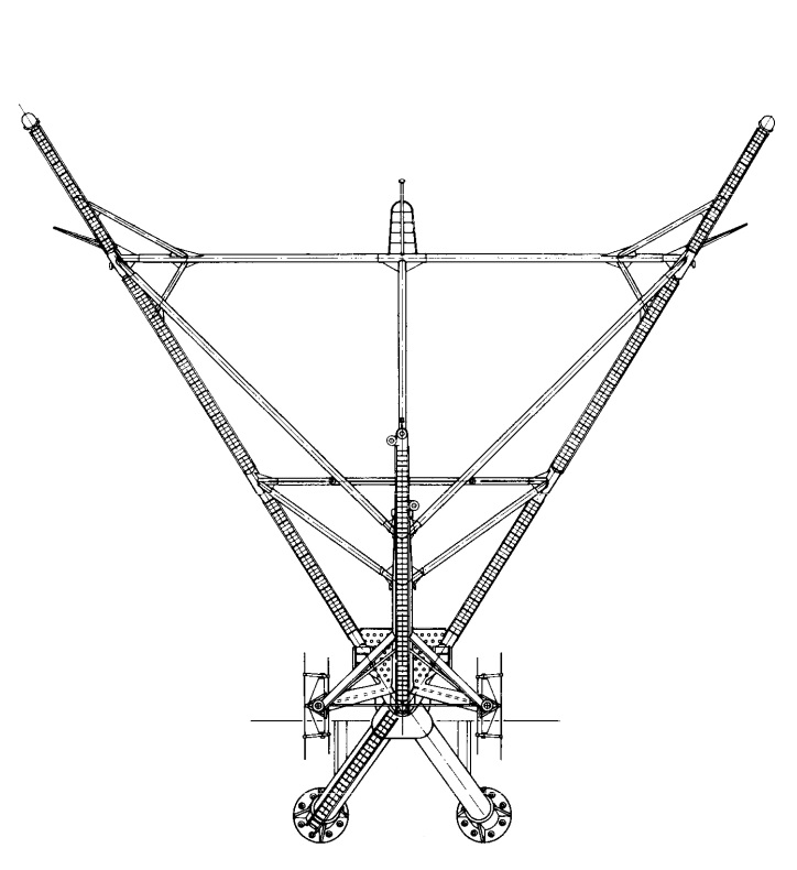

See pic 02 . It shows the left side of the bridge , front view. You see MC Nr 1 above in this picture.
It leads to the outer tip of the Bridge LEFT Yard ( middle right position in the picture).
Take a closer look to the area in FRONT ( left upper corner) of the black illumination strip in the ceiling, in front of the bridge : MC Nr 1 features , in chronological order : 1 bifurcation downwards with a White Cylinder Insulator , followed by 1 brown ball insulator. Then you see : 1 bifurcation downwards with a White Cylinder Insulator , and finally : 1 White Cylinder Insulator, attached in line on MC Nr 1.
Notice 2 : The 2 White Cylindrical Insulators that are attached to this bifurcation downwards will be discussed later :
they are NO part of this rigging chapter and will be discussed in rigging step �MC Nr 1 & 4 split
to 155mmFront Antenna�.
The brown ball insulator between the 2 downward bifurcations is the LAST brown ball insulator of the series of 10. I here you thinking ��. WHERE exactly is that ?
Ref : Jan Skulski�s AOTS page 37 : this location is at length station Nr 111 or 112, above the back slope of the
Front 155mm Gun .
Fortunately, pic 07 gives you a better view, lengthwise I mean , where the last brown ball insulator is located.
Use your zoom. Knowing that the BBI is attached right between the 2 downward directed white insulators , it will not be too hard in this picture to get a correct proportional impression. You can clearly see WHERE the bifurcations are located , on what distance from the bridge , under which specific angle the lines depart , etc , etc..
Hint : Use your zoom. slightly UNDER the White Cylinder Insulators on MC Nr 1, with the red brick wall as
background, you may discover 3 �other � White Cylinder Insulators. This is MC Nr 4. Alive and kicking !!!

Also noticed on MC Nr 1 ( and Nr 4 ) : 1 White Cylindrical Insulator ( WCI) , attached in line.
Insulator Head Count :
on MC Nr 1 : qty = 10 BBI�s and qty = 1 WCI
on MC Nr 2 : No insulators used
on MC Nr 3 : No insulators used
on MC Nr 4 : qty = 10 BBI�s and qty = 1 WCI

Step 02.07. Rigging 2 Connecting Cables from the Main Yards to the Mid Yard.
Gentlemen ,
today we will talk about the Connecting Cables from the Main Yard tips to the Mid Yard Lug Ring
The pictures.
For convenience, the same colour code for arrows was used in all the pictures.
Blue arrows : Connecting Cable on Port side.
Green arrows : Connecting Cable on Starboard side.
Orange arrow : Connection of Port side Cable to Mid Yard Lug.
Pink arrow: Connection of Starboard side Cable to Mid Yard Lug.
Red arrow : Mid Yard Lug Ring.
White arrows : Main Yard Lugs, port & starboard side.
Black arrows : Main Cable Nr 1&4 Side Lugs.
Yellow ovals : Brown Ball Insulators on Connecting Cables.
Rigging Procedure: See all pictures
The port & starboard connecting cables depart from a Lug Ring at the base of the big lantern on the Main Yard tips. See Pic 003-004-005-006 and white arrows in Pic 001-002-003-004 -005-006 for detail.
Please note that none of these Lug -Rings make contact with the Main Cable 1&4 Lug Rings. The Main Cable Lug Rings are located at OUTER side of the Main Yard tips. See black arrows in Pic 001-002-003-004 -005-006 for detail. The black arrows were introduced to show that all Main Cable Lugs are maybe close near the Connecting Cable Lugs, but they do NOT connect. Main Cables and Connecting Cables have separate Lug Rings. See Pic 003-004-005-006.
The 2 connecting cables meet each other at the Mid Yard Lug,(Red arrow). Both cables are attached with their own loop (Orange and Pink arrow). See Pic 007-008 for detail.
In Pic 008 you can clearly see that the 2 connecting cables are attached with a loop to a small common ring. This small common ring is connected to the Mid Yard Lug Ring.( Red arrow)
The philosophy in this rigging step is :
Both connecting cables run from a Lug ring on the inner side of both Main Yards towards the Mid Yard Lug ring, to which both cable loops are connected with a smaller common ring.
Insulator count :
Each of the connecting cables contain 2 brown ball-insulators: one near the Mid-Yard tip (port and starboard side) and one near the Main Yard-tips (port and starboard side). See all pictures, yellow ovals.
But definitely check Pic 001: this is the only place on which you will find the 4 brown ball-insulators in 1 same picture. All the other pictures lack at least 1 insulator in their view.
Total amount of insulators used in this rigging step : qty = 4 brown ball-insulators.
This is the end of step 02.07. Rigging of 2 Connecting Cables from the Main Yard tips to the Mid Yard Lug Ring.
This is also the end of CHAPTER 02 - BRIDGE
Next Main Chapter : CHAPTER 03 - MIDSHIP
Next rigging step : 03.00. Mast Assembly Part 1.
Gentlemen,
have a nice day.

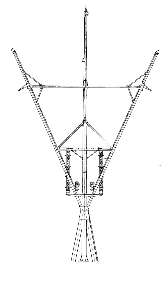

The Mast Assembly on Yamato is built out of 3 big sub-assemblies :
The first one is the Mast-Base Support, then we have the Unison Sleeve, and finally, we see the 3 Mast arms that are sticking out above the Unison Sleeve.
Beside these 3 important structure-components, we also notice two big triangular reinforcements and 2 Junction Beams. All will be explained in the next article.
Let�s start.
1. Mast Base Support : See Pic 001: Mast Assy Overview
The Mast Base is a tripod. The triangular shape formed by this tripod is located behind the Funnel. The FLAT side of the triangle is facing the bow side of the ship while the triangle-tip is facing the AFT ship (stern side). All 3 big support beams (420 mm diameter) are connected to the ships deck with 3 gigantic braces. See Pic 002: yellow circle
The rear base support beam is not inclined and goes vertically up to the unison sleeve. The 2 front support beams are tilted backwards and come together with the rear support under the unison sleeve. These 3 big beams together form the base support of the Mast Assembly.
2. The Unison Sleeve :
The 3 support beams come together at a height of +/- 7,00m and disappear under a triangular steel casing: the unison sleeve. See Pic 004: yellow circle
The contact area between the 3 supports is not visible because it is hidden under the unison sleeve outer skin.
The sleeve is a construction of metal sheet that surrounds completely the upper part of the 3 support legs and the Underside of the 3 Mast Arms.
It has 3 flat sides with 3 round corners, perfectly surrounding the structural shape of the round base tubes and it is closed at the top and at the bottom.
3. The 3 Mast Units �above� the unison sleeve.
ABOVE the unison sleeve, the Main Mast and the 2 Side Mast Arms rise upwards, forming (again) a tripod shape: the Main Mast at the front and the 2 Side Mast Arms to the aft sides.
One may think that the 3 upper masts will follow the same angle and centerline as the 3 base support legs underneath, but: No ! It�s not the case. Look at Pic 005: Rear view, Pic 006: Upper view & Pic 007: Side view.
In the side view, you see that the (front) Main Mast above the unison sleeve has the same angle (and centerline) as the 2 Front legs of the Base Support Unit under the sleeve.
But the 2 Side Mast Arms above the unison sleeve are tilted slightly backwards to an angle that has not the same centerline of the lower support legs. See pic 007 : The inclination of the the 2 Side Mast Arms above the sleeve is bigger than the angle of the 2 lower front beams, installed on the deck.
All 3 Mast-Units above the unison sleeve have a tapered shape towards their end. At the unison sleeve, the Main Mast beam has a diameter of 360mm and at the end it is only 210mm.
From the Main mast tip to the deck, it is 27meters long, (inclined position) from which 20 meters extend ABOVE the sleeve.
Both Side Mast Arms have a diameter of 220mm near the unison sleeve and at their tip they have a diameter of 160mm.

On the Mast Assy , there is an Upper and a Lower triangle. The Upper Triangle,( the biggest one), is located on top, while the (smaller) Lower Triangle is installed lower on the Mast Assembly.
See pic 009: Red Lines show the Upper Triangle while the Green Lines show the Lower Triangle. A= Main Mast B= Porst Side Mast & C= Starboard Side Mast.
The triangle structure beams have a much smaller diameter than the base-support beams (140mm versus 360mm), and just like the base-support beams under the unison sleeve, they have a cylindrical shape.
Remark : the Main Mast and 2 Side Masts above the unison sleeve are NOT cylindrical but tapered towards their end-tips.
4.A. Upper Triangle
At 4,25m from the Side Mast Arm Tips, we see the Upper Triangle that connects the 3 main Masts with each other : the Upper Triangle. See pic 009 & 010 : Red Lines.
The Aft beam of the Upper Triangle is installed between the port & starboard Side Mast Arms.( B-C). The 2 Front beams of the triangle lead both to the Main Mast (B-A) & (C-A).
So far, it remains quite simple. One can say that the Upper triangle is installed in an almost HORIZONTAL position. See Pic 013: blue line: Upper Triangle installation angle.

The yellow circles in Pic 014 are the 3 Lower Triangle beams that are welded to the Main Mast & 2 Side Mast Arms.
Special feature: in Pic 014 you can see that the Aft beam of the Lower Triangle has a strange kind of vertical railing : see red line.
I compared the size of this �railing� with the ship railing on the deck and this one is much smaller than the real deck railing. To my humble opinion, this construction is not suitable to be a full-fledged railing for the Yamato crew.

Red Lines: Upper triangle. Red Circles : upper & lower connection plates at Main Mast and Side Mast on Starboard side.
Green Lines : Lower triangle, Green circles: upper & lower connection plates at Main Mast on Port & Starboard side.

The yellow circles in Pic 014 show the very distinctive shape of the triangular connection plates that connect the Lower triangle to the Main Mast and 2 Side Mast arms.
Just like the Upper Triangle, the Lower one is connected to the Main Mast & Side Mast Arms with 12 Connection Plates : 4 plates on the Main Mast and 8 plates for the 2 Side Masts.
See also pic 10: green circles. The Connection Plates on the Lower Triangle are smaller than those on the Upper Triangle.

Although the Upper Triangle is already a quite rigid reinforcement for the 3 masts, it also contains additional reinforcements.
On the AFT Upper Triangle Beam, (Pic 011: red stripe) at the 2 Side Mast Arms, you see 4 smaller beams (Pic 011& 008 : yellow stripes). Each beam is welded to a multi-shaped metal plate (Pic 011: small Yellow circles)( Pic 012 : blue circles)
(Pic 008 : yellow circles) that is welded on the upper and lower side of the Upper Triangle Aft Beam.
These 4 Triangle Reinforcement Beams lead towards the Side Mast Arms where they connect via a smaller triangular connection plate.
Pic 011 : blue circles.
Pic 012 : yellow circles.
Remark 1 :
Triangle Reinforcement Beams are aligned with the 2 Side Mast Arms, having the same angle backwards.
That�s the reason why you can NOT see them in the Side View of Pic 007. But in the Pic 005 Rear view and Pic 006 Upper view, you can see clearly their specific shape & location.
Remark 2:
Triangle Reinforcement Beams ONLY appear on the Upper Triangle.
The Front beams of the Upper Triangle, have NO Reinforcement Beams at all.
Remark 3:

So where exactly do the 2 Front Beams of the Lower Triangle connect to the Front Main Mast ? Answer : At a distance of 16,3m measured from the deck on the front of the main mast.
See Pic 013 : Blue line = installation angle Upper Triangle
Yellow line = installation angle Lower Triangle
A= Lower triangle beam between the 2 Side Mast Arms.
B=Arrival point of Lower Triangle Beams on the Main Mast Aft side
Reference : New Anatomy of the ship - Yamato & Musashi, fig D1/1 on page 200.

The Lower (inclined) junction beam connects the Lower Triangle tip at the Main Mast (C )with the Underside of the reinforcement plate(not visible in this picture), in the center of the Upper triangle AFT beam. (B )
What is also special on the lower junction beam : on its upper side there is a ladder installed. See Red arrows : ladder trajectory.
And on the location where the lower junction beam is attached to the Underside of the Upper Triangle aft beam(B ), the shape of the junction beam changes into a small diameter rod which extends in the same line as the lower the junction beam. See Red Circle.
Around the small diameter rod you see a sort of � screen�. That screen is what I call : the �strange� ladder.
For God�s sake, why do they need a ladder, in THAT location ?
Very simple : at the end of the rod ( Pic 015: green circle ) you can see a small pulley hanging straight down, above the Aft Rangefinder. From the Aft Rangefinder platform, a white cord is coming up, running through the pulley and going back down.
And the white cord in that pully, is the line that carries the Imperial Japanese Navy Ensign & Samurai Banner.
See Pic 016:
Red circle : ladder
Red line : Lower Junction Beam
Blue circle : Pulley for white cord
Yellow line : white Ensign & Banner cord , hanging down to the Aft Range Finder Front Side ( stern side ship)
4. The Upper & Lower Mast Reinforcement Triangles
The mast shape and its strength (above the unison sleeve) is assured by the installation of 2 triangular reinforcements.
But these reinforcements are not really perfect triangles.
Let me explain :
In reality they are reinforcements, installed in a triangular form, but with the 3 triangle-tips missing.
The triangle beam-ends are (independently of each other) welded to the Main Mast and Side Mast beams at a small distance from each other. They give you the impression they are a perfect triangle, but no : the tips are missing. Nevertheless, to simplify communication we will use the name �triangles�.

5.A. The Upper Triangle �Connection Plates�.
As mentioned earlier: each triangle beam is attached to the 3 Mast beams with a weld seam. So in total we have 6 welded beam ends. To reinforce this connection, EACH of these 6 contact area�s is equipped with 2 Connection Plates: 1 on the top side and a second on the bottom side of each triangle beam : See pic 010

5.B. The Lower Triangle� Connection Plates�.

9.A. Main Mast
1.Main Mast Pulley for Vice Admirals Flag Cord.
See Pic 018 :
White arrow at mast tip (A): White Cord pulley at Mast tip.
White arrow at Searchlight Platform (B) : White Cord pulley attached to the Searchlight Platform Railing ( stern side).
Blue arrows : trajectory of White Flag Cord.
See Pic 019 :
Yellow arrow at mast tip (A) & Yellow circle : White Cord pulley at Mast tip.
See Pic 020 :
Big White arrow : Pulley at front railing of searchlight platform.
Green arrow : Pulley bracket at front railing of searchlight platform.
The Vice-Admirals White Flag Cord is a double white cord. It runs through a pulley on the back of the Main Mast -tip ( Pic 019 yellow circle) at the bottom of the Lower lantern on the aft side of the mast, downwards to the Searchlight Platform Railing. See Pic 020.
At the searchlight platform, The White Cord is contained in a pulley (Pic 020 white arrow) that is attached with a bracket to the SLPF railing (Pic 020 green arrow).

3. Main Mast Lower Lug(s)
The 2 Main Mast Lower Lugs are located :
- On the port & starboard side of the Main Mast
- At the connection point where the Front Lower Triangle-tip is attached to the Aft Side of the Main Mast Arm.
See Pic 023: Yellow circle: general view of the port side Lower Lug�s specific location.
See Pic 024: Yellow Arrows : Port Side Lower Lug in detail: you �ll see that the Lower Lug secures 3 different cables : Two cables from below (B) and 1 cable from above (A).
The Main Mast Lower Lug is not a � common � ring. It has a special shape. The cables from above and below do not connect right next to each other. There is a certain distance between them.
See Pic 025 : Starboard Side Lower Lug DETAIL: Yellow Arrows : What we see here, is that the Main Mast Lower Lug is a half-round double flanged bracket with an attachment ring at both ends.
The 3 different cables are connected to a cable-eye at the upper (A) and lower (B) part of that bracket. They do NOT touch each other. My humble opinion : the Lower Lug has been conceived this way to avoid interference between cable-ends and the Main Mast beam
9.B. Side Mast Arms.
1. port & starboard Side Mast-tip Lugs
See Pic 026 : General View
Yellow circles : the 2 side Mast tips where a bunch of cables arrive at different Lugs.
See Pic 027 : Starboard Side Mast tip : Yellow numbers show all the cables that arrive from different locations to the Side Mast tip-Lug.
1 : One Cable from front arrives on the Front of the tip-Lug.
2 & 3: Two Cables from outer side arrive on the Outer Side of the tip-Lug.
4-5-6 : Three Cables arrive from behind on the Aft side of the tip Lug.
7 : One Cable from the other Side Mast Arm-tip arrives at the Inner Side of the tip-Lug.
Counting the amount of cables that arrive from all different locations we can conclude that on each Side Mast Arm -tip, we see 4 Lugs : 1 Front Lug, 1 Outer Lug, 1 Aft Lug & 1 Inner Lug.
2.(White Cord) Triangles
See Pic 028 : Yellow circles : Location of the ( White Cord) Triangles at both Side Mast Arms.
See Pic 029 : Yellow circle : Detail of ( White Cord) Triangle at port side. Yellow lines: Upper Triangle Beams
See Pic 030 : Yellow circle : Port Side Triangle with White Cord running through Pulley on a Bracket. Yellow lines: Upper Triangle Beams
The 2 (White Cord) Triangles are very fine constructions that are located at the Outsides of the Side Mast Arms, a fraction higher than the contact point where the Aft Upper Triangle Reinforcement beam is welded on both Side Mast Arms. See blue circle in Pic 030 and yellow circles in Pic 028.
Their only task is to lead the white cord that departs from the left Rear Range Finder Brackets and follows a trajectory upwards via the left (white cord) triangle and further downwards to the Aft side of the Lower Triangle beam, then up to the starboard (white cord) triangle on the starboard Side Mast and then again downwards further to the starboard Rear Range Finder Brackets.
Remark : the(White Cord) Triangles are not as heavy or sturdy as other brackets or devices on the Mast Assembly because they "only" guide White Flag Cord.
White Flag Cord is less thick and much lighter than the (black) cables that are used on Yamato's Mast Assembly.

See Pic 037 : Mast Base & Unison Sleeve
Yellow Lines : ladders from the SLPF to the Left Front Support Mast Beam on the ships deck.
Please note that once above the unison sleeve, the ladder is bowed to follow the trajectory of the Mast to the SLPF.

See Pic 040: Pic shows detail of the SLPF, including railing.

Next to the SLPF in Pic 040, you see also 2 antenna�s, installed at the Front of the Main Mast at both sides of the SLPF in such a way that crew members climbing on the Mast Ladders will not be hindered by the presence of these 2 big constructions. (see pic 038-039-040).

See Pic 018 :
See Pic 019 :
See Pic 020 :
2.Main Mast Upper Lug
See Pic 021 :
Yellow arrows : trajectory of 2 Cables coming from Bridge Main Yards.
White arrow & circle : Location at Main Mast Upper Lug where the 2 cables from the Bridge Main Yards are joined & attached.
See Pic 022 :
Yellow arrow : Main Mast Upper Lug location on Main Mast : Side view
There is only 1 Upper Lug and it is located on the front side (bow side) of the Main Mast.
In this lug , the 2 cables (MC3&4) coming from the Bridge Main Yards are joined together. See Pic 022 for dimensional proportion and location.

10. Ladders on the Mast Assy
On Yamato�s Mast Assy we see quite a few (long) ladders.
See Pic 036 :
Blue Lines : ladders on 2 Side Mast Arms
Pink Line : ladder on Upper Connection Beam
Yellow line : ladder on Main Mast Arm
Above described ladders go from the Searchlight Platform all the way up to the lanterns in the Main Mast and 2 Side Masts.
The pink line shows the ladder on the Lower Connection Beam, from the tip, all the way up to the end of the beam, at the pulley for the White Cord of the Vice-Admirals Flag.

Pic 002 � Cables and Branches� is in fact a real picture of the schematic view in Pic 001. It shows dimensions & proportions.
On MC1&4, you see all the branches (yellow) and the cables (blue) that descent to their destination on deck. Branches 1- 4-5 & 6 will convert into one single Cable going down, while Branches 2 & 3 will transform into 2 separate cables.
Hint: it is a good exercise to compare Pic 001 with Pic 002.
Beware of optic illusions when you trace a branch or a cable in this picture.
Pic 003 �All insulators� is similar to Pic 002 but here the different colored circles indicate per Nr the position and the quantity of insulators that are used in this rigging.
Pic 004 � Departure and arrival MC 1&4� shows you with 4 red circles the trajectory that MC1&4 follow in this rigging chapter, from the Main Yards to the Mast tips.
1. Branches & Cables on & from MC1 & 4
As already mentioned, this chapter starts on the Bridge, at the 2 Main Yard tips.
See Pic 004 : the 2 red circles at the 2 Main Yards show where MC1&4 depart from the Bridge area.
See Pic 001& Pic 002 for general view and Pic 010 for detail : This is the starboard view of the front and middle part of MC4 at the starboard Main Yard tip.
The MC4 front part is : from the Flagstaff on the bow to the Bridge Main Yard tip and the middle part is : from the Bridge Main Yard tip to the Side Mast tip.
The front and middle part of MC4 are both connected to a cable-eye on the tip of the starboard Main Yard.
Both part-ends of MC4 are attached to that cable-eye with a bottle screw. Click on Pic 013 to see the detail.
Talking about symmetry: the same rigging process happens to MC1 at port side.
Let�s proceed. Now that we left the Bridge and Main Yards behind Us, we follow MC1&4 further, direction: the Mast tips.
Branch Nr 1 & Cable Nr1:
Pic 001: Branch Nr 1 & Cable Nr 1
Pic 002: Yellow 1 + Blue Nr 1
Pic 003: Green circle Nr 1
Branch Nr 1 is located right above the front side of the Front Searchlight Platforms.
Cable Nr 1 comes down from Branch Nr1 through one white bar-insulator and leads to the (only) rigging bracket on the Front
SL Platform. The bracket is located on the front (Bow) side of the platform wall.
See also Pic 005, 006 & 007 : yellow circles.
Branch Nr 2 & Cables Nr 2 & 3 :
Pic 001: Branch Nr 2 & Cables Nr 2 & 3
Pic 002 : Yellow 2 + Blue Nr 2 & 3
Pic 003: Blue circle Nr 2
Branch Nr 2 is located right above the center of the Middle Searchlight Platforms.
Branch 2 comes down through 2 white bar-insulators in line, and splits hereafter into Cables Nr 2 & 3 before heading towards the rigging brackets on both sides of the Middle Searchlight Platform Wall.
See also Pic 005, 006 & 008 : yellow circles.
Branch Nr 3 & Cables Nr 4 & 5 :
Pic 001: Branch Nr 3 & Cables Nr 4 & 5
Pic 002:Yellow 3 + Blue Nr 4 & 5
Pic 003: Blue circle Nr 3
Branch Nr 3 is located right above the center of the Aft Search-light Platforms.
Branch Nr 3 comes down through 2 white bar-insulators in line, and splits hereafter into Cables Nr 4 & 5 before heading towards the rigging brackets on both sides of the Aft Searchlight Platform Wall.
See also Pic 005, 006 & 009 : yellow circles.
Branch Nr 4 & Cable Nr 6 :
Pic 001: Branch Nr 4 & Cable Nr 6
Pic 002: Yellow 4 + Blue Nr 6
Pic 003: Blue circle Nr 4 + Red Circle Nr 4A
Branch Nr 4 is located right above the center of the Mid Ship Aft Range Finder.
Cable Nr 6 comes down from Branch Nr 4 through 2 white bar-insulators in line, and leads via a 3rd white bar-insulator to a single cable-eye at the bottom of the Mid Ship Aft Range Finder wall.
See Pic 005: yellow circle on Mid Ship Aft Range Finder
Pic 011 : yellow circle = Mid Ship Aft Range Finder
Blue circle = attachment for Cable Nr 6
Exactly �where� on Cable 6 is this �3rd white bar insulator � installed ?? Take a look at Pic 014:
The yellow circle shows the 2 white bar-insulators in line near Branch Nr 4 and in the green circle we see the 3rd white bar-insulator.
The light- blue circle is the attachment point for cable Nr 6.
With this picture you have a slight idea about dimensions and proportions of the insulators location on Cable Nr 6.

See Pic 001 & Pic 004: Red circles at mast
See also Pic 015: green circles: this is the place where MC1&4 reach the cable-eyes on the front of the Mast tips and blue circles show the location of the 2 brown ball insulators.

2. Searchlight Platforms & their typical rigging brackets
See pic 005 � 006 � 007 � 008 � 009 - 011.
Searchlight platforms are major contributors when talking about Rigging of MC1&4 above the Mid Ship.
At both sides of the enormous Funnel there are qty=3 each 150cm Search-light Platforms.
Each SL platform is surrounded by a metal wall with a very specific shape. On the outside of the metal wall we find one - or two brackets that are the end-station for the different Cables that come from the Branches on MC1&4. All Searchlight platforms get their names from their relative position on the ship�s front or aft side.
Front = Facing the BOW direction of the ship.
Aft = facing the STERN position of the ship.
Middle = between Front & Aft SLPF �s.
2.1. FRONT Searchlicht Platforms
See pic 005 - 006 - 008
Both Front Searchlight Platforms are located aside & at the front of the Funnel base and their floor is 1 level LOWER than the other Searchlight Platforms and also 1 level lower than the Funnel walkway�See Pic 005 -006
Detail: Both Front SLPF�s have only ONE rigging bracket. see pic 005 - 006 � 007 : yellow circles
The bracket is a triangular shaped rod, with 1 support rod in the middle, welded to the outer front (bow) side of the Platform Wall.
Via Branch Nr 1, Cable Nr 1 is attached to this bracket. See pic 001
MIRROR VIEW effect when talking about rigging .
On starboard side, the bracket is located at the Right side of the SL platform.
On the Port side, this bracket is located at the Left side of the SL platform.
But nevertheless that obvious difference : both times the bracket is located at the Bow-side of the platform wall.
THAT is what I call : the mirror-effect. See pic 005-006-007
2.2. MIDDLE Searchlicht Platforms
Like the word says, the Middle SLPF�s are located between the Front and Aft SL platforms, somewhere near the middle of the Funnel.
The middle SLPF is mounted at the same height level as the Funnel Walkway and the Aft SLPF floor level.
Detail: Both Middle SLPF�s have rigging brackets at both sides of the platform Wall. In both cases, it�s a triangular shaped rod, with 1 support rod in the middle, welded on the outer edge of the wall.
See detail in pic 008, yellow circles.
Via Branch Nr 2, Cables Nr 2& 3 are attached to the brackets of the Middle SLPF. See pic 001
2.3. AFT Searchlicht Platforms
See pic 005 � 006 - 009
These 2 SL platforms (port and starboard side) are installed, between the Midship fire control tower and the direction finder.
The Aft SLPF�s are installed at the same height level as the Middle SLPF�s. See pic 005 - 006.
Just like the Middle SLPF�s, the Aft SLPF�s have also 2 rigging brackets. But here we see a structural difference between the front and aft brackets.
The front bracket (bow side) has the same triangular shape as the Front & Middle SLPF brackets, but the rear bracket (stern side) is a big massive metal rod with flat surfaces, slightly tapered and with a cable-eye on it. See Pic 009. It extends far more from the platform wall than the triangular shaped brackets do. See pic 005 � 006
Pic 009 : Yellow circle = triangular shaped bracket and Blue circle = solid flat rod bracket
Via Branch Nr 3, Cables Nr 4& 5 are attached to the brackets of each AFT SLPF (port & starboard).
Cable Nr 5 is attached to the rear (stern side) solid bracket while Cable Nr 4 is attached to the triangular front (bow side) bracket. See pic 001& Pic 005-006-009
Remark
People with sense for detail among you might have noticed something odd when looking at the stern side bracket in Pic 009.
Indeed, the stern side brackets of the Aft SL platforms have a special feature: not only they receive cable Nr 5 (from MC1&4) but at the right side of the picture you can also see another cable that DEPARTS from this bracket.
And here is a second hint: See Pic 001 on the left side. You will see Cable Nr 9 that starts at the stern bracket of the Aft SLPF. From there it goes upwards to a cable-eye at the upper side of the 2 Side Mast Arms. So why is cable Nr 9 not discussed in this rigging chapter ?
Cable Nr 9 will not be mentioned for one simple reason: it is a connection from a Searchlight Platform to the Side Masts. All the cables we discussed in this chapter are coming from Branches.
And because this cable is a connection to the Side-Mast arms, it will be treated in a separate rigging chapter named : Rigging of Cable Nr 9 to the Side Mast Lugs.
This terminates the Rigging of the 6 Searchlight Platforms.
3. Midship Aft Range Finders
The Midship Aft Range Finder is located between the Aft Searchlight Platforms and the Mid Ship Aft AAA Platforms.
At the bottom of their outer wall there is a cable-eye installed.
See Pic 001: Via Branch Nr 4, Cable Nr 6 is attached to this cable-eye.
See also Pic 011. Yellow circle = the Range Finder itself and blue circle is the cable-eye where Cable Nr 6 is attached.
4. Midship Aft AAA Platforms
Right next to the aft side of the Midship Aft Range Finders (stern side), we see a triple 23mm AAA Platform surrounded by its protection wall. At the front side (bow-side) of the wall there is a cable-eye installed just under the upper wall edge.
See Pic 001 : Via Branch Nr 5, Cable Nr 7 is attached to this cable-eye.
See also Pic 012. Yellow circle = the Aft AAA Platform and the blue circle is the cable-eye where Cable Nr 7 is attached.
5. Midship Aft AAA Platform Structure Support
The Mid Ship Aft AAA Platform Support is in fact a part of the Aft Ship and although it is really a metal structure with 3 windows, it literally supports the stern side of the Aft AAA Platform. Hence the name : Structure Support.
See Pic 001 : Via Branch Nr 6 , Cable Nr 8 is attached to the cable-eye of the AAA-platform support.
See also Pic 013. The yellow circle is the platform support structure and the red circle is the cable-eye at the stern side of the structure.

See Pic 001 � Midship Rigging Scheme� and Pic 003 � All Insulators�.
- Starting from the Main Yards at the bridge, qty= 4 brown ball-insulators are used on MC1 and MC4 together. Pic 003: yellow circles near the bridge.
- On branch 1, cable 1, qty = 2 White Bar-insulators are used on MC1&4 together.. Pic 003 : green circles Nr 1. Pic 001 : Cable Nr 1
- On branch 2, cable 2&3, qty = 4 White Bar-insulators are used on MC1&4 together.. Pic 003 : blue circles Nr 2. Pic 001 : Cable Nr 2 & 3
- On branch 3, cable 4&5 qty = 4 White Bar-insulators are used on MC1&4 together.. Pic 003 : blue circles Nr 3. Pic 001: Cable Nr 4 & 5
- On branch 4, cable 6, qty = 6 White Bar-insulators are used on MC1&4 together.. Pic 003 : blue circles Nr 4. Pic 001: Cable Nr 6
- On branch 5, cable 7, qty = 4 White Bar-insulators are used on MC1&4 together..Pic 003 : blue circles Nr 5. Pic 001: Cable Nr 7
- On branch 6, cable 8, qty = 2 White Bar-insulators are used on MC1&4 together.. Pic 003 : green circles near the Side Mast Arm tips. Pic 001: Cable Nr 8.
- On the Mast Side Arm Tips where MC1&4 arrive, qty= 4 brown ball-insulators are used on MC1 and MC4 together..Pic 003 : yellow circles near the Side Mast Arm tips.
Total amount of Insulators used in this rigging step : qty = 8 Brown Ball Insulators & 22 White Bar-insulators.
Branch Nr 5 & Cable Nr 7 :
Pic 001: Branch Nr 5 & Cable Nr 7
Pic 002: Yellow 5 + Blue Nr 7
Pic 003: Blue circle Nr 5
Branch Nr 5 is located right above the front side of the Mid Ship
Aft AAA Platform.
Cable Nr 7 comes down from Branch Nr 5 through 2 white bar-insulators in line and goes to a cable eye at the Front (Bow-side) edge of the AAA Platform Wall.
See Pic 012 : the yellow circle is the Mid Ship Aft AAA Plat-form and the blue circle is the attachment for cable Nr 7.
Branch Nr 6 & Cable Nr 8 :
Pic 001: Branch Nr 6 & Cable Nr 8
Pic 002: Yellow 6 + Blue Nr 8
Pic 003: Green circle Nr 6
Branch Nr 6 is located right above the Aft side (Stern side) of the Aft AAA Platform Structure Support.
Cable Nr 8 comes down from Branch Nr 6 through 1white bar-insulator and leads to a cable-eye that is installed on top of the aft edge of the Support wall.
See Pic 013 : the yellow circle is the Aft AAA Platform Structure Support, the red circle is the attachment for cable Nr 8.
After Branch 6 we proceed with MC1&4, and little before we arrive at the big lanterns on top of each Side-Mast, we encounter qty = 2 brown ball insulators. After the insulators, MC1&4 are attached to the cable-eyes at the front side of the Side Mast tips.
So far, we talked about the rigging of MC1&4 between the Bridge Main Yards and the Side Mast Arm tips.
After this, we looked at the Branches and Cable connections.
Now we will have a look at the � hardware on deck� which is involved by this rigging chapter.
We will continue this rigging with the following subjects :
- Search Light Platforms (SLPF�s): front � middle � aft.
- Mid Ship Aft Range Finders (port & starboard)
- Mid Ship Aft AAA Platforms + Support Structure.
- Insulators quantities & locations
Remark
Insulator Count
This is the end of step 03.01.Rigging of MC1&4 from Bridge Main Yard tips to Side Mast tips.
Next rigging step: 03.02. Rigging of Cable Nr 9 to the Side Mast Lugs.
