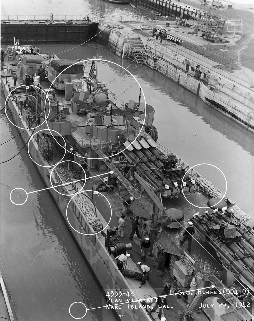

Here is one of the photos dated 5 August 1942.
Before the twin 40-mm mounts were installed, the "surviving" SIMS class units in the Pacific went through one of two interim configurations to get two additional 20-mm guns installed on the aft deckhouse after Battle of Midway.
USS MUSTIN had what I call the "diamond" pattern for four 20-mm guns arrayed around the searchlight, as seen on USS HUGHES.
Some of the NorNY group retained the small searchlight deckhouse (minus the searchlight) atop the aft deckhouse, and two 20-mm guns were added aft of the two 20-mm guns already mounted there. I call the layout of the 20-mm guns in this case the "square" pattern. This photo of USS RUSSELL (DD-414) illustrates the layout.
Thanks! :woo_hoo:
Cool. This configuration is new to me. I just wanted to ask a question about your photos Russell on 27-28 October 1942.

DD-410 HUGHES - "diamond"
DD-416 WALKE - "diamond"

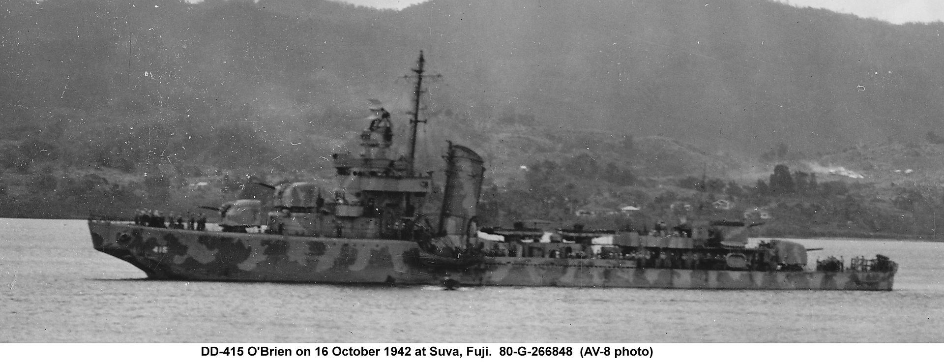

What about DD-415 O'BRIEN? Friedman in the US Destroyers has DD-415 scheme similar to a "square". But I'm not sure if it's correct. Despite this photo's poor quality, I'm almost sure the small searchlight deckhouse isn't there.
https://www.navsource.org/archives/05/pix1/0541522.jpg

Posts: 3841
USS O'BRIEN (DD-415) is one of the units with few photos between January 1942 and her loss. The last photos of O'BRIEN after her fatal damage are by and large distant and poor quality. But, as Dick said, she had the aft small deckhouse (formerly for the searchlight) at her end. This close-crop image I scanned at NARA maybe of better quality.
Have you taken the time to go through all the pages in this thread on the SIMS class? I have posted most of these images and comments along the way in my searching at NARA.
Of the five "NorNY modified" SIMS (this was the initial King Board mods, the ChNY mods were an improved configuration that saved weight and prepared for when twin 40-mm mounts were available);
DD-409 SIMS ... Lost before any additional upgrades
DD-410 HUGHES ... had small former searchlight deckhouse removed and the "Diamond Pattern 20-mm arrangement" installed at MINY in July 1942.

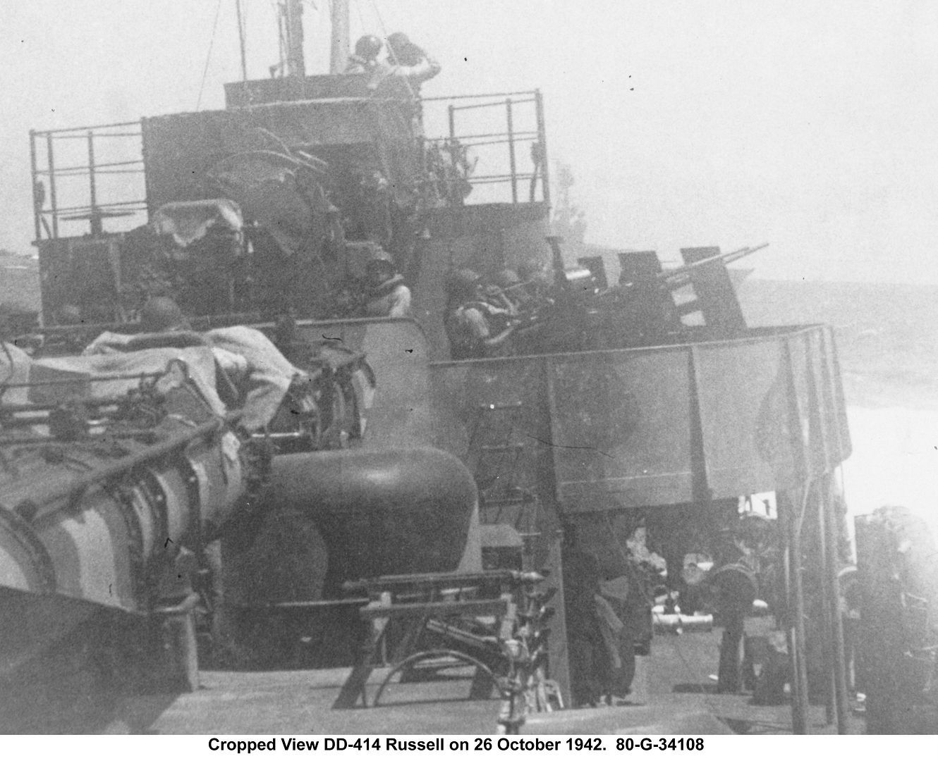

DD-414 RUSSELL ... unclear when the two additional 20-mm guns were added in the "Square Pattern", likely at PHNY, retained configuration until her upgrade with two twin 40-mm mounts at MINY in June-July 1943.
DD-415 O'BRIEN ... unclear when the two additional 20-mm guns were added in the "Square Pattern", likely at PHNY in July 1942, lost in this configuration. (See DANFS entry)
DANFS entry;
O-Brien was retained at Pago Pago for local escort work. On 26 May she supported the occupation of Wallis Island, previously taken over by the Free French and joined Procyon 19 June for the return voyage to Pearl Harbor.
Operating out of Pearl Harbor, the ship performed escort duty and acted as patrol and plane guard. She got underway 17 August 1942 with TF 17 to reinforce the South Pacific Force, screening the oiler Guadalupe. While escorting a convoy of transports enroute to Guadalcanal, joint TFs 17 and 18 were attacked by the Japanese submarines I-15 and I-19 on 15 September 1942. Wasp was sunk; North Carolina and O'Brien were damaged by torpedo attacks.
