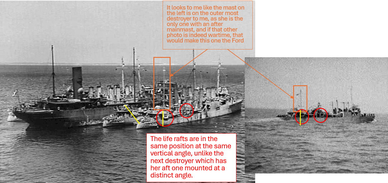

Thanks for the kind words that all that very useful information! Glad to share what I have found myself with the community, more information is always useful, and this conversation is definitely doing to help me with the build.
I also agree that the Asiatic Fleet destroyers were not uniform in their outfits, but I did want to get the general outline of it down, as there do seem to be some general changes which most or in some cases all of them had, like landing the forward starboard life boat. Also, I probably should have been clearer with what I meant by 1942 changes. I don't think they happened during the war itself, all of these happened prewar aside from maybe adding some .30 cals here or there, what I was trying to say and was not clear about is that these are changes they received by 1942 (Like the plates for the bridge windows) as compared to a barebones as completed 1918 Clemson. I'm converting a Flyhawk Ward and their model represents a very barebones prewar Wickes class, so the modifications list I posted I believe happened prewar in their last refits.
As for paint, based on the evidence, I think I am going to paint my destroyer (I haven't quite chosen which yet) in a base coat of light grey, add some rust, and then make Cavite Blue (or something close) and add it as a wash so that it looks like a very battered Cavite Blue fading away in the tropic sun, giving it the very battered look they had.
Lastly, do you think that ID on the Ford from the Kookaburra photo is correct? Because if it is, I think it IDs her in the photo of the four Java Sea survivors around the George G Henry, as the aft mast and life rafts seem to line up perfectly, where as they don't with the next in board destroyer. If the Kookaburra photo is indeed a wartime picture, then Ford is the outmost DD in that other photo. I think this would make her not the destroyer with the Black Hawk in that other photo as the Ford does not seem to have the platform and the ship next to the Black Hawk has it but no main mast, making it one of the other AF DDs.
Thanks again for all that info, and the photo of the other .50 cal position is exactly what I needed even if it is off of a lend lease DD!

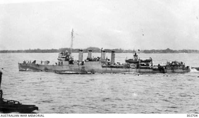

That good to know about the Ford and would definitely help identify her. I am always impressed by the ingenuity of the Asiatic fleet sailors. Unfortunately, I don't think either image has enough resolution in the deckhouse area to confirm if those ships have the said mounting. The image of her next to the George G Henry seems to come from a film, but I can't find it on the AWM and I've been digging for it there for a bit today. HMAS Kanimbla was operating off Java during this period, so in absence of other information, I would tentatively say its the Ford, but a better photo would be great.
I did find a different video which shows several interesting ships including a brief shot of an AF DD from this time period. It was taken on a convoy moving through the Indian Ocean, Java Sea, and Australia in Jan-March 1942.
What appears to be an Asiatic fleet Clemson can be seen for a few seconds at 29:40
https://www.awm.gov.au/collection/C190139

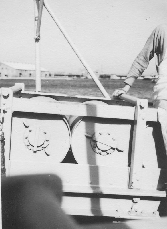

AFAIK the Asiatic Fleet tincans only had DC roll off racks.
I'm just skeptical because the Goodwin pic alleged to be POPE is in a photo album kept by a guy on a ship that did not operate w/POPE, and which has a number of erroneous IDs in it re the Java Campaign.
You're quite right that guys acquired many pics that were reprints..that was common enough. However, taking that viewpoint I might ask, 'Then how come that pic has not showed up in other albums?'
(Or maybe it did. I don't know.)
Anyway, it simply seems at least as strong an argument con as pro.
FWIW
