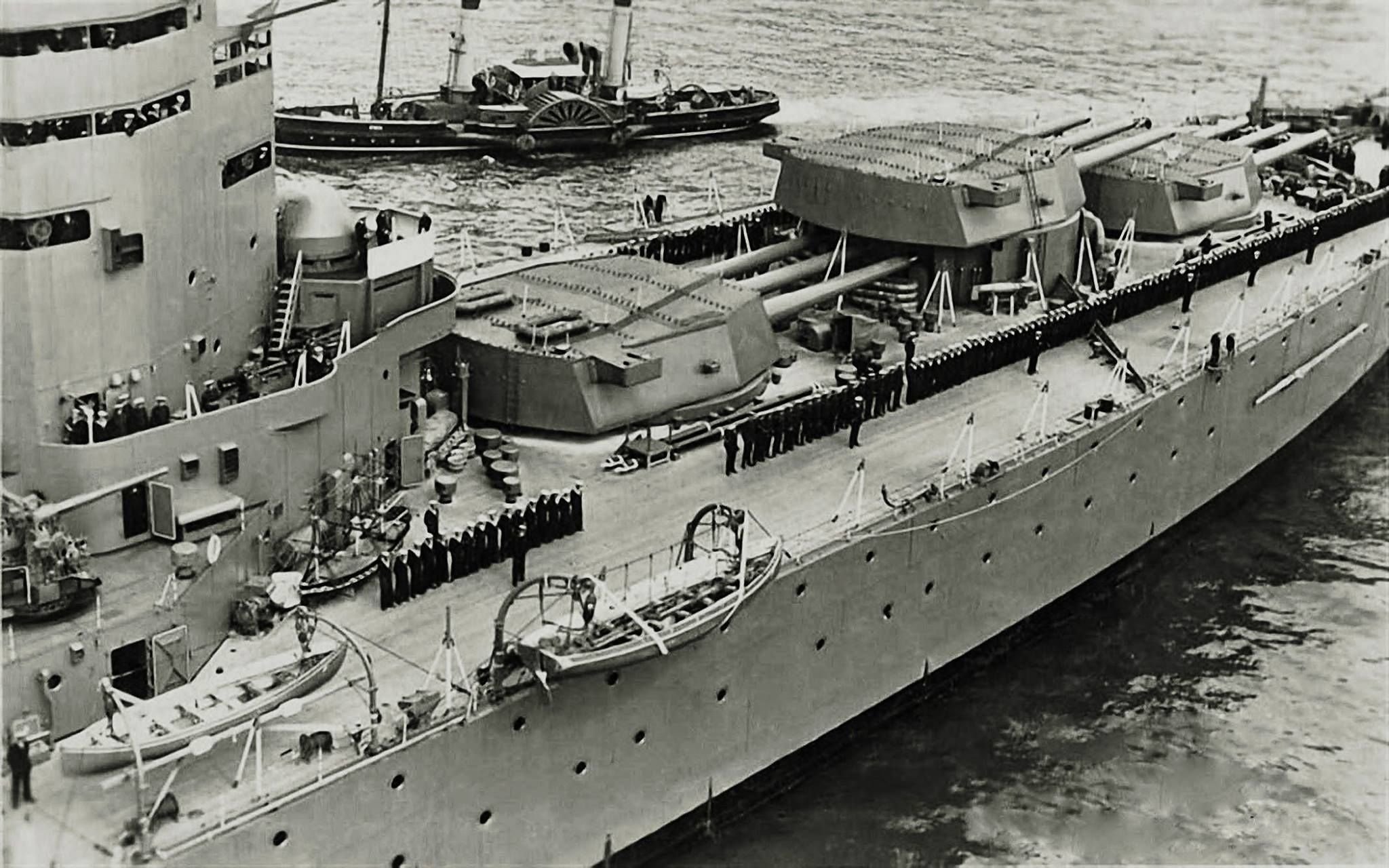

Another question:
What is the accepted deck colour for around the conning tower? the level where the 40mm Single Pompoms, later the 12,7mm MG's were located pre-AA refit?
Is it just darker grey metal or some wood or even Linoleum?
This photo shows that level I think it was called the Conning Tower Platform:
fc677f80abf753223a856c5577545f82.jpg.b4df990aa2b06526bb7e686fa07da6a8.jpg [ 402.19 KiB | Viewed 3265 times ]

If you ask me: I would say Dark Grey painted metal. No Linoleum (Corticene!) for sure, then you would see brass strips to hold these down.
In theory also Semtex could be used, but I never read anything about Semtex on Rodney or Nelson.

Thank you, I will fix my drawing than.
