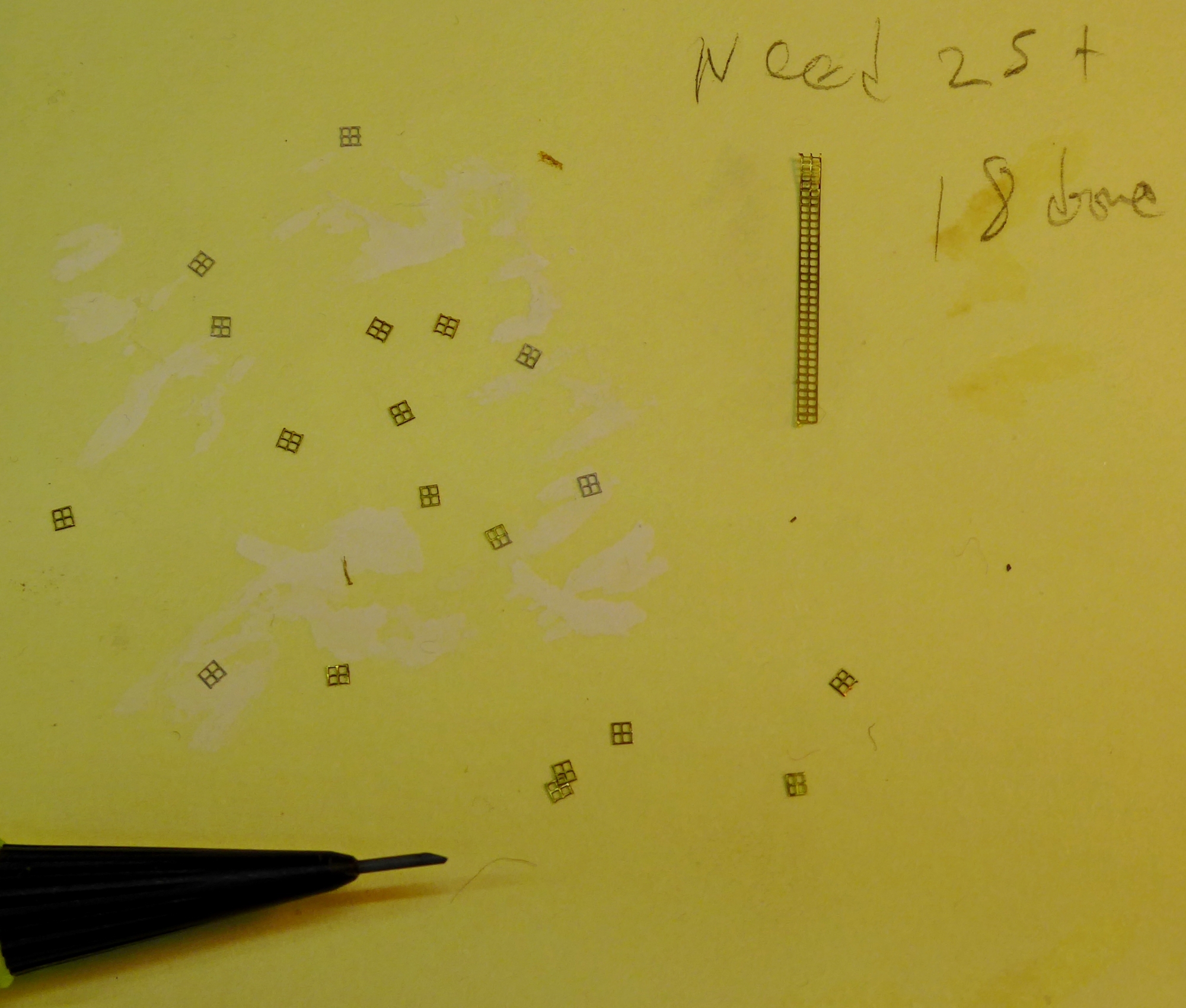

On the face of it this is simple stuff -- but the wooden construction was panelled with 3 x very small( mullioned ) windows ( one behind the wheel )
These were cut from a part fret I suspect was 1/700 North Star French battleship windows-- so it would be kind of appropriate!!
I need quite a lot for the stern windows as well as the apertures below the poopdeck

Instead of individual tiles of windows-- I would use strips of the LR grille decal-- held down and straight with blu-tack at each end ,
then overlay the appropriates size PE, pre-painted- then tack it on to the decal with matt enamel varnish. ( Humbrol Matt-kote )
When dry --another drop of thinned matt varnish spread over the surface bonded the
decal LR grille strips to the PE fully
and only then trim the decal ends with a new 10 blade in a scalpel
Thus..... I ended up with a " kit " of component parts to surround my previously cut 'core '
