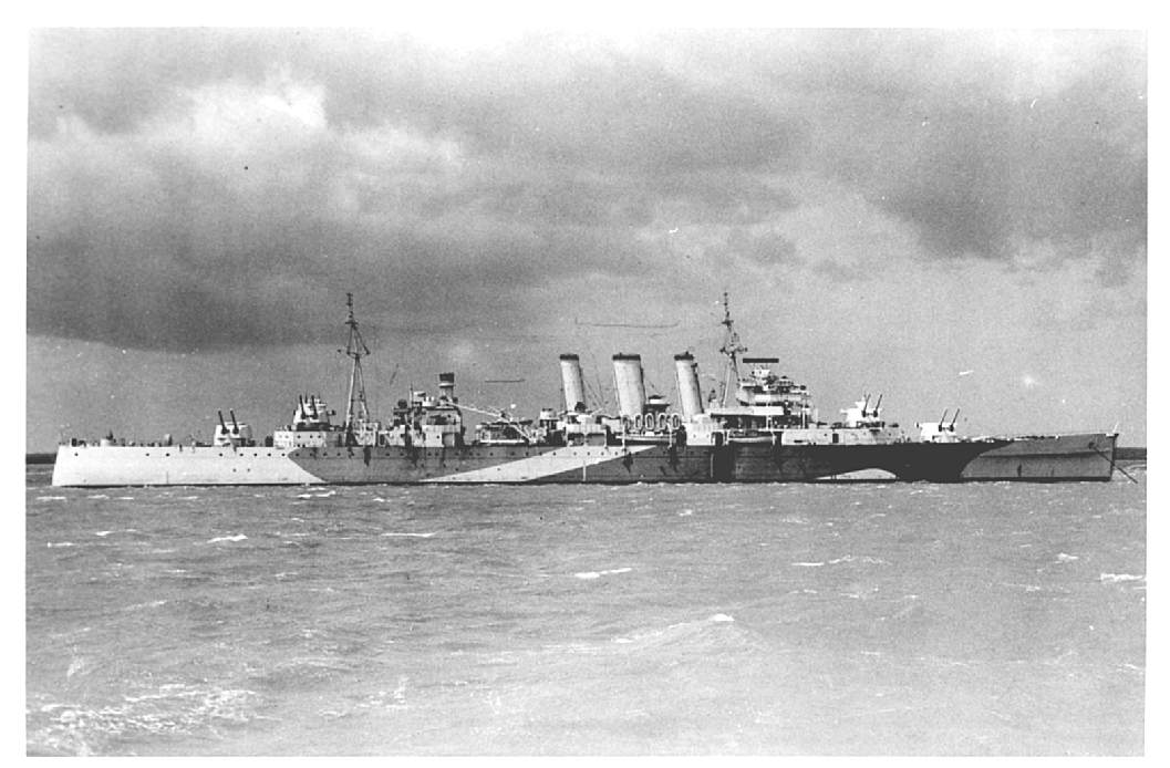

Regarding the starboard side of the pattern, I was quite confused by the three pictures below, which patch would be the darkest colour of the two. You chose for the rearmost, but what's your reasoning behind that choice? I noted someone on Britmodeller having made the opposite choice instead. https://www.britmodeller.com/forums/index.php?/topic/235134898-hms-norfolk-camouflage-colours-battle-of-north-cape/
Forward patch darkest, lighter patch to the rear
Forward patch darkest, but possibly area on the bow same colour as the rearmost patch
Undecided, forward patch slightly darker, but also the area on the bow possibly same colour as rear patch
Rear patch darkest, almost black. Bow clearly the base light grey. Seems to be most in accordance with your model.
Or are we looking at two distinctly diffferent, i.e. reversed schemes? And then, when was this change applied?
Roger Whittaker +9/13/2023
Last edited by Maarten Schönfeld on Tue Mar 05, 2024 10:16 am, edited 2 times in total.

Hi Maarten - good question. I think I have chosen the photo made from the carrier as an argument.
I think that the darker appearance of the lighter colour at the bow - which is not visible on all photos - is an artifact caused by the angle of the hull sides (or there was a change made).
Raven in Warship Perspectives has a different opinion - he drawn the lighter colour at the bow in the same colour as the colour near the main mast and the forward field darker. But Raven's port side pattern looks very different compared to the photos I have found (no similarities at all). Therefore, I have decided to ignore Raven and do my own interpretation based on the photos.
Raven wrote that the design was modified in October 1943 - which could be an explanation for the differences, but it could be also a different interpretation.
Wright shows two different patters for June and December 1943 - differing regarding the two darker colours (MS 3 and B30 on B 55 on the first, 507A and B15 on B 55 on the second). That would fit to the lower contrast on some photos. I know that there are many who criticize Wright and I do not agree with regarding the December 1943 pattern - again, as in Raven, the pattern on the port side is very different from the photos which I have found.
There is also part of the port side pattern, which was unclear to me. There could be an additional darker field midships near the waterline extending from the darker field behind, but on the photos this part was obscured by waves.
Caused by the new findings by Sovereign Hobbies, I am anyway completely confused regarding British colours ;)

Thank you for your explanation. We then should conclude that the starboard scheme was changed in October 1943, only the colours were changed but the pattern stayed effectively the same. Now only remains: which one was before October, and which one after? As the latter then was the scheme worn at North Cape in December.
Wheter the port side was changed as well is still to be determined I'm afraid.

The photo made from USS Ranger in Iceland is dated 17th of October 1943, i.e. that is the pattern she had also in December 1943.
https://www.reddit.com/r/WarshipPorn/comments/dbrfvd/british_heavy_cruiser_hms_norfolk_in_iceland_seen/?rdt=49408
https://www.world-war.co.uk/Dorset/norfolk.php
https://www.facebook.com/144541438966797/photos/a.145186852235589/4384934631594102/
And there are these photos dated December 1943 (in the first one, the rear panel is darker, the second is very dark):
https://www.iwm.org.uk/collections/item/object/205153331
https://www.iwm.org.uk/collections/item/object/205153330
From the portside, I found this photo dated December 1943:
https://www.iwm.org.uk/collections/item/object/205153329
It matches the pattern of the photos linked here:

YES! I agree the first of these excellent photo's is VERY convincing for your theory, the other has too much backlight that we can make out the colour shades.
(note to everyone else: when you open the links to these photos, you'll come into the photo viewer of the Imperial War Museum. Use the zoom button + to focus in to the Norfolk (the smaller of the two ships)
And this leaves us know with the tantalizing question: what did the PORT side really look like BEFORE October 1943? Would that drawing of Alan Raven still have ground and were the colours changed in October, but before December? A least it suggests the bow is painted in a mid-tone, like the photos of the SB side seem to suggest. I personally think the 'knuckle shadow' isn't really explaining what we see on those pictures: the bow is almost exactly the colour of the rear patch (you can check that with cutting away the center part of the photo)
When you cut the mid part of the photo away, the bow is even darker that the rear patch...
But then again: who really wants to build a pre-October 1943 model of HMS Norfolk, as one is intending to build her in the colours of North Cape?
