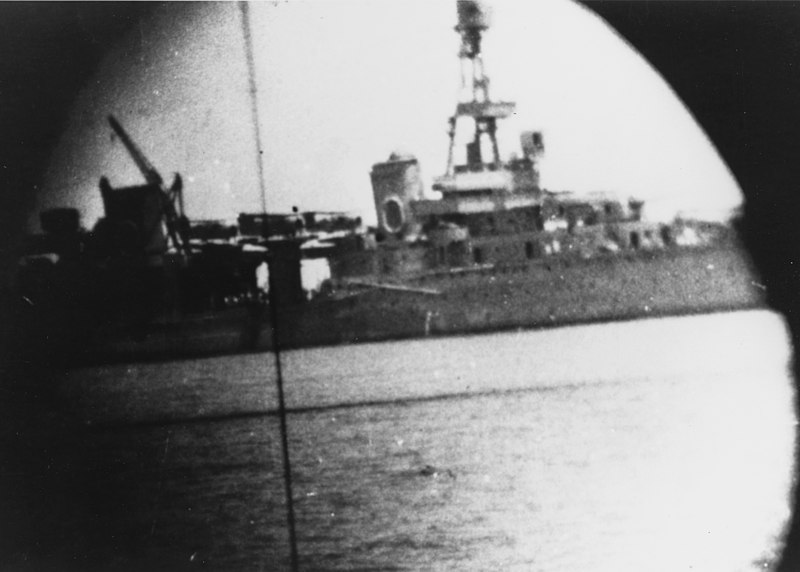

Also apologies if this was already posted earlier in the thread, but here's another image of the Houston showing her camouflage from 1942. Its certainly more grainy, but again shows the Measure 1ish (IIRC Cavite Naval Yard did their own variation of what the Pacific fleet was doing at the time) type camouflage Houston was wearing

The questions re CA-30's paintjob resurface every few years.
The more I look at it again & the more I think about it, I now wonder if this wasn't blast/fire damage. I still do not believe it was a deliberate camo paint scheme. I have some photos of CA-30 being repainted (well before Nov. 1941) and there's nothing resembling that, nor was there anything remotely like it in the Asiatic Fleet from the immediate prewar or NEI periods.

G-Opt wrote:The questions re CA-30's paintjob resurface every few years.
I don't think that blast/fire damage could be responsible for that. That would have required the blast to manage to perfectly discolor the entire turret roof and 8 inch gun barrels the exact same color, or for a fire to have burned on the turret top and barrels at the same intensity for the same amount of time on both the turret and barrels, and that seems too unlikely for me to believe, fire usually doesn't behave like that, especially when it is unintentional. I don't see why that could not have been an addition to her camouflage during her November 1941 refit. It seems pretty clear to me that the turret top and barrels are the same color and the turret top even has the circles in the paint from the wear caused by the life rafts that were there. That wear to me indicates paint on the turret top (as that is consistent with how paint wears), and as the color on the barrels is the same color as the color of the turret roof, it seems to me that it is intentional paintwork on both the turret and the barrels.
Fire/blast damage does not fit that well, and that doesn't look like water to me, so I don't see what that could be other than intentional paint, especially as the 5 inch gun seems to have a similar pattern

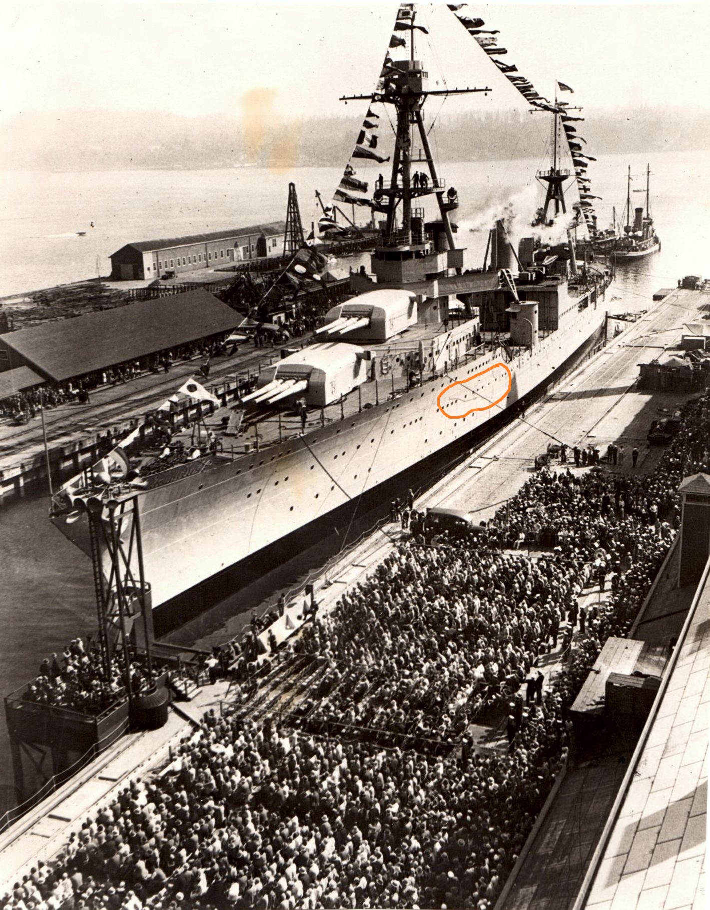

General question for you all (as I'm not able to find anything on this topic) -- the Northampton, Pensacola, and Portland class cruisers all have a visible riveted section of plating above the main armor belt, with tapered ends fore and aft running upwards towards the main deck. What is the purpose of this plating? There is no mention of it in any of the armor tables or battle damage assessments of the damaged ships (Northampton and Chester). It appears as though all the shell plating above the main armor belt up to the main deck is part of a continuous section of riveted plating.
The plating section's ends are visible in this photo of Louisville off Mare Island: https://www.history.navy.mil/content/hi ... 26545.html
The forward plating section is nicely visible in this additional photo of Louisville after refit at Mare Island as well: https://www.history.navy.mil/content/hi ... 30497.html
The battle damage assessment from Chester's torpedo hit in Oct 1942 does not mention anything beyond shell plating in this area, so I'm curious if this section was armor: https://ibiblio.org/hyperwar/USN/WarDam ... PlateI.JPG
I've re-read the appropriate chapters of Friedman's US Cruisers and can't find anything about it either. I know this is a rather obscure topic so appreciate any insights!

is extra plating possibly as a stiffener to strengthen that section of the hull from the 2nd deck to the main & upper decks as not shown in her Booklet of General Plans 1945. she had it since she was built as can be seen in this link.
https://www.navsource.org/archives/04/028/0402855.jpg The Christening and "Launching" of Louisville on 01 September 1930.
https://www.navsource.org/archives/04/028/04028.htm

It's not extra plating, it's how the ships were built back then. Plates overlapped and were riveted for the most part. That's how the Prairie was built. They aren't stiffeners, they are the "outside" of the hull plating, and the inside of the ship looked the same. The hull plating joints weren't "butt" joints, they were "lap" joints.
FFG-7
Posts: 735
Re: Calling all USS Northampton class (CA) fans
Post by FFG-7 »
Guba, Ian is talking about this if I am correct circled in orange. that is not normal practice.
Guba
Posts: 354
Joined: Thu Jan 21, 2016 5:36 pm
Post by Guba »
FFG-7 wrote:Guba, Ian is talking about this if I am correct circled in orange. that is not normal practice.
Oh okay, didn't see that a first, had to zoom in. It looks to me for spreading the weight of the armor belt forward. Maybe there is one going back too...
Ian Roberts
Posts: 314
Location: Austin
Post by Ian Roberts »
That's right -- that area differs from the rest of the shell plating which is what raised questions for me originally. I wondered the same -- if it was meant as a method to help distribute the weight of the armor belt. I'm sure the answer is there somewhere, just not easily available online :)
FFG-7
Posts: 735
Post by FFG-7 »
the hull plates above the armor belt is just covered with rivets which suggests to me is used to stiffen/reinforce that section of the hull.

better view of the riveted plates. https://www.navsource.org/archives/04/031/0403155.jpg Closeup of USS Augusta (CA 31) berthed at Melbourne, Australia after arriving on 29 October 1934. Note aircraft catapults and plane handling facilities.
https://www.navsource.org/archives/04/031/04031.htm

That was called the 'armour-hanging plate', as I recall. Have some very good close-ups from CA-30, which I'll try to locate & post.
G-Opt
Posts: 86
Post by G-Opt »
Here are a few images & some notes I found tonight...Harvested those Dewey drydock close-ups ~25-30 years ago.
The 1935 shot off California with FDR just happened to show the shape of that area well, I thought. Ditto the 1941 image at Cavite...
Hope these are of some interest.
CA30 repaint Cavite41sm.png (116.83 KiB) Viewed 4862 times
Ian Roberts
Posts: 314
Location: Austin
Thanks G-Opt -- was waiting for your reply :) I think that solves it -- so we can consider the "heavily riveted plating" as the "armor hanging plate". Very interesting. Thanks!
