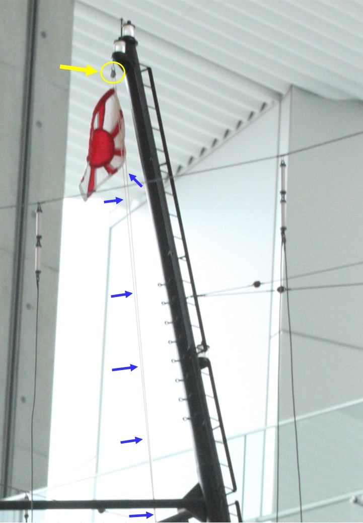

Pic 001 :
Yellow arrow at mast tip: White Cord pulley at Mast tip.
Blue arrows : trajectory of double White Flag Cord.

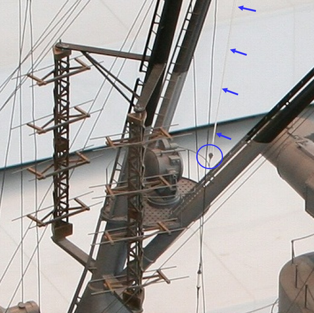

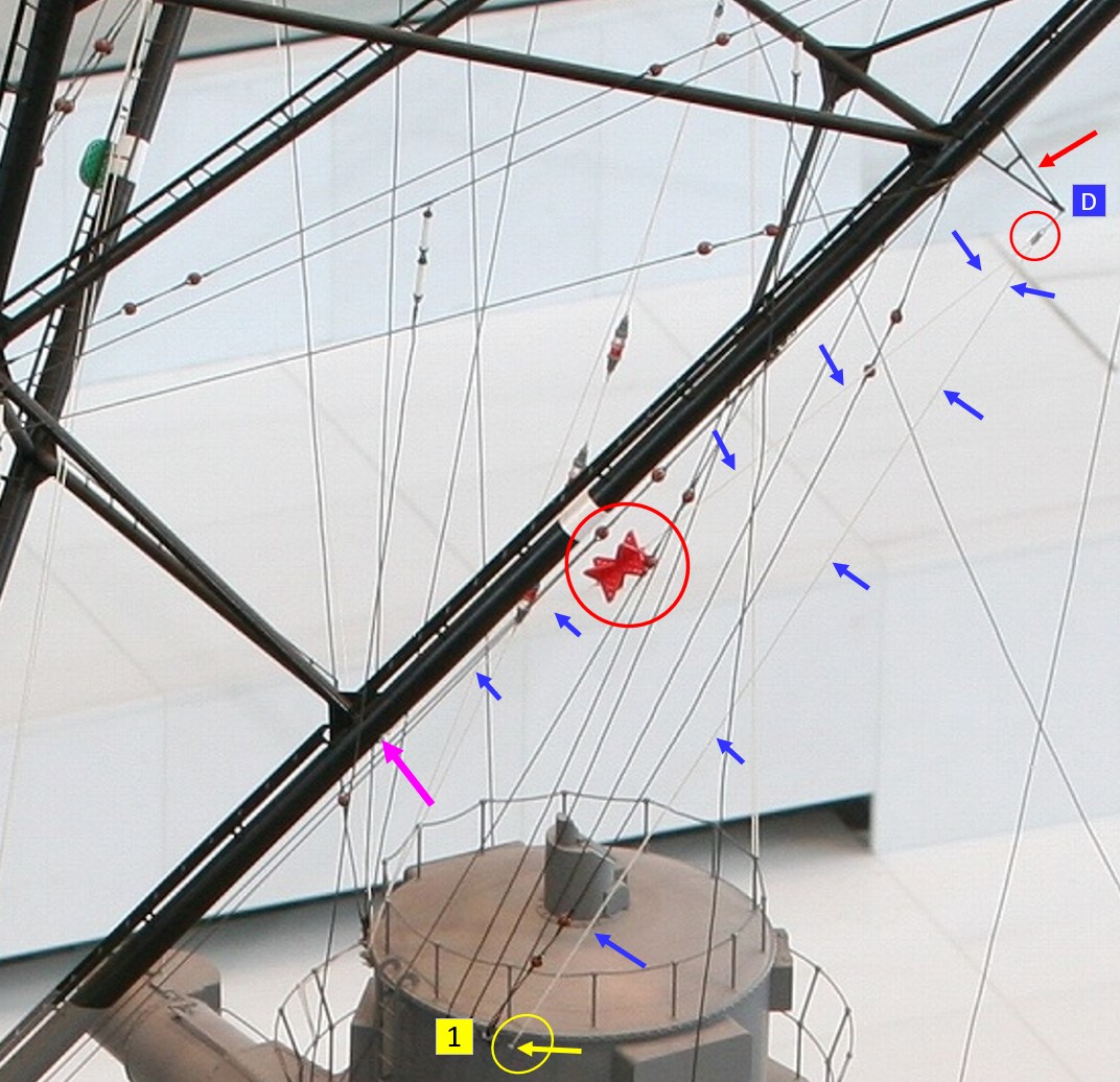

Pic 002:
Blue oval : Location of the 60cm Searchlight Platform between the Main Mast and the 2 Side Mast Arms.
Pic 003 :
Blue oval: Pulley at front railing of searchlight platform.
Note : the Front Railing of the Searchlight Platform faces the stern side of the ship.

Pic 001 :
Pic 002:

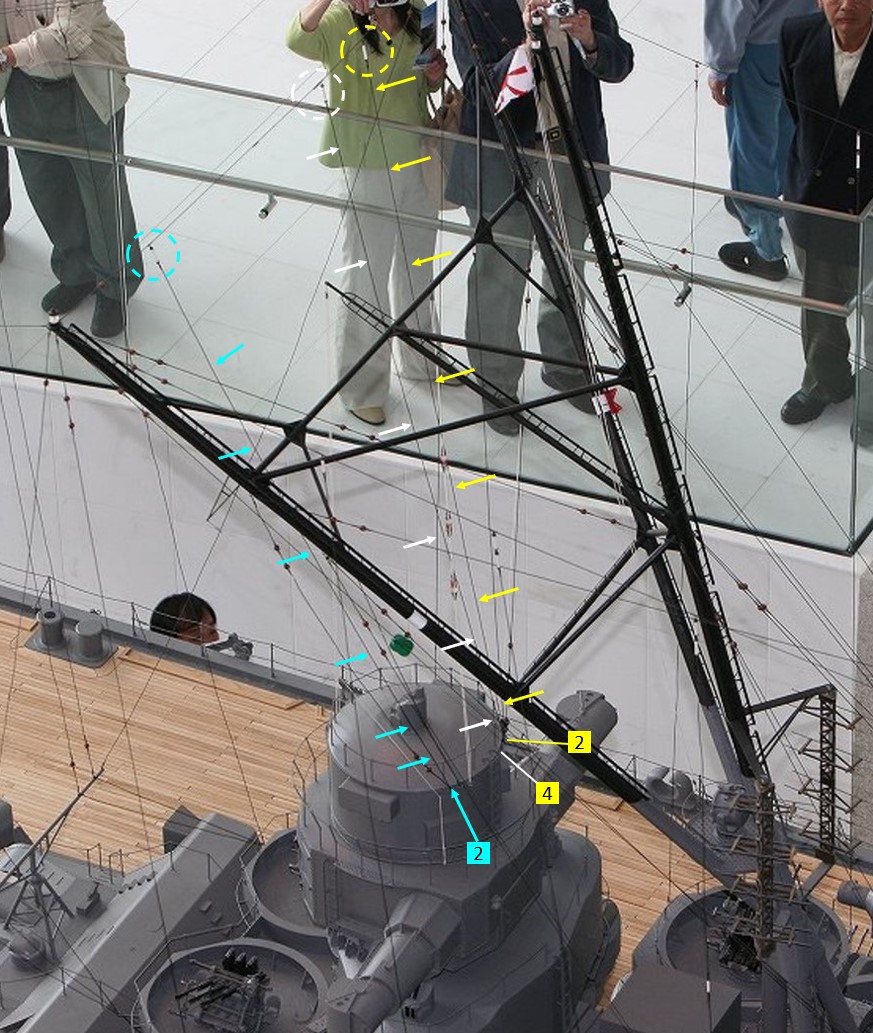

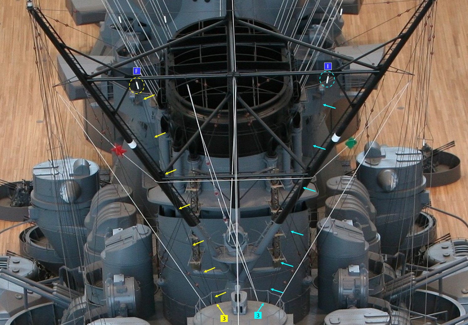

Please take a look at Pic 001 : the white circle shows the location of the Rear Range Finder on the Aft Ship.
Did somebody already noticed ? Indeed, we are no longer on the Mid-Ship!
Also note that the Front of the RRF faces the Aft ( stern) side of the ship. Because the Aft 46cm/155mm Guns shoots Backwards.

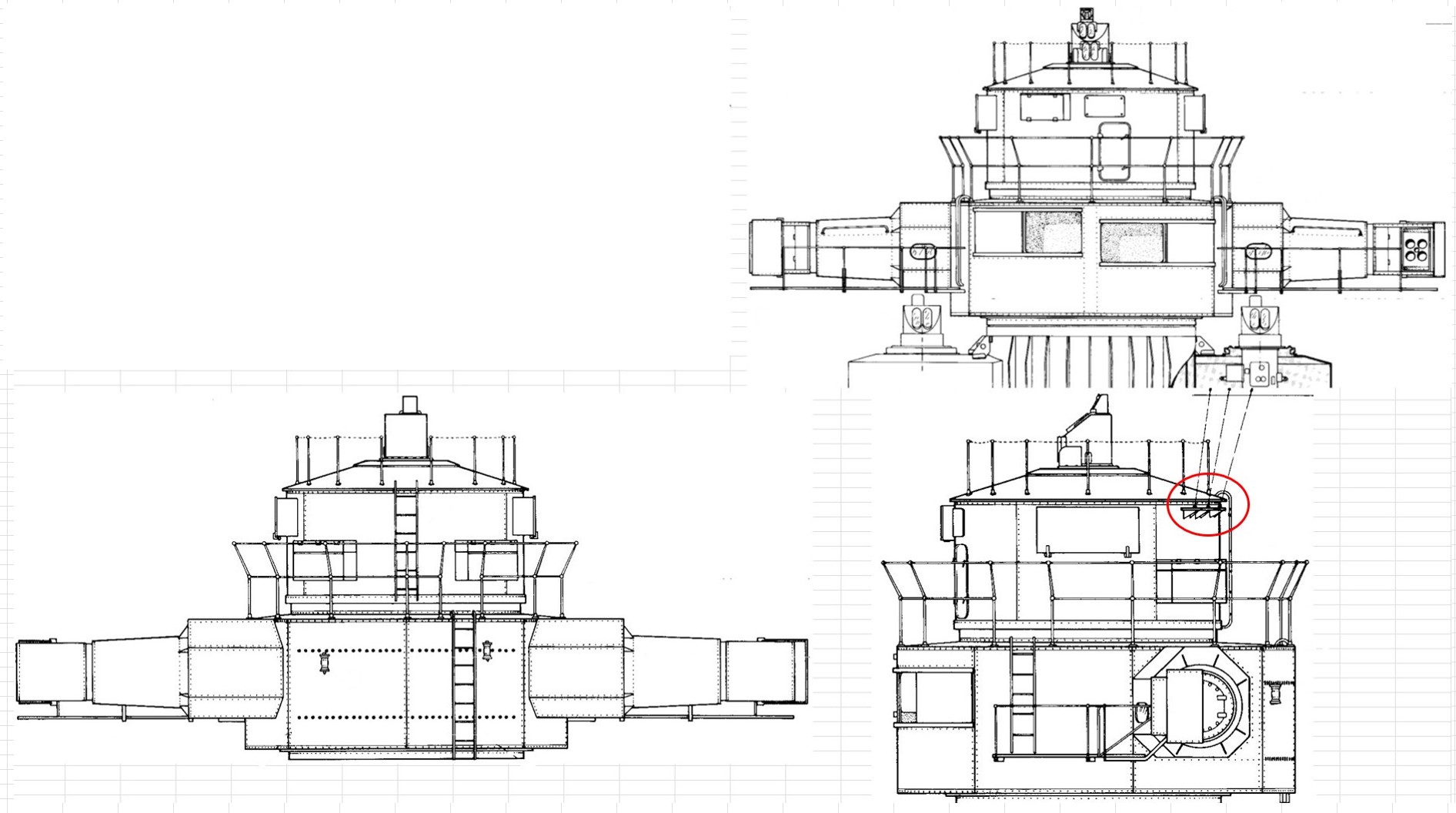

Pic 002 is a drawing with 3 main positions of the RRF.
The Front view in the upper right corner, the Rear view in the left lower corner, and the Side-view in the right lower corner.
In the Side view you will notice a red circle : this is the location of the Brackets, in this pic, at the starboard side of the RRF.

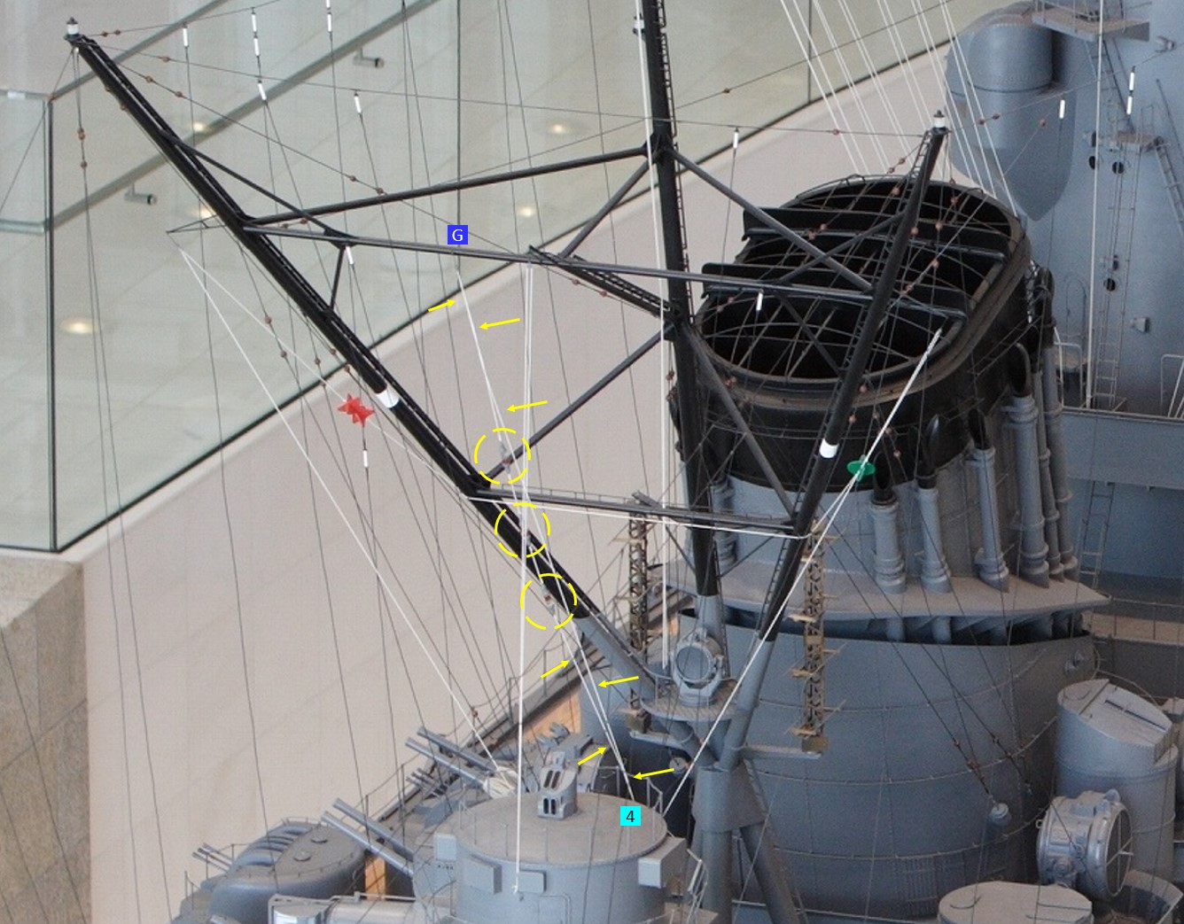

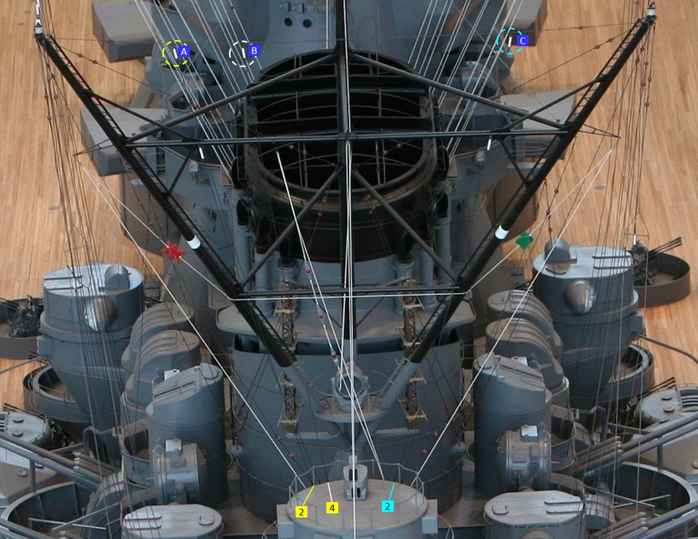

The RRF Upper view, the most important one, is depicted in Pic 003 : schematic drawing. Here you see 6 yellow highlited triangular devices with a hole in it , bearing Nrs 2-3-4.
There are 3 devices on each side of the RRF. We call them : the RRF "Brackets Nr 2-or 3- or 4". The 6 brackets are conceived to receive, guide and hold cables or white cords.
Also in this picture : the 2 red rings: Lug Nr 1 on port and starboard side of the RRF. These Lugs do the same job as the Brackets do. They are called : Lug Nr1.

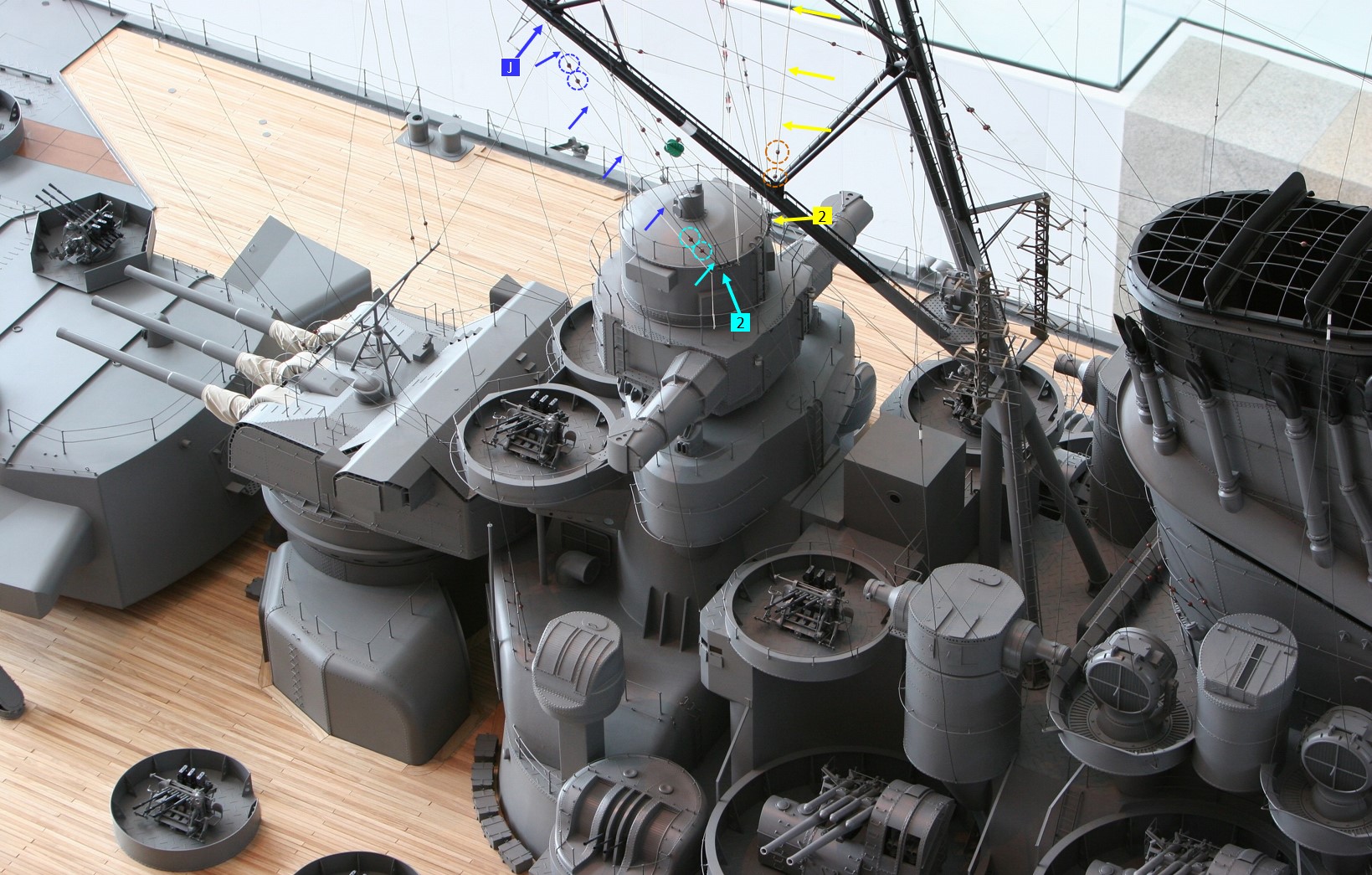

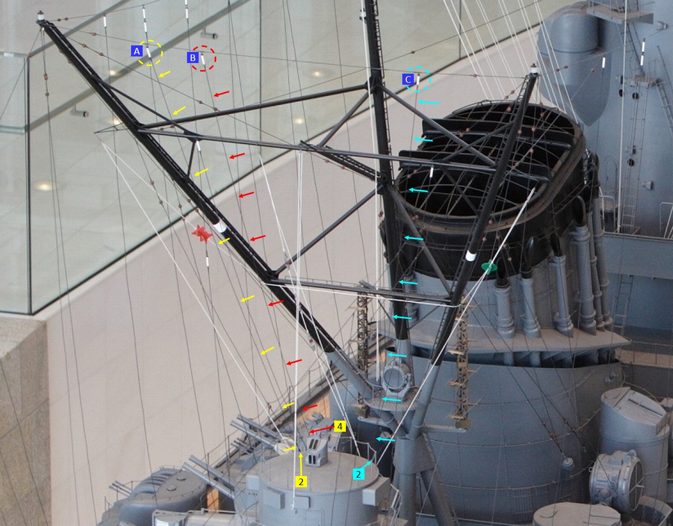

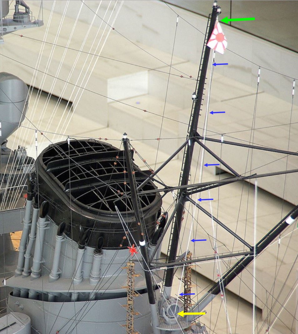

Pic 004 shows you the 3 Port side brackets in the blue circle. Hard to see, but when you look close at the right side of the 3 brackets, you also notice Lug Nr 1, in wich a white cord is attached.

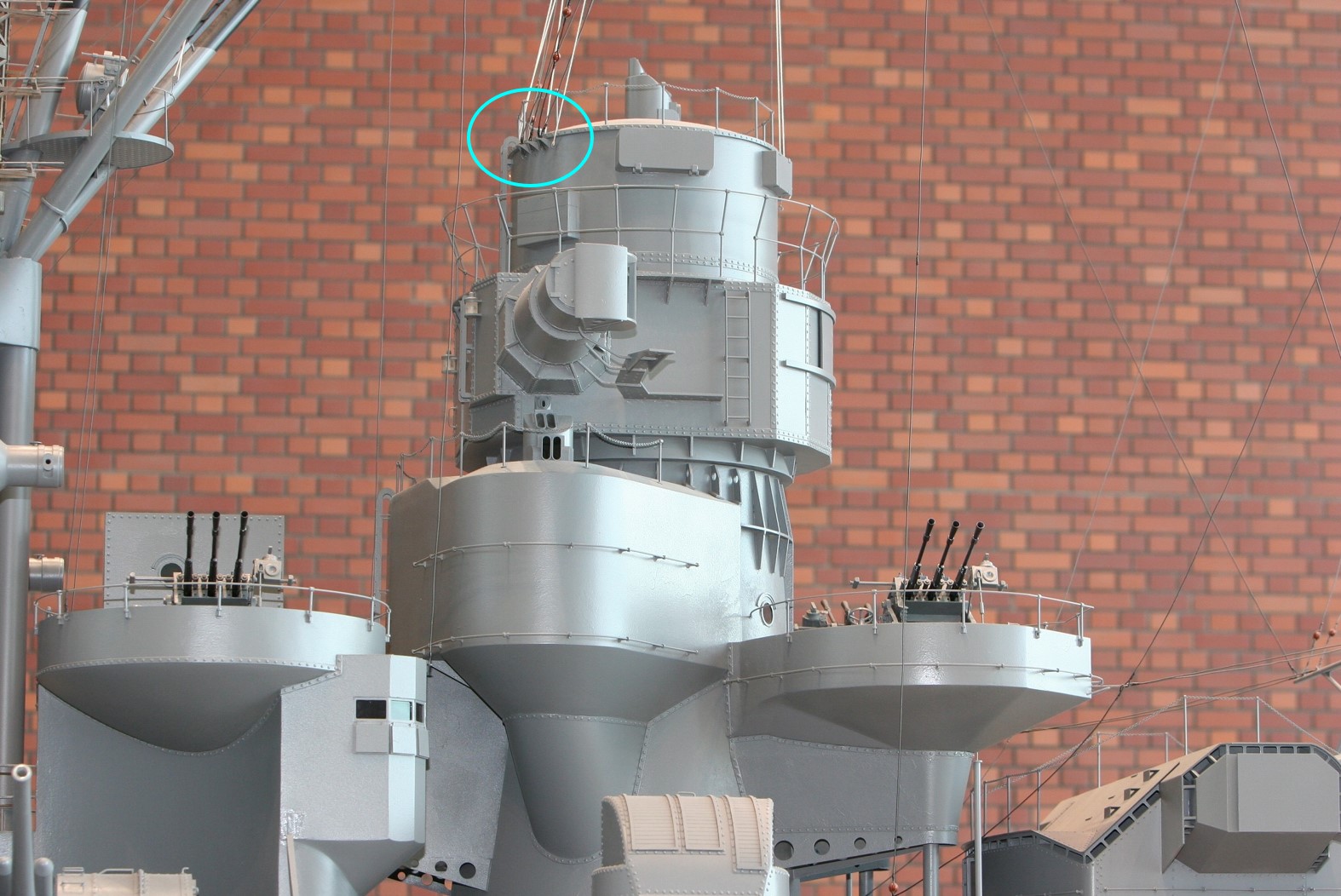

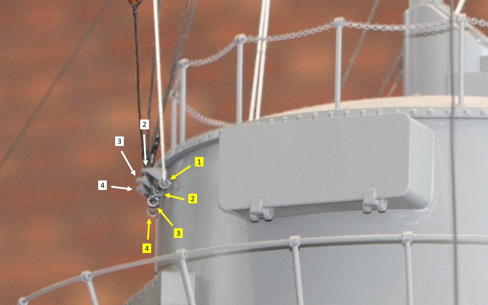

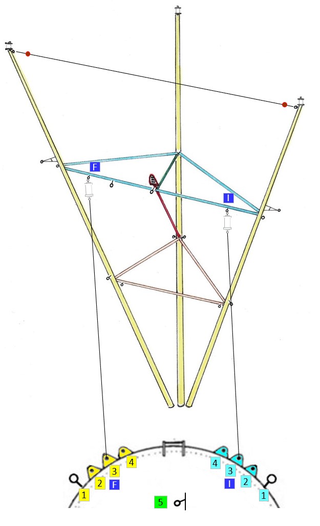

For more clarity, I introduced Pic 005 : a detail shot of all Brackets and the Nr 1 Lug.
At the bottom, you see 4 Lug-rings marked by yellow arrows (1-2-3-4). Above, you see (only) 3 Brackets marked by white arrows ( 2-3-4).
Lug Nr 1 is has no bracket and is shown with a White Cord attached.
One should expect that each of the 4 Lug Rings are covered by a bracket. But on Yamato's RRF, the bracket on Lug Nr 1 is missing on port and starboard side.
Why ? If somebody knows the reason : I'm all ears !
That's why in future rigging chapters we'll talk about Lug Nr 1 and Brackets Nr 2 - or 3 - or 4. It's a fact: Bracket Nr 1 simply does not exist.

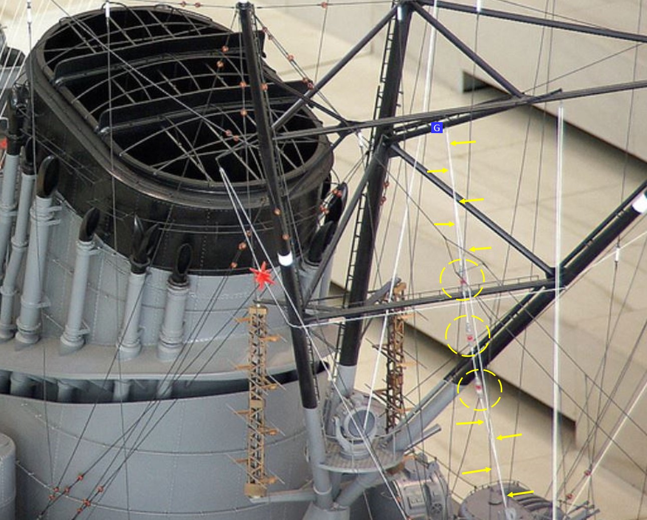

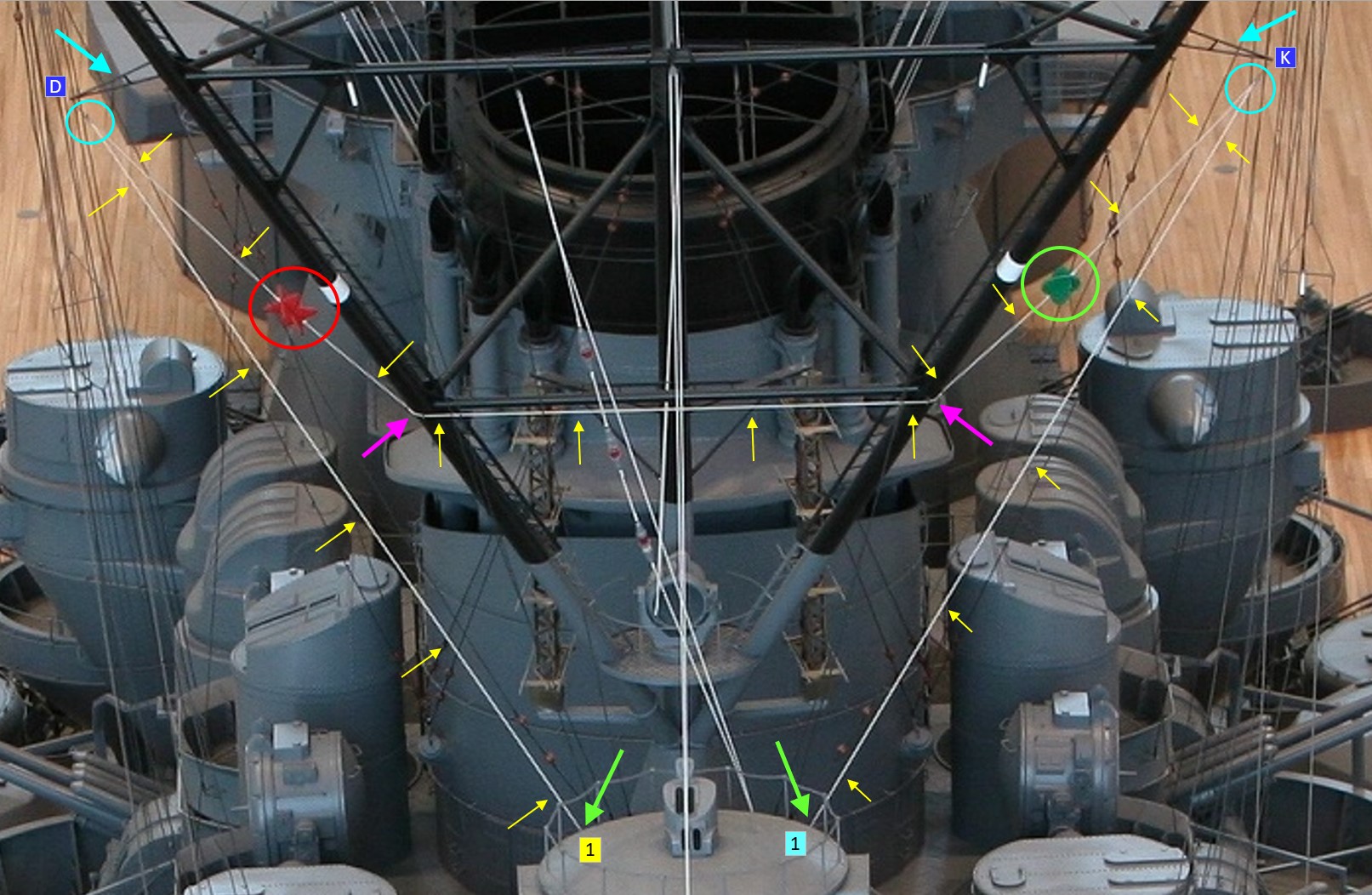

In Pic 006 you have a detailed view on the RRF starboard brackets and Lug Nr 1 : The same colour procedure of Pic 005 was applied : the bracket location was enlarged, the white arrows show the different Brackets and the yellow arrows show the underneath Lugs.
Please note that in Lug 1 and bracket Nr 4 there is a White Cord attached (in bracket Nr 4 it's a double white cord) while in Bracket Nr 2 there are 2 cables and in Bracket Nr 3, there is only 1cable attached.

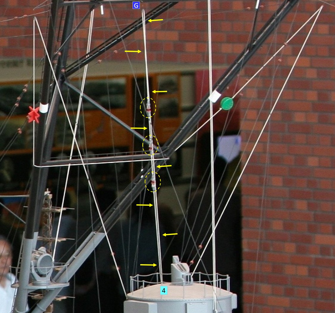

- White(double)Cord "G" comes from the Starboard side Bracket Nr 4, goes Up, runs trough the Pulley at the Port back side of the Upper Triangle, goes back down, runs trough 3 red/ transparant
Lanterns and returns to its start point : the Starboard side Bracket Nr 4. This double White Cord contains what seem to be 3 odd shaped red/ transparant Lanterns.

Pic 008 is a schematic drawing , not to scale or proportions. It
shows you where all the cables and cords from the RRF lead to their arrival spot on the Mast. Or vice - versa.
The Upper part of the drawing represents the Mast Assy while the Lower part is a schematic top-view of the RRF brackets, lugs and the Front pulley Nr 5.
Cables and Cords on the Mast Assy are marked with dark blue highlited letters at their specific location. Port side RRF Lug and Brackets are marked with yellow highlited numbers.
Starboard side Lug and Brackets are marked with light-blue highlited numbers. It may be usefull to compare Pic 008 with Pic 009 & Pic 010.
And to favorize the clarity in Pic 008: the dark-blue highlited Cable- letters shown on the Mast Assy are also shown on the RRF lower part of the drawing, near the brackets and lug Nrs.
This will enable you to see immediately what Bracket or Lug receives which Cable coming from the Mast Assy.
- Cable "A" departs from the Port side on the Connection Cable between the 2 Side Masts, trough a White Bar Insulator and leads to the Port Bracket Nr 2.
- Cable "B" departs from the Port side on the Connection Cable between the 2 Side Masts, trough a White Bar Insulator and leads to the Port Bracket Nr 4.
- Cable "C" departs from the Starboard side on the Connection Cable between the 2 Side Masts, trough a White Bar Insulator and leads to the Starboard Bracket Nr 2.

Pic 009 is an Aft view of the Mast assy and all the Cables descending to the RRF Brackets & Lugs.
Pic 010 is a Starboard -Aft view of the Mast assy and all the Cables descending to the RRF Brackets & Lugs.

Pic 004 is a side view that gives a good sight on the Junction Beam Pulley"H", at the end of the lower junction beam : see RED arrow. The blue arrows indicate the white flag cord that is barely visible in this picture. But
the most important here is the location of the Junction Beam Pulley"H".

Step 04.02. White Cord from RRF Bracket Nr 4 to Upper Triangle Aft Beam Pulley : the 3 odd lanterns...
Gentlemen,"
Today we will talk about the White Cord that goes from starboard Bracket Nr 4 to Pulley "G" on the Upper Triangle aft beam, and back to starboard Bracket Nr 4.
Let's take a look at the pictures:
Pic 001 is a schematic drawing adapted to this rigging step. It shows the RRF Brackets (yellow colour for Port side and Light Blue colour for starboard side). Also the Upper Triangle Aft Beam with the Pulley G is shown with the White Cord, which is drawn in blue for a good contrast in this drawing. Like I said before: drawing a White Cord on a white background is rather difficult.
Almost all pictures have the same colour code:
Blue or yellow arrows mark the White Cord trajectory.
Blue or yellow ovals show the 3 odd lanterns.
Blue tag "G" is the pulley on the Upper Triangle aft beam.
Light blue tag Nr 4 is the starboard Bracket Nr 4 on the RRF.
This is a very simple rigging procedure (see Pic 003) :
The White Cord, attached in starboard bracket Nr 4 goes up to the Upper Triangle Aft Beam Pulley, at the Upper Port side of the Mast (see Pic 004)and comes down again to starboard Bracket Nr 4 (light- blue tag).
The returning half of the White Cord contains qty = 3 devices which I call : " The 3 odd shaped lanterns". I must say I did not find any reasonable explanation on the lanterns function but I'm sure there must be one, somewhere! One lantern is located above the Lower Triangle and the rest of the lanterns are installed lower than the triangle.
The first thing that stands out when you see the Cord trajectory is : WHY does the White Cord depart on Starboard side and goes to a pulley on the Port side of the Upper Triangle aft beam from where it comes back down to Bracket Nr 4 on the starboard side of the RRF ? This way, the White Cord's is hanging completely slanted. Strange !
Anyway, strange or not, I only observe what my eyes can see !

Step 04.03. White Cord from RRF Brackets Nr 1 to the Triangles on the Side Mast Arms
Gentlemen,
Today we will talk about the White Cord from RRF Brackets Nr 1 to the Triangles on the Side Mast Arms.
If we look more into detail in this chapter, it is about the
rigging of the White Cord from Port side Bracket Nr 1 to the Port Side Mast Triangle "D", going further to the corner with the Lower Triangle Aft Beam and running from the Starboard Side Mast Triangle "K" to the starboard side Bracket Nr 1.
Just to emphasize the fact that the complete trajectory in this rigging step is accomplished by only 1 (single) White Cord.
The pictures :
As always, I tried to use the same colour code in every picture. Where the contrast was too high, I had to use different colours to mark the rigging items.
Pic 001 is a simplified schematic drawing from the reference drawing in rigging step 04.00. "Rigging on the RRF".
It shows the RRF Brackets Nr 1,on port and starboard side, the Mast assy and the pulleys on the Side Mast triangles "D" & "K".
The colour codes for pictures 002 to 007 :
Green arrow (yellow tag) = port side Bracket Nr 1.
Green arrow (light blue tag) = starboard side Bracket Nr 1.
Yellow arrows : trajectory of the White Cord.
Light-blue circles : Pulleys at both Side Mast Triangles.
Light-blue/ red arrows : Port & Starboard Triangles on Side Masts.
Pink arrows : switch point where the White Cord changes its (rather) vertical trajectory into a horizontal trajectory with Lugs on the Lower Triangle Aft Beam.
"D": Port side Triangle.
"K": Starboard side Triangle.
Red circle : Port side red squared Maneuvering Indicator.
Green circle : Starboard side green circular Maneuvering Indicator.
Big Thanks to Dan K for providing me the correct info on the Maneuvering Indicators : The red (port) and green (starboard) shapes seen in pics 5 & 6 are maneuvering indicators, to broadcast rudder positions.
Rigging procedure :
The White Cord starts at the Port side Bracket Nr 1(yellow tag), see Pic 001. From there it goes up to the Triangle pulley " D" on the port Side Mast Arm. See Pic 003, light blue circle.
After the pulley, the White Cord goes back down with a red multi flanged Maneuvering Indicator to the point where the White Cord direction changes on the Side Mast.See Pic 005, pink arrow.
In this location, 2 lug rings are installed : one on the Side Mast arm and one on the Lower Triangle Aft Beam. The 2 lug rings force the White Cord to re-direct into a horizontal trajectory, all the way on the Lower Triangle Aft Beam. See Pic 008-009, yellow arrows.
At the right-end of the Lower Triangle Aft Beam, the White Cord encounters again 2 similar lug rings that re-direct the White Cord from a horizontal trajectory, via the green circular Maneuvering Indicator towards the Triangle "K"pulley on the starboard Side Mast arm. See Pic 004 -006, red & blue circles and blue arrows.
After the pulley, the White Cord continues to the starboard side Bracket Nr 1. See Pic 006, blue arrows, yellow circle and yellow arrow (starboard Bracket Nr 1).
Notice:
A good overview of the whole White Cord trajectory can be found in Pic 001 - 007 - 010.
Detail of the port side Triangle "D": see Pic 003 & 005.
Detail of the starboard side Triangle "K": see Pic 004 & 006.
Details of the White Cord Re-direction on the Side Mast Arms are shown in detail in Pic 008 -009.
Insulator Count
In this rigging step, NO Insulators were used.
This is the end of step 04.03. White Cord from RRF Brackets Nr 1 to Side Mast Triangles.
As illustrated in the Gran Prix Shuppan volume on IJN cruisers:

Dan,Dan K wrote:The red (port) and green (starboard) shapes seen in pics 5 & 6 are maneuvering indicators, to broadcast rudder positions.
In your book collection of IJN Ships, are there any drawings or photos of rigging attachments (hardware) that can complement what Katana is doing here? TIA Jim

Dan ,Dan K wrote:The red (port) and green (starboard) shapes seen in pics 5 & 6 are maneuvering indicators, to broadcast rudder positions.
Big thanks for sharing the correct function of these devices.
Textual corrections were immediatly made in the article.
For your info : In the picture of your post, in the left page, I saw that basket-shaped device.
I discovered similar items at the signal deck also. See the pictures in annex
Katana

Today we will talk about the Cables that run from the RRF Brackets Nr 4&2 towards the Connection line between the 2 Side Mast Arms.
The Pictures : as usual, in all the pictures of this rigging step, I tried to use the same colours for the same rigging devices as long as the contrast of the different pictures allowed me to do.
Pic 001 is the simplified schematic drawing for this rigging step.
Here, the main contributors are the 3 cable attachments A, B& C on the Connection Line between the 2 Side Mast Arms and port side Brackets Nr 2&4 and starboard side Bracket nr 2 on the RRF.
Pic 002 & 003 show you the complete trajectory of the 3 different cables, marked with ovals and arrows and the cable attachments A, B & D .
Pic 004 & 005 show also the cable attachments A, B & D and the RRF Brackets, but here the cable trajectories are not marked.The contrast with the background is not sufficient to recognize cables.
Rigging procedure :
In this step, the rigging procedure is pretty straightforward.
On the Connection Line between the 2 Side Mast arms, on 3 different locations (A, B & D) a White Bar Insulator is attached with its front connector. The rear connector holds a cable that goes to the Yellow Port side RRF Brackets Nr 2&4 and to the Light Blue RRF Bracket Nr 2 on starboard side.
When you check the pictures you'll see that the 2 cables from Port side RRF Brackets Nr 2&4 lead to a White Bar Insulator " A & B" on the Port side of the Connection Line.
And the cable that comes from starboard RRF Bracket Nr 2, leads to a White Bar Insulator "C" on the Starboard side of the Connection Line.
So this time, the cables follow no slanted trajectory.
That's all. It can be that simple.
Insulator Count
Needless to tell you that in this riggng step in attachment point A, B & D, each time 1 White Bar Insulator is used.
Total amount of Insulators used in this rigging step : Qty = 3 White Bar Insulators.

YAMATO RIGGING GUIDE
CHAPTER 04. REAR RANGE FINDER
Step 04.05. Cables from RRF Brackets Nr 3 to the Upper Triangle Aft Beam
Gentlemen,
Today we will talk about the cables from the port and starboard side RRF Brackets Nr 3, up to the attachment Lugs on the Upper Triangle Aft Beam.
The Pictures :
Pic 001 is a simplified schematic drawing , adapted for this specific rigging step. It shows you both RRF Brackets Nr 3 and the 2 cables that go upwards and end in the rear connectors of 2 White Bar Insulators that are attached to the Upper Triangle Aft Beam Lugs.
Pic 002 is an aft view on which you can see the cable ( yellow arrows) from Port side RRF bracket Nr 3 towards the White Bar insulator installed on attachment "F" on the Upper Triangle Aft Beam Lug.
The trajectory of the starboard side cable (light blue arrows) from attachment "I" on the Upper Triangle Aft Beam Lug to the RRF Bracket Nr 3 is visible on the starboard side.
The yellow and light blue colours apply also to the arrows and Bracket tags in Pic 003 & 004.
Rigging procedure :
In fact this rigging step is quite similar with step "04.04. Rigging cables from RRF Brackets nr 4&2 to the connection line between the 2 Side Mast arms". And it is also pretty simple.
The 2 cables depart at the port & starboard RRF Brackets Nr 3 and go upwards to the aft connectors of the 2 White Bar Insulators that are attached to the Upper Triangle Aft Beam Lugs.
That's it. No complications , no special devices or whatsoever.
The port side cable is attached to a White Bar Insulator on the port side of the Upper Triangle Aft Beam and the starboard side cable is attached to a White Bar Insulator on the starboard side of the Upper Triangle Aft Beam.

We see 2 White Bar Insulators that are used on the Upper Triangle Aft Beam Lugs : one on port and one on starboard side.
Total amount of insulators used in this rigging step : Qty = 2 White Bar Insulators

Today we will talk about the Cables from RRF Brackets Nr 2 to the Side Masts Upper Lugs.
Remember the Side Masts Upper Lugs ?
The description in rigging step 03.00. Mast Assembly Part 2 says : "The Side Mast Upper Lugs are located on both Side Masts, slightly under the (white cord) triangles and also little under the connection of the Side Mast Arm with the Upper Reinforcement Triangle See Pic 031". This "pink circle in Pic 031" from step 03.00. is in this rigging step 04.06. : Pic 005 station "J".
The picture is the almost the same. The name tags differ.
Let's take a look at the pictures in this rigging step :
the picture colour codes:
Yellow arrows : port side cable trajectory.
Light-or dark blue arrows: starboard side cable trajectory.
Yellow circles : port side Brown Ball Insulators.
Light-or dark blue circles : starboard side Brown Ball Insulators.
E : port Side Masts Upper Lug.
J : starboard Side Masts Upper Lug.
Yellow tag Nr 2 : port side RRF Bracket Nr 2.
Light-blue tag Nr 2 : starboard side RRF Bracket Nr 2.

Use your zoom to distinguish the different cables. Before I have put arrows on them, I enlarged the pictures quite a bit to know the exact location of the 2 cables in this rigging step.
Beware of optical illusions : At a certain location in Pic 008, our cables run very close to the White Cord that goes to the Side Mast Triangles. Just follow the arrows and use your zoom to find the exact cable. The Brown Ball Insulators near the RRF Brackets are not always clearly visible. But when you look for the Blue or Yellow circles, you'll find them.
Pic 001: as always, this is a schematic drawing adapted to this rigging subject. You see at port and starboard side 2 cables that depart from the RRF Brackets Nr 2, they go upwards to the Side Masts Upper Lugs where they are attached.
Beside Pic 001 there are 7 other pictures that show views from different angles on the cable trajectories, the Side Mast Upper Lugs and the RRF Brackets.
I recommend you to use the picture colour code when you look at them.
Rigging procedure :
From both the port and starboard side RRF Brackets Nr 2, a cable departs to the Side Masts Upper Lug. See Pic 002-003-008.
Details of the starboard Side Mast Upper Lug can be seen in Pic 004 & 005.
The port Side Mast Upper Lug is shown in Pic 006 & 007.
And although Pic 008 is quite dark, both cables can be easily distinguished, despite the dark back-ground.
Recommendations when using the pictures :
Rigging procedure :

To resolve this problem, I retrieved my old Pic 002. This is a side view drawing of the Aft Ship Rigging that uses the same colour codes, letters and digits as Pic 001.
In Pic 002, the schematic factor disappears and is replaced by a more practical drawing. It shows you a realistic view on each specific location of Main Cables, Branches, Joints and Connecting Cables on the Aft Ship.
Nevertheless, Pic 002 has also its limitations : in the side view there was no opportunity to show Cable "G" on port and starboard. Nor did point Nr 6 show, where Cable "G" is attached to the Structure Wall under the Aft AAA platforms. And instead of seeing 2 Aft AAA platforms and 2 Brackets Nr 5, you see only 1 piece because this is simply : a Side View.
What is also missing in Pic 002 ? Cable "C" that runs from the Side Mast Rear tip Lug to the second level deck where it is attached to the deck with a bottlescrew in attachment point 7.
However, there still 2 items in Pic 002 that are of some interest to Us.
The first one is the expanded screen that shows the Aft 155mm Gun Antenna and the arrival of 6 cables on its Brackets.
The scaled-up Antenna view shows you more details than the small original figure in Pic 002.
The second interesting item in Pic 002 is the red coloured line at the left side of the picture. This red line marks the Rear limit of the Aft Ship Rigging area.
The marking point for that limit is visible in the upper part of the picture. The red line starts at the left side of Joint Nr 10, where Cables "D & E" merge back into 1 single cable, namely : Main Cable Nr 1 on Port side, but also Main Cable Nr 4 on Starboard side.
To compare the schematic drawings with a real picture , I introduced Pic 003 to give you an idea about dimensions.
At the right side you see start point Nr 0 on the Port Side Mast where Main Cable Nr 1 departs.
A little further to the left, and due to the Triangular Branch Nr 1, MC1 splits from a single cable into 2 cables.
From there, they proceed to the Crane tip on the Stern.
At the outer left of Pic 003, in Triangular joint Nr 10, the 2 cables are merged together into 1 single Cable: Main Cable Nr 1. Near this location you also see the red striped line, marked with red arrows.
When you pull the red line down to the deck, you end up above the 46cm Gun Barrels, little before their end.
Although the starboard Side Mast tip is not visible in this picture, Pic 003 shows you where the Aft Ship Rigging begins (start point Nr 0) and where it ends at the vertical red line, near Joint Nr 10.
This area is the playground of all the next rigging steps on the Aft Ship.

As a reference I use 2 schematic drawings : pictures 001 & 002. They served in rigging step 05.00. but their contents & info are suitable for this rigging step.
As regards to Pic 003 - 004 & 005: Not every picture shows the same kind of details. Let me explain:
Pic 003 is a rear view picture that shows you very well the proportions of MC1&4 towards the Mast beams. It also shows the individual dimensions and distances between Split Points Nr 0-1-2-3-4-8-9 and the 2 brown ball-insulators near start point Nr 0 (yellow circles).

Pic 004 is a SIDE view picture that I introduced with only 1 goal: to show you the dimensions and proportions of all cables on MC1 &4 above the Aft ship.
When you look very close at this picture you can see :
a)the individual dimensions and distances between Split Points Nr 0-1-2-3-4-8-9.
b)the dimensions of all the cables that come down to the deck.
c) the relative position of the split points & cables towards the Aft AAA platform, the 155mm Gun Antenna and towards the Gun Barrels. Important : the yellow striped line, marked with Red arrows shows you MC4 Joint Nr 10 that indicates the end of cables D&E but also the left end of the Aft Ship Rigging Area. And it also shows you the vertical position of the rigging area towards the barrels of the 46cm Aft Gun Barrels.
d)the arrival of cables on the AAA platform Front Railing Brackets and the cables reaching the 155mm Gun Antenna : they are clearly visible in this picture but in a side -view they loose too much detail to be numbered or tagged.
Pic 005 is a Side view, ideal to show you the distance between MC 1&4, and the dimensions & proportions of the Aft Ship cables.
This picture was used to show you detail of all the split points, joints and cables near the Side Masts.
What you didn't see in Pic 003 & 004, but what is exposed and colour- marked & numbered in this Pic 005 : the arrival of the 2 cables "F" on the AAA platform Front Railing Brackets (joint Nr 5). Also marked: the arrival of the cables (B-H-I) on the 155mm Gun Antenna, on port and starboard side. In this picture, certainly MC4 lends itself better to show details of the Aft Ship Rigging. Due to the capture angle in this picture, MC1 is not that suitable.

Gentlemen,
today we will talk about the Cables that go to the Aft 155mm Gun Antenna.
The Aft 155mm Gun Antenna Brackets contain not only cables that arrive there, there are also cables that depart from the brackets.
But today we will talk only about the cables that arrive on the Aft 155mm Gun Antenna Brackets. The departing cables will be treated in a future rigging step.
And what else than a collection of detailed pictures can tell you more than 1000 words ?
Pic 001: this is the schematic drawing that will be used in all the rigging steps of the Aft Ship. The following items are important for this rigging step: Cables "D"&"E", Branches Nr 8&9, Cables "I"-"H"& "B" and Antenna Brackets Nr 1-2-3 , all on port and on starboard side.
Pic 002: a side view where you can see both Side Masts. Please note that cable splits & junctions detail is far more visible on starboard MC4 than its opponent on port side : MC1. Also present & tagged : all cables
leading towards the 6 antenna brackets (green & red Nr 1-2-3).
Pic 003: Front view of the Rear Range Finder with on the foreground the 155mm Gun Antenna with its green & red tagged brackets and port & starboard cables éB-H-Ié coming from above. This picture also shows the
linear distance between all brackets.
Pic 004: Right front view of the same area. In this picture you can see where the antenna is installed on the 155mm Gun Roof.Please note the different angles between cables " I-H" and cable "B".
Pic 005: Starboard side Aft view of Antenna brackets. Detail in this picture : the lugs that are installed on the aft-upper location of the antenna bar. Again the different angles between cables " I-H" and cable "B".
Pic 006: Almost straight head-on detail picture of the Antenna brackets and their cables towards the AAA platform front brackets Nr 5. Also note the prominent presence of 4 brown ball insulators on cables "H & -I".
Pic 007: Port Side view of the same area. Very distinctive in this picture : look at the angle with which cables "H&I" arrive at the brackets, with their 4 brown ball insulators. Also note that the antenna brackets are
located a little bit higher than the AAA platform front brackets.
Pic 008: Port Aft Side view of the Antenna. In this picture we notice the location of the AAA platform front brackets : not in the middle but more on the outside of the platforms. Also the angle with which port and
starboard cables "B" arrive at the anntena.
Pic 009: Bigger view from the same position as Pic 008. This picture shows you the difference of arriving angles between cables "B", coming from the aft Side Mast tips and cables "H&I", coming from junctions Nr 8&9 on
Cables "D&E".
Pic 010: Big side view to show the trajectory of port & starboard cables "B" and the location of the 2 brown ball insulators ( see blue circles) near the Side Masts.
Pic 011 is the schematic drawing with all cables arriving at the Aft 155mm Gun Antenna.
Cables "D&E".
Let's start this rigging procedure :
In all the pictures of the 155mm Gun Antenna , the 3 port brackets are marked red and the 3 starboard brackets are marked with green colour.
Numbering of the brackets is, like so many items in the Yamato rigging, done in mirror view.
In plain English: both brackets Nr 1 are located on the OUTside of the antenna, brackets nr 2 are in the Middle and brackets Nr 3 are installed on the INNER side of the antenna, facing each other.
Notice : not only the Antenna Brackets are identified in mirror view, the locations from where the incoming cables originate are also a mirror view from each other.
There are 2 different sources that "provide" the antenna brackets with cables : startpoint 0 on the 2 Side Mast Aft Lugs and cables "H&I" (port and starboard side) above the Aft Ship.
Starpoint Nr 0 at the 2 Side Mast Aft Lugs.
On both Side Masts, the Aft tip Lug is considered as startpoint Nr 0.
From there, cable "B" departs and immediately encounters a brown ball insulator not far from the Mast tips.
See blue circles in Pic 002 & Pic 010.
Then, both cables "B" (blue tag for port side, yellow tag for starboard side) lead to the red and green tagged outer brackets Nr 1 on the antenna. See detail in Pic 003-004-005-006-007-008-009.
Antenna brackets are in fact big lug rings that are attached on the upper aft side of the antenna bar. Very suitable to fasten cables. See detail in Pic 006 & 007.
Cables "H&I" at port & starboard of the Aft Ship rigging.
Cables "H&I" emerge from junctions Nr 8&9 with blue tagged cables "D&E" on port side and the yellow tagged cables "E&D" on starboard side, high above the Aft Ship. They lead to the red & green tagged brackets Nr 2&3 on the 155mm Gun Antenna.
See detail in Pic 001 & Pic 002.
Here are the interactions between the cables "D&E" ,junctions Nr 8&9 (port & starboard) and the antenna brackets :
In Branch Nr 8 on Port side cable D, cable "H" goes down to the red tagged Bracket Nr 2 on the 155mm Gun Antenna.
In Branch Nr 9 on Port side cable E, cable "I" goes down to the red tagged Bracket Nr 3 of the Aft 155mm Gun Antenna.
In Branch Nr 9 on Starboard side cable E, cable "I" goes down to the red tagged Bracket Nr 3 of the Aft 155mm Gun Antenna.
In Branch Nr 8 on Starboard side cable D, cable "H" goes down to the green tagged Bracket Nr 2 of the Aft 155mm Gun Antenna.
With al this info, we know which cables arrive in the 6 Antenna Brackets and where they come from.
