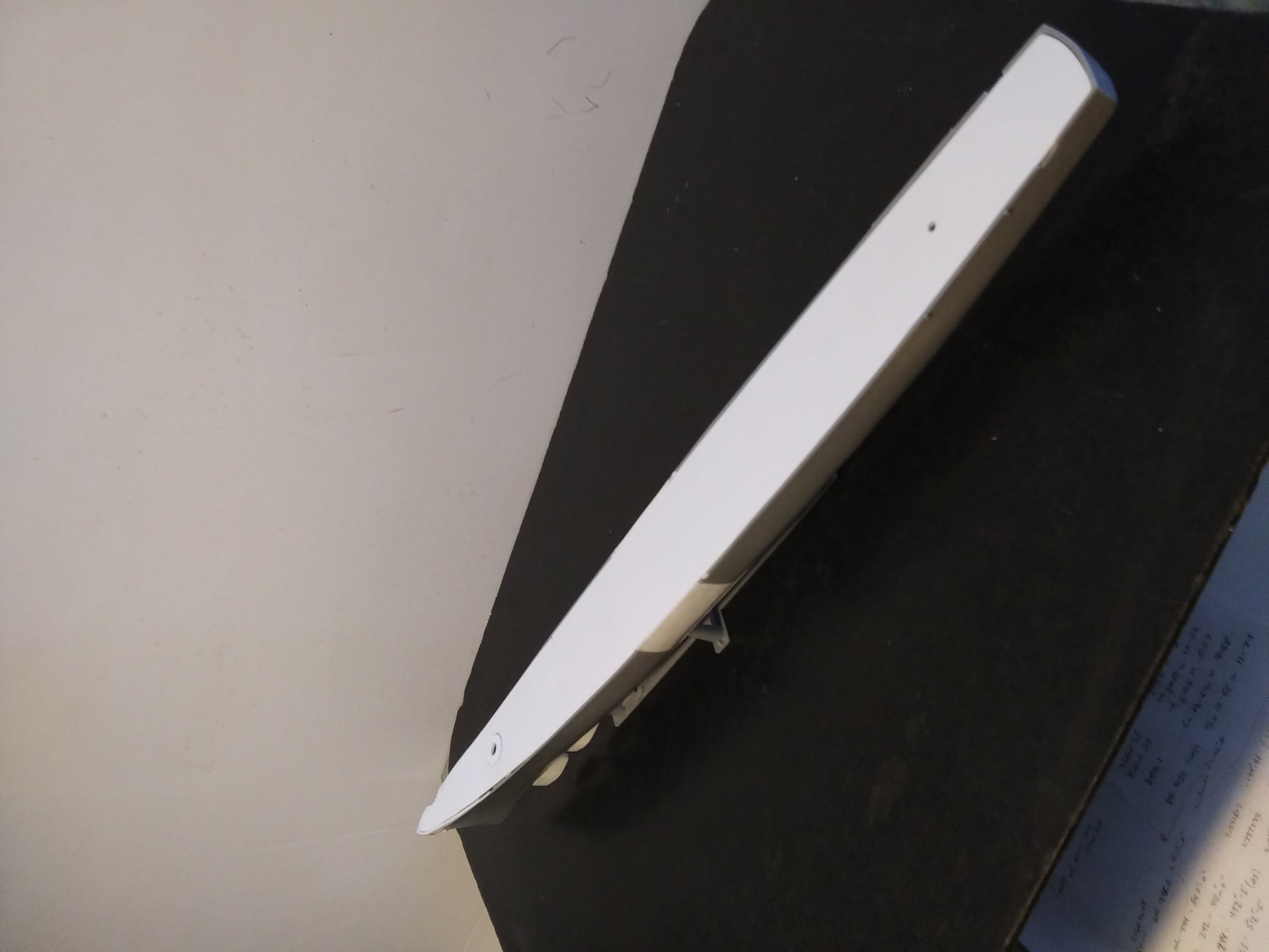

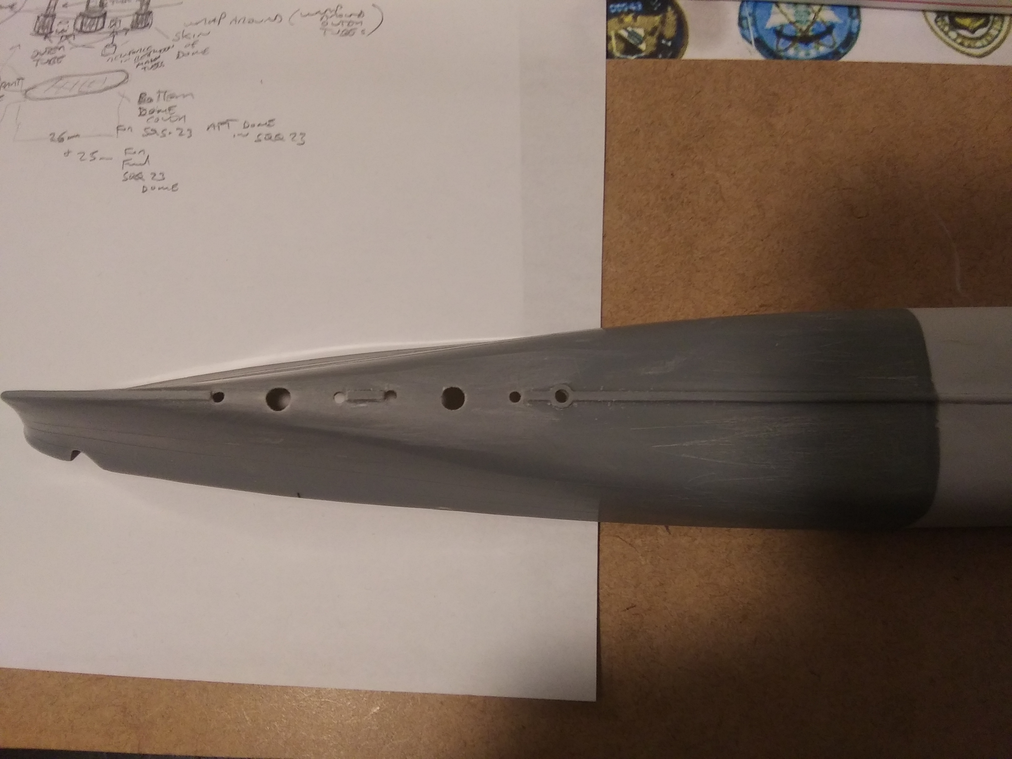

after a very long delay {due job change/life, family etc. Finally restarted work on the DD931 type to DLG conversion, added twin sonar domes, closed up the anchor ports, and reconfigured the anchor ports, raised the bow by 2.85mm (about 3 ft in scale), next is add the main deck

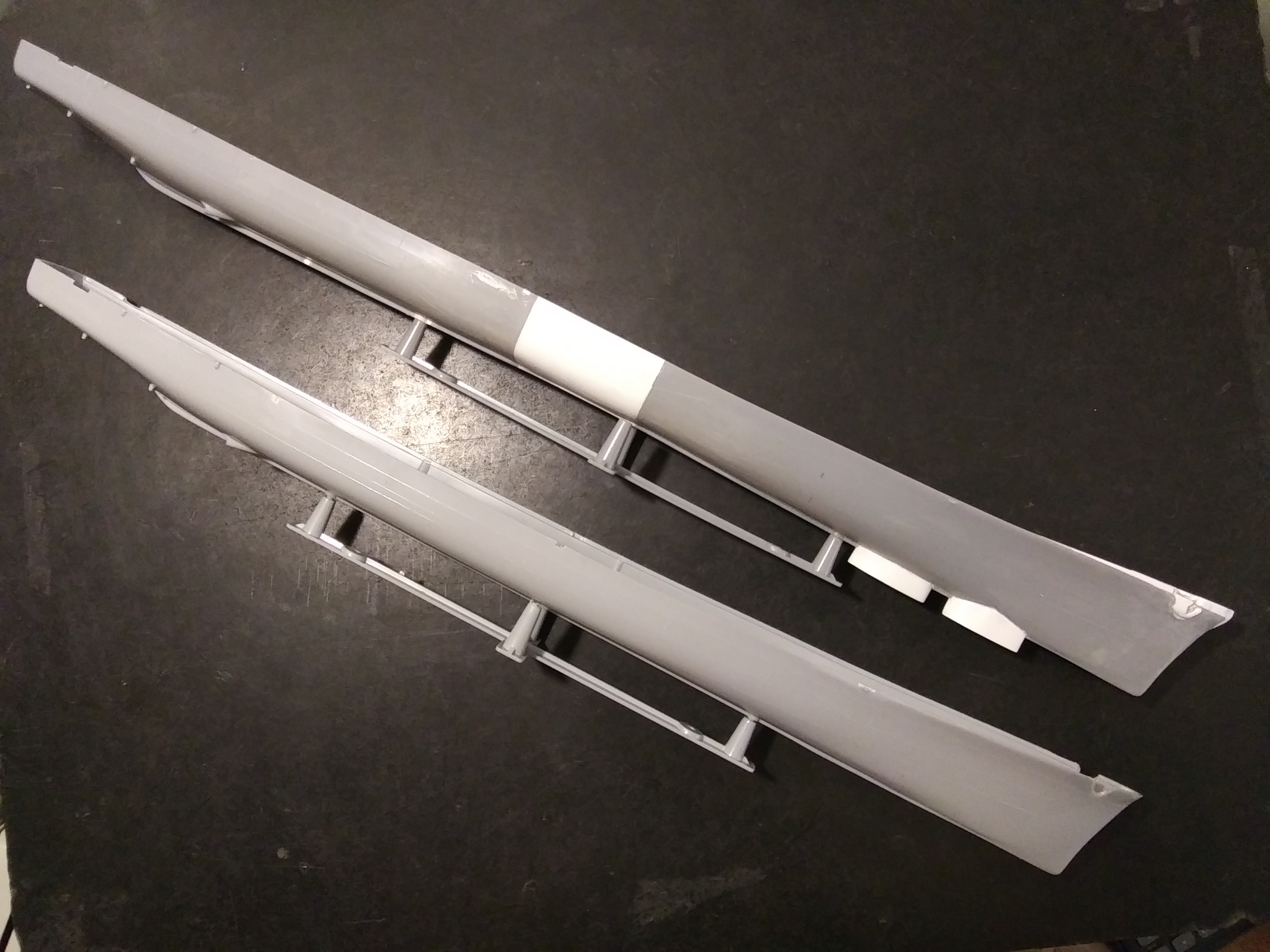

In the above picture post was able show a original dd931 hull next the to the extended hull, this my fourth F.Sherman kit 1/320 scale, (kit is the John Paul Jones), also picked up two 1/311 scale DEG-1 Brooke class models (kit is the Ramsey), both model kits by Atlantis (old Revell/Monogram kits released under Atlantis)

why is the conversion model bent at the middle so that the keel is curved downwards at the ends instead of being straight?

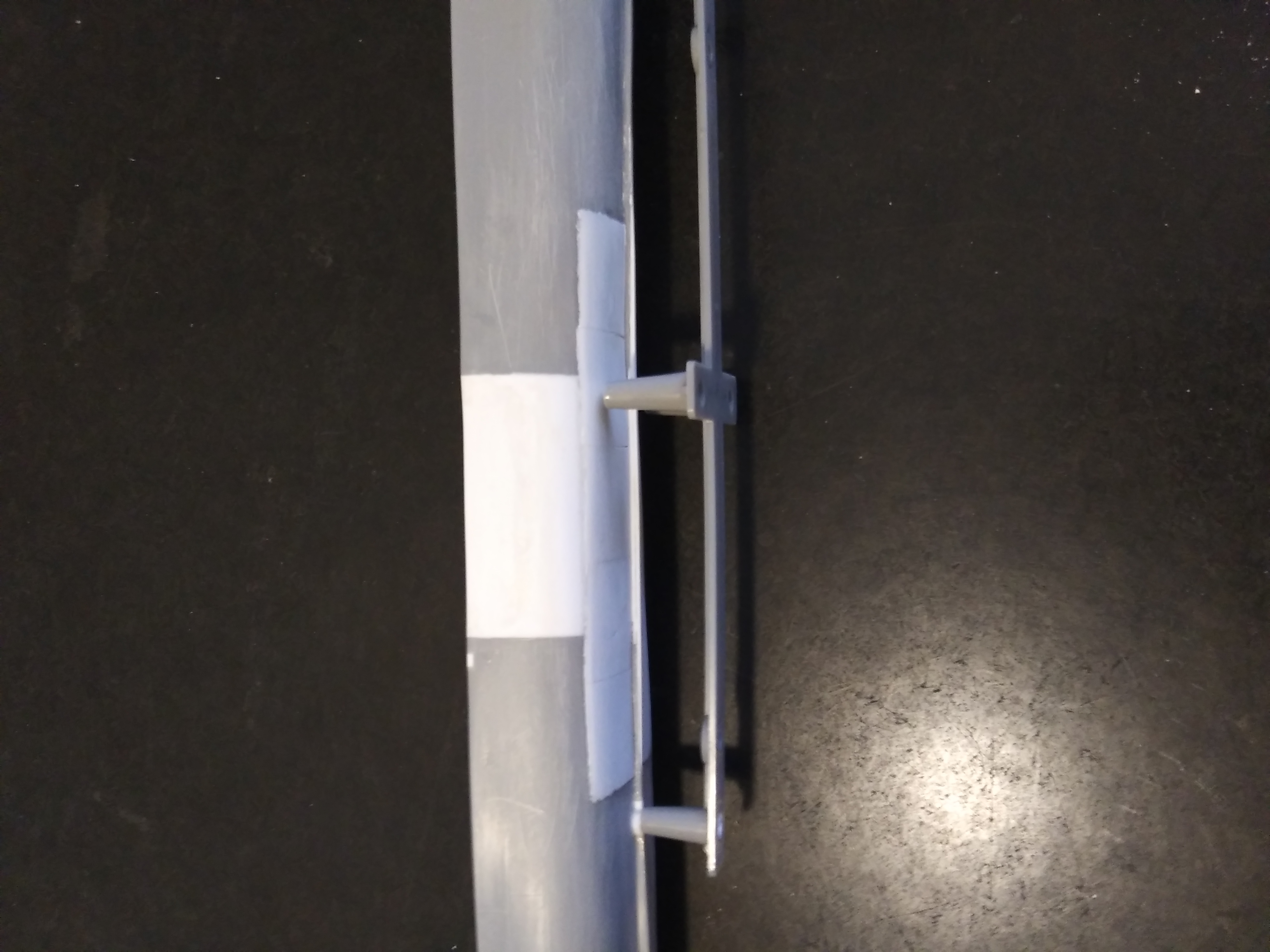

FFG-7 I remember this issue now, after not touching the model in many months, when I sanded the hull extension to blend in with the hull , parts of the keel got sanded down in certain areas, quick fix added a strip of white plastic to the keel and will add super glue later to even the keel out more.

that won't solve the bent model as can be seen in this picture of yours. download/file.php?id=158570&mode=view

The hull not bent, the curves of hull are changed due sanding to blend in with the hull extension, and hull is also push out with inside brackets to widen the hull. add all this together get a change hull curves fwd and aft of the extended hull section.
So I decided cut the inside brackets to take some of the pressure off the widening part, it only moved about .05mm at the most, this cause the extension part to bubble up little in some spots, as this is made up of four layers, it bubbled up inside the layers, also added white plastic to hull to try fill in area of heavy sanding see if will take out some of the curves, and then build the keel back up in this area.
