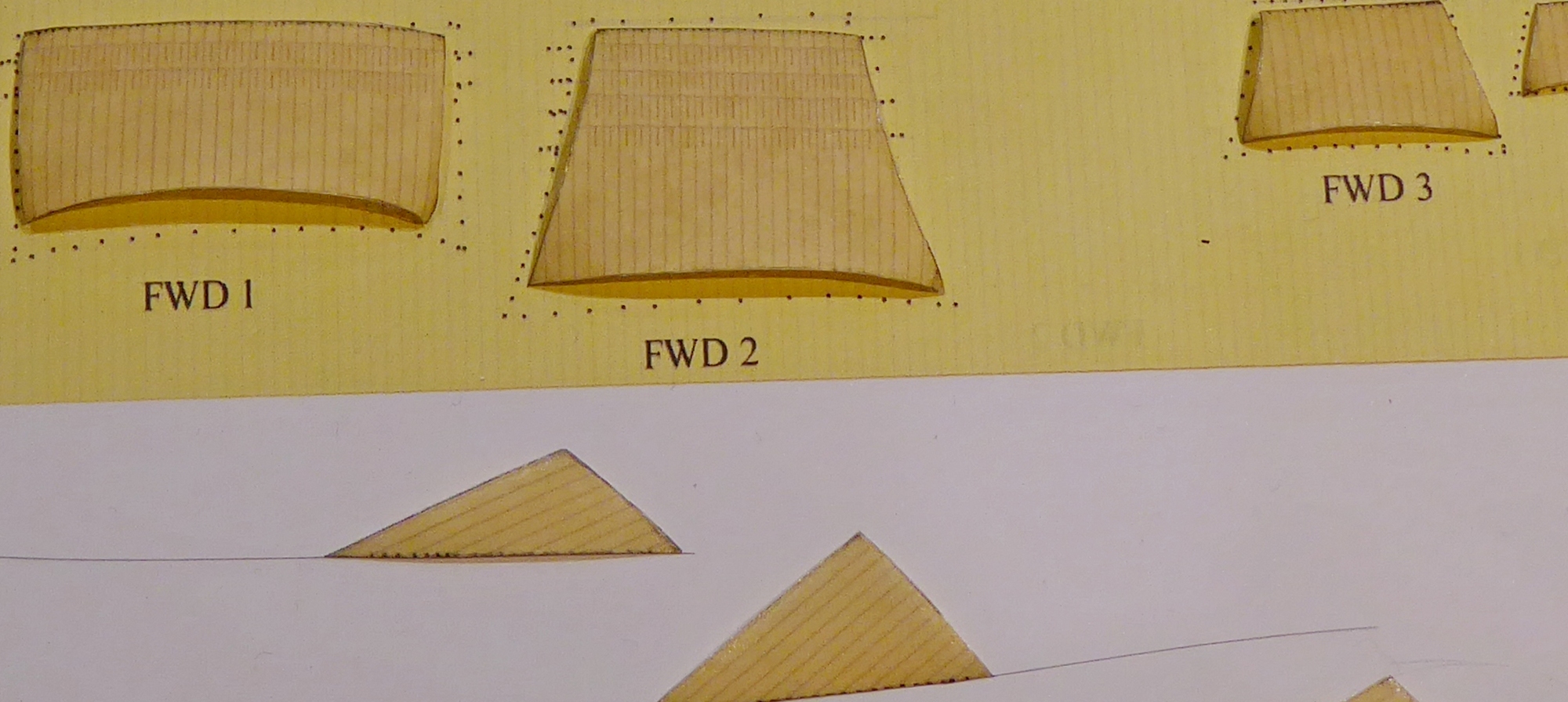

I try and make my sailmaking to look feasible--and subtle for the small scale
The top-sails are just over half the size of my small fingers finger nail....
I started by creating the ' new' the sail paper lines in much higher res
and experimented with different colours an shades, the Ochre shades as good for old paintings and large scale models.
Keeping in mind the small size--I wanted the reef pennant ropes ( RPR ) to be capable of being handles by my 1/700 crew
This means they are only just visible when printed....
The reef bands and RPR have been drawn in as a series dots rather than lines
When printed it removes the ' weight ' of line to the observers eye
The RPR get longer on every reef row--as the RPR need s to be long enough on the 4 th Reef to
reach around the previous 3 furled ropes as well as tied around the spar
Getting the RPR level was achieved by the simple and quick means of having a piece of paper taped to the screen (!)

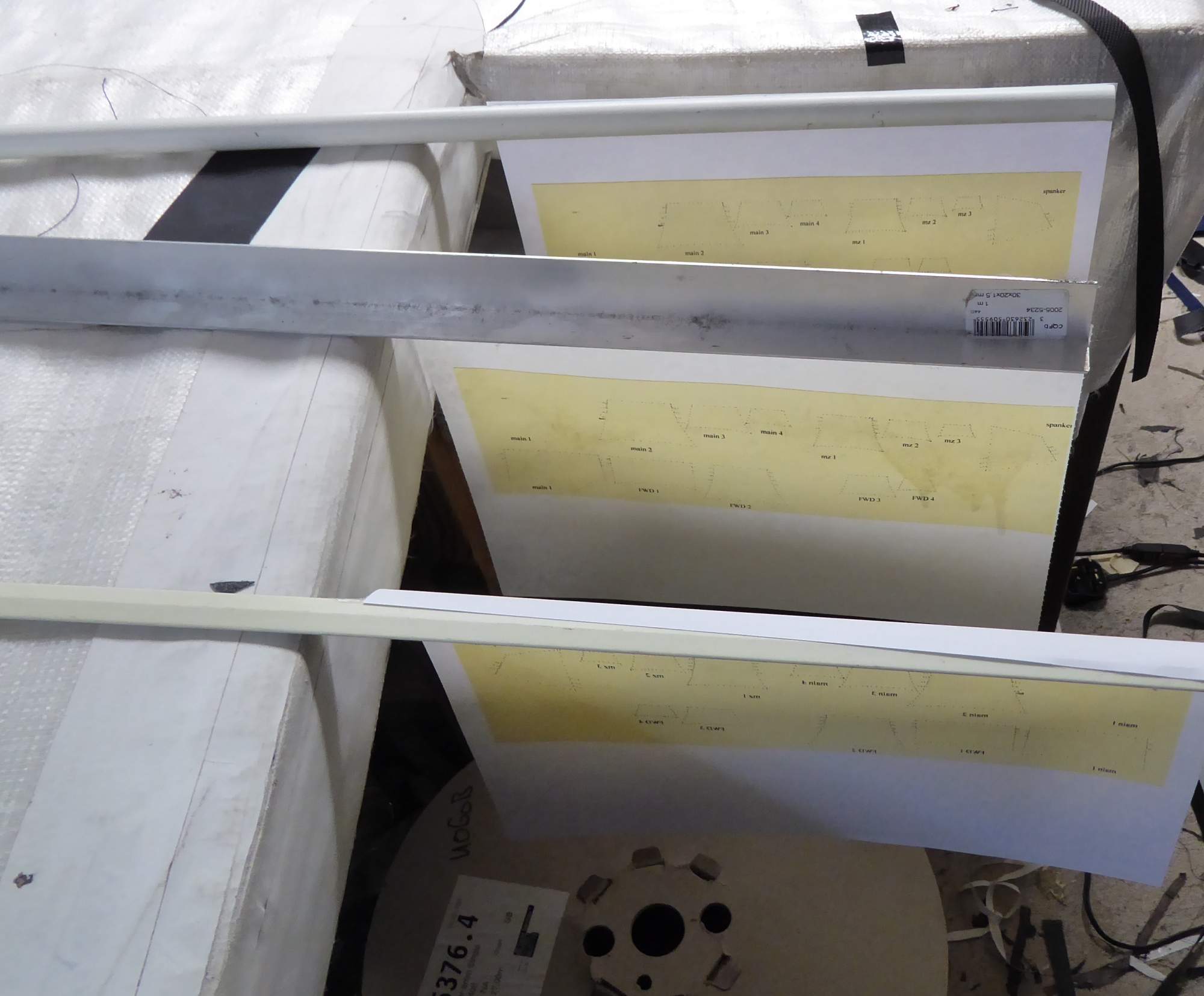

I printed a lot of different types of paper (!)
and also readjusting the file sizes to give an exact print size to mach the templates
This print was NOT exact...!
I use an inkjet printer--which is very un-waterproof, but gives a more subtle result than
my fried laser printer
To counteract this both sides have varnish sprayed on both sides
the image shows the sail 'sheets' hanging to dry...
Once varnished both sides I can work into the sails with watercolour and enamel paints to create the reinforced outer corners
as well as the anti-chafe patches on the inside just above the lower platforms

@ Rui Matos
No....not quite ...
the sail templates are cut out from a 1/700 scaled pdf drawing paper printout
This was slightly enlarged by 3-4% so that sails have enough (over) size for me to create the ' belly' and fullness shape
( as when its a 3 D shape takes up length in each direction hence making it slightly bigger compensates for this
as well as the narrow but full return curve at the leeches (vertical sides) caused by the 'bolt-ropes
( rope sewn in around the edges of the sails )
being tighter than the fabric
I simulate the bolt-ropes with 0.05 tinned copper wire glued onto the butt edge of the paper while the sail is flat ( fiddly! )
=> I do this on ' baking ' paper as the CA glue does not sticky that!"...
Then the sail is shaped firstly by rolling a round headed large paint brush handle to stretch the paper on a Post it note pad ,
then a small round headed paintbrush handle to create the 3D effect at the leech
The the copper wired sail edges are formed between fingers--the wire makes it hold its shape perfectly
( You can see the messy glue on this experimental unvarnished paper sail )
It is the same as I did on my 1/400 Mary Rose model--except now its half the size !! ( x 5 optvisor! )
The Bretagne sails are not as ' billowy' as the Tudor sail 300 years earlier,
by 1860 they strapped the sheets down harder and flatter
to gain some windward ability--approx 65-70 degrees off the wind
cheers
cheers
JB

meanwhile...
I have found a photo of a contemporary French sail steamer with sails set and actually sailing( and no reefing pennants.... )
ah well--mine has them now !!
( the sails seem to be flatter and set set tighter than the billowing sails of earlier in the 1800's...
I have made some progress--with all sails cut out and now starting the process of adding boltropes all round in 0.07 mm wire
It is quite a tedious process--but doing the gluing on grease-proof baking paper has simplified the arduos-but-almost -fun process....
The round ended plastic body of the old Parker fountain pen (with the spoon )
makes a good shaping tool when shaping sails on a post-it-note
With the pen I can apply point loadings to curl the paper slightly at the edges ( and not overdo it!)
Once all the sails have been wired and shaped
-- I will paint the boltropes-- and paint in the platform patches
and then attach them to their spars and yard arms in readiness for mounting and masting the ship to her sea-base !
