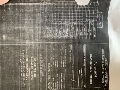

Found an interesting set of plans for the Fletcher class. Quality is not great but it has some interesting details to pick out.
One is the mast rigging
Another is that I get the impression there was some plans to make Mt’s 53 & 54 open top like on the Sims/Benson/Gleaves class. Those two mounts are drawn differently from the other three.
Cover sheet info

Not all the mounts were the same on the Fletchers. I am not sure for the reasoning for this. Hank Strub has researched for his Stoddard (DD566) for which he designed and 3D printed the mounts and comment on. which is which. I have seen no info indicating a possible open top set of mounts but our resident Fletcher expert Rick E Davis would know.

I missed your 31 August 2023 post. I don't know who you were posting your response to or what the question exactly was, but the 5-in/38 "guns" were not all exactly the same. There were different Mods as refinements/improvements were adopted on the production line. A noticeable difference were that the Gun Captain's hatch was either on the "left or right". The reason was that when production of the 5-in/38 mounts was being planned, the twin 5-in mounts needed two guns in the twin mount with mirror image layouts for loaders, etc. It was decided for the single 5-in guns that rather than produce a third mount type, that single mounts would use either a "left or right" 5-in gun inside the mount.
As for FLETCHER class drawings showing open 5-in/38 mounts, the initial plans for the FLETCHER class did indeed plan on open mounts for 53 and 54 mounts. That configuration was changed to enclosed mounts. On some "proposed" improvements, the original layout drawings were modified for illustration purposes.
