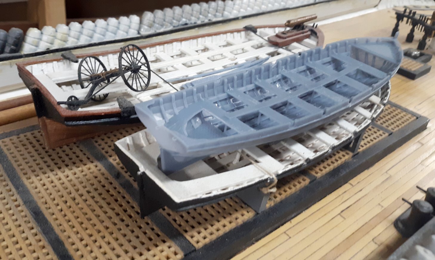

Small boats seem to be a reasonable place to begin and I have been working on the trusty USN WWII 26' MWB. This is just a trial technique balloon to explore the necessary technique.

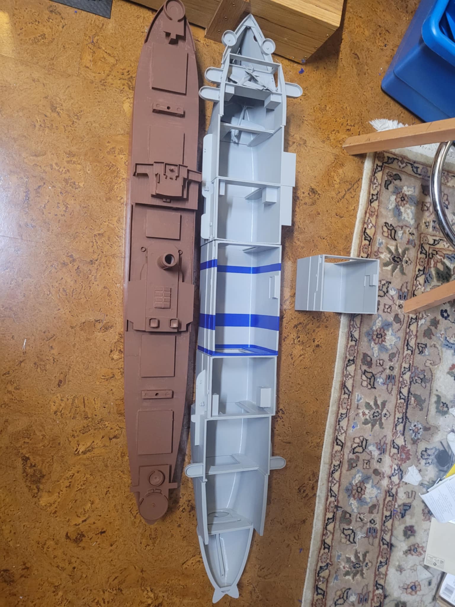

I've taken up the job of getting some cargo ship work done for a buddy - he wants a conversion of the Liberty Ship to a Park ship - so...here's what we ended up with:
https://www.thingiverse.com/thing:6873845
Not perfect, but close enough for his model railroad setup. It's a modification (with permission) of the Johnbuttery Liberty Ship model.
Next up is the 20mm Oerlikon twin mount that I put together. Looks pretty much the part - I'm pleased.
https://www.thingiverse.com/thing:6869601
Then - I took the other Liberty ship file that's on Thingiverse from Jaberwok and modified that into a pretty close match of HMS Puncher:
https://www.thingiverse.com/thing:6869595
Currently printing the Puncher.
Note - in the picture below, the Park is printed at N Scale - 1/160, and the Puncher is printed at 1/144.
Draft print in 1/350 scale
Puncher and Park side by each.

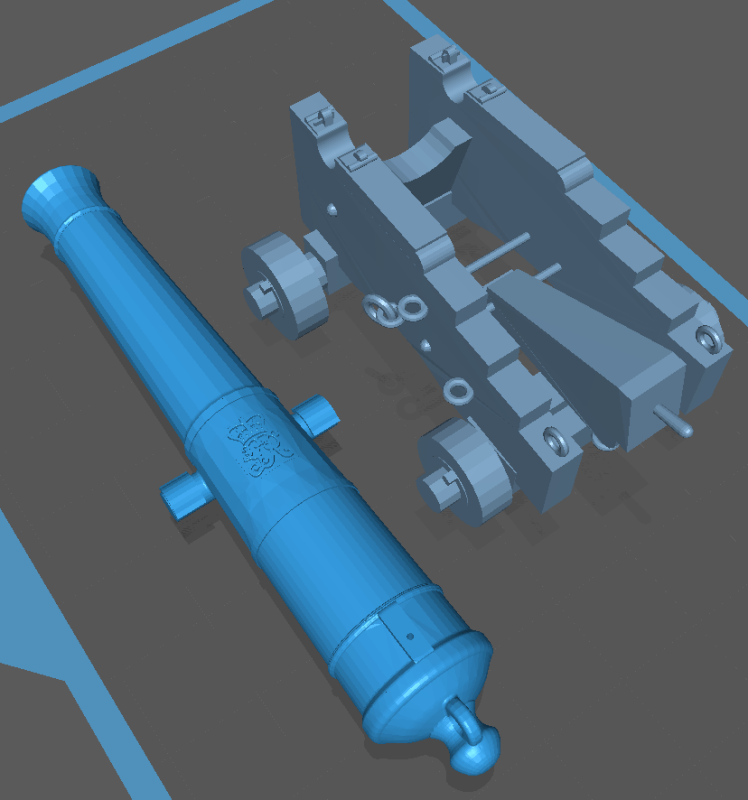

Modeling the capstan based on a drawing from NMM

A lot of facets on the barrel, which is a shame. Setting up the 3D drawing programme? :cool_2:

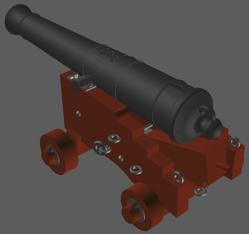

Iceman 29 wrote:A lot of facets on the barrel, which is a shame. Setting up the 3D drawing programme? :cool_2:
That barrel was done by someone else, and the cartouche was lifted on the surface, draginf some of the geometry along. I made a fresh barrel and laid the cartouche into it separately. It's still relatively "low-poly" but it's better. I changed out the model on Thingiverse too
18 pounder
18 pounder
Iceman 29

That's much better! :thumbs_up_1:
