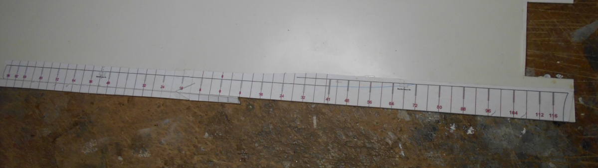

I finally reverted to the old bread and butter method for the hull. I was not satisfied with the styrene cladding. I also made my own photo etch with corel draw. Hauler etched it and it's not expensive

what thickness of styrene did you try to use as cladding for the hull?

FFG-7 wrote:what thickness of styrene did you try to use as cladding for the hull?
0,25 mm
FFG-7
Posts: 724
Re: 1/500 R.N. BOLZANO
Post by FFG-7 »
too thin & were you just cladding 2 frames at a time or do longer plates to cover more frames at once?

I filled with balsa the space between the frames, but the plating did not fit exactly to the frames.
I already used this method with succes but it was a 1/200 scale model with 0.5 plating

I used mostly 1mm thick styrene to frame then clad a scratch built 1/525 scale ww2 full hull tanker. did that over 30yrs ago & still have it. no balsa was used on it at all. my 1/144 warships are balsa framed but clad with 1mm styrene with the biggest being 52" long & about 40yrs old.
