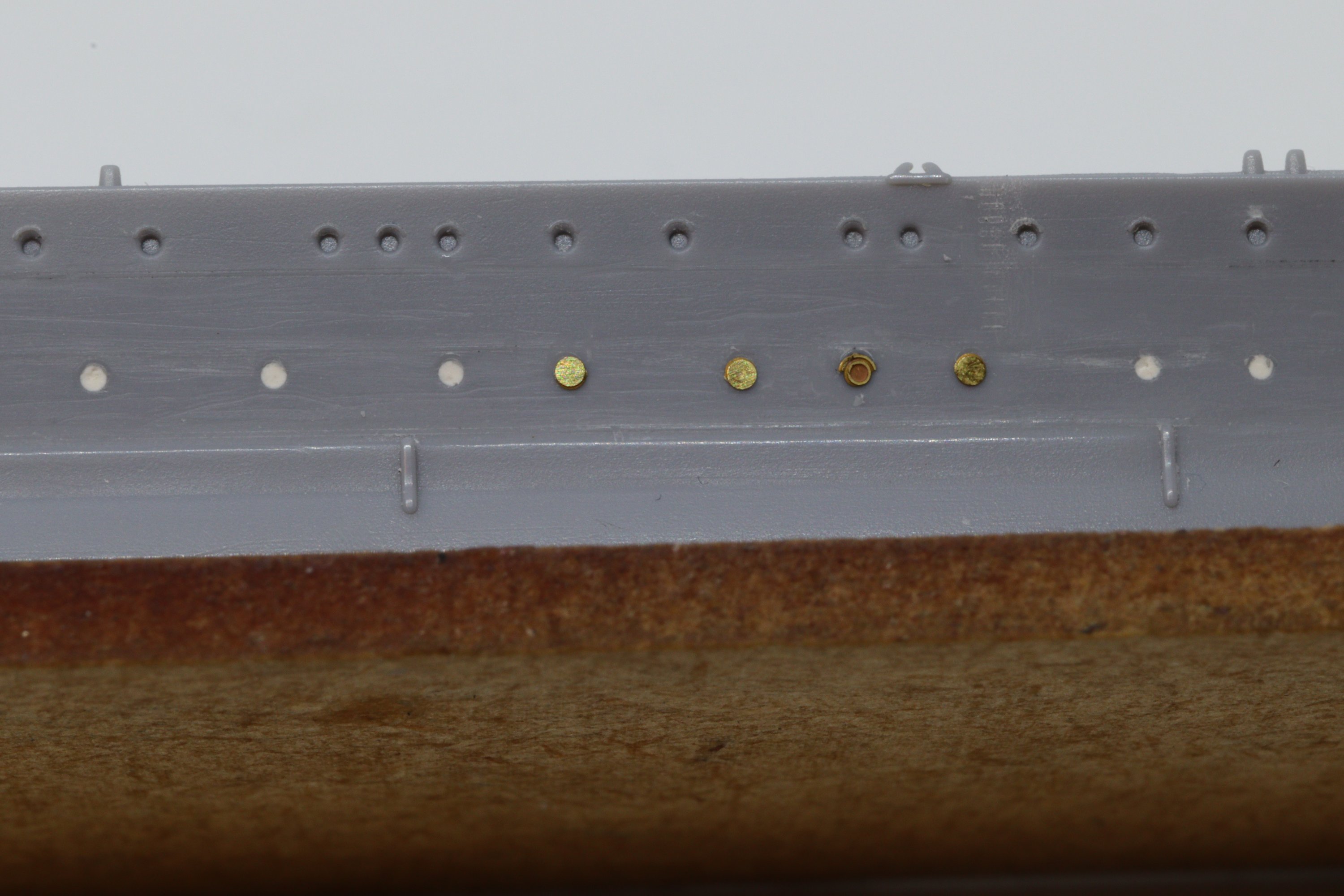

I should add that all the above work on sealing the portholes was in vain in the end. I was not satisfied how the PE seals turned out so I asked Simon and he´s been so kind to provide me with a set of 3D printed seals that look much better. So I had to drill the putty out from around 120 portholes – glad that the acrylic putty was quite soft :D
