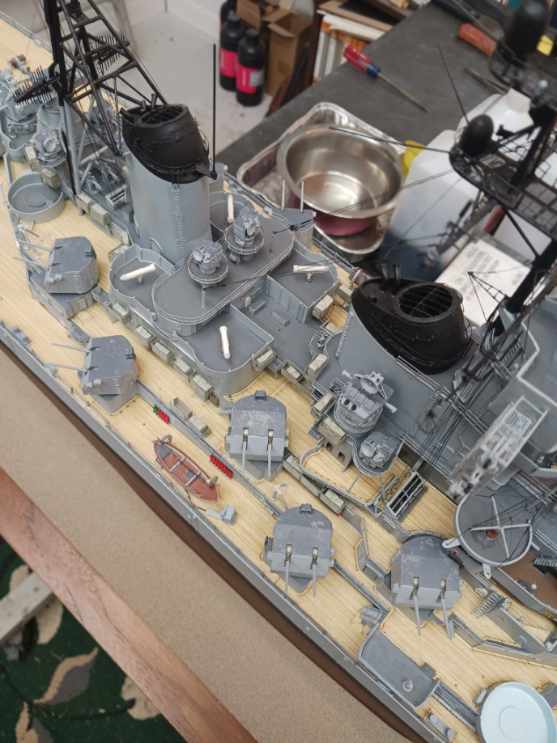

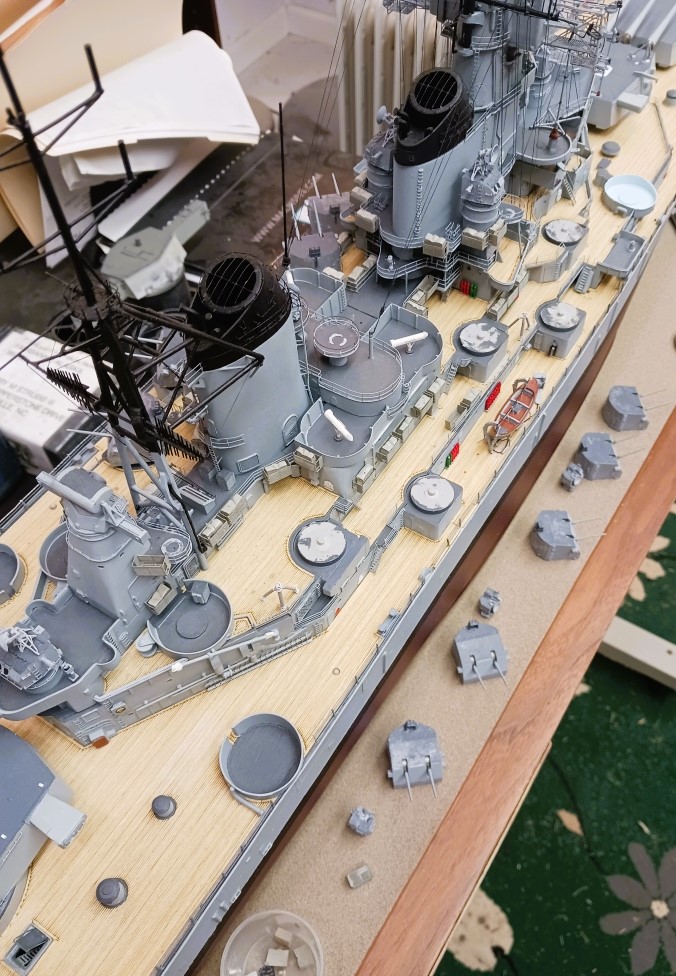

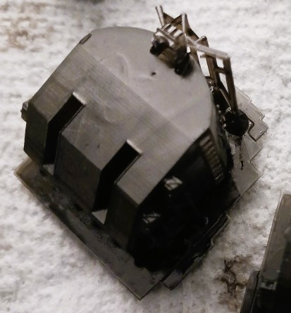

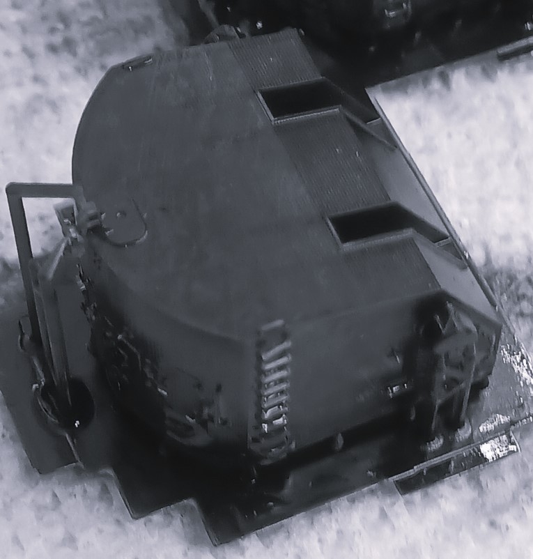

At the Fleet's In model warship show on board USS NORTH CAROLINA a couple weeks ago, my main entry was my 1/200 scale model of USS NEW JERSEY (BB-62). While at the show, I noticed that the 5"-gun mounts and Mk. 56 FC directors were once again showing signs of paint blotching and surface crystallization. Here is what I'm talking about -
This has ONLY occurred with 3D printed parts that were purchased thru Shapeways back when their normal product material was an opaque, white resin. Although they had mentioned at the time that they recommended using acrylic paint, I don't use acrylics and painted these with Testor spray/bottle enamel. Initially, I did not see any problems until last year and then went ahead and repainted 5" mount surfaces where needed. This time around, the Mk. 56 FC directors/RADAR dishes were also showing signs of both discoloration & crystallization. So, rather than mess around and waste time repainting AGAIN :doh_1: - I am making my own 3D parts (also with a higher level of details) using the Rapid Black Resin from Phrozen. As I had 3D files already made in other scales of both these parts, it was simply a matter of rescaling, correcting for thickness & stability, and printing. Today, I hope to have the last of these parts printed and ready for painting (Mr. Color Spray/Bottle lacquers) and assembly. The ship model will enter drydock for an unscheduled upkeep & replacement period while this work is performed.

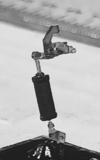

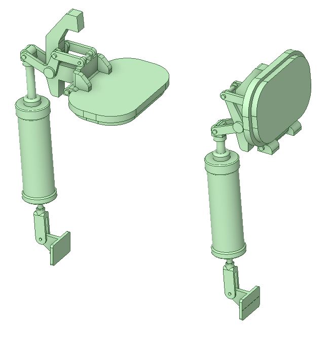

Redesigning the top hatch closing mechanism was an interesting side project as my original one was rather simple and less detailed. Here are the two (open/closed0 units I've come up with based on an illustration of the gun mount from the side -
5" mount top hatch closing mechanism (open/closed)
While the hatches are hard to see with the blast shield in place, I think this still makes for a higher level of details for the overall gun mount. And more importantly, they have printed out well even at 1/200 scale. Currently I am printing (2) of the mounts with the closed hatch and no blast shield (forwardmost 5" mounts on either side) and (8) of the 5" mounts with open hatch/blast shield.

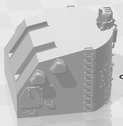

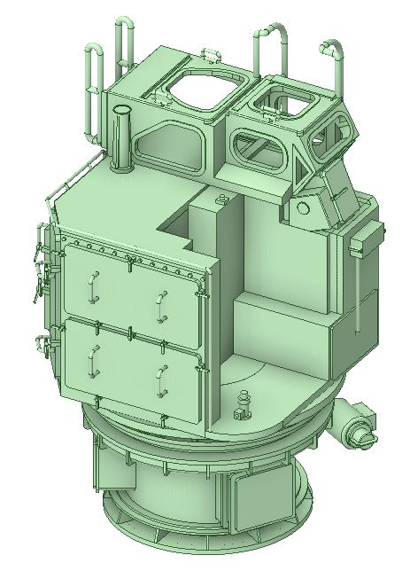

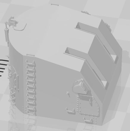

Next, the Mk. 56 FC director & RADAR are already printed and ready for painting/assembly. With a bit of thickening of the handrails, I have been able to get really good results in printing. Here's the design pix -
3D Design pix from file
Hopefully tonight after my last print run finishes, I'll be able to begin cleanup, painting, and assembly in prep for installation.

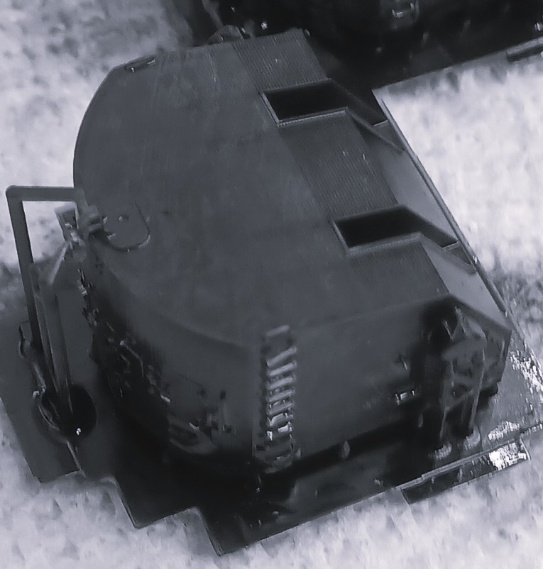

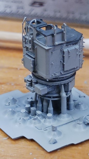

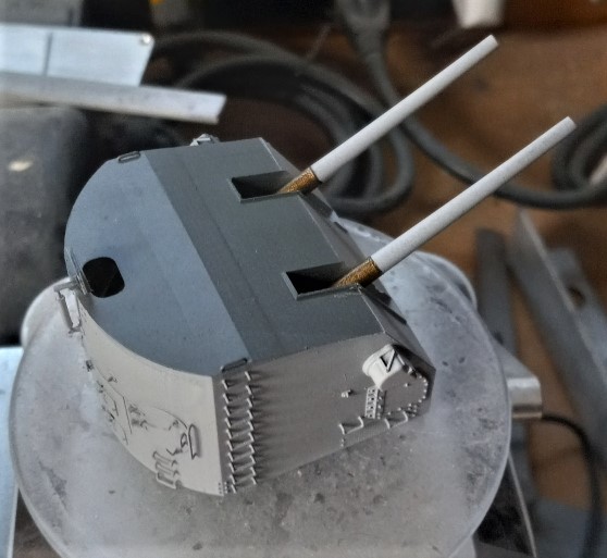

Once we were home from the Veteran's Day meal at Golden Corral, I went and checked on the printer. Everything came out excellently and is now drying. Here is a shot or two of the 5" gun mount just after being printed -
This is the version with open hatch & Blast Shield in place. Here is a shot of the closed hatch w/o the Blast Shield -
The 2nd round of barrels all came out very well this time, so I have a few spares at the moment.
My Mk. 56 FC Directors all came out excellently, as well. I just didn't take any photos yet as they are still in their printing supports and hard to visualize.

Good that you were able to correlate the cause of the original bubbling/crinkling of the paint.
I had to strip the paint off the entire flight deck of my Bonnie - turns out the green spray paint I was using doesn't seem to cure properly, so putting on a second layer even after a week of drying wasn't enough.

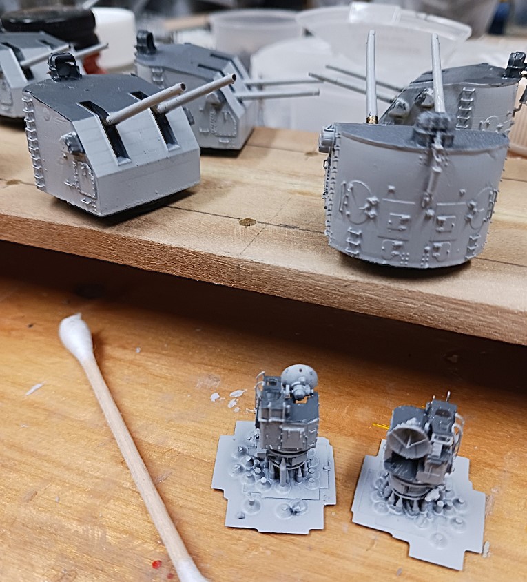

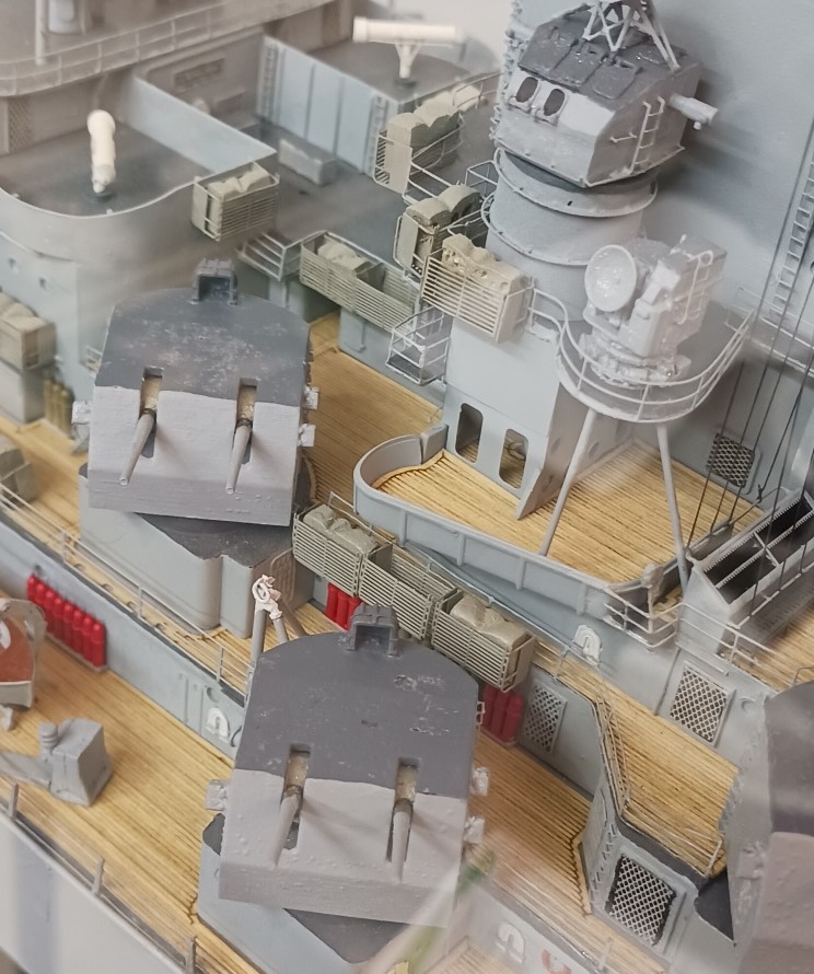

I've now finished painting both the mounts and the Mk. 56 FC directors -
I think the details on both items came out really well - these are, after all, 1/200 scale parts, so rather tiny. And... the commerical equivalents don't have nearly any of the fine details I've been able to achieve. Not bragging, just glad that my detailed design work was actually printable.
Perhaps after Christmas I'll have some space in the shop to open the case and begin the replacement of these parts on the ship model.

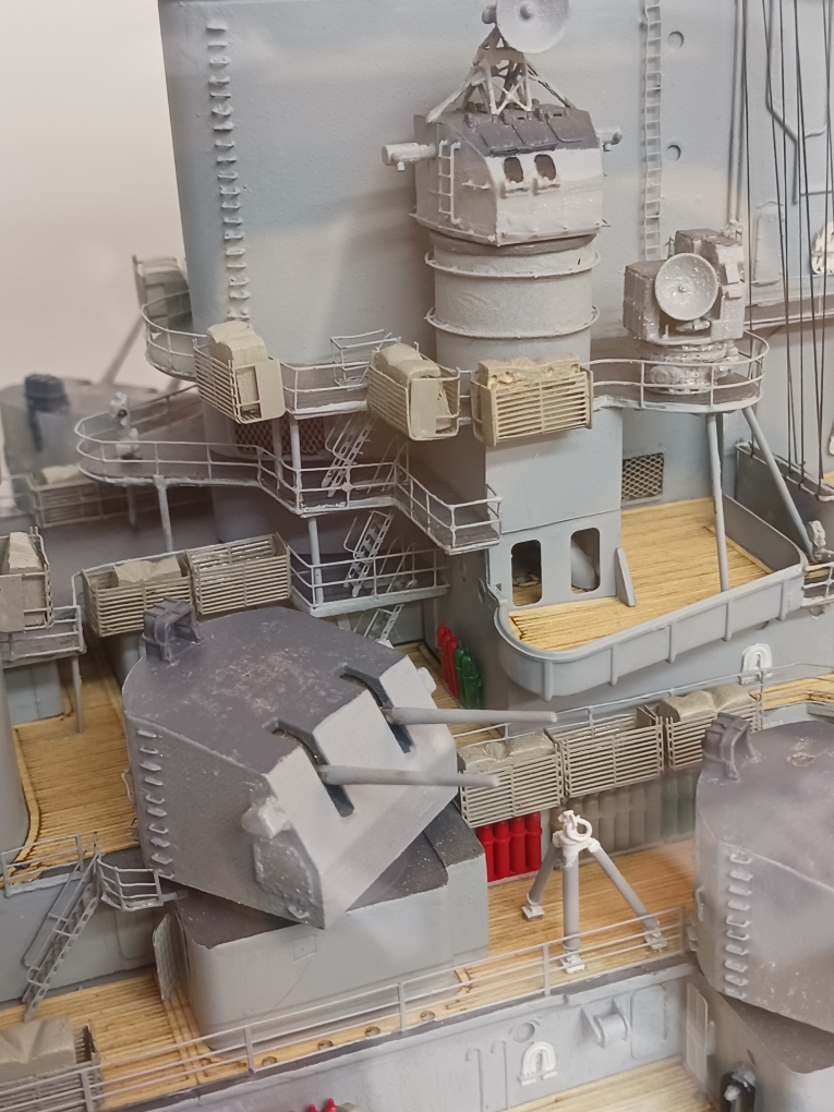

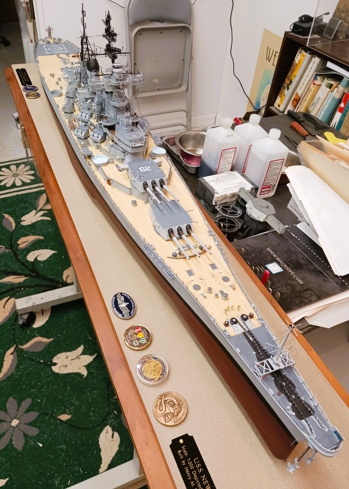

With the change to warm weather and help from The Admiral, NEW JERSEY went into drydock yesterday and we removed the display case -
Here's a shot of the stbd side and the 5" mounts & Mk. 56 FC Directors with mottled paint can be seen; these are the items to be replaced -
Last night I was successful in removing the stbd side parts without any problems (rather surprising given that I couldn't remember how much cement had been used to adhere them in place) -
This also includes removing the old stbd side Mk. 56 FCDs which came off easily, as well!
So far, this yard period is working out well... :eyebrows:

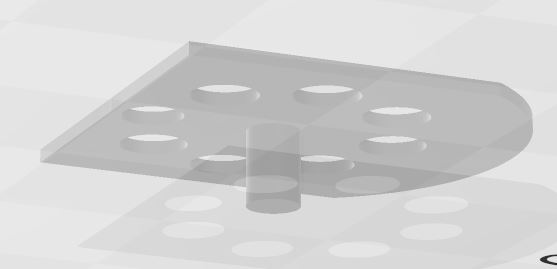

Last night's work came to a halt when I realized that the baseplates for the 5" mounts were incorrect - I had rescaled the mount parts for my large-scale gun mount (2024 project) and had forgotten that the round barbette below the baseplate should have been removed for this particular usage. So, the redesign & print setup only took about 20 minutes, but I ended up reprinting those baseplates with the printer in sort of a "jury-rigged" location in the shop - all came out fine but now I've got to survey my remaining gun mount parts and see if 10 are available that have all the details correct and if not, get those reprinted. Nothing that can't be done, just a small detour in the replacement process.
The baseplate is now correct -

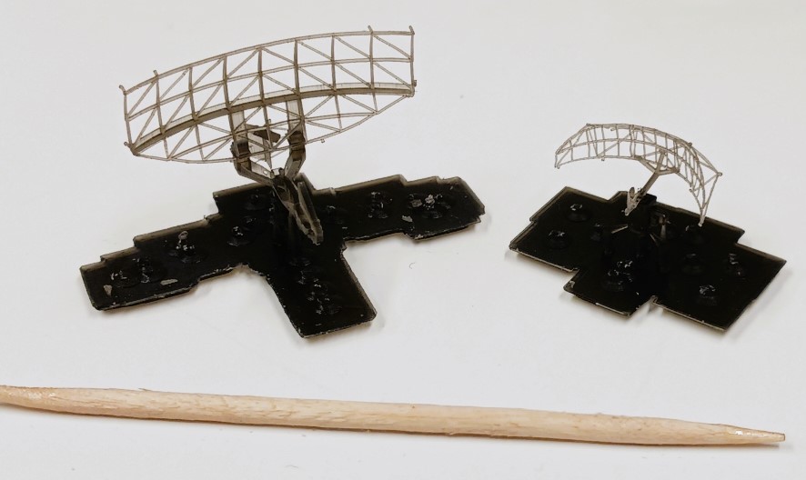

With RB resin stretched thin, I'm hoping to print (3) of each of these antennas in order to hopefully get at least one successful and useable unit.
BB62vet
Posts: 3173
Location: Mocksville, NC
Re: 1/200 scale Replacement Parts for Mk. 56 FC & 5"/38 Gun
Post by BB62vet »

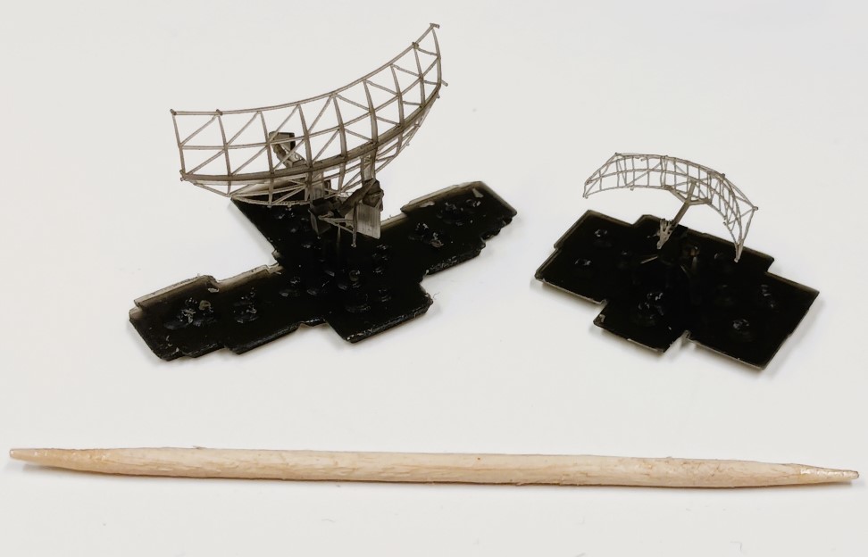

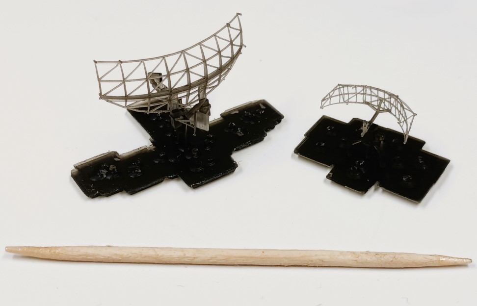

Surprisingly enough, all the RADAR units (3 of each type) printed out well. Only after trying to remove the supports did my butterfingers mess up one of each!!! The Admiral threatened to report my inefficiency to DOGE!!! :doh_1:
But here are examples of these tiny parts -

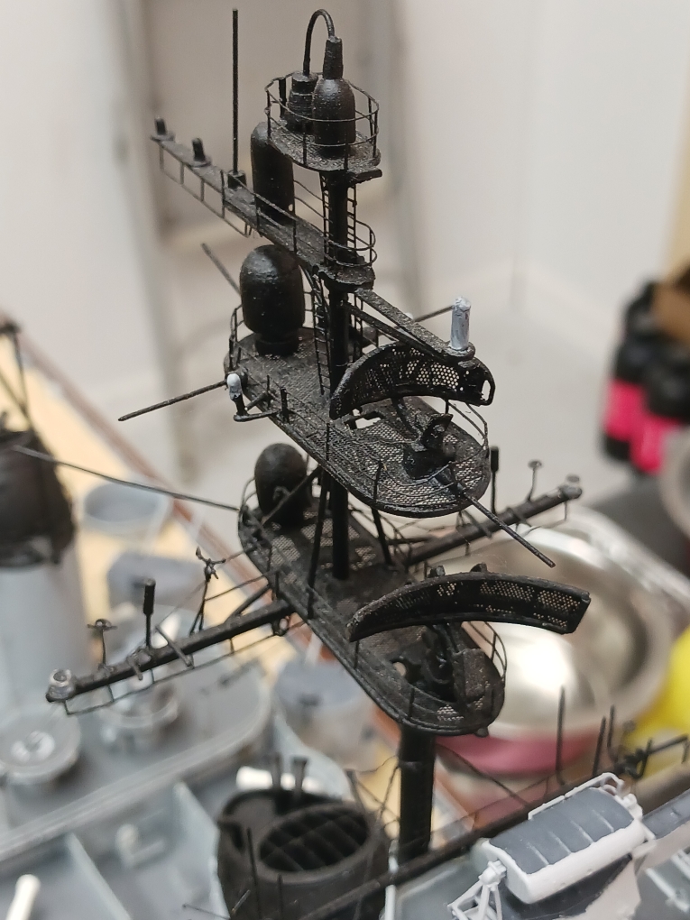

Here is a shot of the mast & RADARs as built -
I'm thinking the new 3D printed parts will be installed in this project!!!

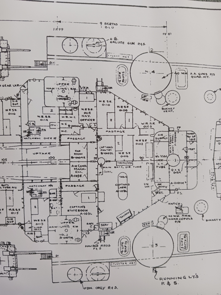

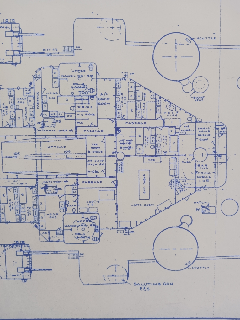

I dug out the 1967 BoGP for BB-62 and the saluting guns are not specified as to the size of the gun, etc., only that 2 of them would be shipped -
In addition, here is the plan view of that area of the deck showing the 2 saluting guns -
Here is the 1956 BoGP for BB-64 in which the saluting guns are actually called out -

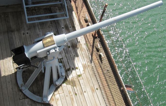

I did find a few photos of the saluting guns on USS SALEM (CA-139) as a museum ship and these are closer to what I recall as being on board NEW JERSEY during her 3rd commission -
So, without being able to locate a copy of BuOrd Pamphlet 1112, First Revision, which would more than likely have the 6 pd cannon listed, I'll 3D design/print the version on board USS SALEM and we'll call it a day; this I think, approximates the version as close as I can determine at the current time.
