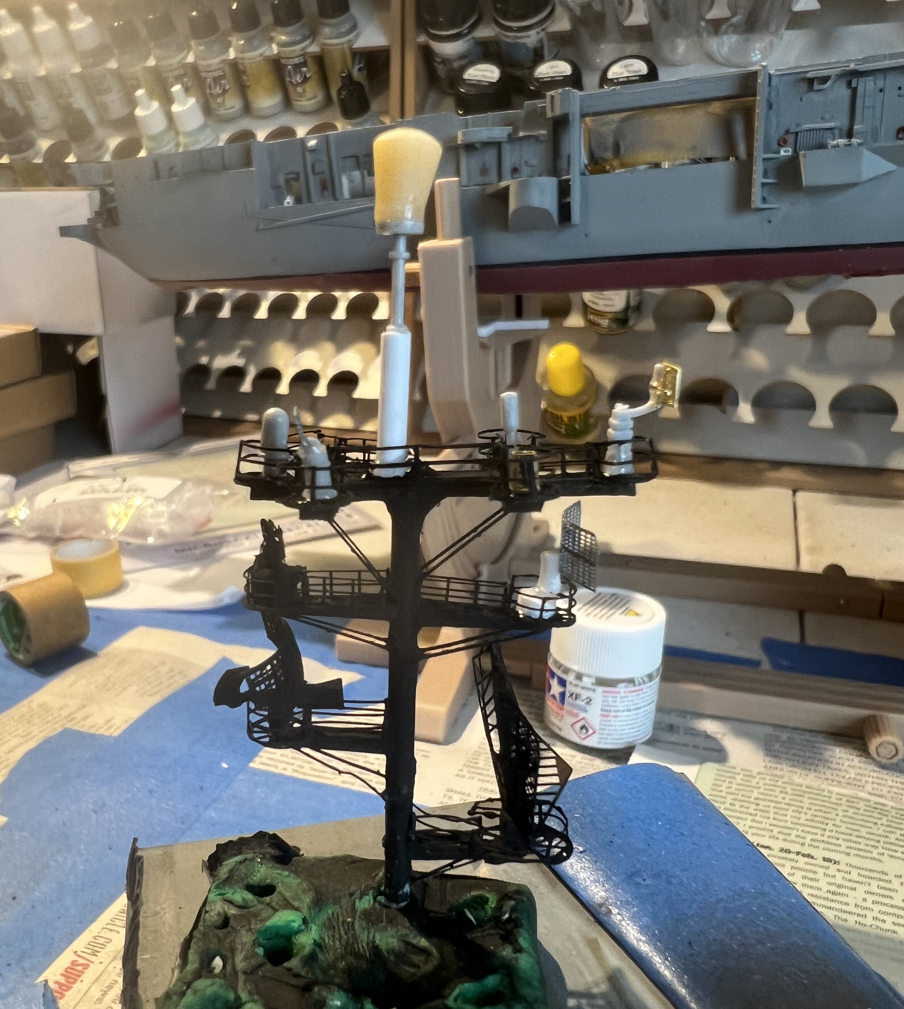

Today's new project was to start the scratch building of the mast. The 1957 USS Hornet (CVA-12) mast was far different than the Gallery Models USS Intrepid mast. The kit doesn't provide many of the parts I'll need for this. I ordered some of the radars and have built them and stored them away for safe keeping. Hornet's radar stands all face to the bow or stern. None face to the starboard or port sides until near the top of the mast.. I will have to create the mast top from Evergreen plastic and photo-etch as well as the top extension for the AN/URN-3 Beacon Ant. Unfortunately, no kits provide that Beacon ant so I'll have to scratch build that also. Thanks to my beautiful wife for helping by spraying the accelerator while I held parts in place. Good start I think.

Got some work done on my CVA-12 USS Hornet 1957 mast. The mast and parts from the Gallery Intrepid kit as well as the Tetro photo-etch set do not provide most of the things needed for this mast, thus scratch building is required. I've included a B/W photo of Wasp in 1955 with the update mast including the X Beam that Hornet did not have as well as a page from the Intrepid kit instructions showing how the mast looks from the kit. I had to scratch build the top main beam with it's four cross beams from Evergreen Plastic. Not the best (would have preferred photo-etch but no-one makes it) but it'll do. I've already built the radar sets and stored each securely until it's time to add them. Still have to scratch build the AN-URN-3 Ant and place that atop a pole smaller in diameter than the main mast and then add the support rods for the radar support beams as well as many small items and of course the railings. The entire mast will be airbrushed black prior to be permanently placed on the island.

Pushed through my dread and got the photo-etch on the mast. It wasn't easy since the photo-etch from the Gallery kit (and of course the Tetra set for the kit) are not matches for how the 57 USS Hornet's mast was. I played and fidgeted with both sets to make it work. Not perfect but it looks good. The entire mast (except for the Ant. covers) will be black. Of course the kit and Tetra do not provide all of the ant's. needed. I'll have to figure some things out. Overall though, I'm pretty happy with it. To top that off today I just found a printer on Shapeways that makes the AN/URN-3 TACAN Ant so I won't have to make that myself. Now if someone would produce the four corner Phasor 90 structures I'd be elated!

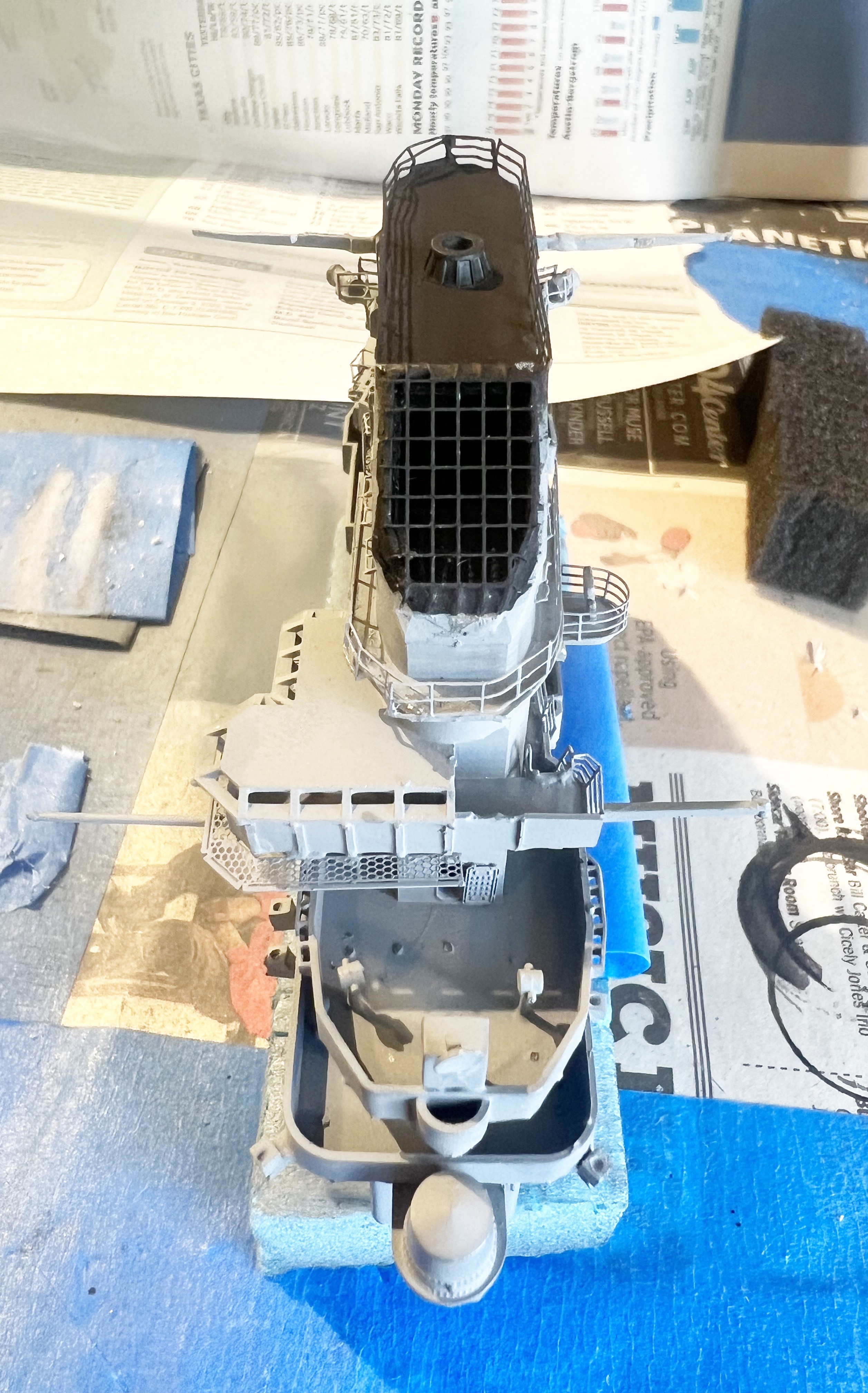

I masked-off the island top and airbrushed the entire topside of the Island flat black. I realized that when I was using a reference photo for the mast that the CVA-9 (Essex) mast was different the CVA-12 (Hornet) in 1957. Well of course. I looked at a reference photo of Hornet in 57 and the SPS-29 wasn't on the rear lowest mast platform. DOOOOOOH! It was on the rear topside of the island behind the mast. I carefully sawed the SPS-29 off of the mast platform. I then realized that the SPS-29 would need a small additional base added so I cut a piece for that and glued it into place. I then glued the SPS-29 into the correct location. I then used the kit supplied SPN-6 photo-etch and put that together with the kit supplied plastic base piece. I glued the SPN-6 into the correct location of the rear lowest mast platform which now makes my mast correct (Thus far) for Hornet 1957. I airbrushed the mast flat black. Still alot to add and scratch build to complete the mast. Waiting on the 3D printed AN/URN-3 Ant. to arrive so I can add that to the top of the mast.
