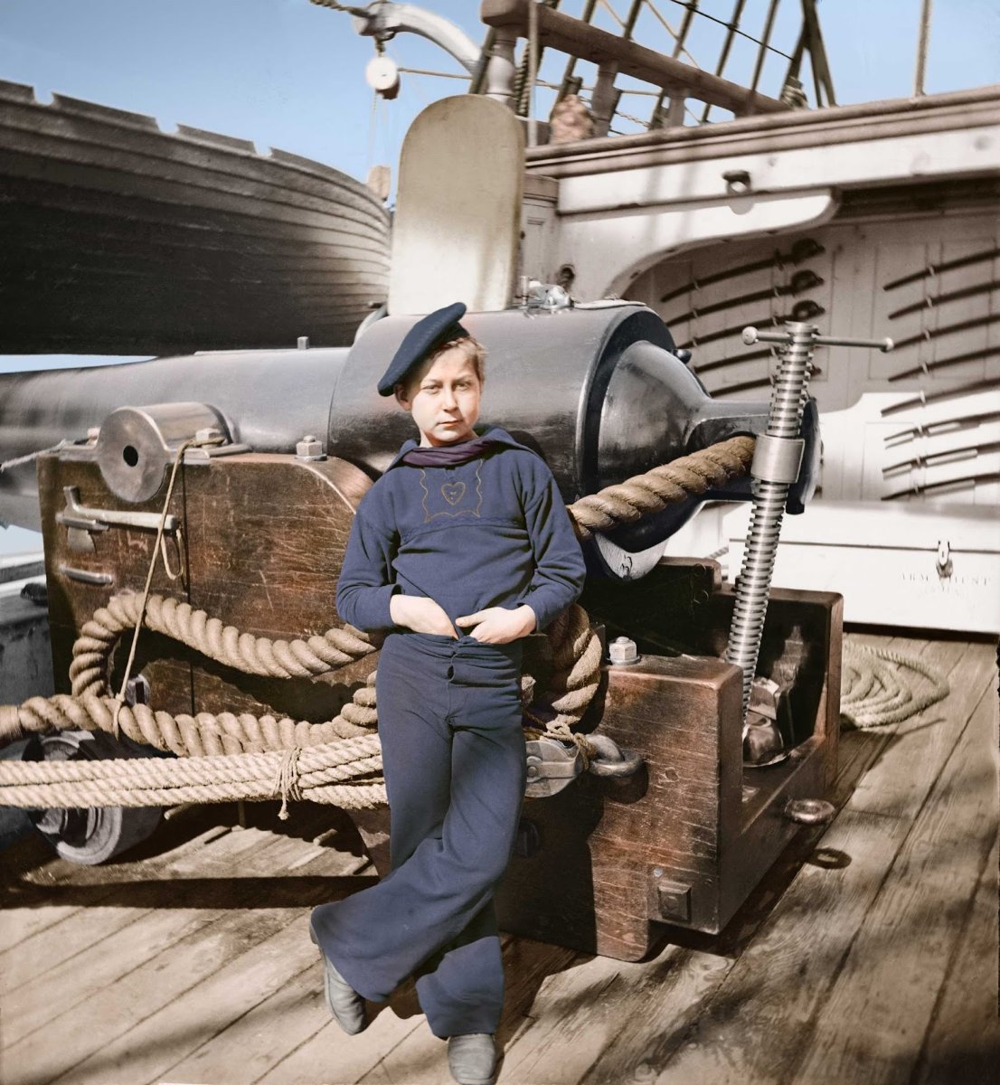

The "Powder Monkey" image has been popping up recently, but you know social media, everything old is new discovery in a day or two.
Here's my favorite colorization of that photo
File comment: A colorized version of the "Powder Monkey" photo.
I always thought the gun was a 30# Parrott, but this recent attention to the images, and the other images of the New Hampshire crewmen posing next to it had me realizing that wasn't right.
The gun's too big, relative to the men (and boys). So I looked up the New Hampshire's armament and found she had 4 100# Parrotts in addition to her broadside pieces. That wasn't right either; the end of the cascable of this gun stopped right even with the back of the carriage, a 100# Parrott would have stuck out aft much further than that from where the trunnions were.
Digging around again, I found that the gun was a 60# Parrott, and I found actual plans for it. Well, pictures of plans, but the measurements were marked, so I could use them.
When I thought I could just pop my existing 3D model 30# Parrott on my already existing 3D model Marsilly carriage, and have another model made - it's turns out I have to start almost from scratch for this one.
I got the tube done, and added to the collection, but I have to come back to the carriage...
