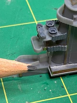

I have a few questions about Lex. I have the Trumpeter 1/350 kit as my base, I will use Model Monkeys Island, funnel, boat pockets and rudder to help the trumpeter kit. for references I have Warship Pictorial 33, Navsourse, and here.
I am an above average builder but far from a master.
As I start my prep for the kit these questions have come up.
1. Did Lex have three bladed propellers at Coral Sea? If so, is there a place to buy them?
2.Is there any pe degaussing cable and diagram of the installation on Lex?
3. Did Lex have a "Tilly" on board?
4. Did Lex have any aircraft handling vehicles on board?
5. Any pictures that would show deck equipment on the island levels? pelorus, voice tubes, search/signal lamps, chairs, etc.
Now to start reading thru the 50 pages of data here!
Thank you for any insight,
Dan
