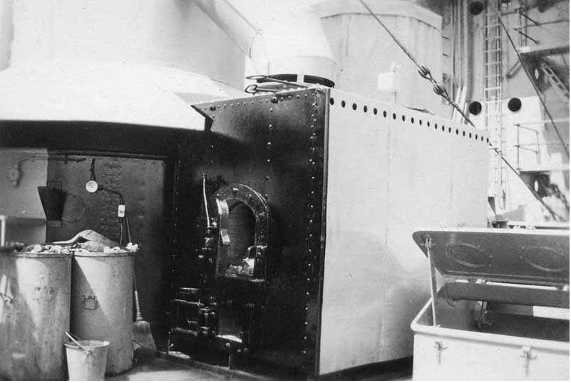

Here's a rare look at the incinerator on USS Tennessee. Finding a pick of any of the incinerator's on any of the pre-war battleships is challenging to say the least.
Notice the face is painted black. Also notice that the black paint extends onto the base of the funnel as well.

This is the first photo I've ever seen of an incinerator aboard these ships. Thx for posting, Jeff. And a nice partial view of the back of her bridge superstructure as well.
