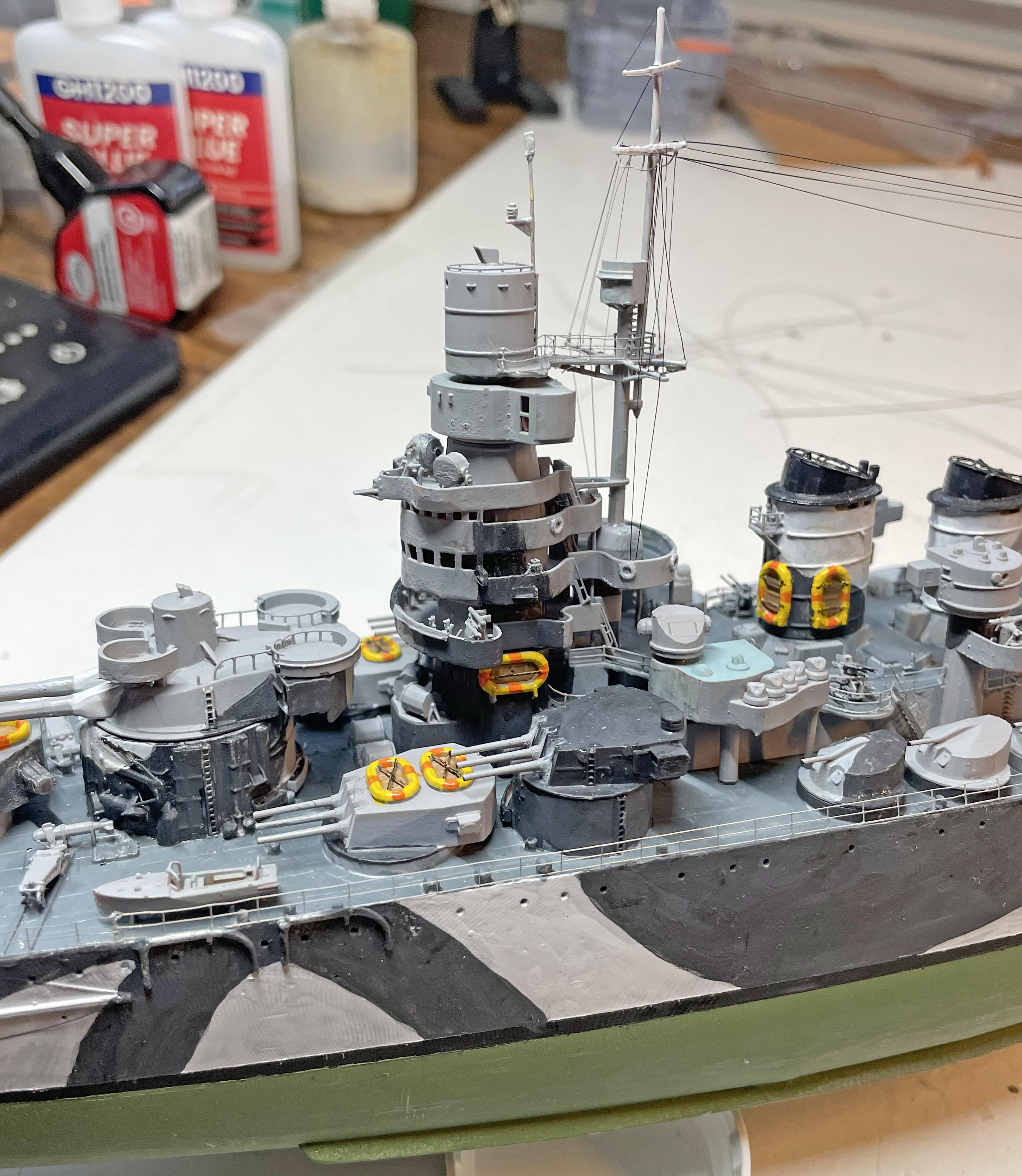

Regarding painting the superstructure parts, this has always been a major effort for me with dazzle camouflage patterns. When the superstructure is in one or two parts, this can be done with brushing before gluing the parts into place on the hull; at least the part to be glued can be held at various angles to access every section. What I do first is spray or airbrush the lightest color on the whole section (e.g, the bridge), including the bridge deck undersides, then brush on the darker color(s) afterward. I have found that using paints of different types (acrylic for one color, oil-based enamel for another) minimizes smearing when one color overlaps another. It is tedious, but that is part of building a detailed model. Frequent touch-ups of the colors will be necessary to assure straight line or gentle curve separation, which is usually the case in the superstructure sections. I've attached two photos of the port and starboard sides of the bridge and nearby structures. The model still isn't completed; I'm awaiting the arrival of 3D-printed twin 37mm and twin 20mm AA guns, as well as porthole scuttles.
