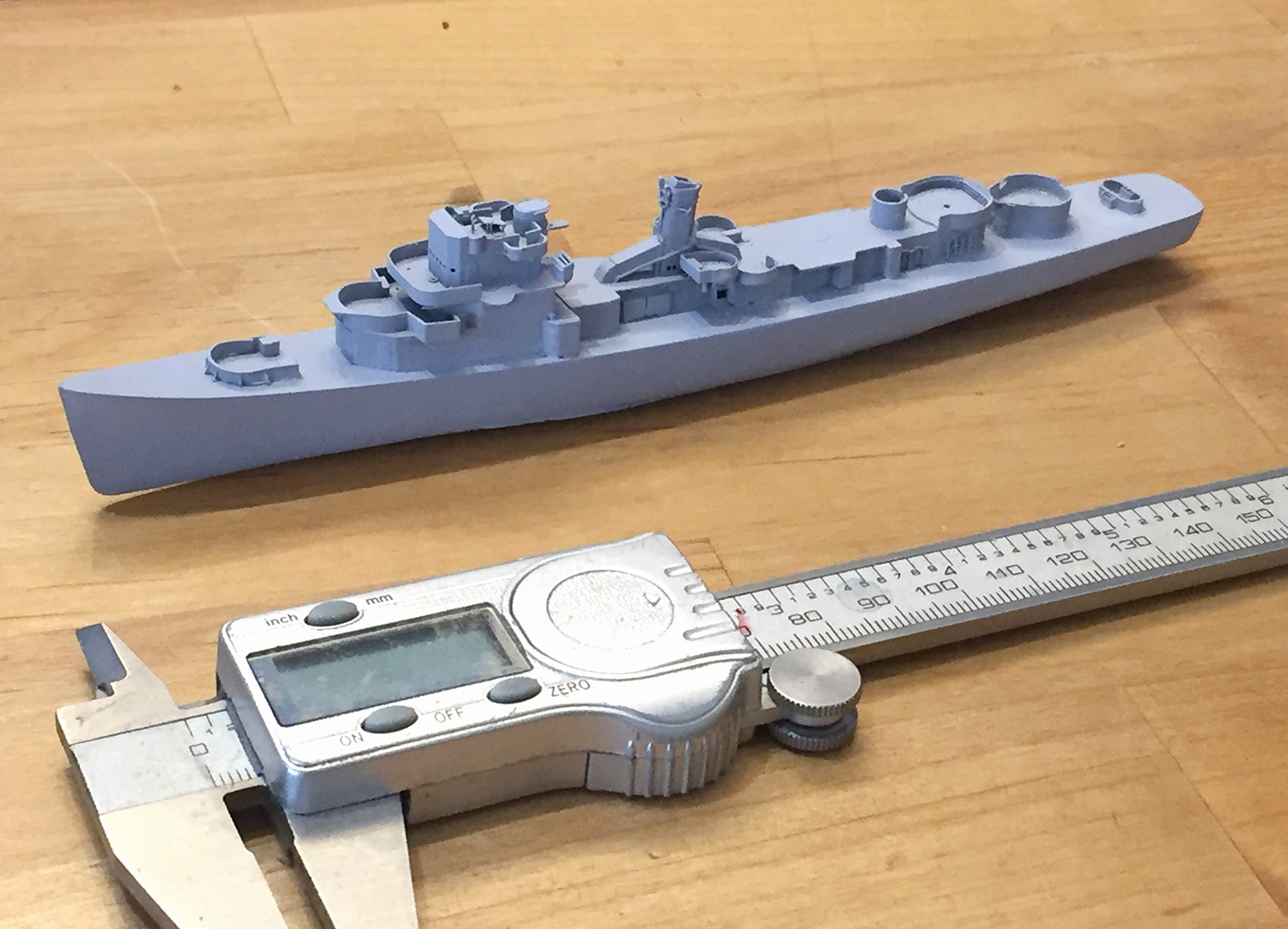

Post by Fliger747 »
1:500 DE England:
Basic hull with two superstructure and three tubs added.

Post by Fliger747 »
Certainly the number of tiny adz parts (TAP's) that are feasible are reduced from a 1:144 model. There you can do towing pads and whatnot, here about the smallest component one can do might be a sky lookout chair. For instance items such as superstructure railings must be beefed up both to print and also to have any ability to be de supported and applied in a survivable state.

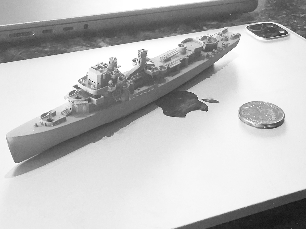

Added numerous small bits and pieces: Depth cargoes and K guns, sky Lookouts, director, tubes, small hatches etc. Time to start base color coats soon.
Posts: 5068
Re: DE England
Post by Fliger747 »
Current progress. With a model this small many pieces are very delicate and have had to be replaced. The latest was the props which extend below the bottom of the hull and I mistakenly set it down and squished the bottom blades! Still working on the aft 01 level 1,1 quad. I was able to modify Hank's larger scale barrel assembly but still working on the carriage.
