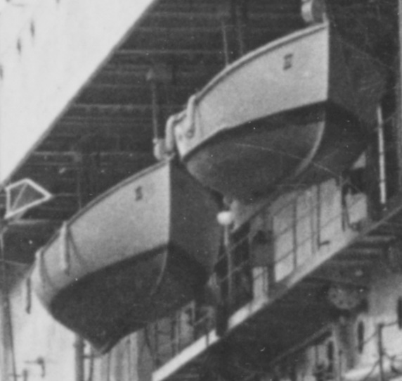

Still working on the c. 1940 Yorktown. I have a question about the boats that were hung under the flight deck over hang amidships. I have attached a section of the Yorktown class Booklet of General Plans showing the ones I’m talking about. If I understand the drawings correctly, the boats are basically suspended beneath the decks by two block and tackles (red ellipses) per boat.
My question is were they secured by other cables/ropes to prevent them from swinging and bumping into things or were the attaching block and tackle arrangements short enough to allow them to swing while preventing them from bumping into things?

Hope this helps.

Very much so. Thanks Steve. I did not have a good picture of these boats in any of my references and I could not find any on the internets. Where did this come from?
I have one more question, I noticed that the BOGP lists these boats as 30' - 0" sailing whale boat. Are they truly unpowered or did they have a motor?

Hi Mark,
The photo comes from the National Archives, catalog number 80-G-63560.
The boats in the photo appear to have props but I could be wrong.
Here's another photo showing the configuration of the straps securing the boats.
Hope this helps.
CV-5 Yorktown 1937_07_14 19-N-17193 cropped small.jpg [ 178.35 KiB | Viewed 1440 times ]
Have fun, Monkey around.™

Thanks Steve.
It helps a lot. I was wondering where they would be positioned in relation to the small deck behind them. Above or below. The picture shows the tops of the boats about in the middle of the chain rails with the bottoms of the hulls just below the deck plate.
It will also give me a use for some of the PE fret frames I have been hording from other builds.

Those small boats are probably 26' Motor Whaleboats - a typical small boat carried on almost all WWll classes of ships. Here is a detailed photos of the typ. davit block setup for those boats:
Here is a 26' MWB on davits with covered steel blocks as opposed to the wooden blocks that were common in WWII era:
This photo is from the 1960s era aboard a FLETCHER class DD.
Referring back to your original drawing, I think I would go with (2) dbl wooden blocks for each davit as shown in my first photo. Steve's last photo showing the diagonal bracing is also typ. of the type of tie-downs that were common for those boats in davits.
Hope this helps,

Thanks for the pictures and verifying the use of the two tie downs BB62vet. I'm not so much worried about the block and tackles so much. They will be very small in 1/487 but your picture shows I guessed correctly about placing an engine box amidships on them.
But this does raise another question in my mind, would the boats be pulled into contact with the platform deck plate by the straps?

Mark,
Refer again to Model Monkey's last photo - if you look real close at the boat's orientation, you'll see that they are slightly pulled in towards the exterior bulkhead of the ship (thus showing the edge of the port side of the boat). That's the effect of the lateral tie-downs. I don't think that the boat keel would be in contact with the deck plates. I'm certainly a novice when it comes to carriers, but small boats of that period were all stowed in similar fashion, whether from davits or overhead tackle (as in this case). I've tried to find photos of this area of WWII era carriers where the boats were stowed but without success. :huh:
Hope this helps!

I was wondering since the straps seem to be pulling the outsides of the boats down which would cause the keels to swing in towards the deck behind them. I thought that maybe the would be pulled to the point of making contact to the deck, but I see now that if the downward shift was small the keels would not come in contact with the deck but the tension generated on the overhead davits would keep the boats steady.

"I was wondering since the straps seem to be pulling the outsides of the boats down which would cause the keels to swing in towards the deck behind them. I thought that maybe the would be pulled to the point of making contact to the deck, but I see now that if the downward shift was small the keels would not come in contact with the deck but the tension generated on the overhead davits would keep the boats steady."
Again, you're overthinking this whole thing. Your first comment above is correct - the keels will be drawn IN not down. Here is a photo (again, a davited boat but that doesn't matter - the straps in this situation cause the same effect) which shows what we're discussing -
I don't think you have anything to worry about!!!
