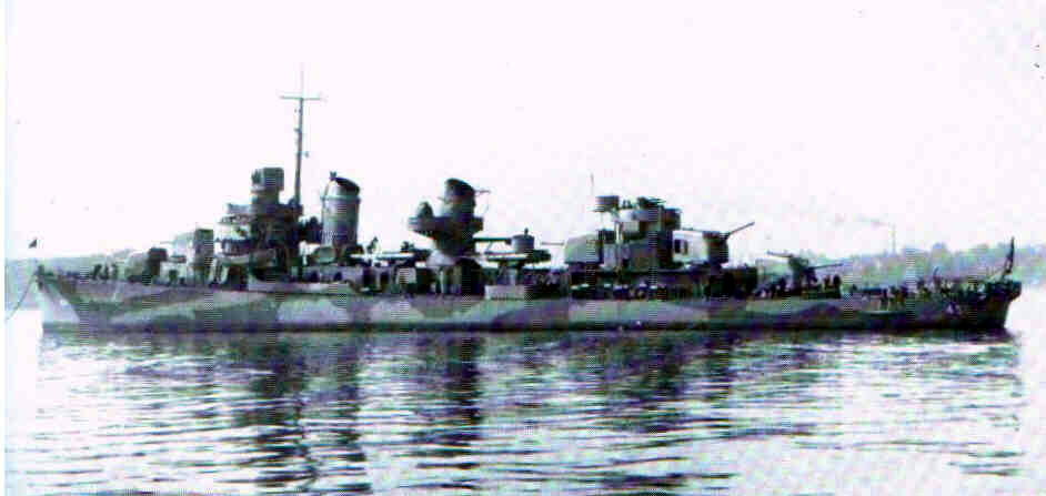

I wonder if this picture shows the Fletcher painting out of Ms18 and into Ms21?
Also, look at this one from the Fletcher website, dated Feb 1942. I know it's dangerous to try and guess what paint colors are in B/W photos, but it could be 5H on the turrets (left side of picture).
