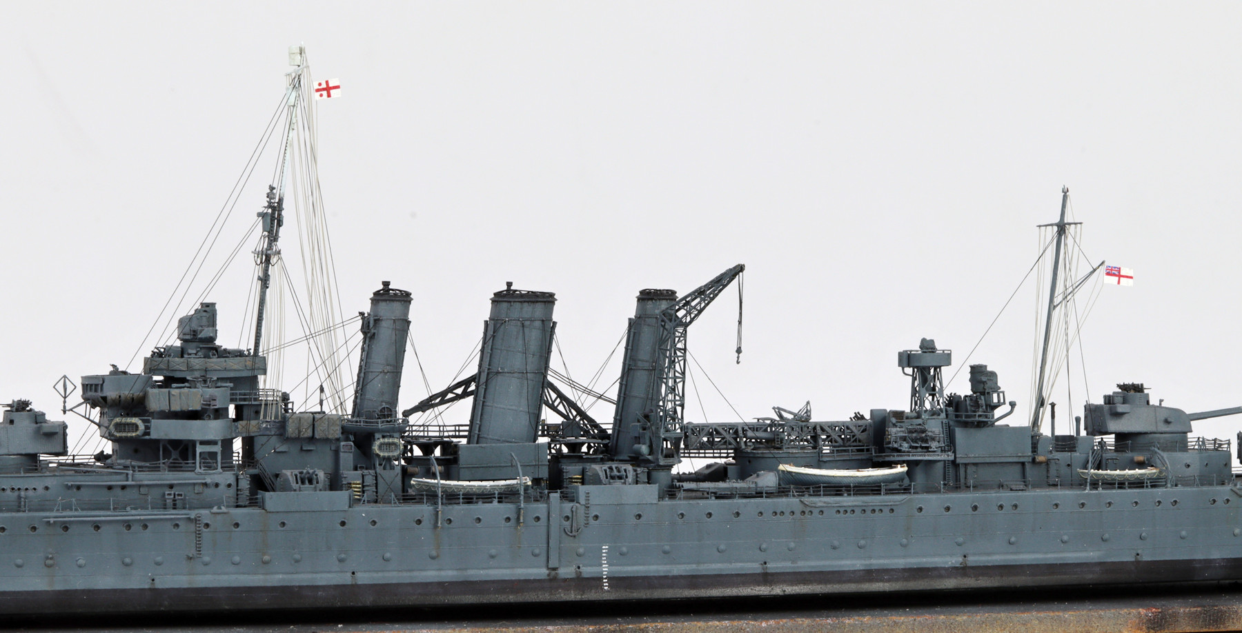

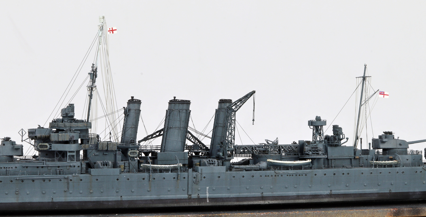

Rigging: guys, halyards, aerials...
Another area on which we spent much more time on research than anticipated was the rigging. Not only that the existing 1942 photos don�t show too many aspects of the quite extensive rigging in detail, but on the other hand they do show that the rigging � including structural rig (stays or guys) � changed quite often during Australia�s career. While we were able to establish exact locations of most of the upper ends of guys, halyards and aerials, locating their bottom ends proved much more difficult in many instances. After having discussed the rig over the course of several weeks we arrived on the setup shown on my model, having tried to get it as much right as possible � with some minor compromises. I had to move the two forwardmost pairs of guys forward a bit, otherwise they struck the bridge. I also had to leave loose the starboard funnel guys that would go over the stowed crane like if the crane was in operation (i.e. same as to port) because the crane did not come out low enough.
Other rigging includes boat davits, booms, paravane davits and accommodation ladder.
My preferred rigging material was once again 0.06mm thin nitinol wire by Shelf Oddity. I really like the way it can be used to depict sagging. It�s just a pity they don�t have more varieties of thickness (or thinness?) that would allow for more differentiation depending on the original material. I airbrushed the wire with black (for stays and aerials) and biege (halyards and boat ropes) paint and achieved some variation of thickness by adding the thicker stays and braces additional paint layers with a brush.
Flags & ensigns
We were not sure which flags would be in place at night, so I decided to use the following setup as seen on several 1942 (daytime) images:
  • steaming ensign on the mainmast gaff
  • large Battle ensign on the mainmast
  • large National jack on the foremast apex
  • Rear Admiral�s ensign on the foremast
Flags were printed by a laser printer on a white decal paper, then applied over a tin foil.
Crew
As far as the RAN crew to populate my model is concerned, I checked several 3D printed RN sets available on the market but found none really suitable for my purpose. I�ve given up using the dated 3dmodelparts sailors that I used in the past, they seemed to me a bit too sketchy compared to the recent hi quality parts I used in this model. In the end I decided to use USN officers and sailors and AA gun crew by Shelf Oddity despite the fact that they indeed are not quite accurate for RN/RAN, but � frankly � the difference can�t be really noticed even on close-up photos. I complemented them with some figures by ION and Triumph to obtain wider variety of poses, while SS MODEL figures proved to be unusable (see 1/700 Figures comparison SSMODEL, Shelf Oddity, Triumph, ION).
Contrary to my HMAS Canberra model, which showed sailors dressed in whites, I painted most of the crew wearing faded blues which seemed more appropriate for the 2nd degree of readiness at night in the Pacific. Gun crews also wore mostly faded blues with off-white antiflash hoods and gloves and olive helmets. Just a few sailors appear in whites or khakis.
Final details
While cross-checking WIP photos just before finalizing the build we noticed several missing details like square-shaped vents aft of the breakwater or a T-shaped vent at the face of the forecastle. It also turned out Australia had additional paravanes stowed on a trolley (the largest scratchbuilt part in the photo) aft of the B turret. And we also noticed warping heads on the aft face of the aft superstructure that were added during the very final stage of the build.

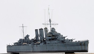

Heavy cruiser HMAS Australia, off Guadalcanal, Aug 9, 1942
It�s 0115, August 9th, 1942. The first Marines waded ashore on Guadalcanal only 40 hours ago. RAdm Sir Victor Crutchley, commanding officer of Task Force 44, returns onboard HMAS Australia from a conference with CTF 62 RAdm Richmond K. Turner and Major General Alexander A. Vandegrift on USS McCawley stationed off Guadalcanal. Twenty-eight minutes later and 15 miles away, the night in Savo Sound will be shattered by the first salvo of Japanese heavy cruiser Chokai aimed at Australia�s sister ship HMAS Canberra. This surprise attack will later be called the Battle of Savo Island by the Allies and the First Battle of Savo Island by their opponents. It brought heavy loss of life and ships to the Allies and marked the worst defeat of U.S. Navy at sea.
My model depicts Australia exactly at the above moment. RAdm Sir Victor Crutchley can be seen climbing the port accommodation ladder, piping party ready to greet him, while his motor boat sails to be hoisted onboard and Vice-Admiral�s ensign is just being raised to the foremast. The ship is in the Second Degree of Readiness, with a reduced watch and only half of the guns manned. A night AA training exercise undergoes to starboard while a bunch of sailors relax out of the view aft of the X turret.
This build is a result of 5+ years of work (with interruptions indeed). I�ve got used to venturing into poorly charted waters already, it�s been happening to me most of the time since I started building ships related to the Battle of Savo Island. This project was no exception so a large part of it actually happenned on the research side as I wished to have the model both accurate and superdetailed. After it�s been in the making for so long I�m so happy it�s done at last - and how it turned out, too.

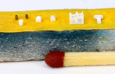

Parts used
Aoshima 1/700 HMS Kent (056714) (parts for the hull, forecastle and aft superstructure only)
My own 1/700 HMAS Australia 1942 photo-etch (see note at the bottom of this post)
Micro Master 3D parts
General
Weapons
Directors (available as one set)
Boats
Carley floats
Bridge details
My own 3D parts kindly printed by Micro Master
  • 4in ready ammo lockers - standard Australia-style) (4)
  • 4in ready ammo lockers - standard Australia-style incl. ready ammo on racks (6)
  • 4in ready ammo lockers - later Australia-style (2) - TBD yet, standard Australia-style used instead
Bridge equipment
  • Air Defence Officers Sight (5)
  • Searchlight Control Sight (4)
  • Pelorus (1)
  • Main compass (1)
  • Enemy Bearing Indicator (3)
  • Lookout Sight (6)
  • Deck Equipment
  • Anchor winches + wheels (2)
  • Main anchor capstan (1)
  • Aft capstan (1)
Vents
  • large fat mushroom vent
  • medium fat mushroom vent
  • small fat mushroom vent
  • medium tall mushroom vent
  • small tall mushroom vent
  • box-like vent standard
  • box-like vent tall
