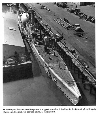

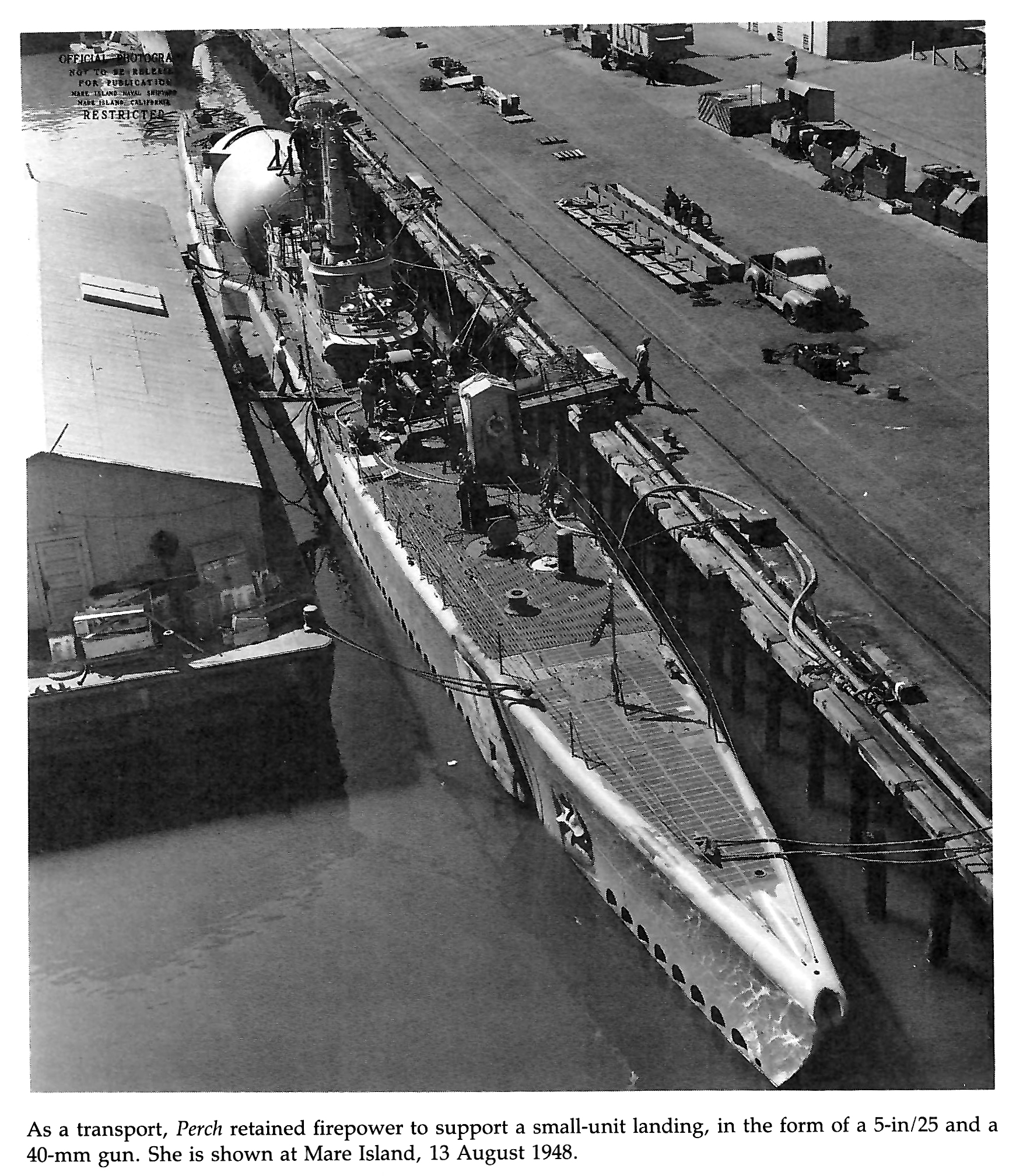

ssn705
- Posts: 62
- Joined: Mon Aug 03, 2015 10:20 am
Re: Calling all Balao SS-285 class SS fans
Probably a stretch with this one, but looking to see if any one has info on PERCH (APSS 313) in the Korean War timeframe. Specifically interested in any further detail/description of the starboard side of the main deck outboard of the deck shelter. A couple pics show a step down ( maybe to facilitate embarking/debarking small boats) but without great detail. Any detail, thoughts, pics appreciated.
Best pic of it is here (Navsource):
https://navsource.net/archives/08/312/0831334.jpg
You can see a guy standing in it. I assume it is likely steps down the sloped sides and probably a vertical bulkhead inboard.
Once the deck shelter is gone, the step is gone too.
Dave
Dave

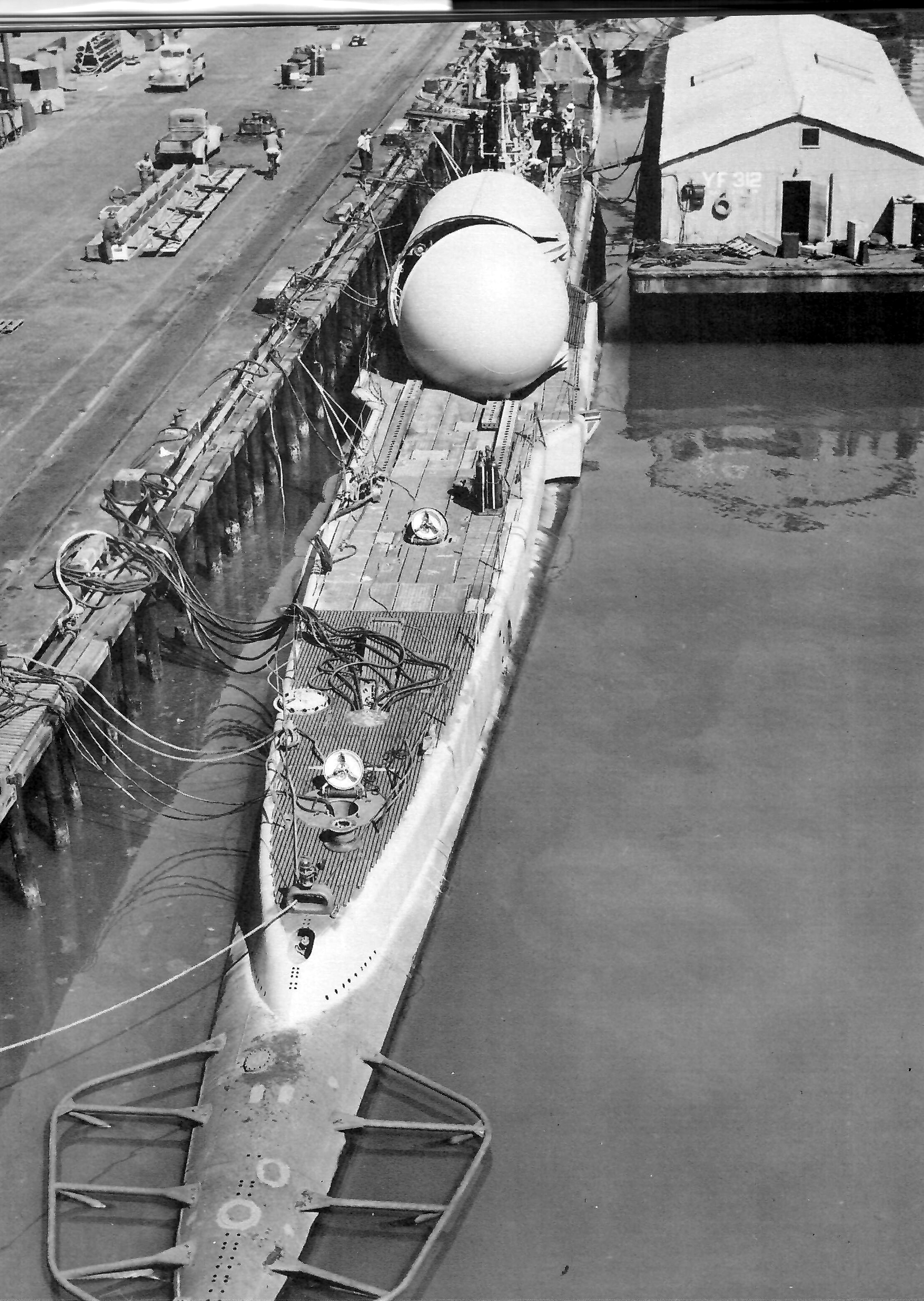

Tom Dougherty
- Posts: 654
- Joined: Wed May 07, 2008 8:05 pm
- Location: Ayer, Ma. USA
Photo of Perch from a rear, overhead view and another forward view. The rear view shows that area in some detail.
Tom Dougherty
Vepr157
- Posts: 276
- Joined: Sat Feb 08, 2014 4:08 pm
- Location: United States
Dave, that's a keen observation; I had never noticed that before!
I suspect that there was a trough in the deck aft of the hangar to allow the hangar door to open as the hangar was recessed into the deck. You only see a notch in the starboard superstructure because the hangar swung open in that direction. Here's a photo which shows what I mean:
https://catalog.archives.gov/id/7576826
When the hangar was removed it seems that this trough was plated over so that just a flat deck remained. The hangar on the SSGs (which was derived from the SSP hangar) had a door that opened upward, so no such trough in the deck was required.
Jacob
Jacob

ssn705
- Posts: 62
Jacob,
That photo and your assessment totally blew my mind. I don't know how I didn't make that connection. In the back of my engineering brain, I have always sorta wondered about the movement of the door since it was side opening. Now to sketch it out.
Dave
Dave
ssn705
- Posts: 62
And the opening trench now makes the shadows in this picture https://www.navsource.net/archives/08/0831321.jpg (also posted by Tom above) make more sense.
Dave
Dave
