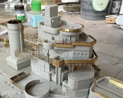

I'm getting closer to finishing the bridge area. The wind deflectors have all been assembled and installed. I could really feel my modeling mojo flagging while putting those together, so I''m glad to be done with it. The rest of the railings went on without much fuss.
I'm going to try to paint most of it before assemble, since the decks and the bulkheads are different colors. Then, once assembled, I'll add the ladders that connect the different decks and paint them.
However, before that, are the bridge windows. They're molded as ovals in the kit, whereas they're really just a circle. This has really been bugging me. One idea is to just fill them in and add a porthole bezel to make a round window. Another idea is to drill out each one, and glue in a piece of clear sprue if I can find something the right diameter. That'd be a lot more complicated but could end up with a better look.
Mike
