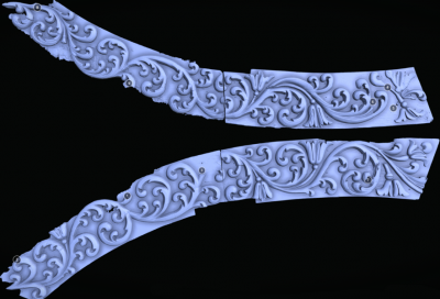

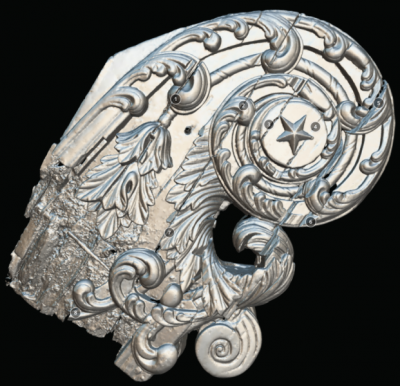

There's no contact for these people shown, so I took the best screenshots of the items I could manage.

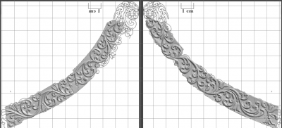

these images I ran through SCULPTOK to generate STLs from them as "height-maps."
trailboard screen-cap
billet-head screen-cap

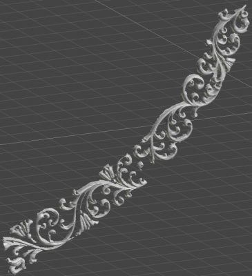

I loaded the resulting STL into Blender to reduce the faces down to something manageable using the decimate feature, and save it as an ,OBJ file. I'm having a difficult time learning Blender so I loaded the OBJ into Anim8or (software I know how to use) where I can clean-up and adjust the model to fit my model of Constellation.
STL from Sculptok
STL from Sculptok
working on it in Anim8or
cleaning it up in Anim8or
