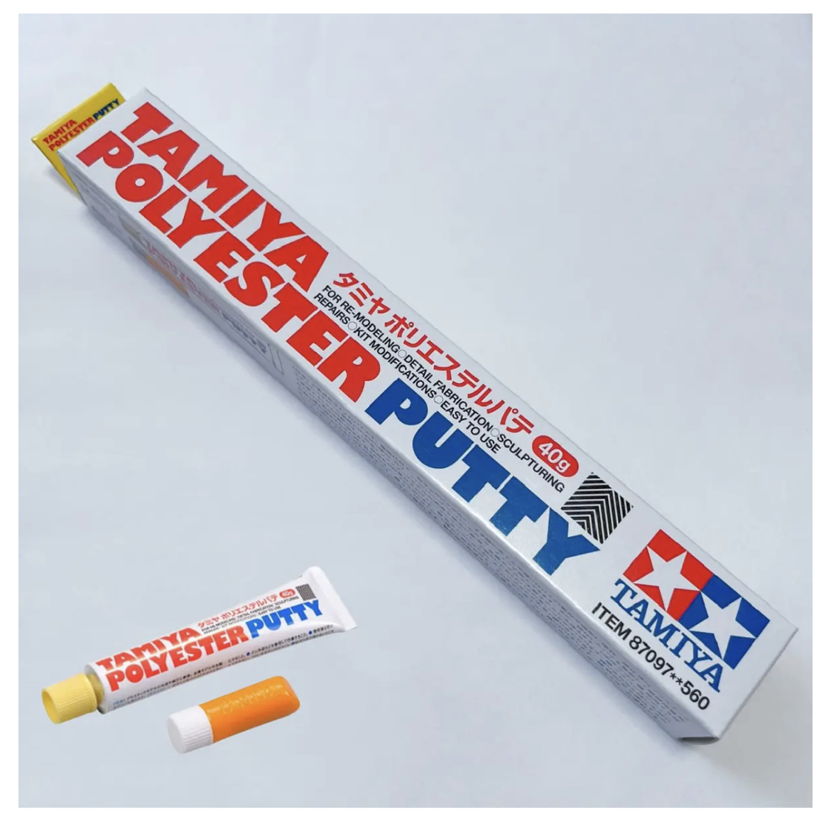

Re: Non-shrinking Putty for filling holes in plastic
I can second the recommendation for Tamiya polyester putty. I have a number of Star Trek models I did maybe 20 years ago where I used this to fill big gaps - it was good to work with at the time, and the models are still holding up well with no cracks forming in the puttied joints, even in nasty spots like the roots of the Enterprise's warp pylons.
