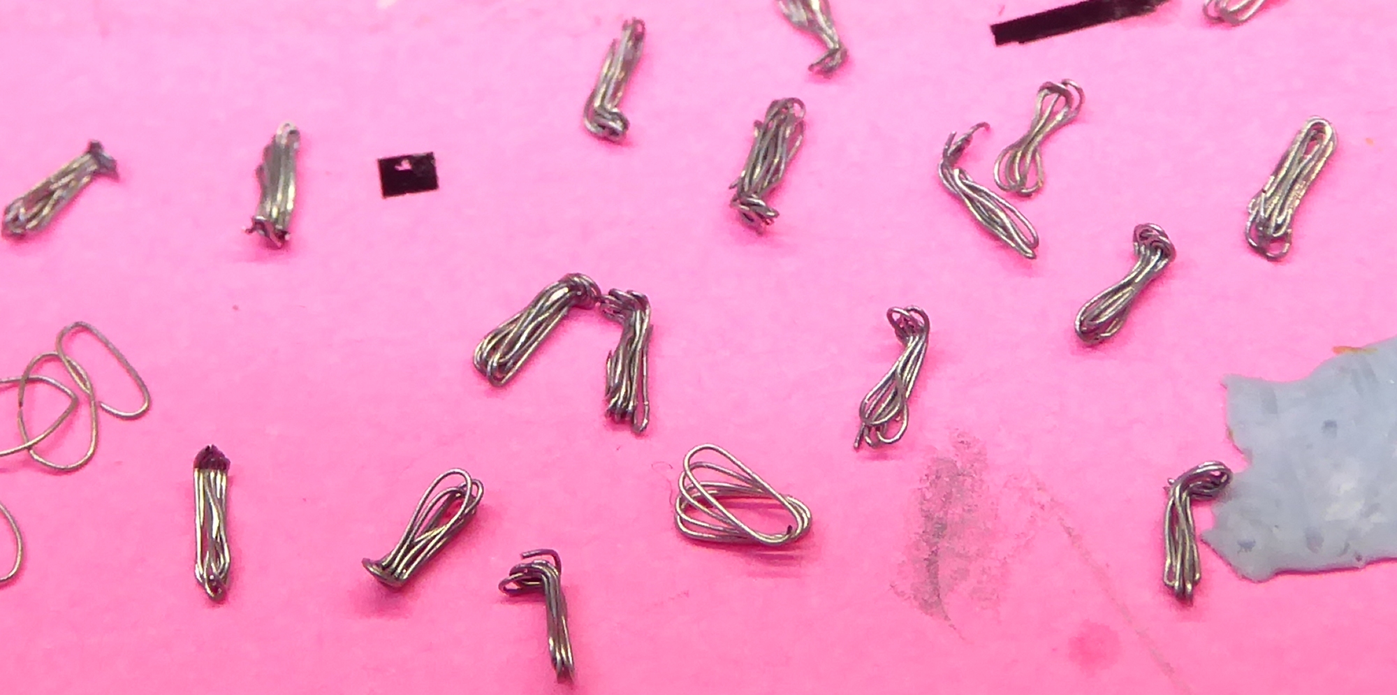

- JIM BAUMANN
- Posts: 5723
Re: 1/350 NRP SAGRES sail training ship (quite the challenge)
Thank you all for your kind words!
this is a challenge indeed....
Now then... if there are masts --there is string !
and the ' string'--halyards, lifts, braces, sheets, hauls in and out etc etc--all these need and have a ' tail ...
ergo ==> rope coils at the end of every belaying point
I did this in 1/700 on Bretagne... and it gives a fair impression.
but in double the scale it needs a bit more detail
I added the simulation of the bar that holds the turning blocks
for the halyards to go to the belaying pins
In real life....
these bars are separately mounted slightly inboard
-- but 350 times smaller--and with the space requirements for handling in model format
--and the fact that my pin-rail legs are a little over-scale...
and that the real life the bar is approx only ca 120 mm or so distant from the leg
( in 1/350 = 0.34 mm )-- so its a permissible compromise in my view ....
making the 100 plus rope coils is a tedious business--
-wrapping copper wire around 2 x drill shanks taped together, compressing them, shaping etc etc
the success / wastage rate is around 50/50
once attached to the pin rail...it looked somewhat better!-
(-the rope coils are the devil to hold secure to paint )
so nothing much new to come for the foreseeable time--
as there is nothing but rope coils in my life.......

I have tried making these from scratch--but was failing to get the inflatable Tubes ( collars ) consistent, symmetrical
or indeed believable bends.
I tried making the tubes from lead free soldering wire bent as well as cut and shut.
I gave up and bought these
They are BEAUTIFULLY detailed models in their own right
alas --for me they have a number of issues ( ...--for the Sagres RIBS )
1) they are too long ==> 7 metres as opposed to the 5 metres Ribs on Sagres
2) they are inboard powered, and have divergent angles for the tubes-which have pointy ends
But the tubes were believable--so I removed everything, cut the tubes off the hulls, shortened both the hulls and the tubes--
re-assembled them with parallel tubes ( taped) as in the overhead image of the Sagres Ribs
