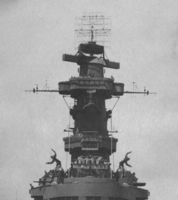

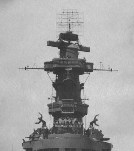

If you're building a mid / later war battleship in a large scale (1/200, 1/350), is it safe to paint the SK radar, MK3 and MK38's flat black? On Indiana in 1942 the radar really does look grey.

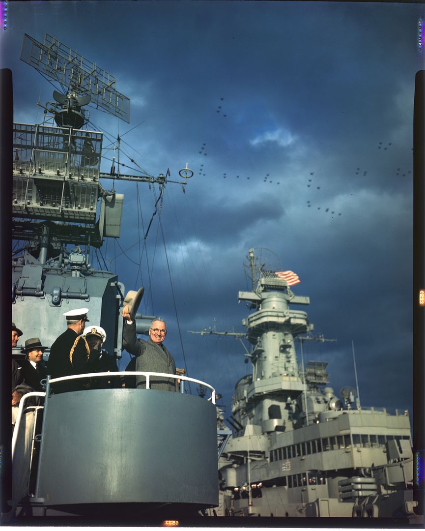

From the looks of it, those antenna could very well be anodized steel which would not require painting. The SG RADAR (center, small solid antenna) certainly looks like that. The MK. 37 Fire Control director's antenna in the foreground looks to be aluminum, one of the two materials RADAR antenna were constructed of (steel, aluminum).
I worked at Western Electric (Winston-Salem, NC) for several years in the early '70s when quite a few field engineers were still employed and met several who had been test personnel to go to the fleet in WWII to install/test new RADAR equipment. Sadly, most of those fellows have now passed on - but, I'm trying to locate any who might be able to correctly answer this evasive question.

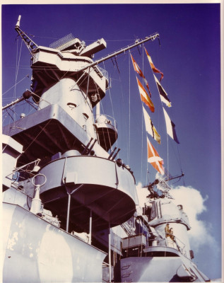

I scanned this original transparency, 80-GK-15861 dated 27 October 1945, at NARA several years back and the image I have looks different in "shades" compared to the NHHC website image, which is an older image I believe made from 35-mm slides which were the only color images "allowed" to be scanned/copied at both NARA and NHHC by researchers. A few years back NARA started to allow researchers to scan the original transparencies (or copy color negatives whichever was available) themselves, but only using NARA supplied Scanners. Whether the original transparency is "truer" to what the actual ships looked like, I won't swear to. I just know that most times scans of the original transparencies look different than the images seen made from the 35-mm slides available earlier. I did NO adjustments to the image when I scanned the transparency or afterwards.
You can see that the image I posted, "which" really had to be downsized from the original 150GB scan, is sharper and the color is shifted.

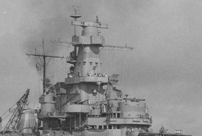

The radar, especially the Mark 3/8? on Alabama in this photo looks pure untreated steel. In 1/350 and 1/200 scale I guess we should start spaying these silver or gunmetal?

if it is untreated then it is not steel as it would be covered in rust especially by the ocean.

My comment on "anodized steel" was obviously incorrect as that would certainly increase the likelihood of rust developing on the surfaces & so forth. Varnishing the antenna as R.E.D. has suggested probably was the preferred method for those antenna constructed of steel.
Parkerizing, which chemically treats steel to inhibit rust I guess could have been employed if the manufacturer had a large enough tank to give the antenna parts a hot bath in the solution. This was std. treatment for military small arms, etc. and perhaps still is.
Coloration of those antennas would also be affected by the salt spray, rain, anything weather-wise which would tend to either bleach the darker colors light or in the case of stack gasses, turn the antennas dark or sooty.
