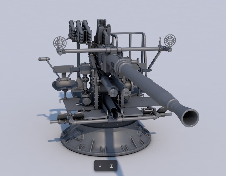

Here are my suggestions for the location of the 17 x single 20mm:
I suspect that on Implacable's arrival in Australia, and before her actual service with the BPF, many, maybe all, the twin powered 20mm were converted to single 40mm boffins.
Careful study of photos would be needed to determine this, but if you have the As Fitted plans from Greenwich they should show all the original twin 20mm locations.
I can see the two original single 40mm mountings you mention. I think they might have been Mk III Mountings:
I'm finding it hard to see where the other two originals were. Surely the As Fitted's show them also?
