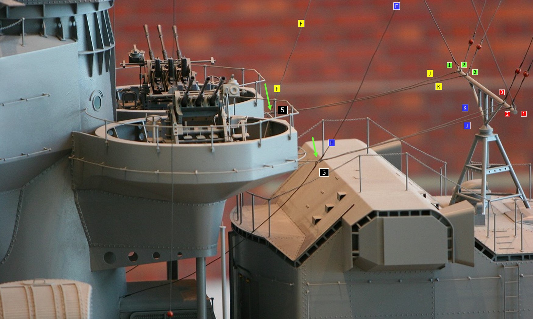

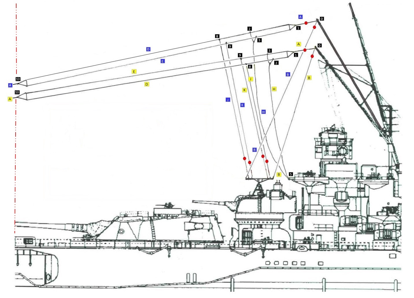

Pic Nr 001: This is the schematic reference picture that will be used in all the rigging steps of the Aft Ship. The elements of todays rigging step are : cables D&E, Branches Nr 2&3, Joint Nr 4, cable F, cables "J"& "K" and joint Nr 5 on the Front Bracket.
And of course : all these items on port and on starboard side.

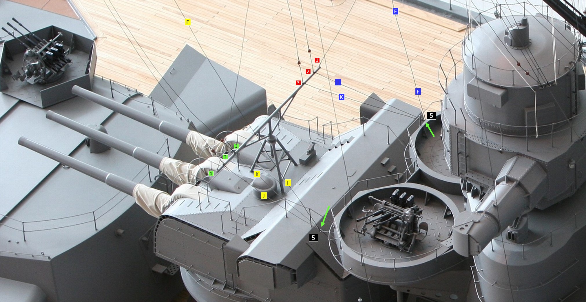

Pic Nr 002: Side view of AAA platform with detail view of the incoming cables on the port side front bracket.Pay attention for the port side bracket Nr 5: the green arrows mark the Bracket Lugs where cables" F-J-K" are attached. Also clearly visible: the length of the rod between the platform wall and the lug-eye. Quite long!
Pic Nr 003: Upper Side view of port & starboard AAA platform, also with detail of front brackets. In this picture also, the big length of the bracket rod is prominently shown.

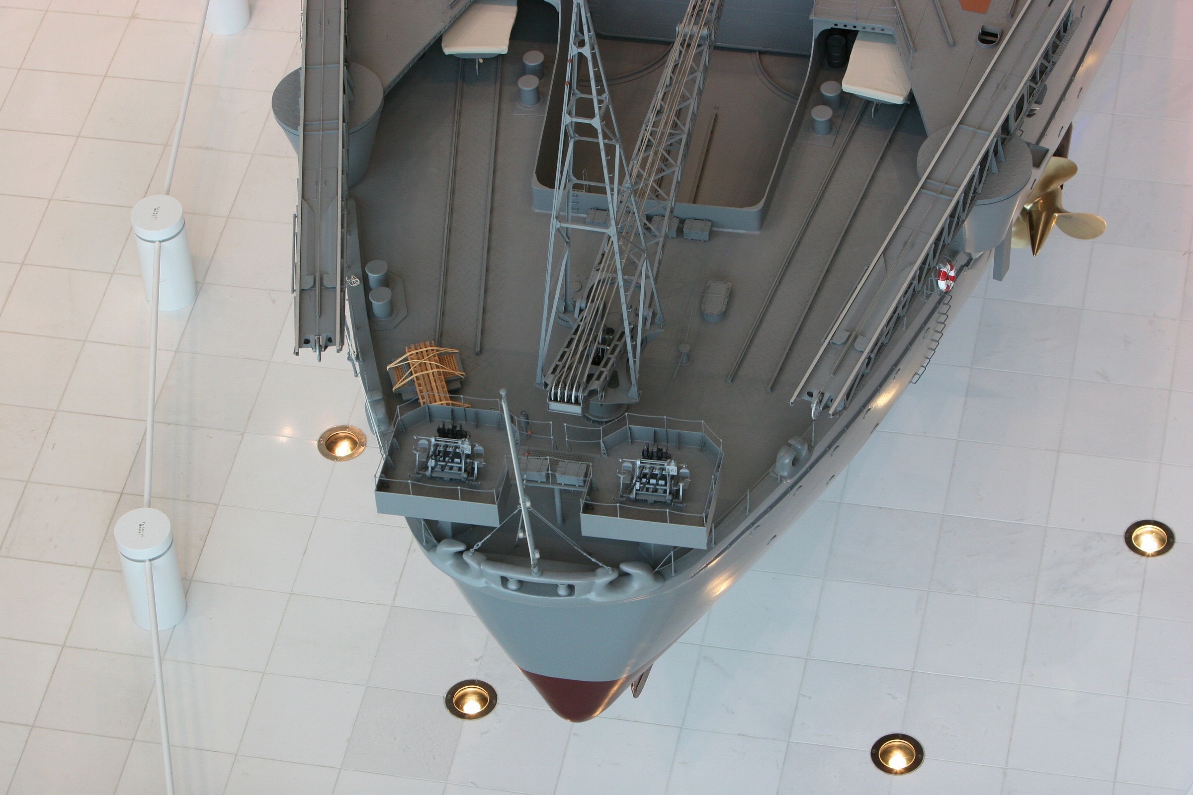

Pic Nr 004: Close Head-on view with incoming cables and detail of the 2 front brackets.
Green arrows: bracket Lugs where cables "F-J-K" are attached. Yellow arrows: attachment points ( 2 per bracket) where the triangular shaped support rod is welded to the Platform Wall.
Please note the 4 Brown Ball Insulators near Antenna Brackets 2&3 on port and starboard side of the antenna.
Cable "F" comes from joint Nr 4 that merges the 2 short cables coming from branches Nr 2&3 on cables "D&E". See also Pic 001 for detail.
Pic Nr 005: Upper aft view of the starboard platform with cables and bracket.
Pic Nr 006: Starboard view of platform & cables.
Pic Nr 007: Close -up of Pic 006 : Front-side view of platform & cables.
Pic Nr 008: Front view with detail of incoming cables. Please note the angles with which both Cables "F" arrive on the front bracket lugs.

The platform bracket:
This is a solid long rod (see Pic 002 for detail) with a lug-eye on one end. The other end, the flat side, is welded to the platform metal wall. A second solid rod, bent in a triangular shape serves as bracket support and is welded with its tip to the underside of the long rod and with its 2 flat ends to the platform wall. (see Pic 004 for detail).
The location of the 2 brackets is at the front side of the platforms, but not in the middle. (see Pic 004 for detail).
When you look at Pic 003, you will notice that the 2 brackets are installed rather on the front Outer side, than on the middle of both platform walls. The 2 brackets are facing the stern side of the ship.

Each platform front bracket Nr 5 receives 3 cables: See Pic 001-002-003-004-005-006-007 for detail.
First cable "F": (see Pic 001 for detail). Above on the Aft Ship, rigging cables "D&E" are split at Branch Nr 2&3 into 2 short cables. Little further, these 2 short cables are immediately brought back together in joint Nr 4, where cable "F" (blue tag on port side and yellow tag on starboard side) emerges and lead to the port & starboard lug-eye of the 2 front brackets Nr 5.
Second cable "J": from the 155mm Gun Antenna bracket Nr 2 (red & green tag), cable J leads to the lug-eye on port & starboard front brackets Nr 5.
Third cable "K": from the 155mm Gun Antenna bracket Nr 3 (red & green tag), cable K leads to the lug-eye on port & starboard front brackets Nr 5.

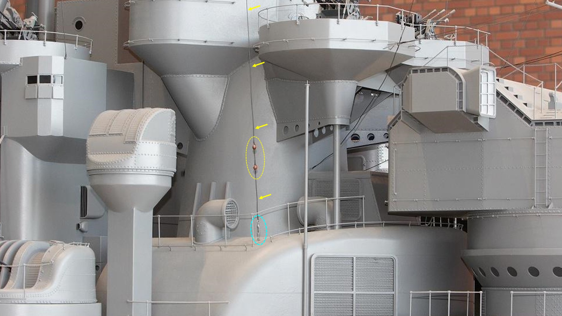

On both Brackets nr 5, cable "G" is attached and from there it goes under the port and starboard platforms where it is attached with a Lug Ring Nr 6 to a ring on the vertical structure wall.
The lug ring is located quite high above a vent. See Pic 007 for detail and the other pictures for general view.
Although Cable "F", coming from the Side Mast tips is present on all pictures I would like to note that Cable "G" is certainly not an extension from Cable "F". Bracket Nr 5 is the end station of Cable "F" and also the place where the new Cable "G" starts.
This chapter received its name because the 2 cables in this rigging step are really hanging " loose".
When you observe these cables you will see that they are not attached to any other station on the aft ship and they have no insulators installed. One may wonder what the added value is to install a short, loose cable without insulators and which makes no contact with any other rigging device.
Another subject for the long list of Yamato's rigging mysteries...
Insulator Count
All the pictures show you clearly that in this rigging step, no insulators are used.

Pic 001 : this is the schematic drawing used in all the rigging steps of the Aft Ship. In this step, the next items are of interest : Startpoint Nr 0 at the Side Mast tip Lugs, Cable 'C' and lug Ring Nr 7 on the second level Deck. All on port and on starboard side.

Pic 005 : general overview on starboard side of a big part of the rigging cables of the Aft Ship. Not only Cable "C" with the Bottlescrew and Insulators is visible but also the 155mm Gun antenna Brackets with all their incoming cables, the connection cables to the AAA Front Brackets and the "Loose Cable G " that ends on the vertical wall under the starboard AAA platform.
Pic 006 : Detail view of the same area. Please note the location of the 2 Brown Ball Insulators and the Bottlescrew that is attached to Lug Ring Nr 2 on the second level Deck.

Details of the Starboard Bottlescrew and the Lower Brown Ball Insulators are emphasized in Pic 003.

Pic 004: Aft-Side view with all the items of the Stern rigging area.
