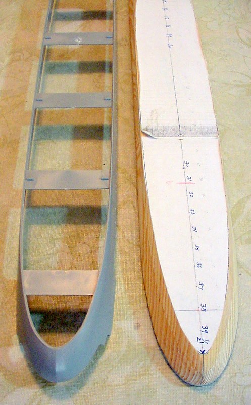

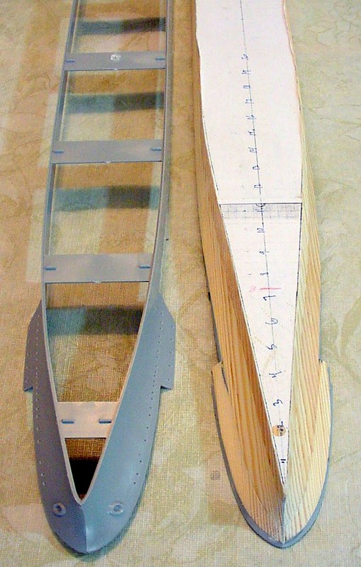

pic 2&3 Show why I think a hull replacement was necessary. It turned out that the best way to show the difference was to photograph the hulls upside down. Not only is the Trumpeter bow awful, the sidewall flare is missing and the stern is as bad as the bow.

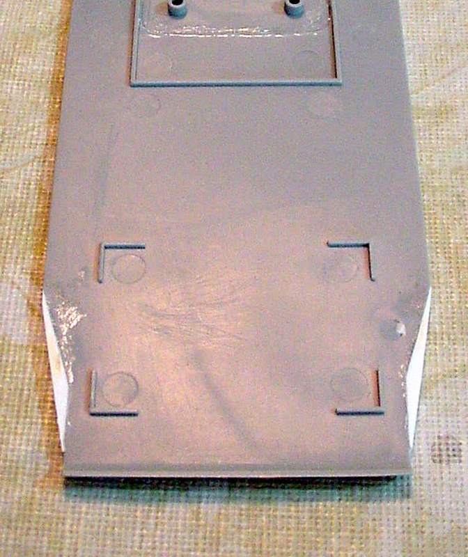

pic 4 Shows the modification necessary to change a CV-8 flight deck to a CV-5&6

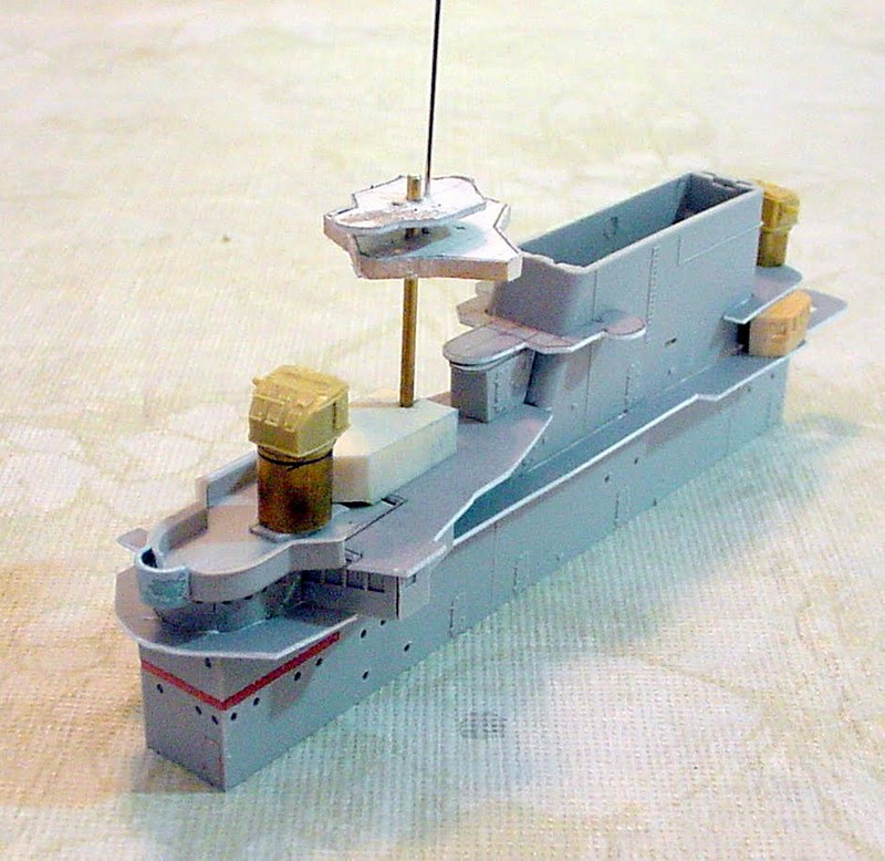

pic 6&7 Show the island roughed out.

JimRussell
Posts: 379
Location: Peoria AZ
Re: Converting the 1/350 Trumpeter CV-8 to a 1944 CV-6
Post by JimRussell »
To all, thanks for the encouragement.
To Martin and others who discussed a resin hull, the same thought went through my mind. I think that it would not work because while a large hunk of resin is fantastic at replicating detail, it is a casting subject to variations in shrinkage and is NOT dimensionally precise. We have all seen or heard complaints about mismatched hull haves. Since the hangar and forecastle decks must be used, the casting must be dead on. Using wood allowed me to start oversize and GRADUALLY sand down to the proper location. Also the blisters will hide many sins over most of the hull length.
Jim

Posts: 8541
JimRussell wrote:Martin, since you asked - more pics.
Thanks. You can really see how wrong the shape of the Hornet it in that 2nd picture.

Interesting that you used wood for the lower hull, I wouldn't have thought of that. Did you use the frames as a guide to sand the hull to shape, or did you sand and flare it until it looked right? My plan has always been to make styrene frames for the portion below the hangar deck and then fill it with sculpting clay or the like, but your method seems to have a lot of merit.
As far as shrinkage for casting replicas from resin; aren't there types of resin known for their lack of shrinkage during the cure process? I seem to recall they do exist but are quite a bit more expensive.
Nice work! I'm a huge CV-5 fan.
-Devin
JimRussell
Posts: 379
Location: Peoria AZ
Devin,
My basic guide is plans that I draw, copy and rubber cement to the top and bottom of the wood slab I am working on. For CV-6 the top was the hangar deck and the bottom was the waterline (the forecastle piece was added quite late in the process). The plan can be seen in the first entry of this thread (you have to clic the link - I used the old style picture entry and wanted the picture big). I then sand to get the side profile at any particular location along the length. A Dremel type grinder with a drum sander and set at slow speed is perfect for this work. Cannot answer resin questions, remember I make my hulls from wood.

As is true of most things, it is easy. When the wood is still in block shape, draw the top centerline on the wood, cement the top plan (punch some holes on the centerline of the plan so the centerline on the wood can be seen).
There are then two location tricks for the bottom centerline, drill a hole (with drill press to keep vertical) or cut on the centerline with a thin scroll saw blade to 1" past the end of the ship at the waterline (a .016" blade leaves a slot that will just take a .020" strip of plastic). Insert the plastic strip which has the bow profile cut so that the length of the strip at the waterline is 1".
I use the strip when there is a pointed end (which was both bow and stern for the Enterprise) and the drill hole for a rounded stern. The strip also is a perfect guide for sanding and keeping the bow or stern vertical (I cannot keep a curved pointed bow vertical without the plastic guide). The location of the hole or slot is put on the plans before they are copied.
The attached photo of a CVL shows the plastic bow guide.
