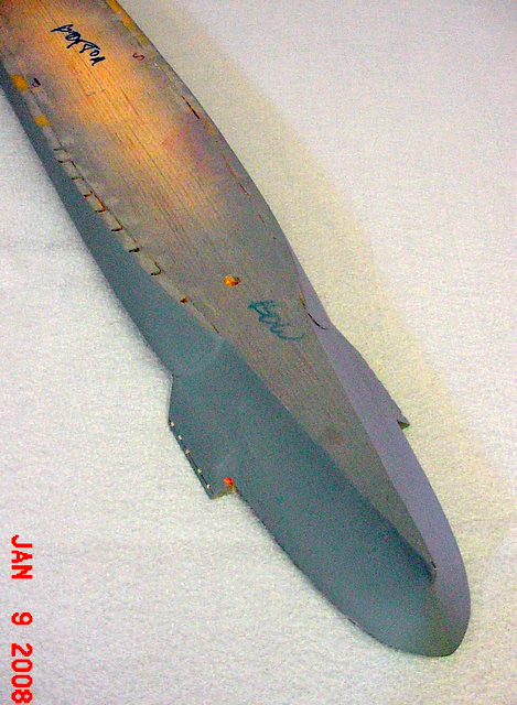

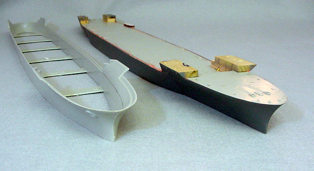

pic 2&3 Show why I think a hull replacement was necessary. It turned out that the best way to show the difference was to photograph the hulls upside down. Not only is the Trumpeter bow awful, the sidewall flare is missing and the stern is as bad as the bow.

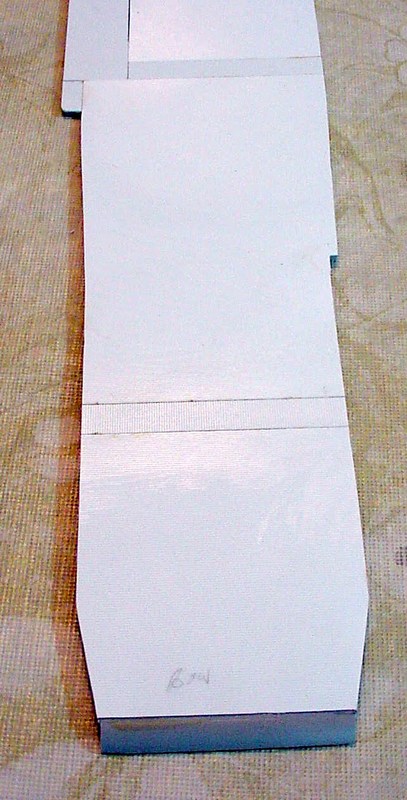

pic 4 Shows the modification necessary to change a CV-8 flight deck to a CV-5&6

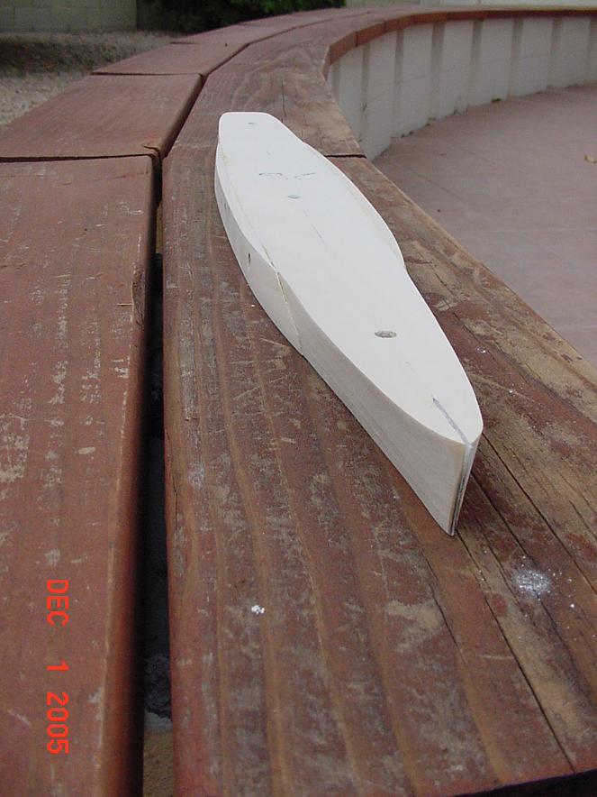

pic 5 While the detail of the Trumpeter Essex class flight decks was excellent, the Hornet was awful. Thus an overlay of Evergreen scribed sheet.
pic 6&7 Show the island roughed out.

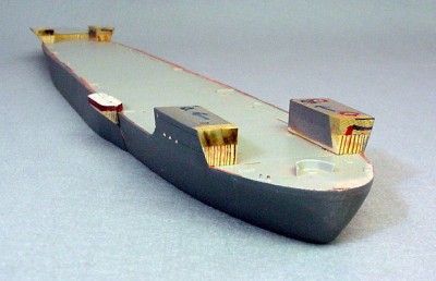

Martin, since you asked - more pics. I was really aggevated with these pics because the dark grey primer showed black. These shots were the frst I made on a new medium grey felt background. I was trying a new backdrop because the old light blue sheet made blue ships look olive. I am calmer now, shot some finished ships with more light (the new low energy socket bulbs!!!???) and blue was blue INDOORS!
The last picture shows the FUN of scratchbuilding. The blister is .25" thick at the waterline and I ended up grinding in grooves on the backside to make the bend easier. The job was all done and I was absentmindedly flexing one, when it broke. In 5 seconds my thought process was:
Damit
I dont want to make this again
You idiot
TILES
I broke all the pieces, bedded them to the hull with yellow carpenters glue, an easy sanding job with a palm orbital sander and nice results.
The first two shots show the hull to date
Jim
