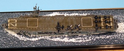

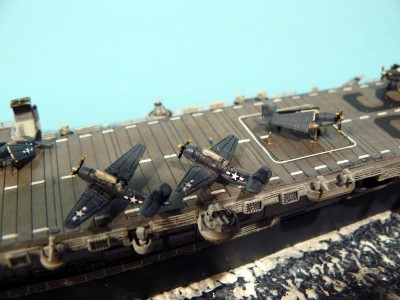

Has anyone tried various colors of pastel chalk? I used it on a couple of 1/700 aircraft carrier flight decks to weather them. I would put a clear coat over the enamel or acrylic paint, then rub finely ground pastel chalk around the deck with a dry Q-Tip. Sometimes the chalk would fill any recesses in the surface. If I screwed up I could blow off or wipe off or wash off the chalk and start over. I have a set of chalks in earth tones in hues of brown, green, gray, and black. I got them at a craft store, I think.

The chalk is rubbed into the surface and extra is lightly blown off. I seal it with air brush acrylic clear coat.
The top photo actually does have a THE DETAILER "Black Out" ready to use wash effect on it. It appears in the seams, but the weathering on the surface is chalk over a Gunship Gray base coat. BTW - This is a 1/700 scale model.
I had asked if anyone had tried pastel chalk for the recesses in wooden deck planks. I didn't do it on purpose, but I have had the chalk rest in the seems where I didn't want it. It would have to be really, really fine powder.
