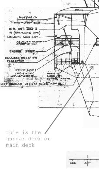

 Post subject: CV-62 hangar deck?
PostPosted: Fri Apr 18, 2008 7:52 pm
Joined: Thu Feb 07, 2008 7:52 pm
Posts: 55
Hi everybody,
I have been measuring the BOGP inboard profile drawing of the USS Ranger (CV-61) in order to determine the hangar deck or main deck distance from the base line. I have a known distance from the base line to the flight deck which I got from the outboard profile starboard drawing. The flight deck is 97 feet from base line. Now I know I am not supposed to scale the drawing but I don't really have any other option. If I measure along the base line at 3 points, AP, Centerline and FP the 97 feet measure an average of 6.25 inches. The drawings are 1/192 scale. Now if I use proportional scaling, the hangar deck distance measured along the same 3 points is an average of 3.91 inches which converts to 60 feet 8 inches.
My question is this: Do any of you who have served on board any of the Forrestal class carriers, in my case CV-62, know the distance from the baseline to the hangar deck or from the flight deck to the hangar deck? I would like to try and confirm my 60'8" dimension. I hope this request makes sense. :heh:
Now I am suspisious of this dimension for one reason. On the outboard profile port and starboard drawings there is call out for a wake light that is 60' 8-5/8 inches above base line and the hangar deck is shown above this light. (see image)
Thanks in advance for any info.
