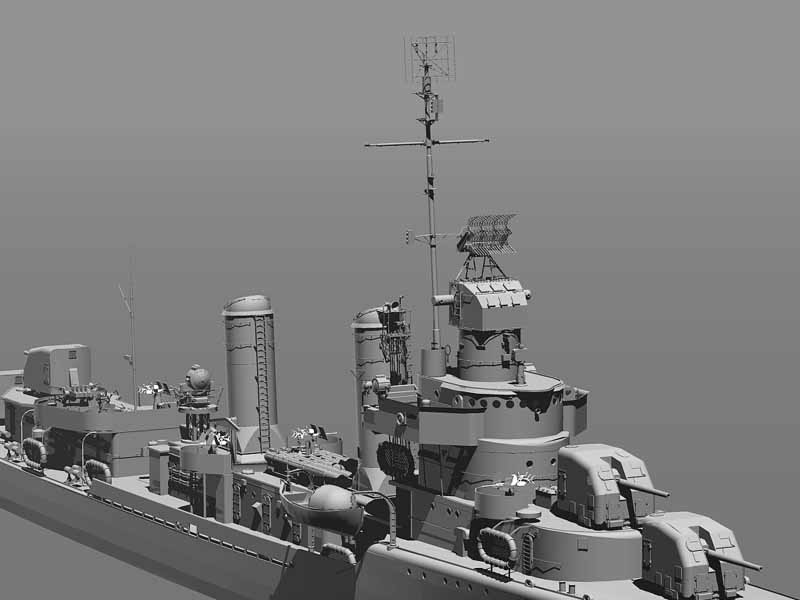

Now that the secret is out. I wanted to post some USS Buchanan CAD pics. I had a lot of fun building this ship. But it really pushed my PC to the limits.
File comment: USS Buchanan DD-484
File comment: Up close view

Since your 1/350 plastic version grabs all the people attention I wonder how many will ever notice there was an excellent 3d model first.... Do you need 120 megs to accommodate it on the HD.. ? if you don't mind me asking.

That -is- beautiful work, Tim :thumbs_up_1:

Within AutoCAD it is only 25 megs waterline style. But all the common parts are blocks and are not duplicated for each version of the ship. The file size swells to 100 megs plus when converted to an IGES file. With these 3D models the detail is somewhat simplified, but not too much. It didn't take me long to figure out that having real 3D diamond plate tread on my 40 mm gun mount platforms was a real no-no. The render time increase was ten fold. I resist the urge to work in shaded view as it tends to bog my computer down to the point where everything happens in slow motion. I have been experimenting with adding materials to the models. I have a MS-12 mod material that I can map to the surface, but it is trial and error to map it to the right proportions. AutoCAD is just now catching up to the render capabilities of other programs. But all that is really of no use for manufacturing a kit.
The real fun comes in when you start shelling out solids and breaking parts up based on best molding practices. I was able to do much of this myself thanks to a good friend who has worked with me in my real job. But this can be heat breaking as you watch the program attempt to make the parts ready to mold and soften details and totally wipe out some finer parts. I am still learning though and am getting better each time I do it. I have even learned some things that helped me with my latest casting design for my real job.

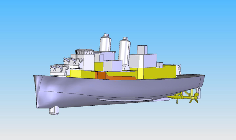

Yes I did. While I was scratch building my USS Zellars I built a model in SW. Of course my virtual model does not have the fine detail as yours does. It's more reflective of the model I was actually building.

Well you figured out how to model a hull, so that is a good start. Keep working at it. Who knows, you may be help design the next plastic kit.

I learned how to use SW at my old job. I was a forging die designer for about 20 years. I was on the drafting board for about 8 years and in '97 we switched over to SW which I was using until '99. Then I made a career move into web programming. The most difficult parts to model were the transom and bow. I would be happy to help you if you like.
I have some experience with 3DS Max and gMax but I am not that familar with Autocad. I think release 13 was the last time I touched it. I am working on a virtual model of CV-62 which is related to my other post the scratch build forum.
