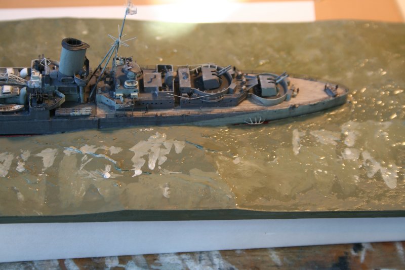

Next the crests of the bow and stern waves were added-using thick white paint, the initial effect is very crude, but more thinners and dry-on-wet paint will give a fairly satisfactory effect yet...
The contrast of blended and un-blended can be seen to good effect below
once washed and dry-on wet brushed the results start to look a little like foaming sea

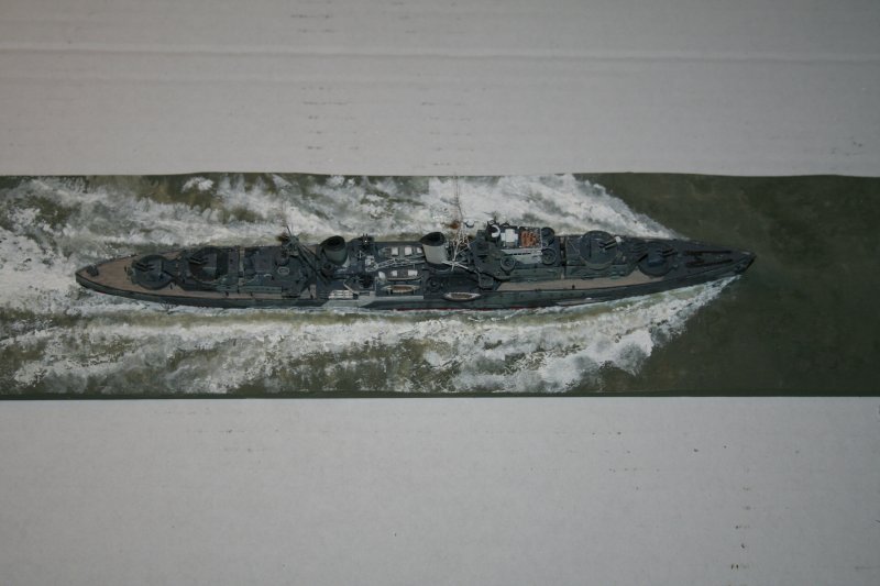

after all the mixing and blending the overhead view was quite pleasing to the eye
