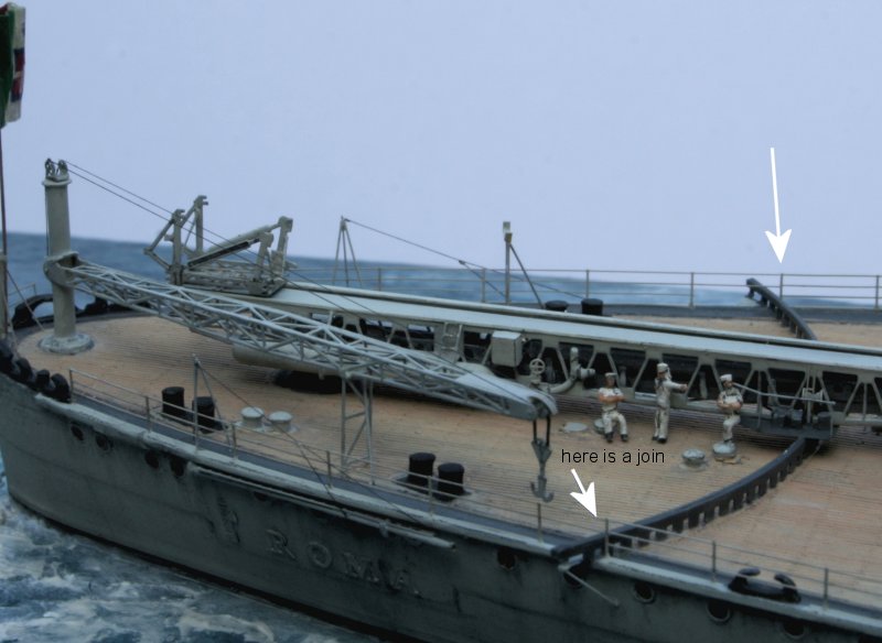

yes- I too mean cut the railing in 1/700 into small pieces @ 50 mm ( 2 inches)
in 1/350 - on my Roma I cut the railing into 2 - 3 - 4inch (50 - 75- 100 mm pieces)
I cut alongside a stanchion- and the join the end of the longitudinals butting to the stanchion-and touch them with thinned white glue--this makes a good and flexible join
see pics at bottom of posting
I always ensure there is a stanchion on a corner--such as on Koenigs Bridge I have cut a piece of railing the correct length, then another piece, but at the end by the stanchion of the second piece put in a 90 degree bend to make a shape like an L
Then glue on both and you should have a stanchion on each corner of the bridge wings.
On mine in any case the railings then had 'canvas'- made of white glue-paint railings first-white glue dries clear-paint canvas(dry white glue) on the OUTSIDE and you can then see the railings inside and the painted canvas outside..
send me your e-mail address via PM--I have taken the pics you requested
JIM B :wave_1:
The white arrows point to joins on my Roma...!
I use joins to prevent expansion/contraction problems--but also it allows me to change the lengths of the railings to ensure that the railing does not foul a fairlead/cleat etc etc--or for an upswept bow like Roma-the rails were made in lots of short pieces with lightly angled cuts to permit the railing to follow the curve of the bow. apiece
